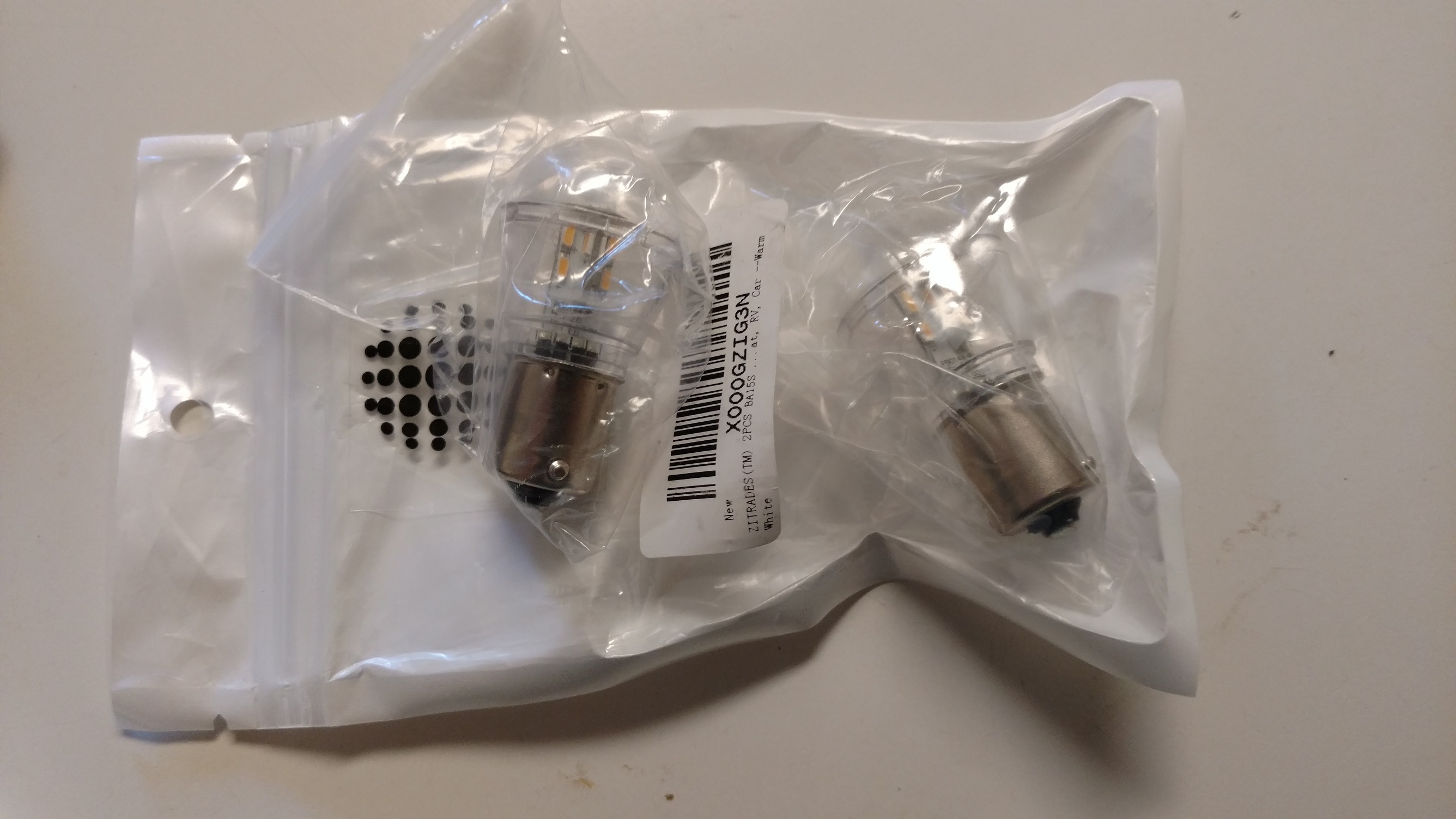

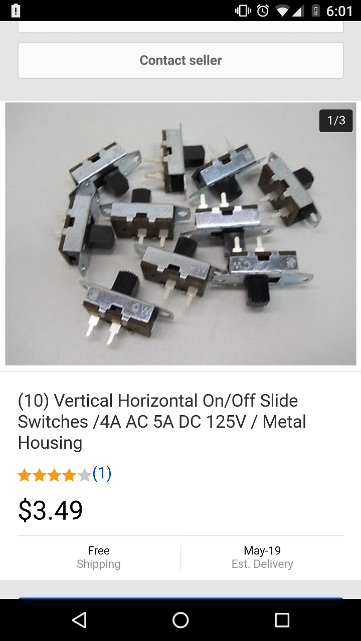

So I've had my 1987 Catalina 25 for about 8 months now and have done a few small clean up projects and tried buying replacement LED cabin lights from a certain online dealer for our boats but found the mounting holes didn't line up and I was nearly blinded with the super bright white LED's that they used. After some online digging, I've managed to locate the exact switch that the cabin lights housed on ebay, a bayonet single contact bulb socket from memotronics that can replace the current socket size with one small dremel cut, and some soft white LED bulbs sized ba15s which matches #93 replacement bulb size indicated on the sticker of the cabin light. In the next few days, I'll have received everything I need to replace the guts of each cabin light for roughly $15-20 per light and about 30 minutes worth of labor for each light. I'll be providing before, during, and after pictures and links in the coming days if anyone is interested in keeping their factory look like I was since all of my cabin lights' plastic containers were in good shape but the sockets and bulbs had rusted out or broken.

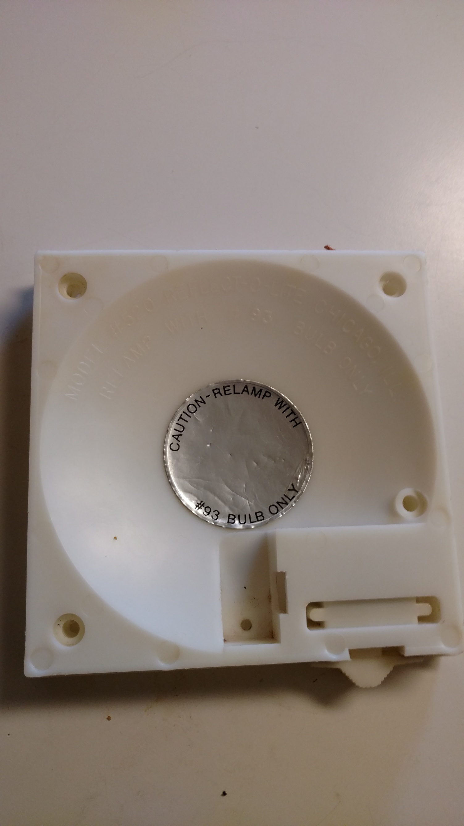

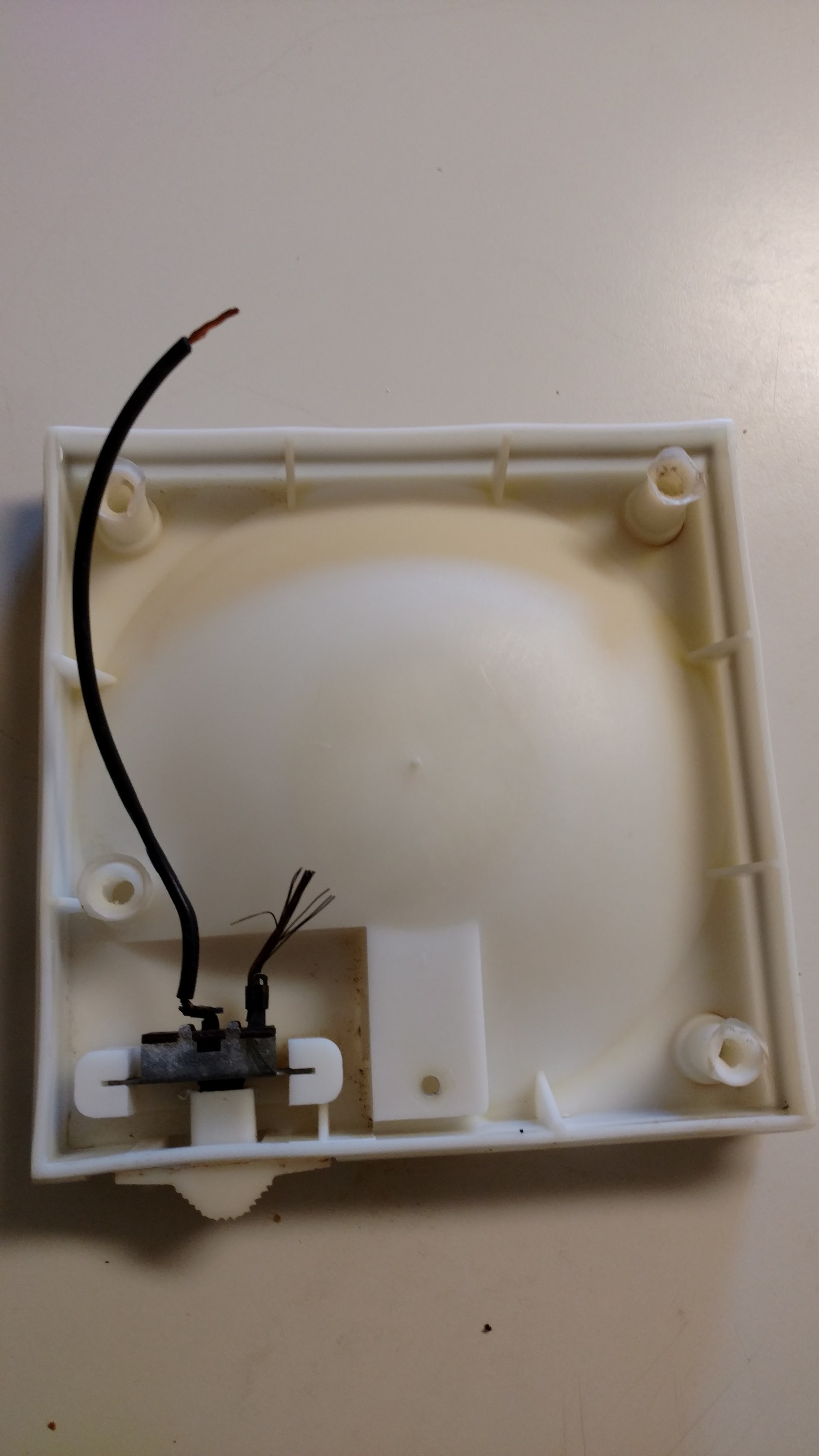

njlarry, agree with you completely on the original look! Attaching pictures now. I have everything I need except those switches and the correct sized clamp on terminals for the switch. The first few photos are the original socket with the original incandescent bulb that had corroded and rusted inside of the socket. Unusable really. We want to remove the whole socket so it looks like the third picture to begin.

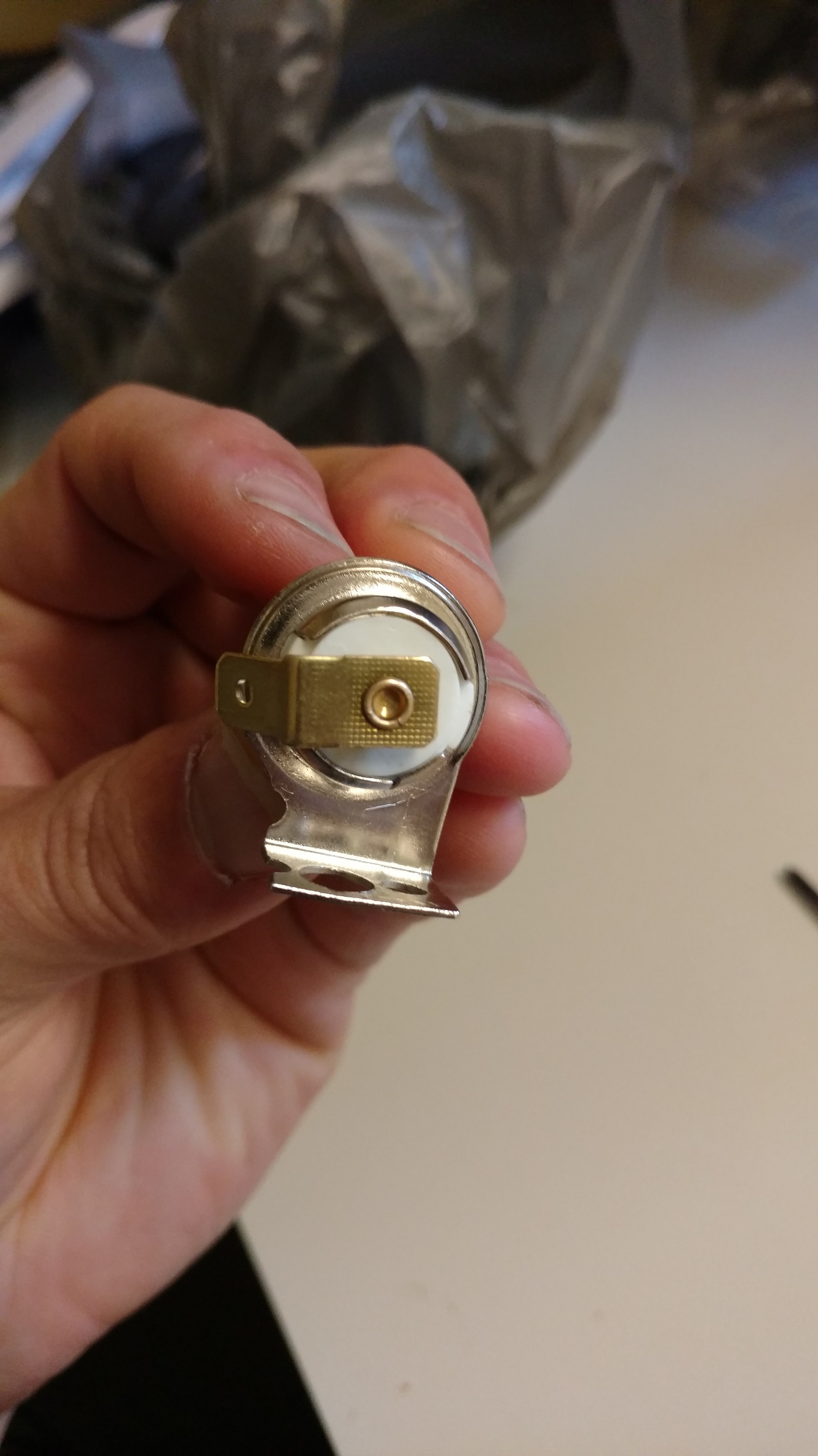

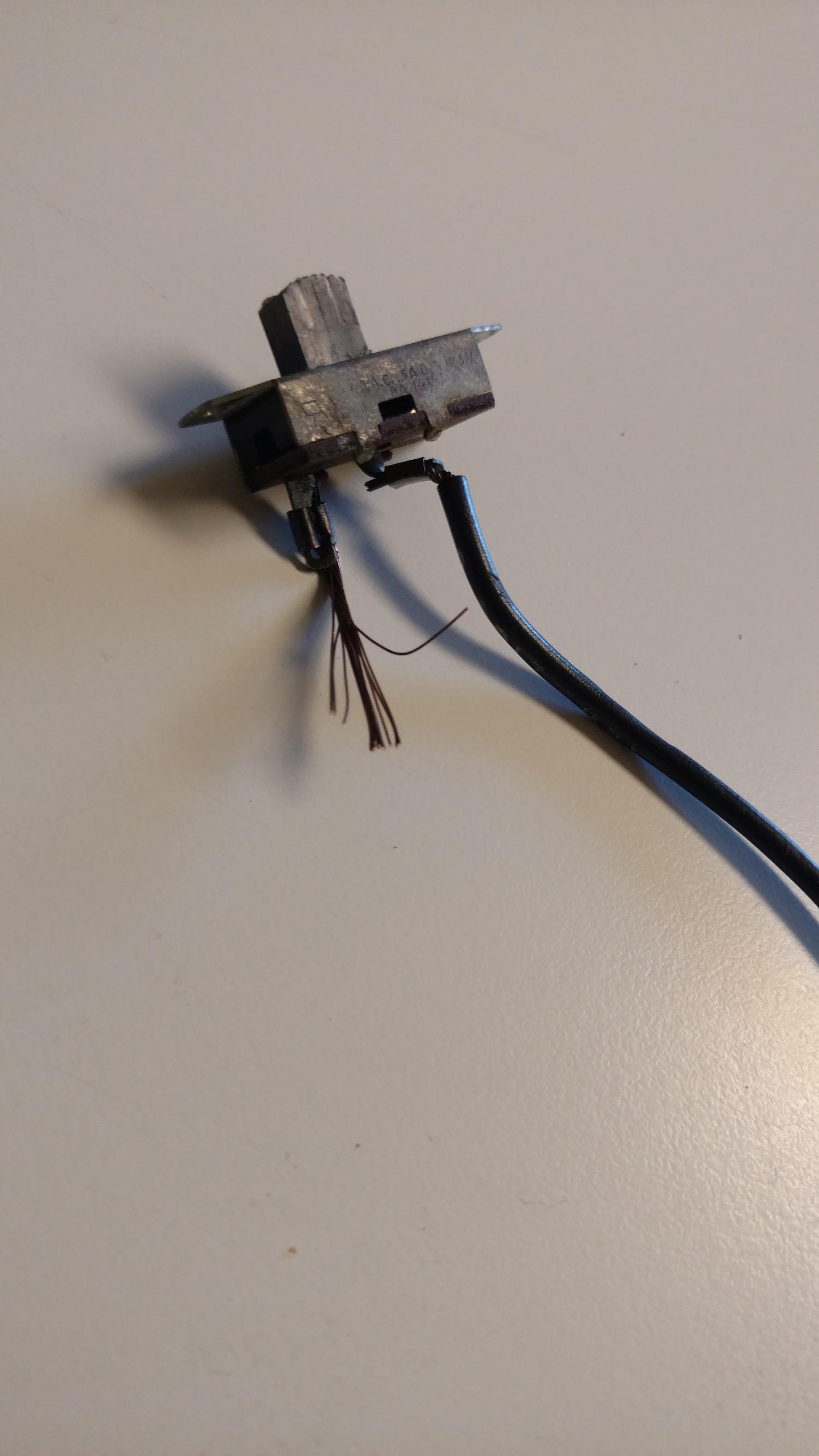

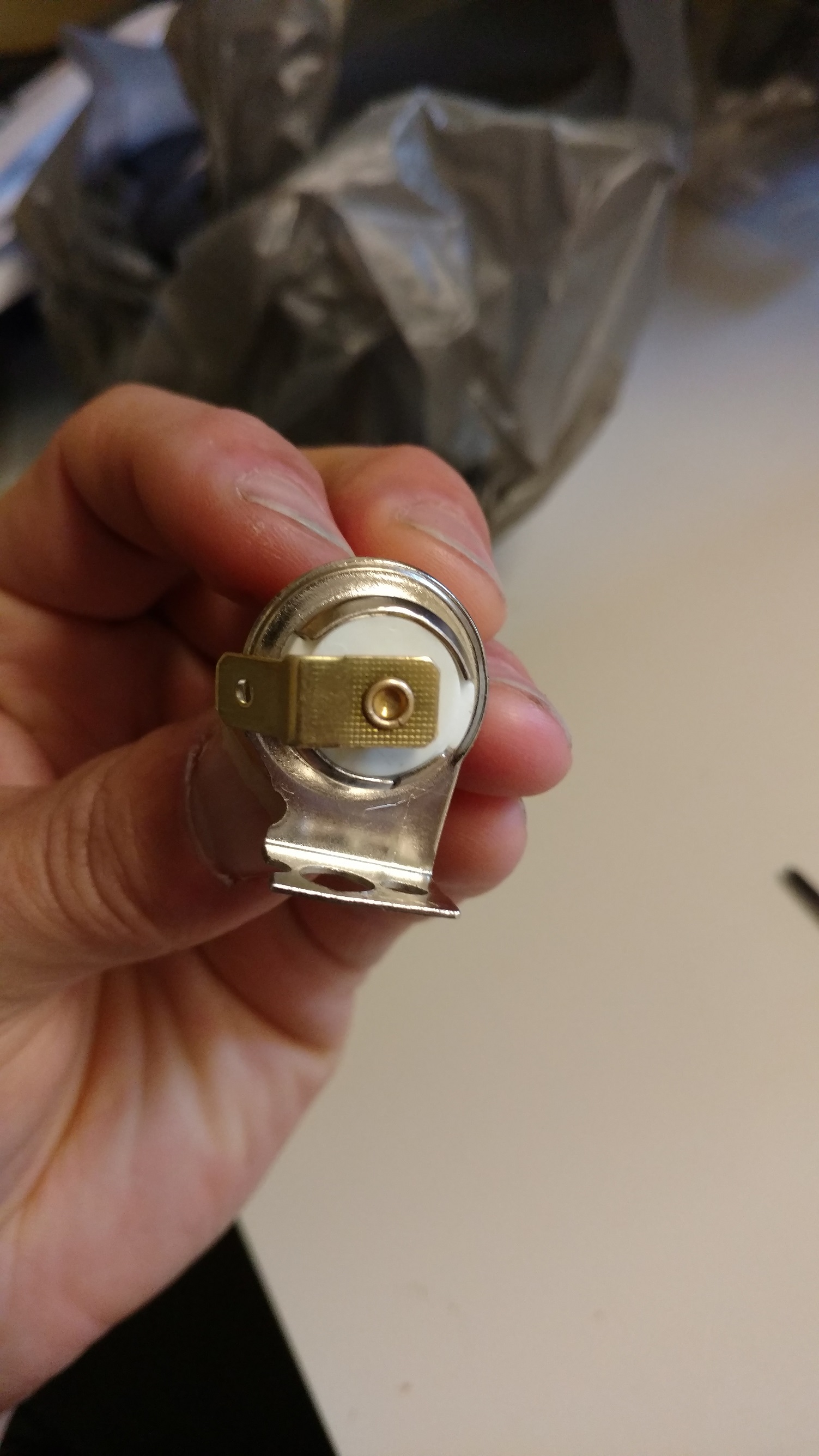

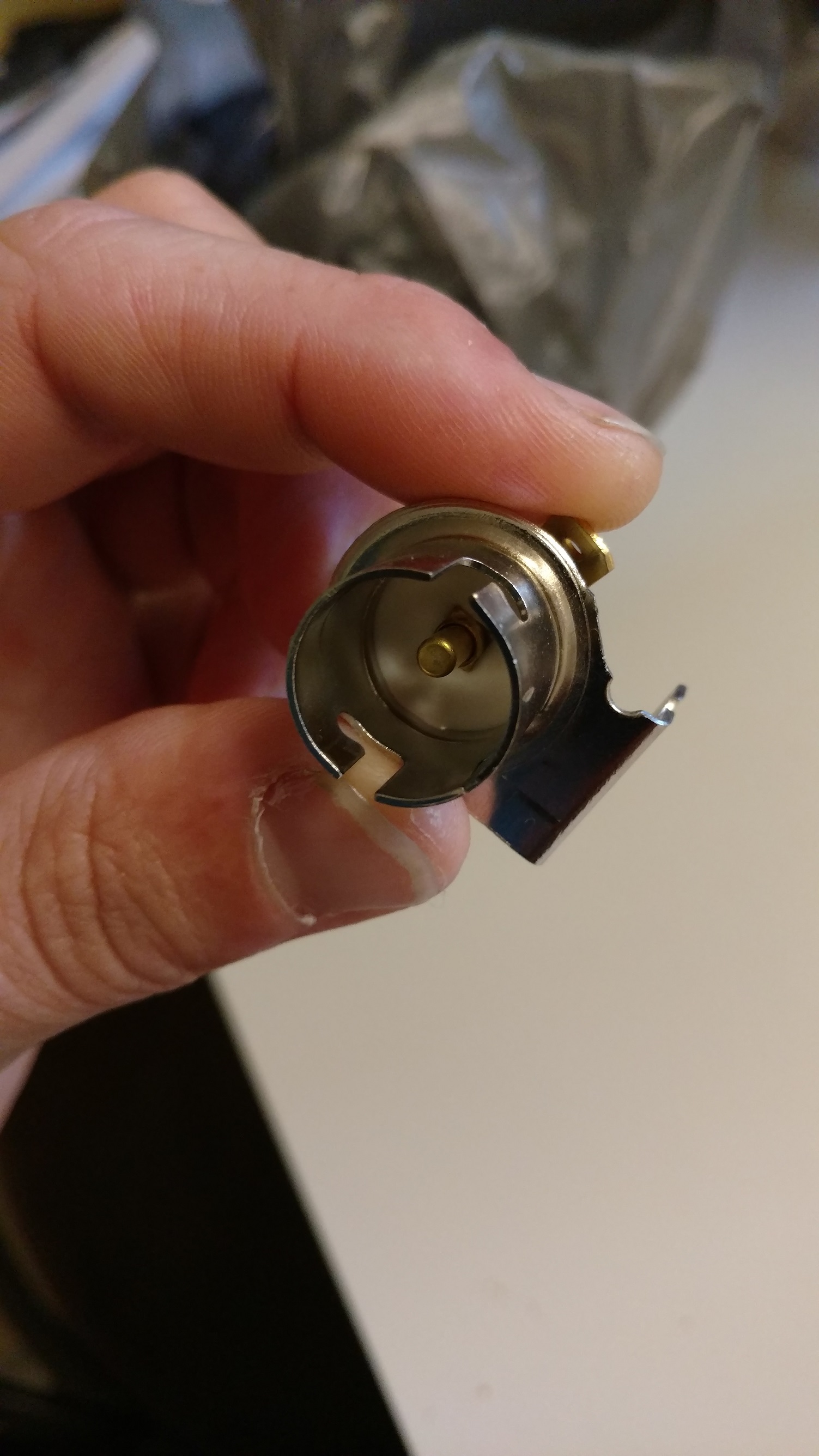

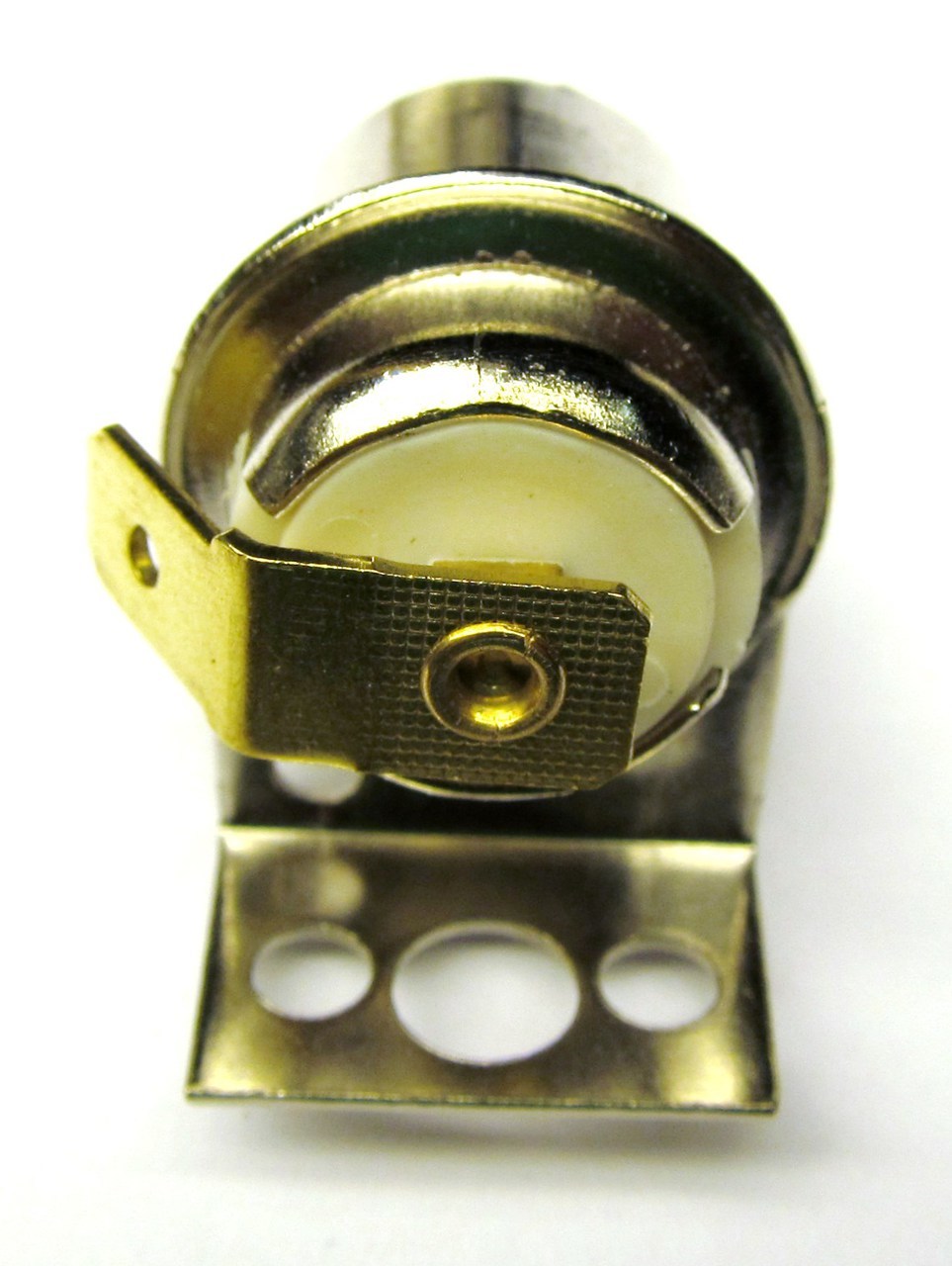

Remove the switch by pulling on the white outer plastic toggle portion of the switch and the switch can then be removed. The socket to be ordered is from memotronics website or found on amazon or ebay. The title on memotronics is "
Bayonet Bulb Socket BA15s, bracket, thick gauge metal, Flosser 6446, for 1156" $4 part. You'll notice it starts out with three small holes in the base of the bracket. This will need to be slightly modified with a dremel. My method was to hold the original up to the base of the new one using vise grips so the bases lined up with each other on the side closest to the switch, that way you will be trimming off a few millimeters from the opposite side so that it matches the width of the plastic insert in the base of the light.

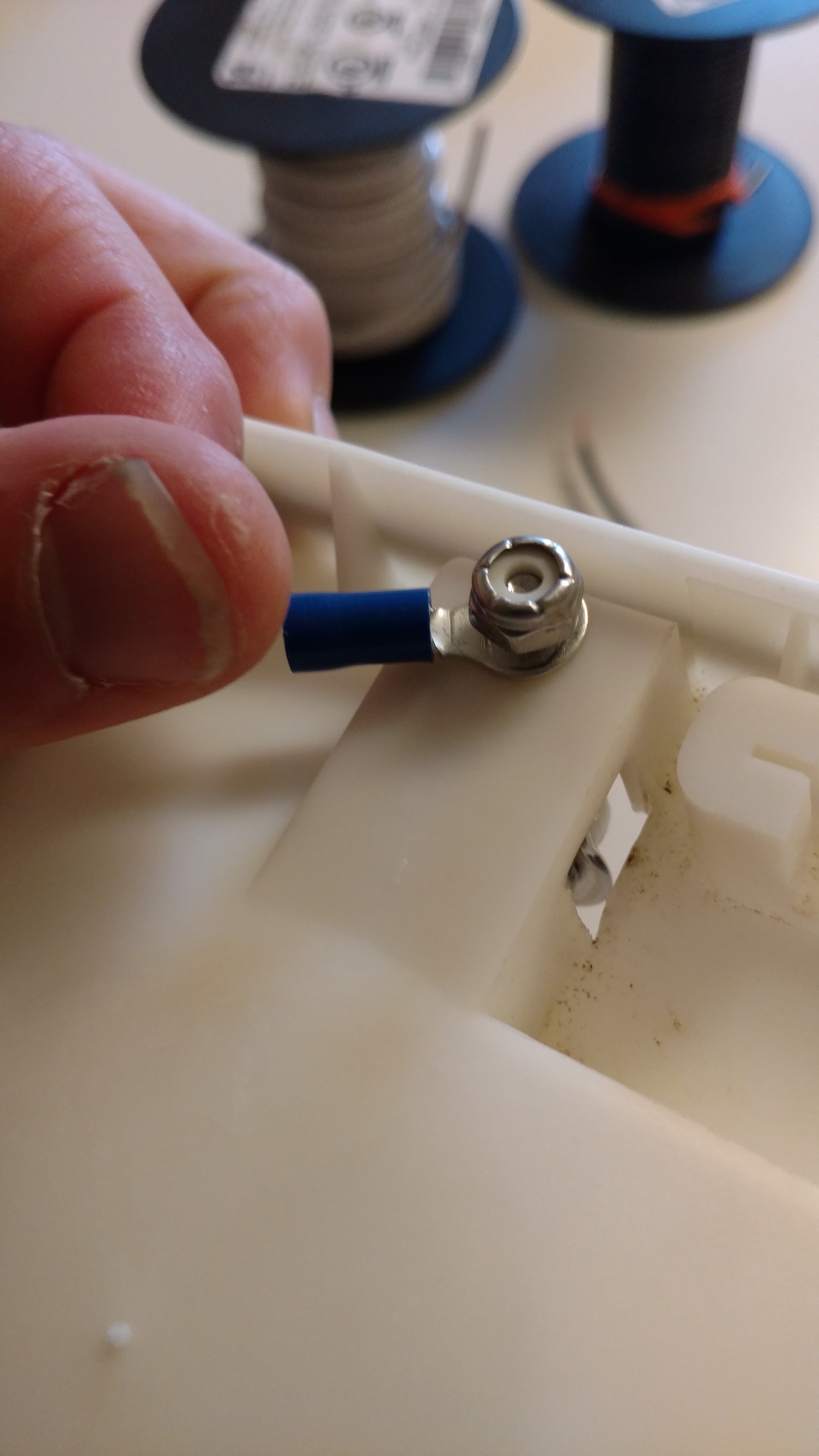

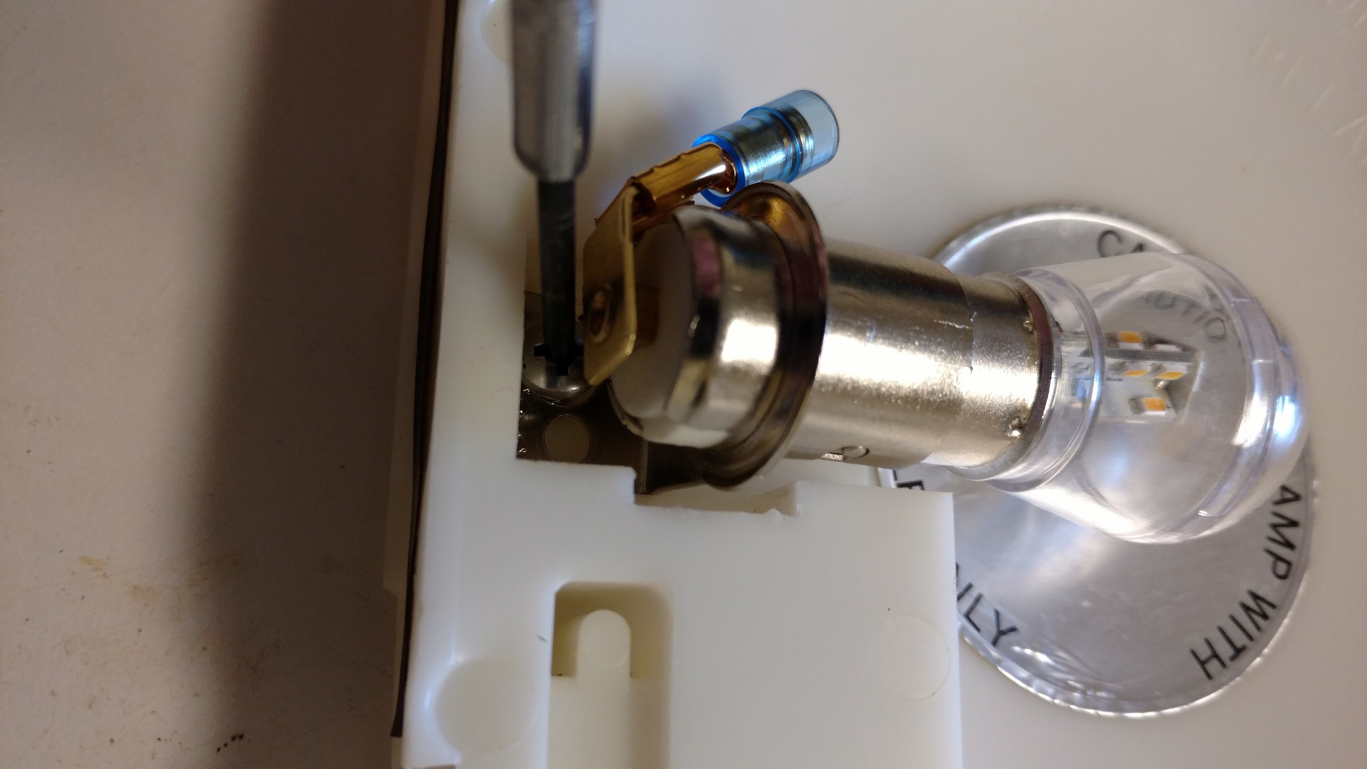

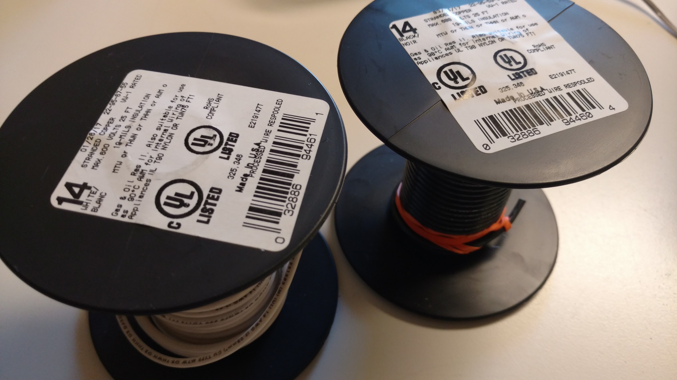

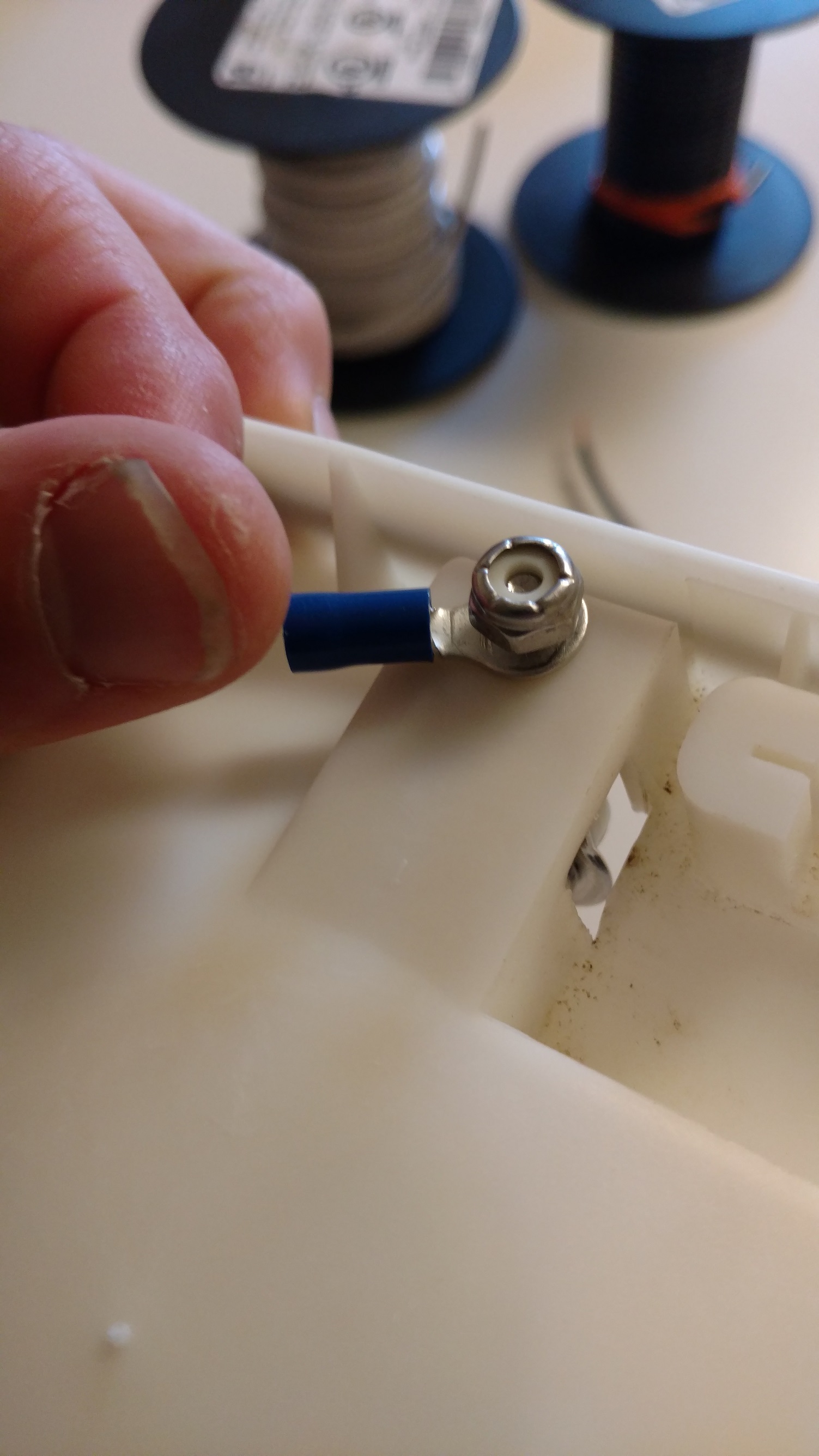

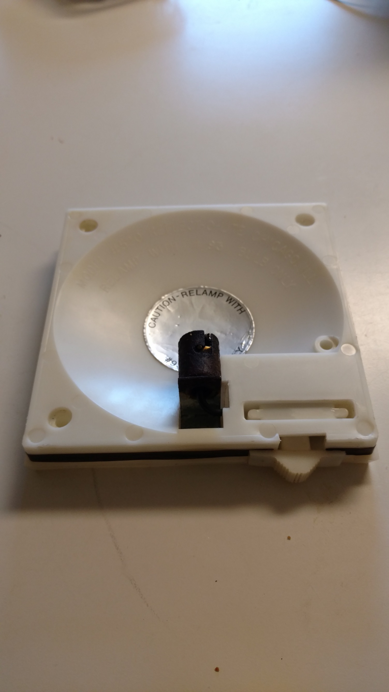

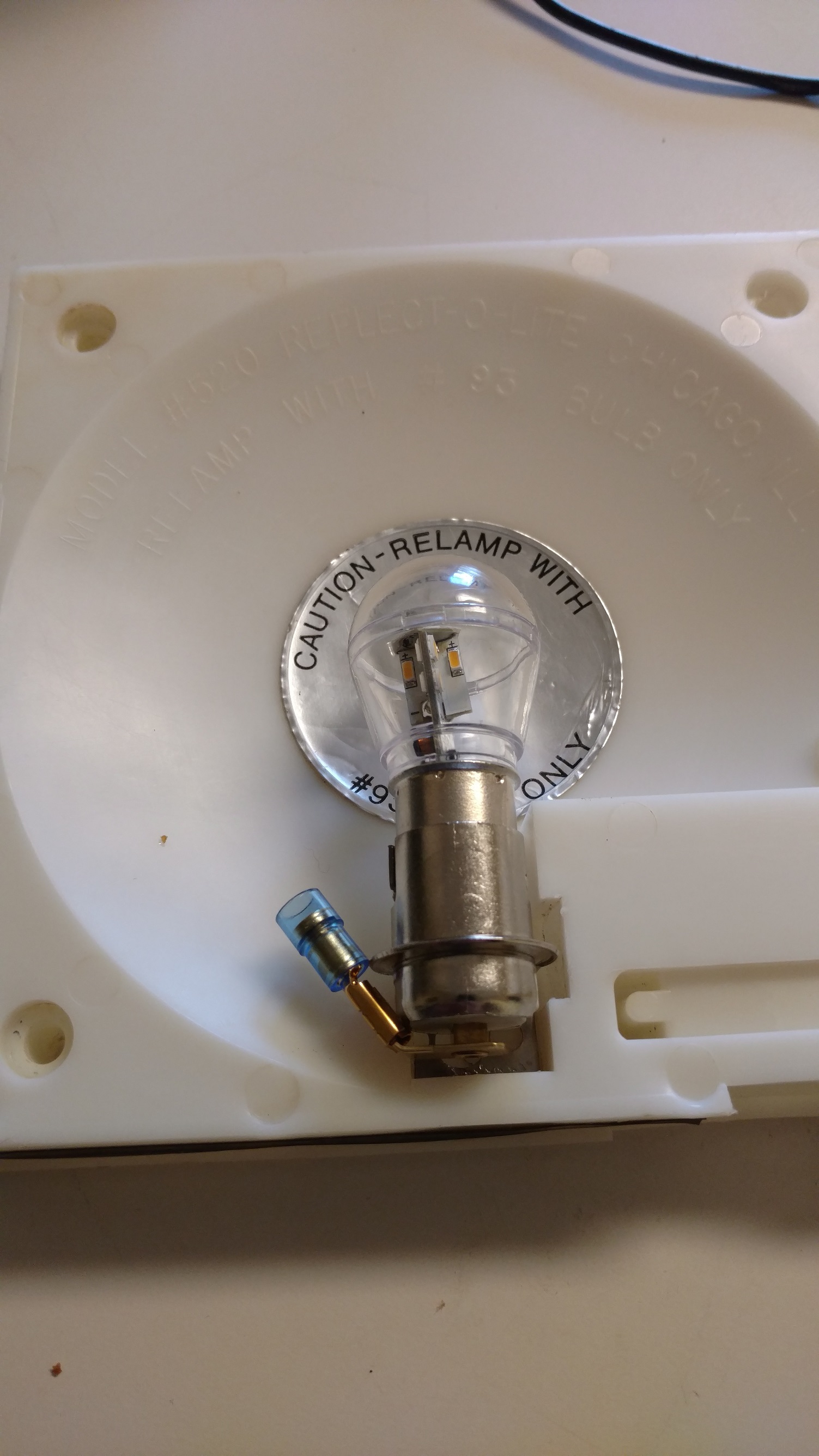

Once you have the base of the new socket to where it will fit in snugly into the plastic base, grab a 6-32 x 3/8 stainless steel machined screw to insert through the largest middle hole of the socket base. This almost perfectly matches up with the hole in the plastic base but may take some maneuvering and the use of a small philips screwdriver. Once the screw is through the hole, flip the light over and add a ring terminal sized 16-14 gauge since our wire is 14 gauge I believe. Top it off with a 6-32 nut. I used a nylon insert lock nut but feel free to use a regular nut if you want. Added the LED bulb to the socket to show how it will sit in the fixture. More pictures to come as soon as I get the new switches in from ebay so I can finish the conversion. Stay tuned!
