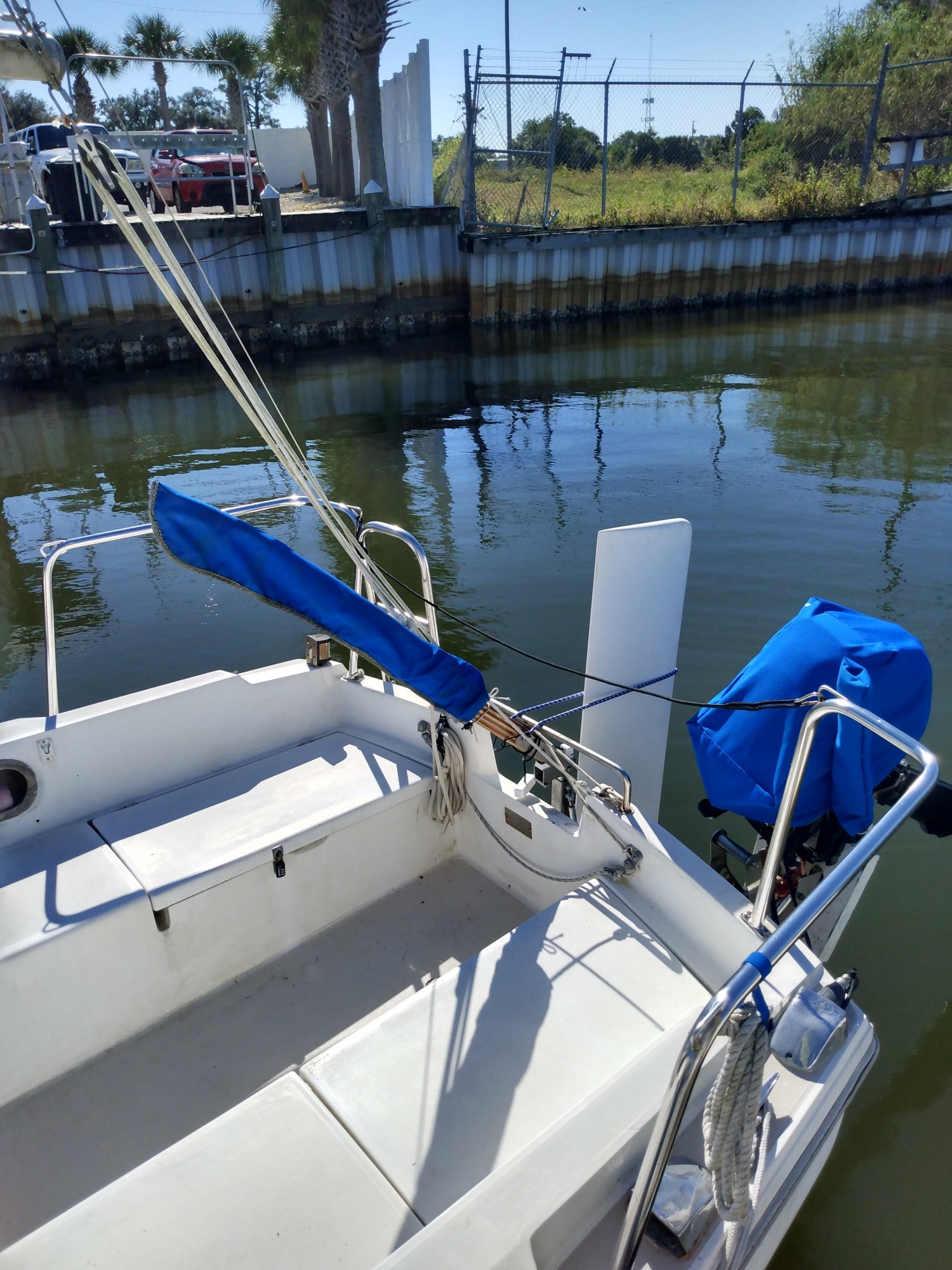

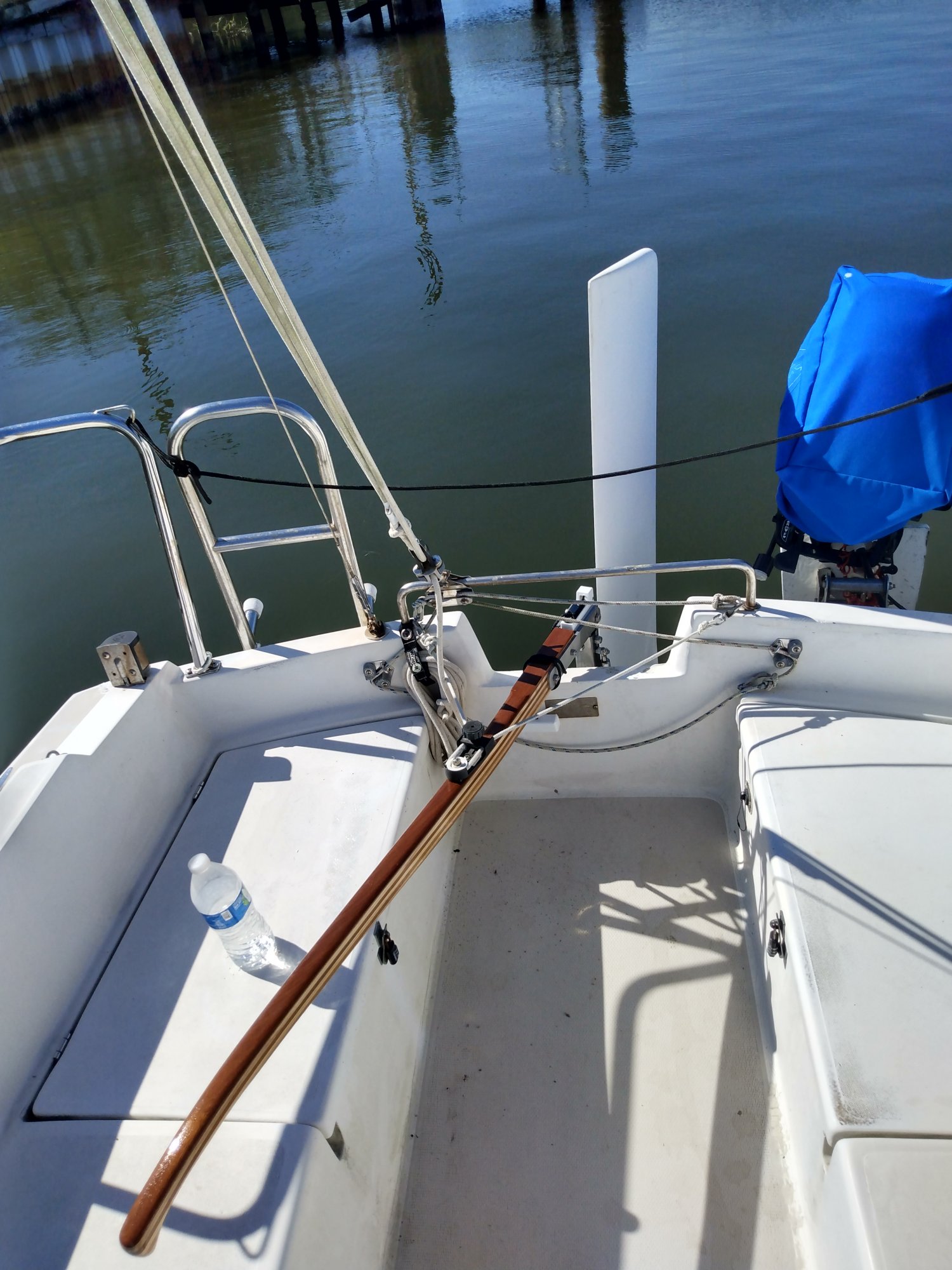

Success! Found the box with new rudder on porch (usual fedex/ups thing drop and run no notice) on October 8. Got back from out of town trip and installed the new one on Oct 15, it was all assembled by factory except for tiller hardware to rudder post part. Easy peasy to install, more work to take old one off and transfer davis tiller tamer to new one. Pix below of new in place and bonus of being able to lift the tiller and stow upright which old system did not allow.

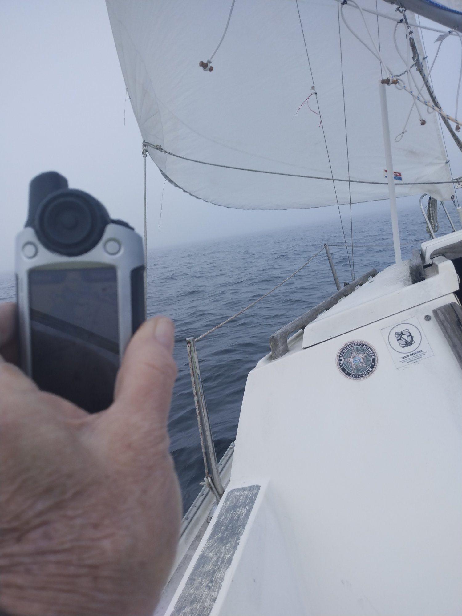

So finally got out on Jan 2nd, light winds and maybe chance of fog. Soooo about 1 hour in the fog rolled in whilst in the middle of pensacola bay, unable to see more than couple of hundred feet and blowing horn when i heard motor boats roaring thru the pea soup. Decided to head home under sail , nav lites on and using my hand held GPS. Since i am posting it worked! Pix for proof below. BTW new ruddercraft rudder works like a charm.

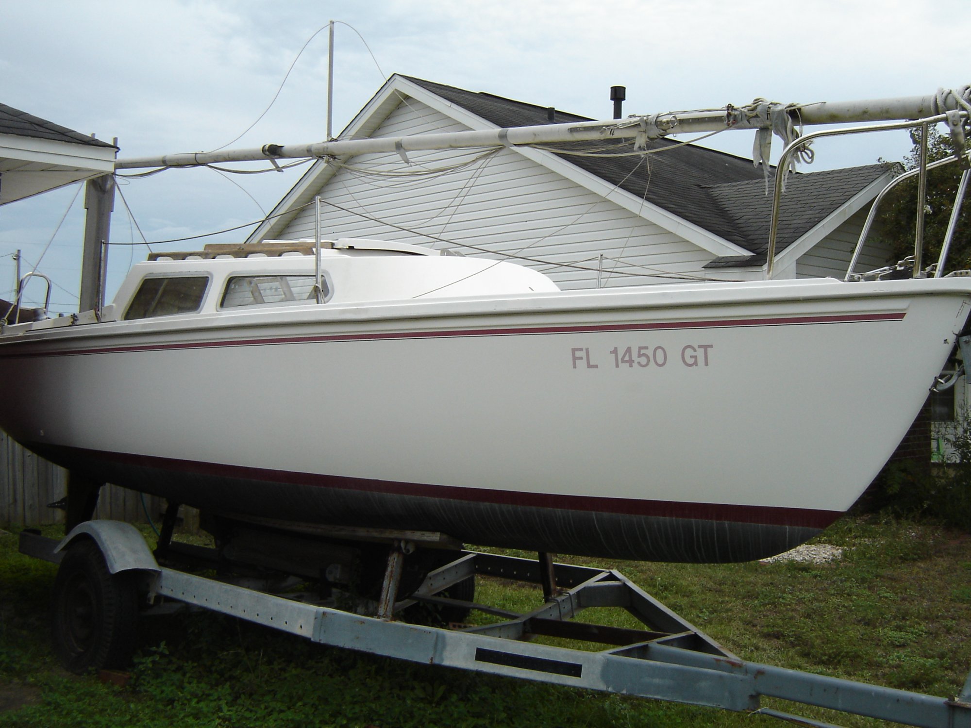

BTW I have kept the same thread going since 2016 to show all the things done to upgrade or repair old design Cat 22 circa 1983, instead of separate posts for each new idea. My spin off of cheap fixes for Cat 22 just has one shot pix or two of simple fixes. If you browse this thread you will find some in depth posts of steps with pix of major things like mast work, electrical upgrades, etc. If you find one you would like more info on I usually have extra pix and infor step by step like in the cabin cushion recover jobs etc. Just post your question and I put up more info and pix. Happy maintenance and more importantly more sailing and cruising. Pix is what I bought on a trailer years ago.

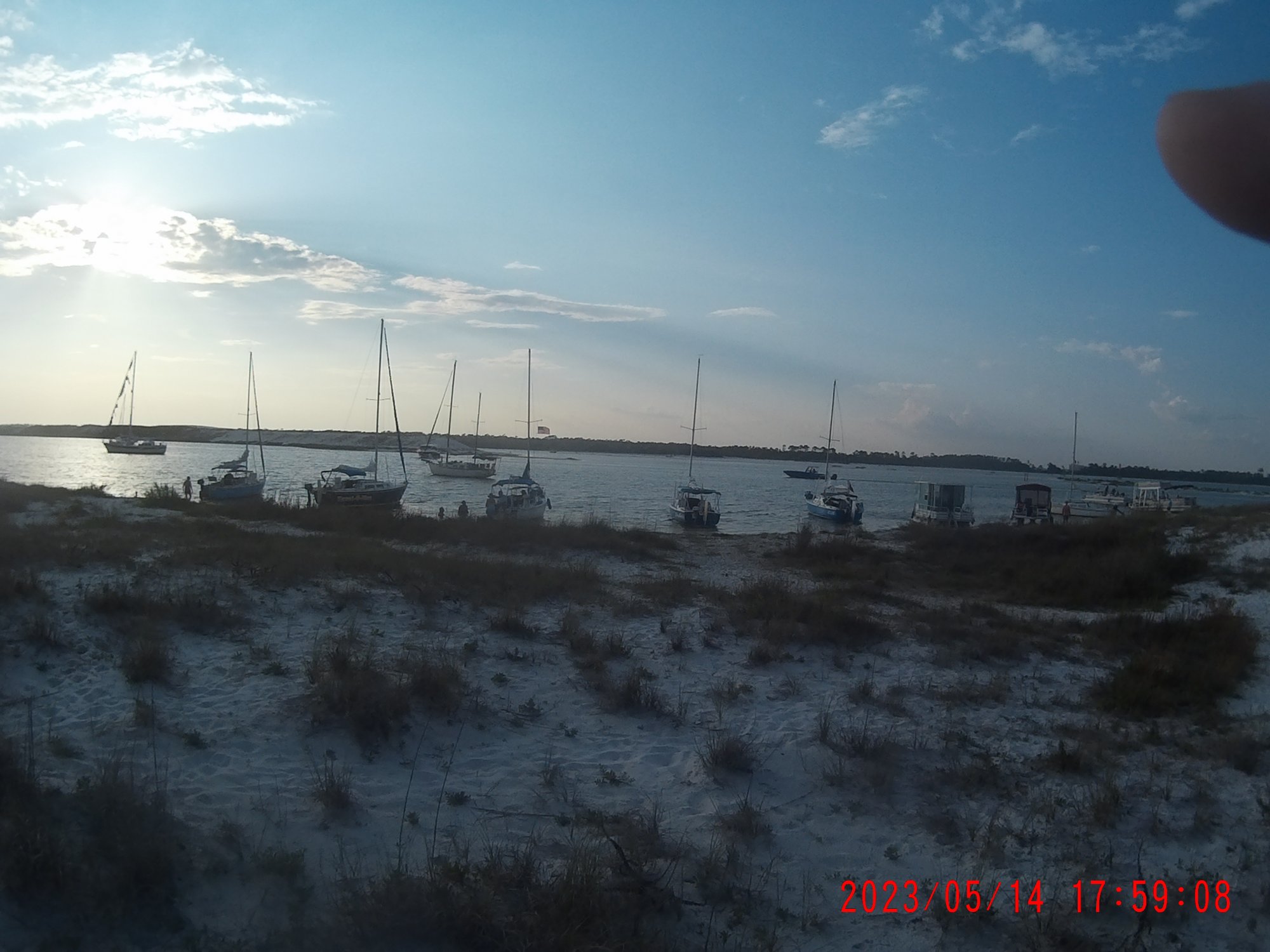

N Gulf Coast Cat 22 cruise , flotilla moored out at Ft. Macree lagoon less boats that earlier years but still cruising!
