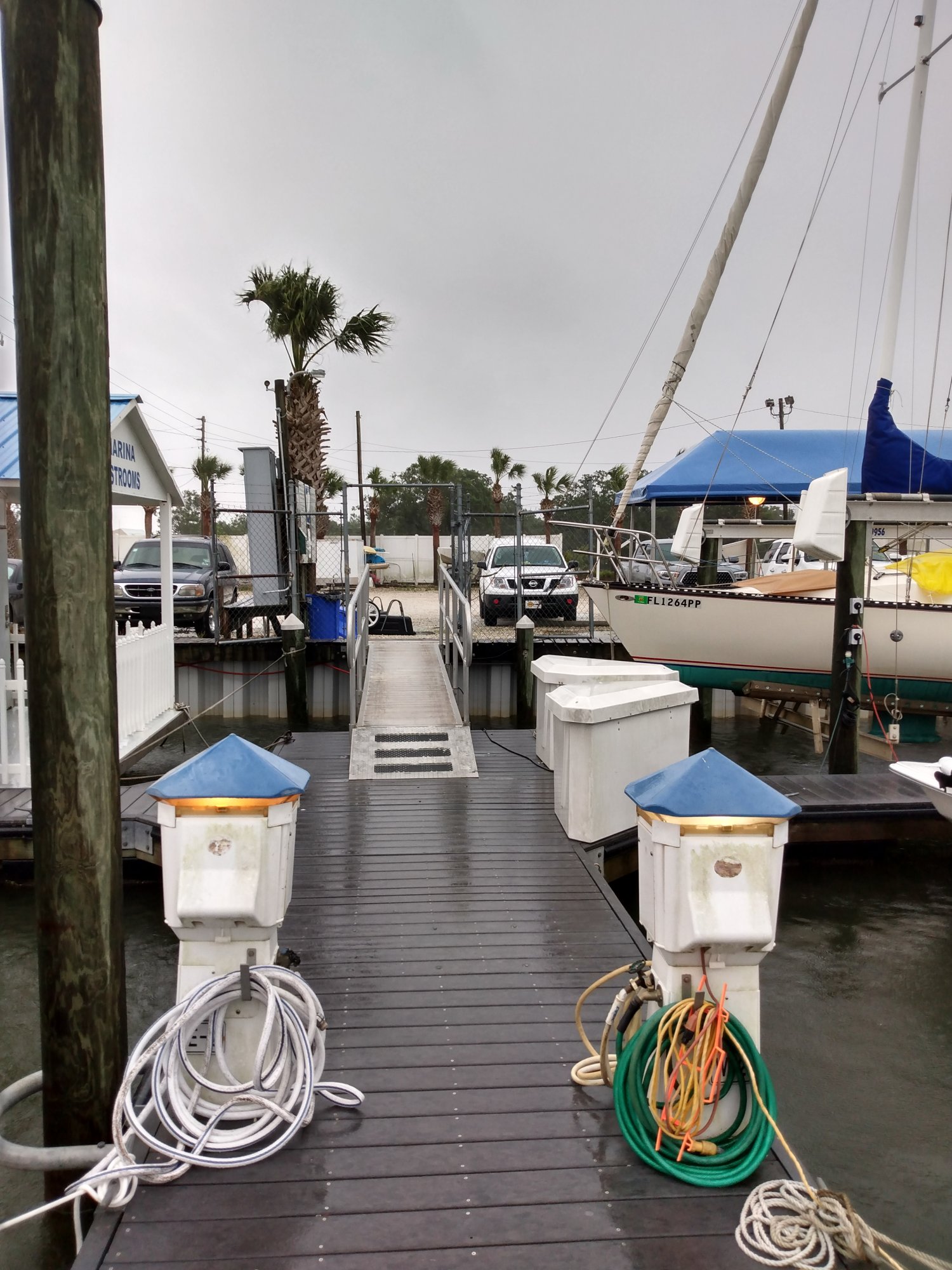

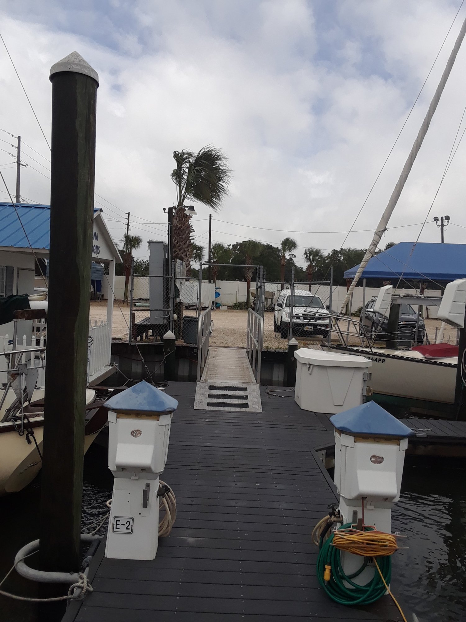

Yet another tropical storm , Cristobal comes by and dock ramp goes level from about 3 foot surge (day before storm even well into gulf) Another reason why everyone needs to be careful when large storm gets in small gulf of mexico bathtub. Do not be fooled by the tiny swirly graphic on the tracking maps look as the actual radar pix.

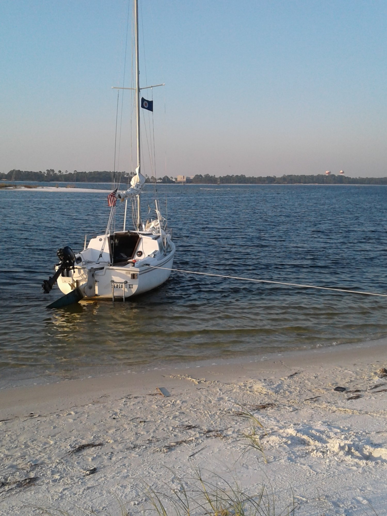

Here is a local trend by Catalina 22s, Mediterranean mooring at Ft Mcree or any shallow beach area. Bow anchor let out til close to shore with swing keel up and tilt up rudder up til your swim ladder gets close to shore, then line to shore with lunch hook or to a bush. Get to step right down to bottom in knee deep water right to shore and back. No wearing out arms with a dinghy ride.

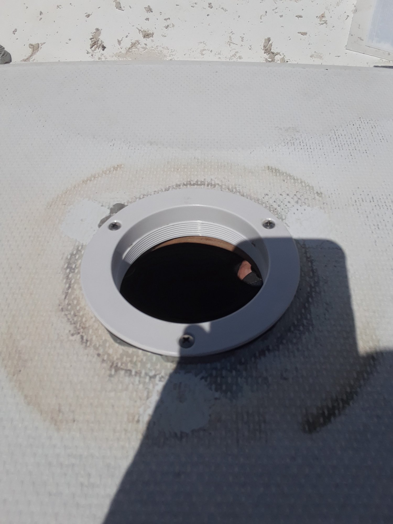

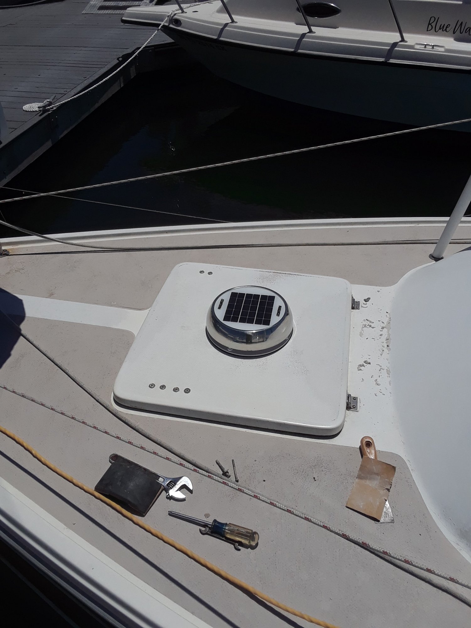

Weather heating up so bit the bullet and installed a replacement nicro solar powered vent , old one motor gave up ghost, new one required removing the old base plate and putting in new one. The vent now screws down into a threaded base plate instead of a slip in plate. Oh well, at least mounting screw holes in old plate matched new ones so just bedded in new plate with butyl and put old bolts back in. Pictures attached of course as usual it looks easier than it actually was to to do.

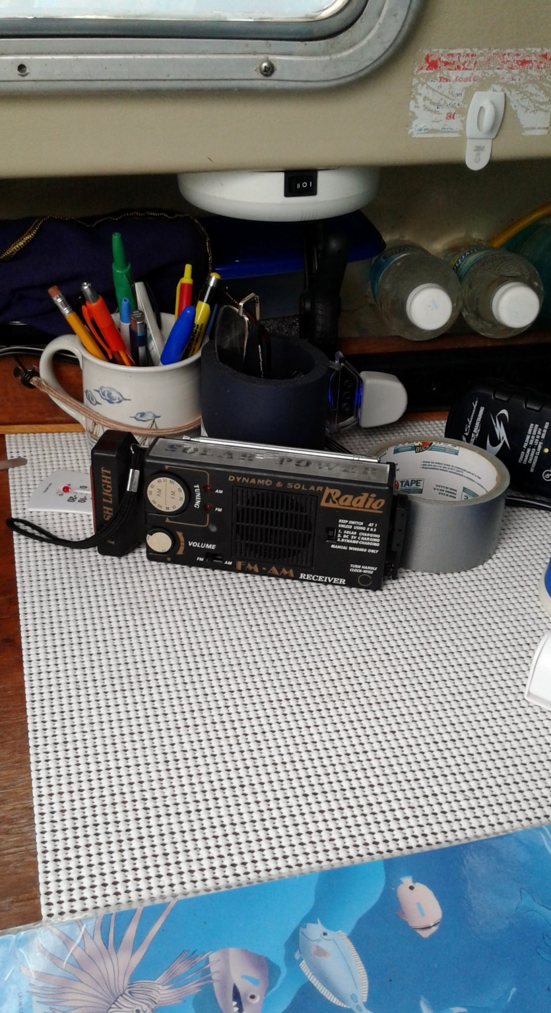

A cheap trick to keep things from sliding around on the dinette while sailing. It is the perforated foam they sell in a roll at Walmart, things stay on it under some rather tilted conditions I tell you from experience. And is easy to remove, move around and adjust. Cheap and easy to change out if it gets dirty.

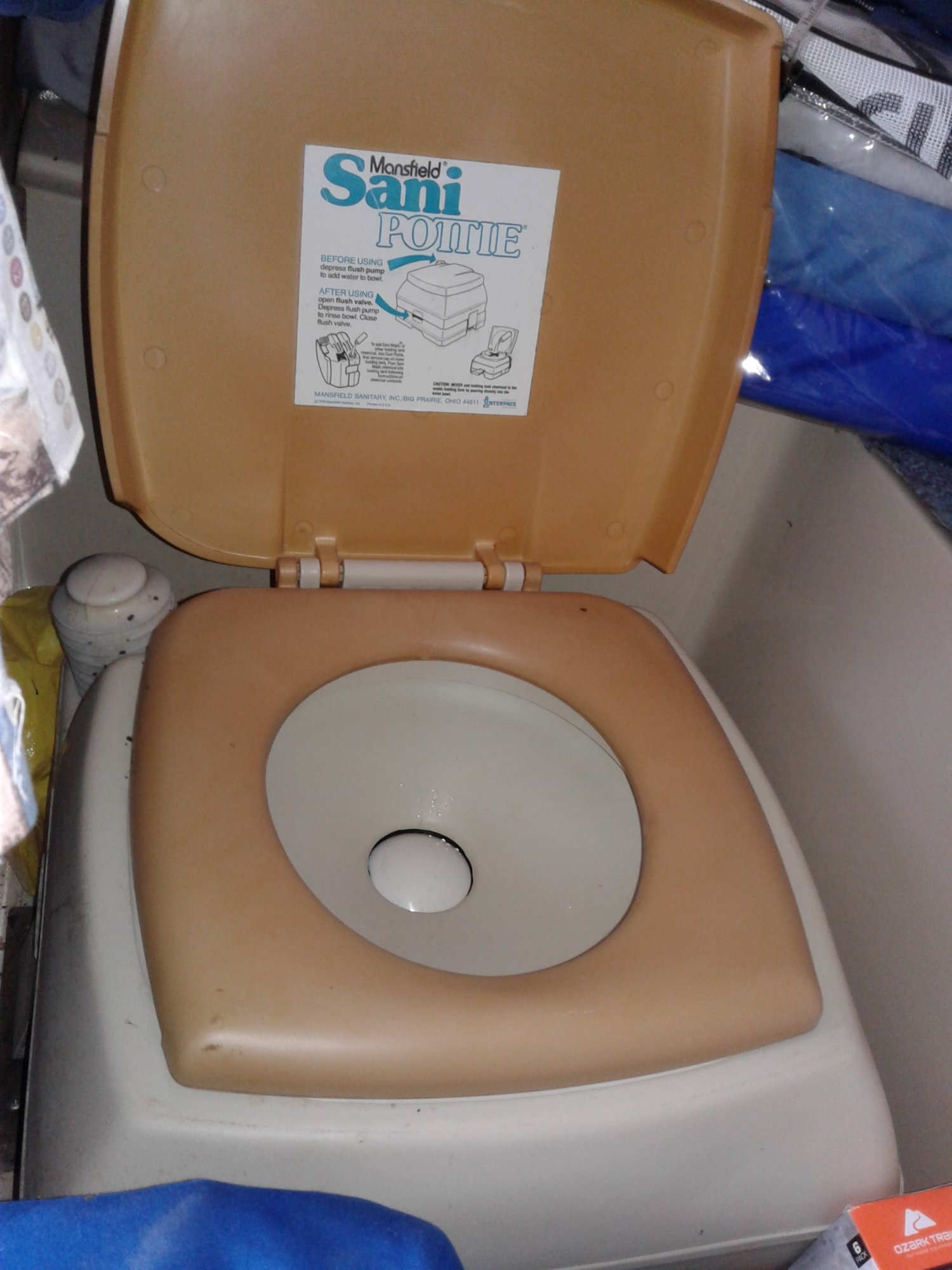

Decided to use the down time from sailing due to foul weather, to open up the porta potty and wipe it down. check the water level and make sure the pump works. Original equipment as far as I know and still works fine. 20180330_144501.jpg

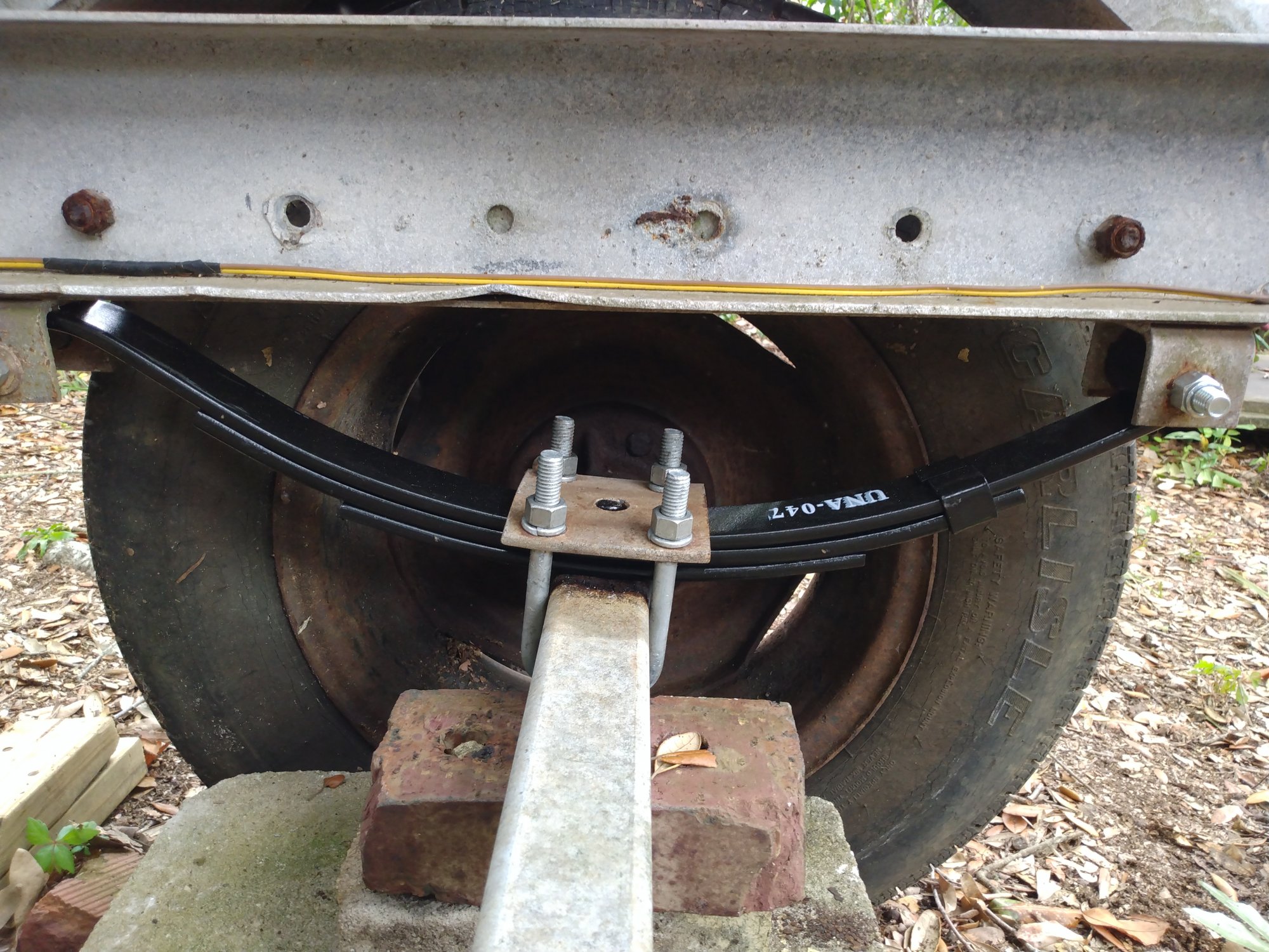

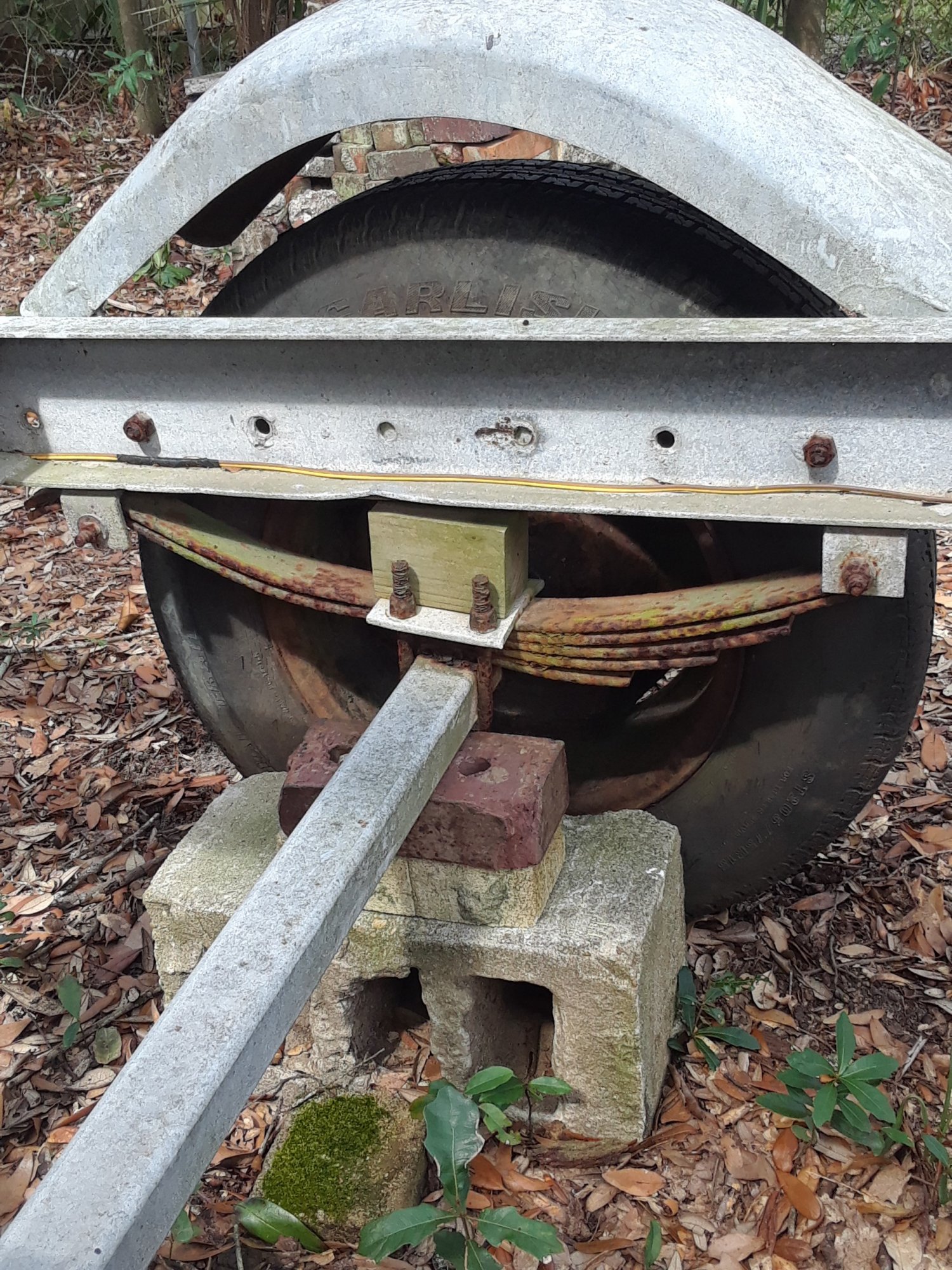

Trailer work part II

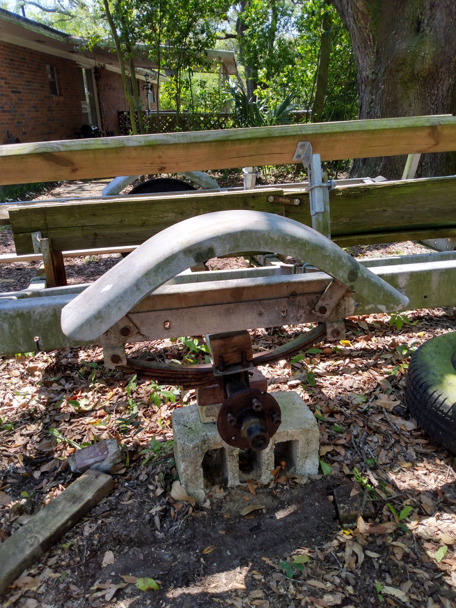

Around April looked at trailer for upcoming hurricane season and noted the leaf springs were very rusty and some even broken and PO has put a wood block in to keep some separation from frame to axle. Sooo I took one side off and took it to Hitch shop locally, nothing in stock suitable for 2490 lb boat and trailer Unk wt. but needed a good 1500 spring load for each wheel. Now we wait only available replacements 3 leaf instead of 5 are from China, Supply line problems but finally 6 weeks later they come in. So with new hardware and springs installed the new leaf springs quite easily and before and after shown below. Now can work on bearings!!

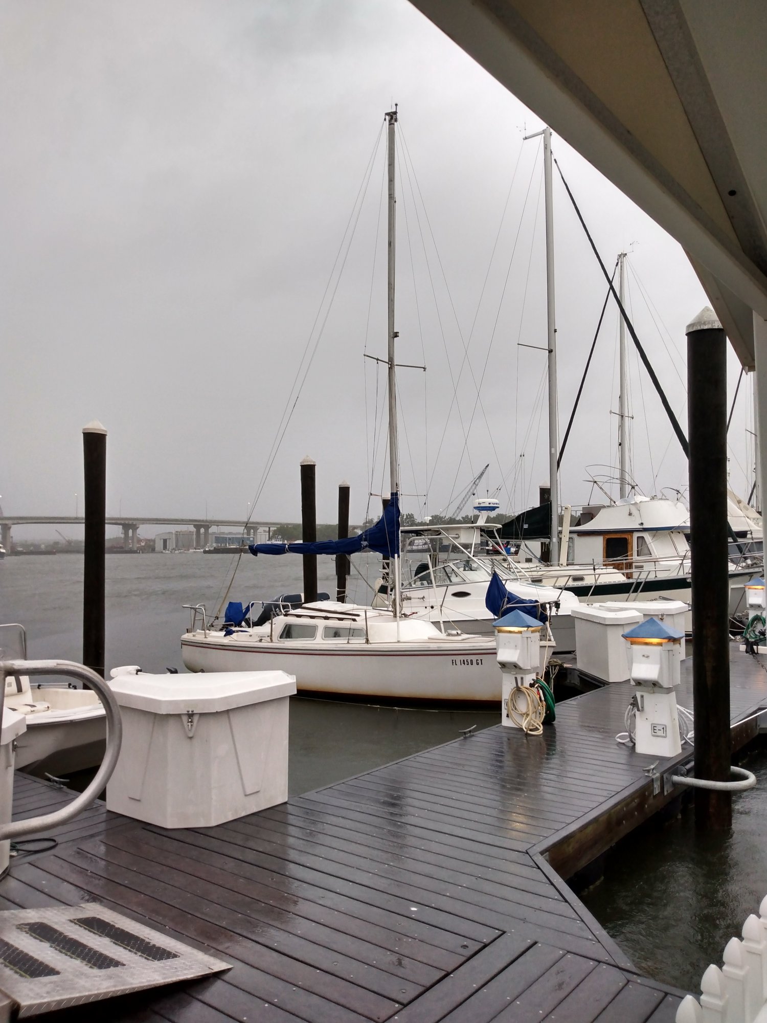

Tropical storm Claudette, prep of boat for wind and surge, and shot of ramp almost level so about 2-3 foot of surge occurred by saturday the 19th about noon or so.
