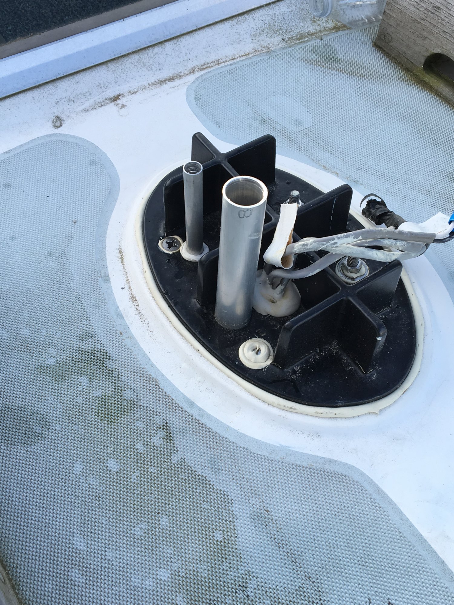

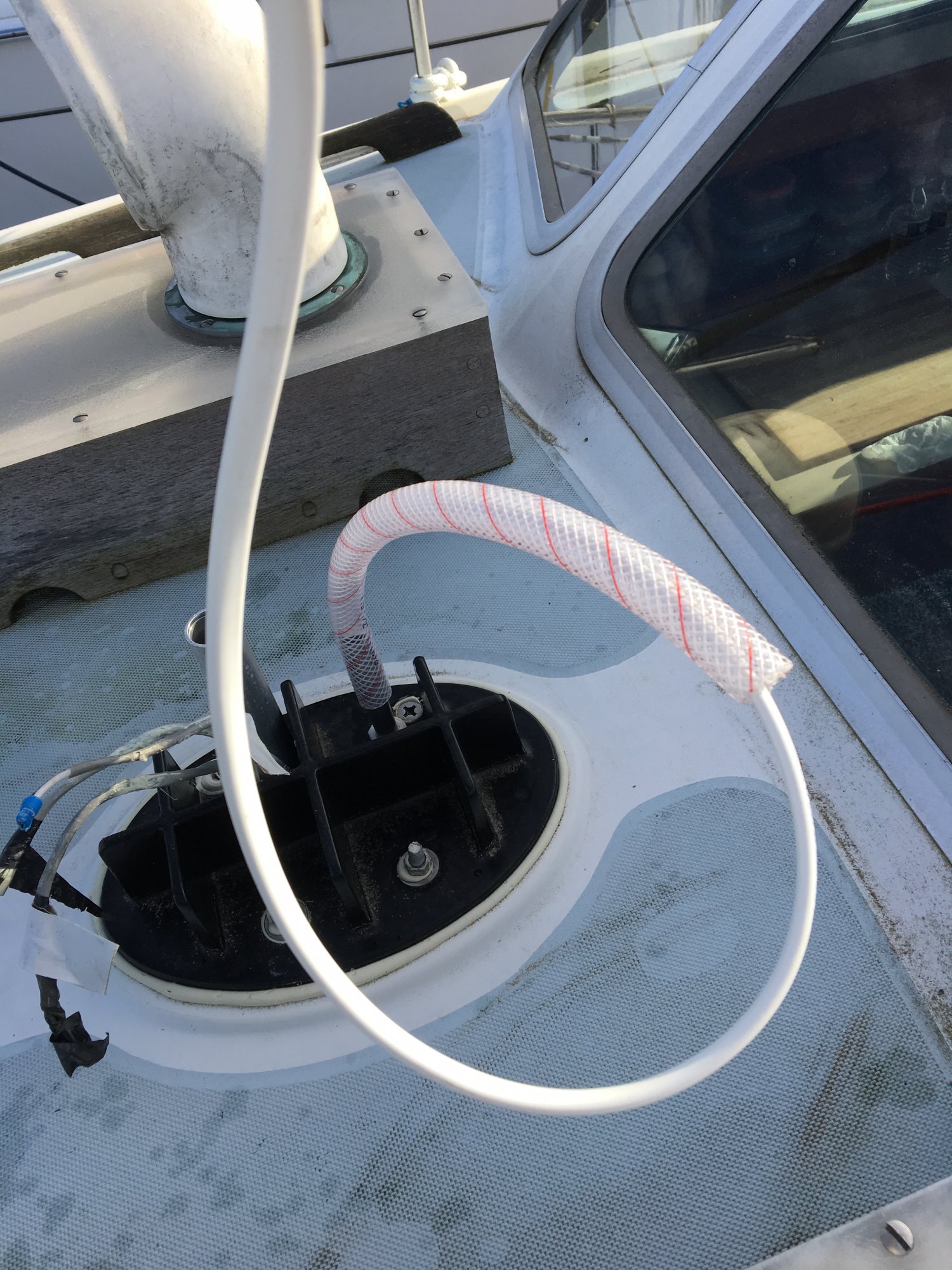

I ran my VHF coax and Radar cables down thru the mast. Clipped the old wires shown in the image. Drilled a hole through the mast step. Prepared a raised tube to stop water from flowing down into the cabin. Opened up the weep holes at the mast base.
Used a piece of hose attached to the pipes to form drip loop.

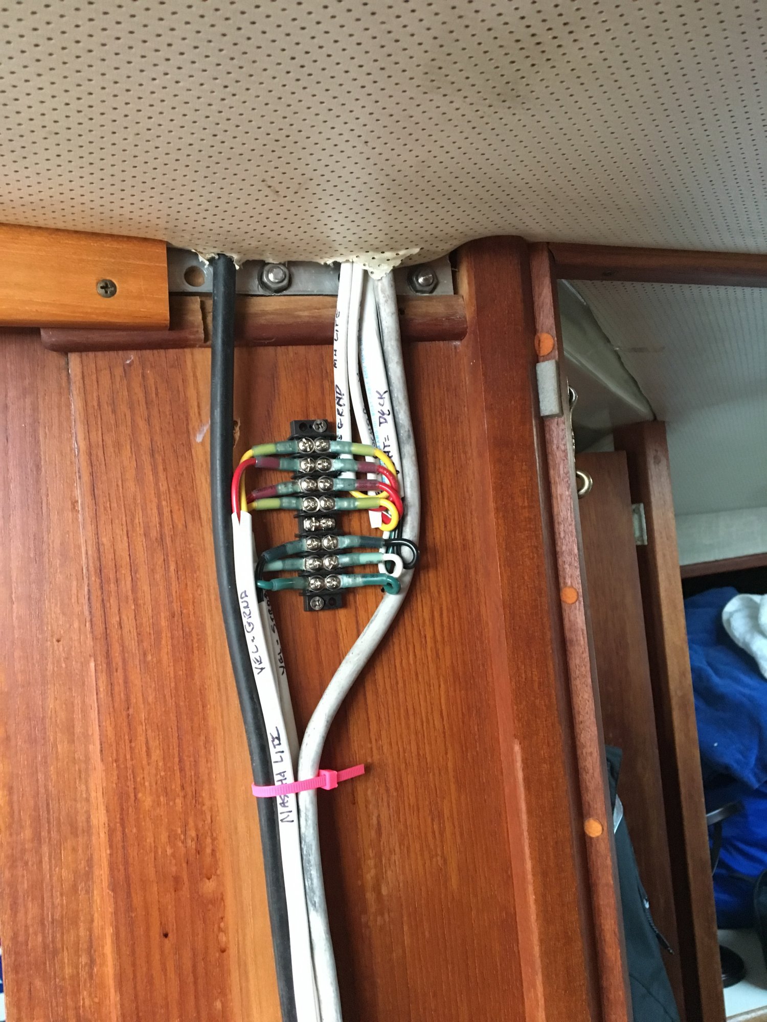

The electrical are ready to be released at the mast base from inside the cabin.
The Radar and VHF cables are released at their displays and then pulled up through the mast base as the mast is removed. This means no connections and reduced signal loss.
I do not expect to remove the mast again, but capable if needed.
