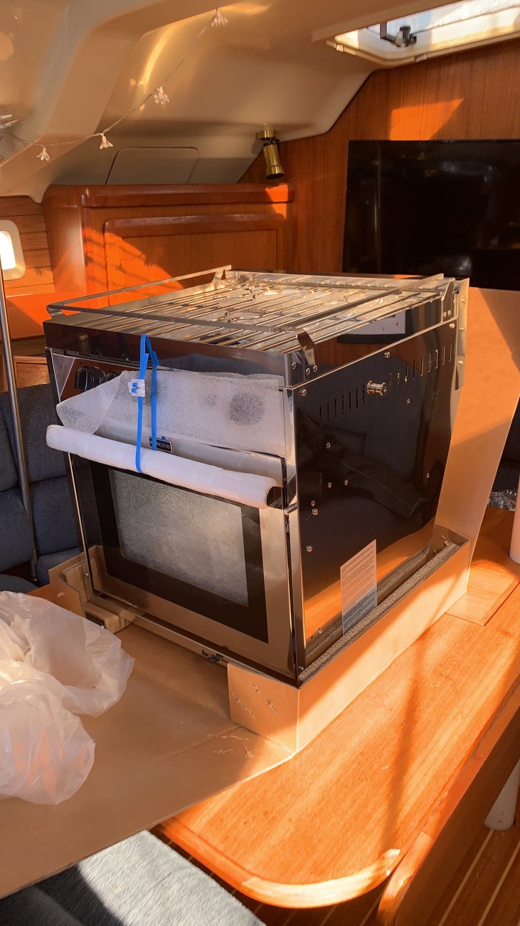

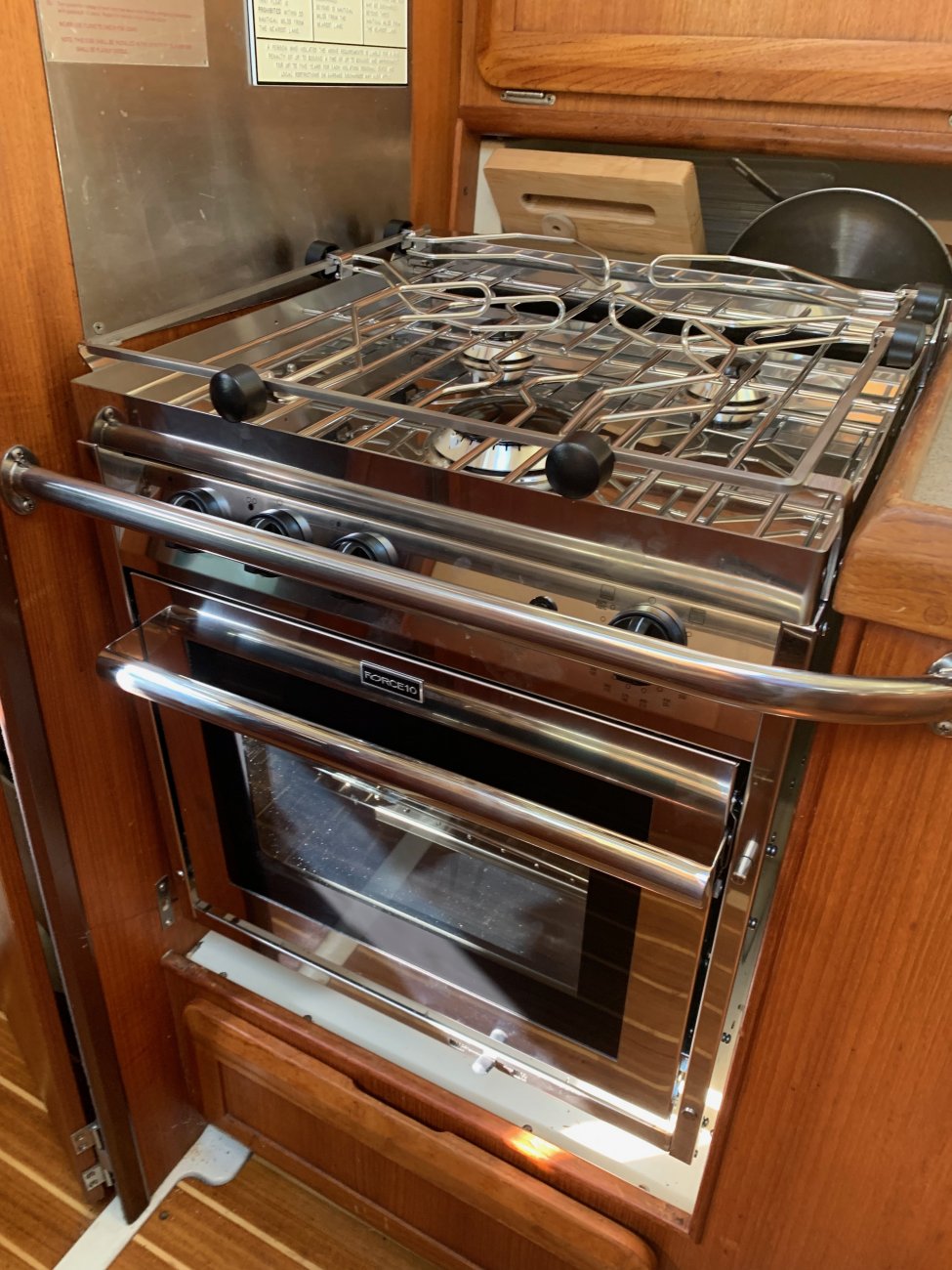

I converted from CNG to LPG as it became very difficult to refill tanks, and almost impossible when cruising away from home. I chose to upgrade the stove as well, but you may be able to get by changing the burners. New stoves have thermal sensors to shut off gas if the flame goes out. I found this to be worth it as we cook regularly on board.

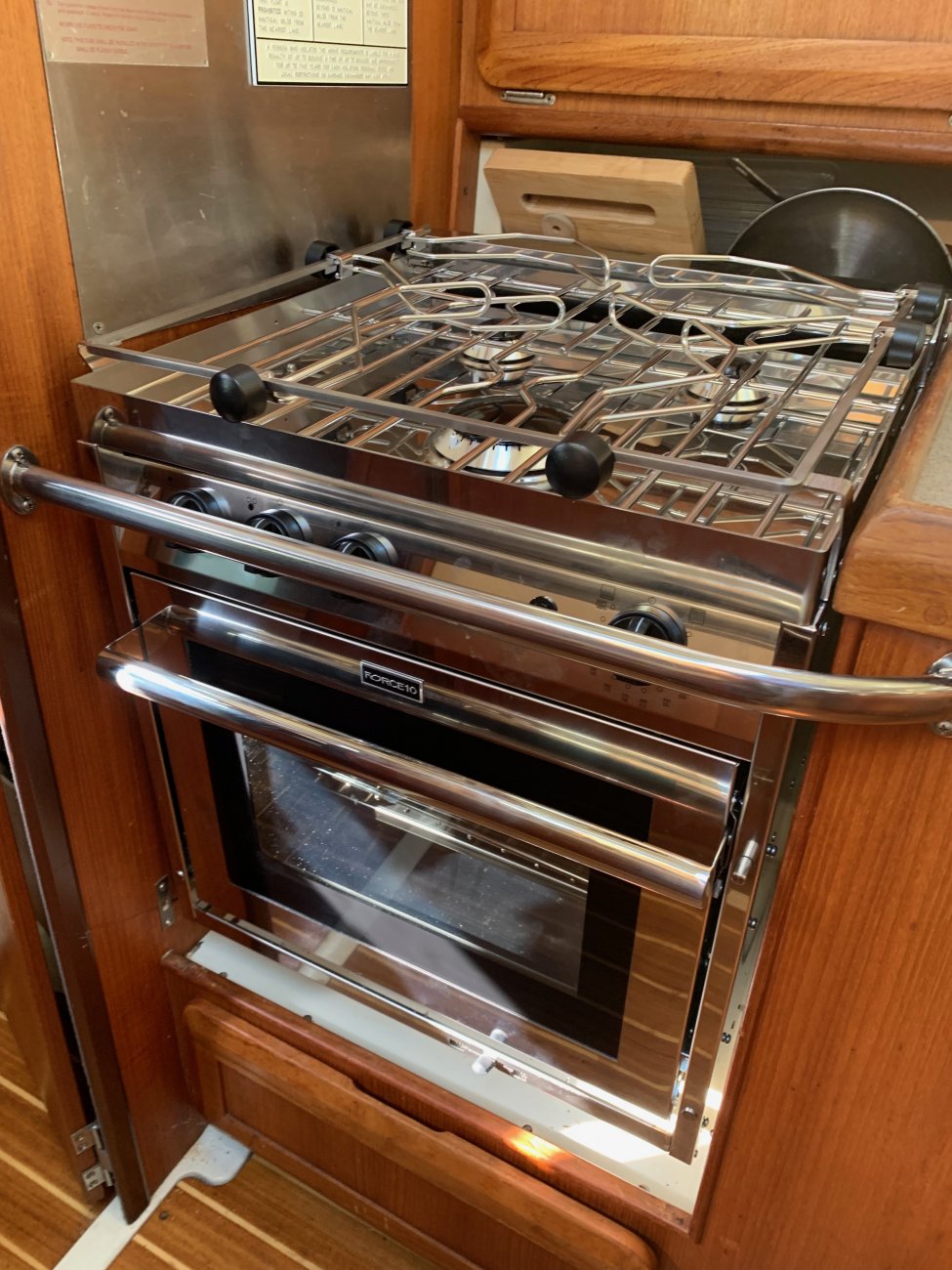

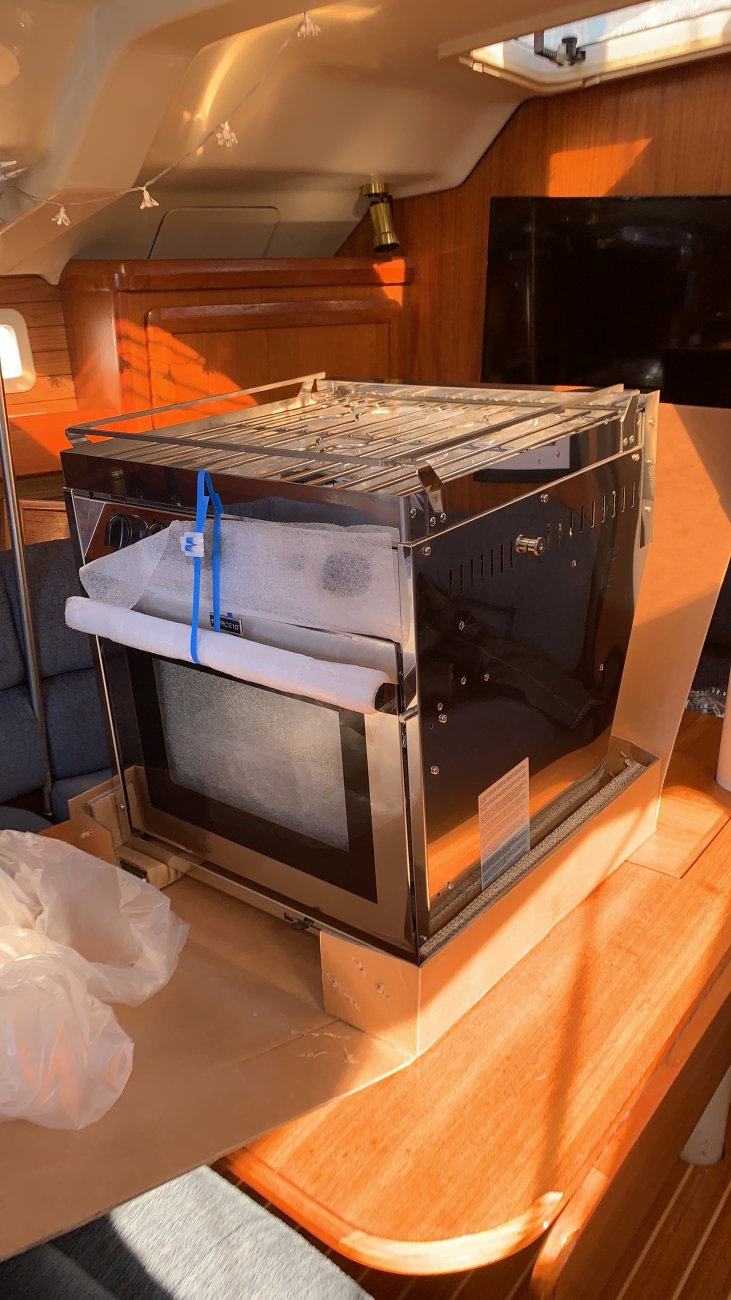

The stove is North American Standard Force 10 3 burners. It drops right into place. It's a perfect swap fit with the original stove and quite an upgrade. (See photos and link)

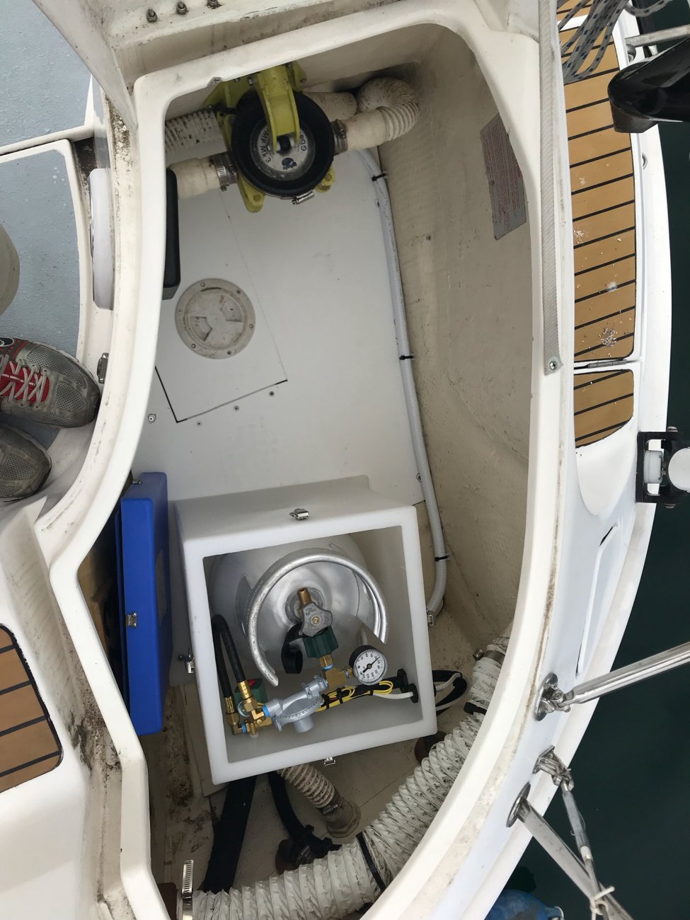

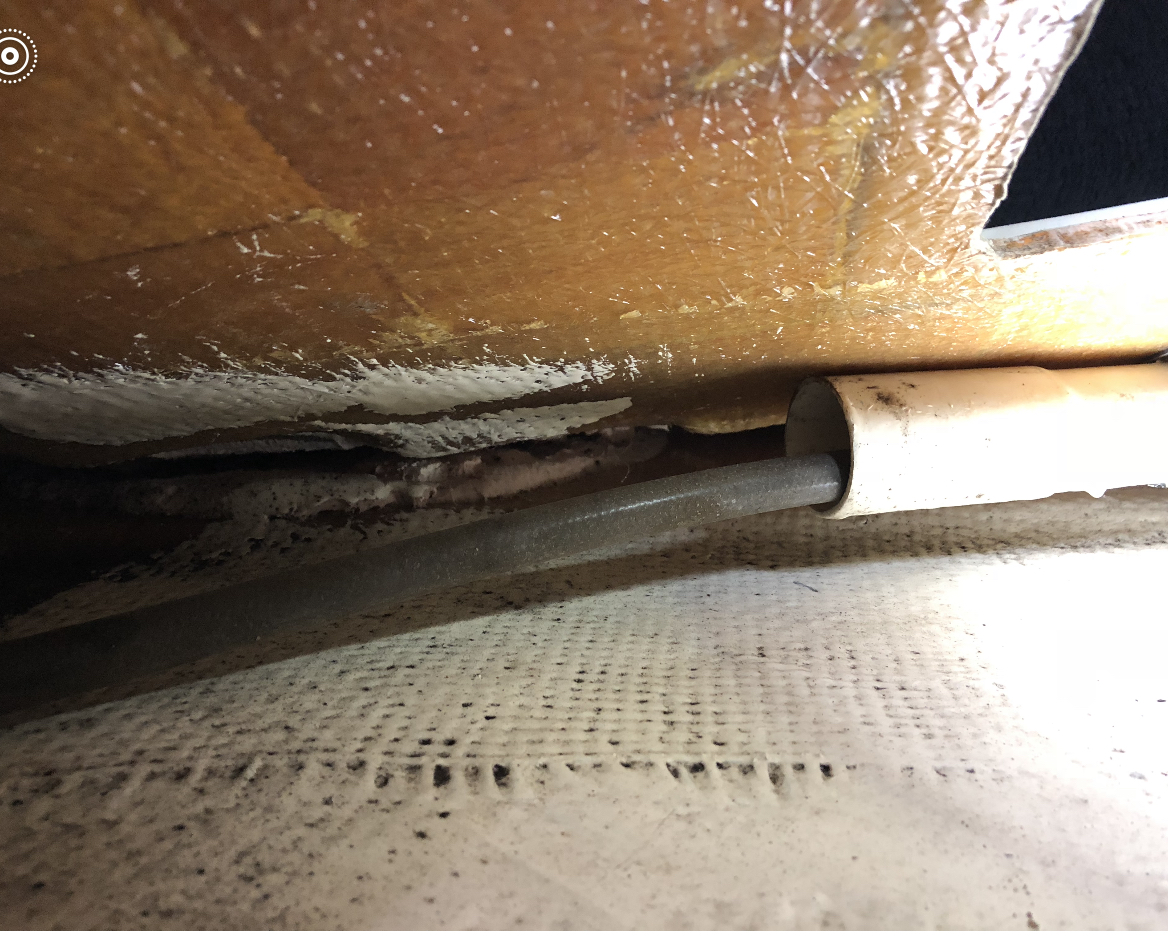

The grey gas hose runs to the middle of the transom, then under the port side of the bed in a white conduit and through the locker to the galley (see photo, took a little bit to find it).

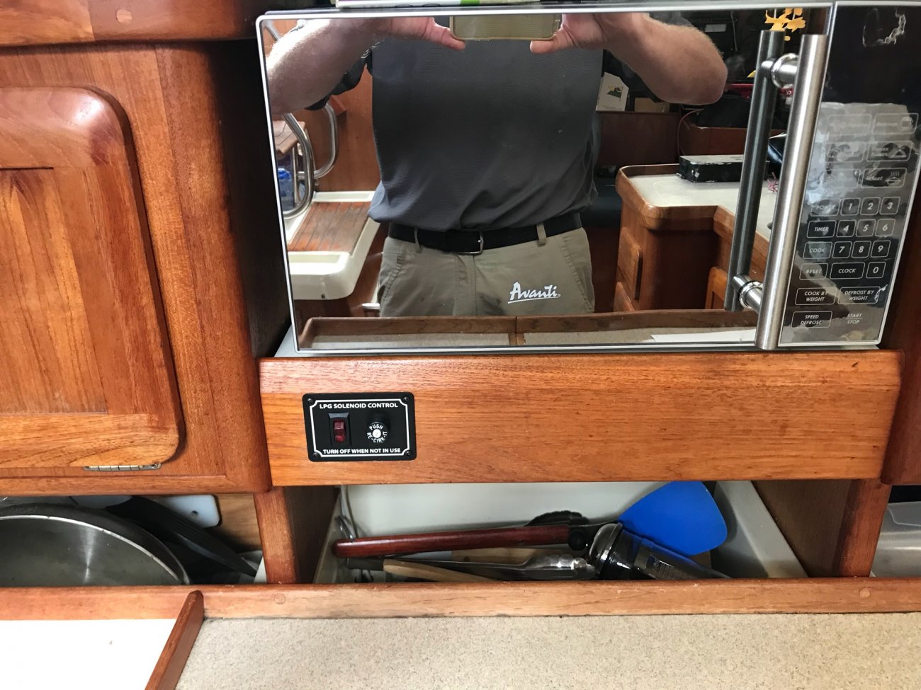

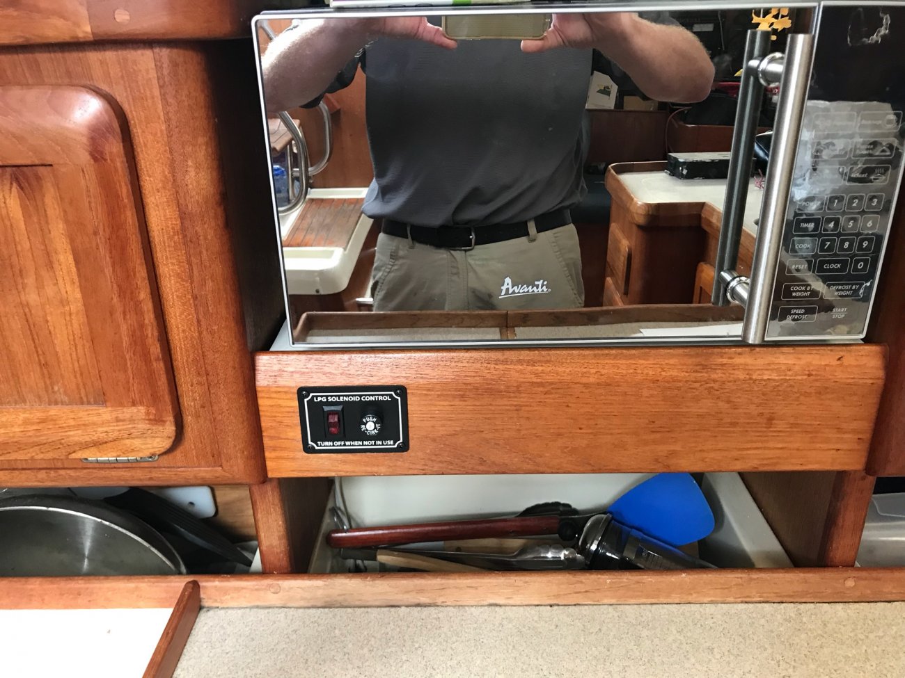

The switch for the solenoid is installed on top of the stove with the 12v wire running under the floor boards, and directly connected to a spare breaker. It is clearly visible. Can't miss it. It's two steps to turn it on 1. breaker on panel 2. switch above stove. (see photo)

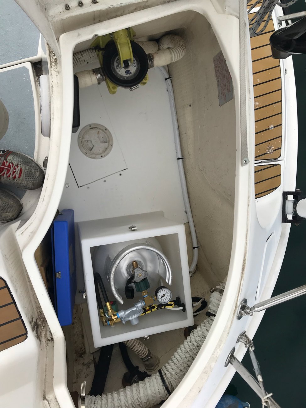

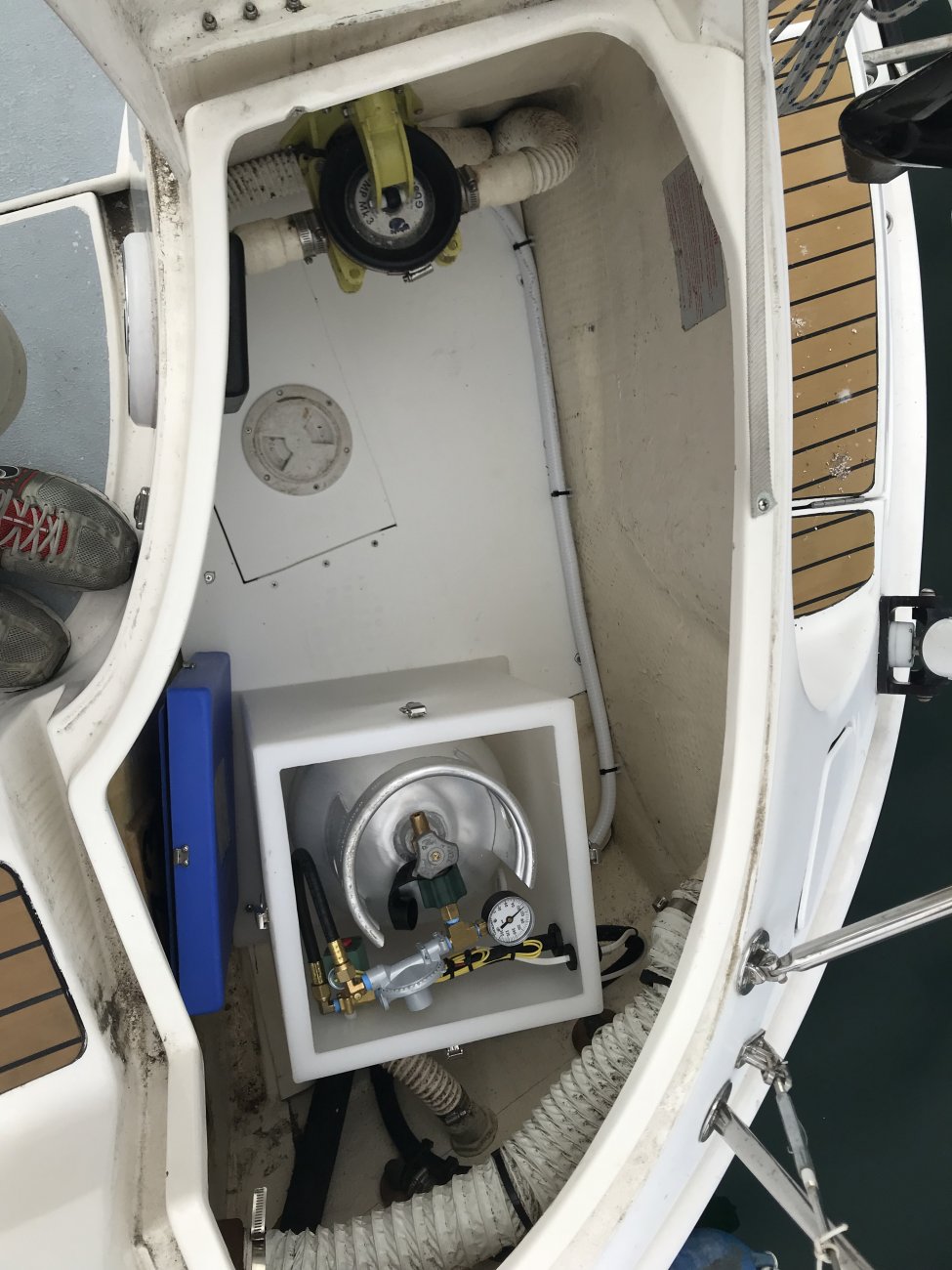

The tank is Worthington 10 lbs aluminum that won't rust. A bit pricey but worry-free. (see link and photo)

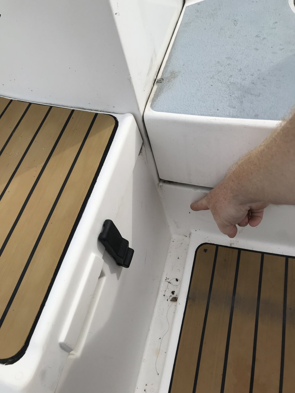

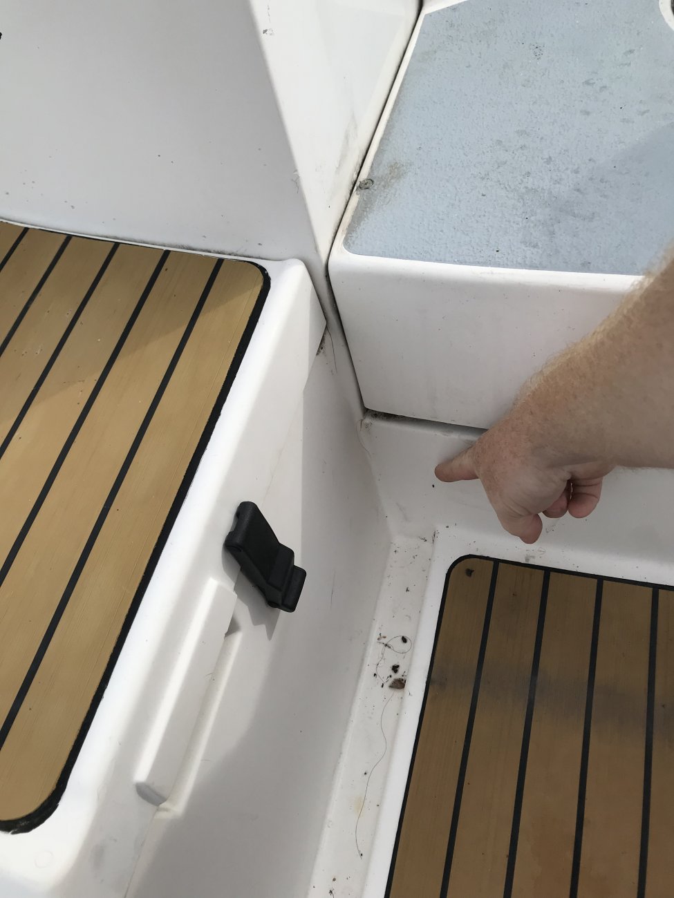

The propane locker is here. It comes with the regulator and tank (if they have it is stock, otherwise it can be ordered separately as it was in my case in the interest of time). The tank is vented on the transom in the center of the boat. 40.5s have a tendency to heel, and placing on the side would make it susceptible to flooding.. (see photo point to location before the drill). Even then, it is installed with syphon loop to prevent water in case of high following seas or of a wave breaking on the transom.
