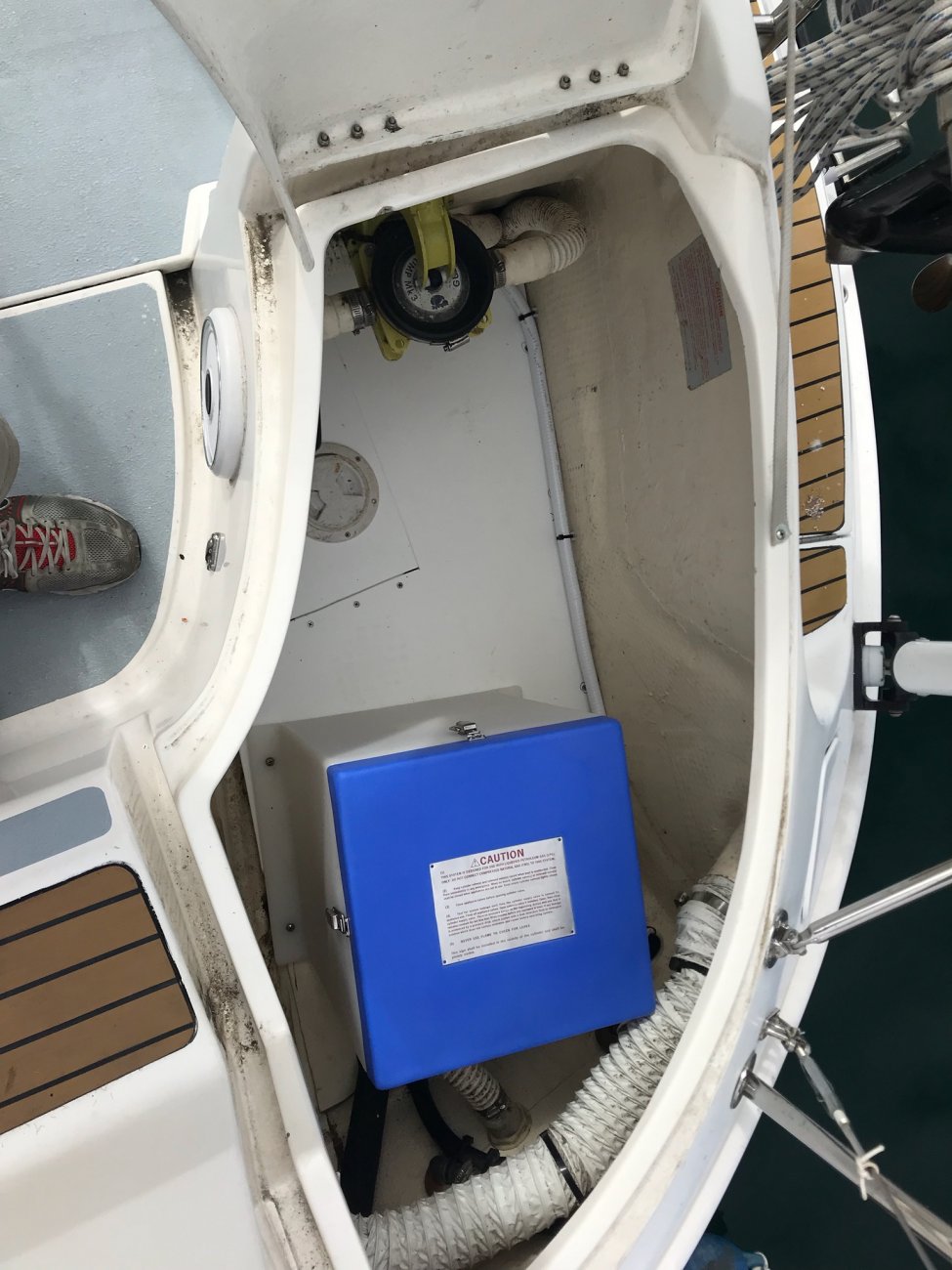

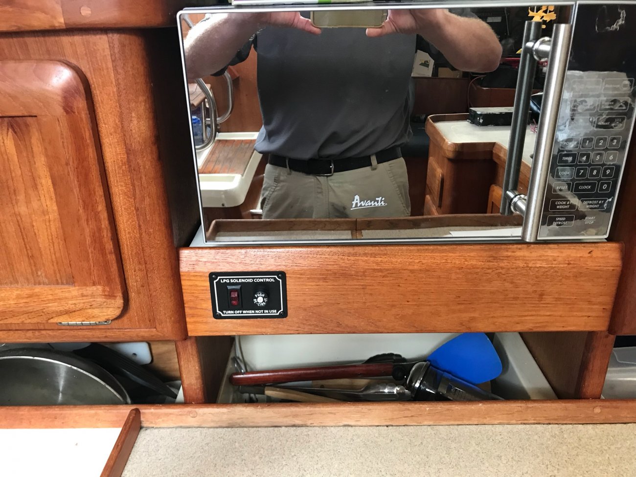

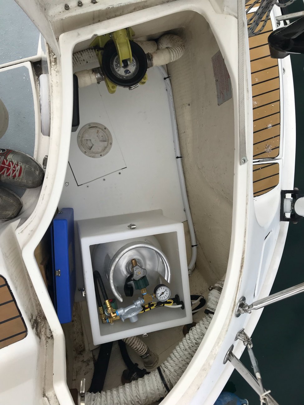

Here are few pics for the upgrade (Stove coming soon)

Where did you purchase the propane locker and what size is the propane tank?
Did the stove and oven fit in the original spot with no modification? What model?
Where did you install the propane detector and shutoff?

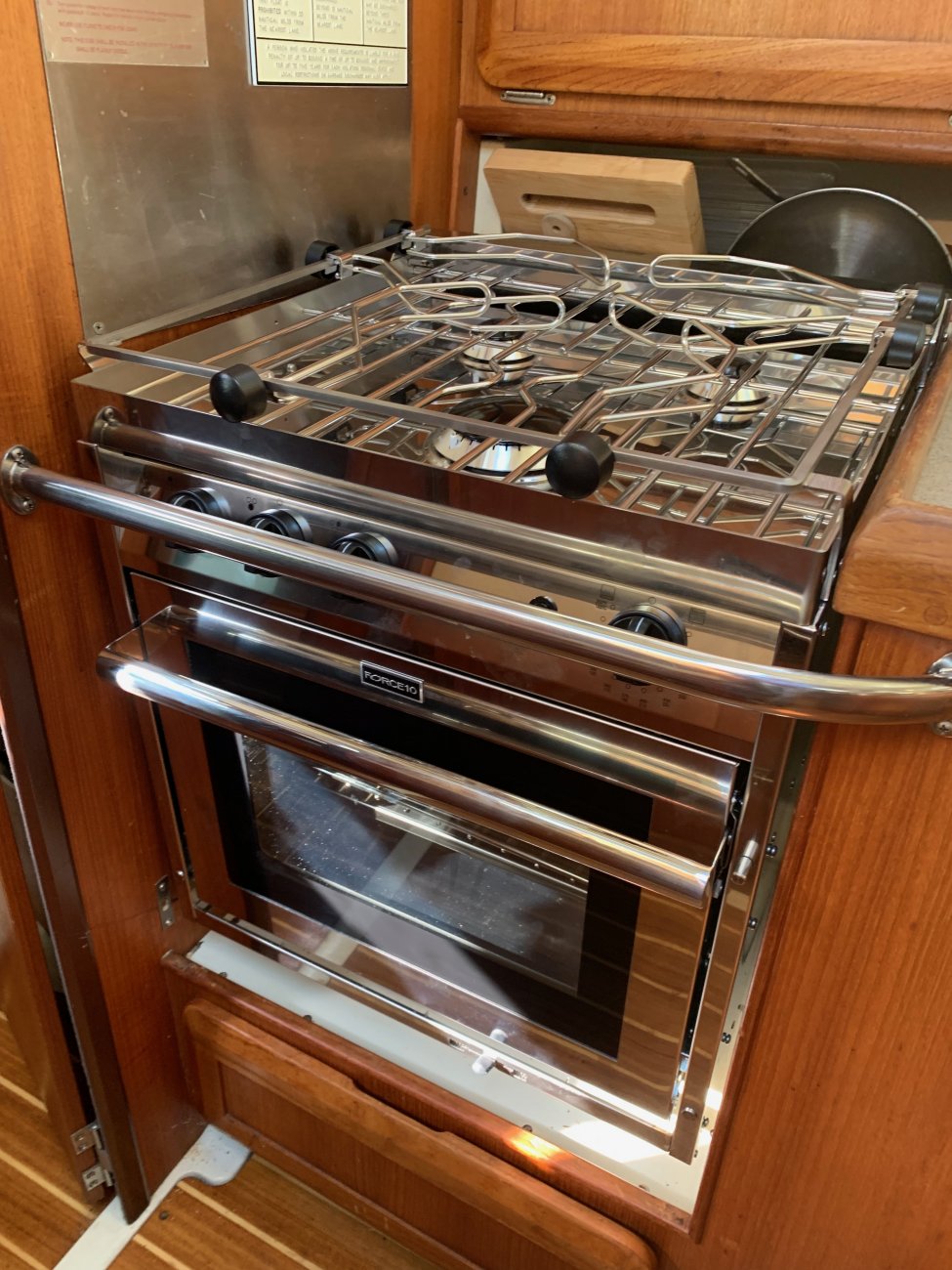

Yes got all for suremarine. Also they were competitive on price with fisheries (my usual go-to with defender). This is what sure marine specialize in. Btw baked two pizza with the new stove this weekend. Very happy with the set-up. Here a pic of the stove (force10 3 burners)

All done with the conversion. Here's the pic of the new stove. Baked two pizzas (at once!) this weekend to feed a hungry crew. Very happy with the set-up. All parts came from SureMarine in Seattle, except for tank that comes from West Marine (only ones who had it in stock) Sure Marine specializes in gas/stove etc and had most parts handy-- and were competitive with my usual go-to stores (fisheries and defender). Needless to say that I am thrilled that I can get gas around pretty anywhere I want now

Mistralseattle, Thanks, is there a specific "conversion kit" for the propane locker that you used? Do you happen to have the model/part number or do I just go to Sure Marine and tell them I have a Hunter 40.5 and they take it from there.
Were you able to use the existing overboard vent that is installed for the CNG on the Hunter 40.5. It seems a little to high to allow a constant downward vent path for the LPG?
