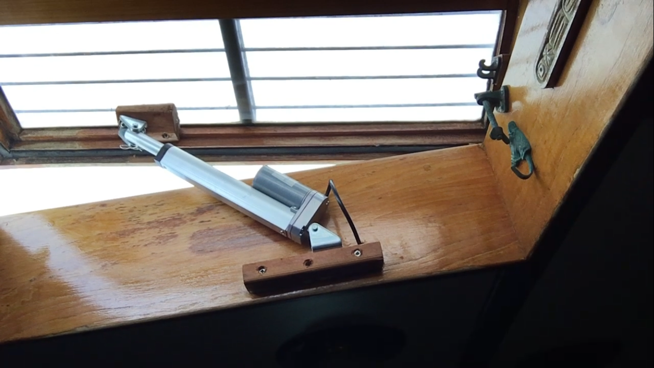

What I would really like to find is some sort of relatively inexpensive way to adjust the panel angle up and down via some device, perhaps 12v powered. As an idea, greenhouses typically have ceiling vents/hatches/(whatever) that have powered hinge-like gizmos to help maintain temperature or humidity.
John, I just this week installed this Firgelli Automations linear actuator to open our galley hatch. The hatch is about 8' above the sole, so opening and closing it had previously (for the past 14 years!) required going up on deck and taking out the 2x4 we had to prop it up. Now, from the galley we just use a rocker switch (on-off-on DPDT momentary) to raise or lower it however much we want. They have these ranging from 4" to 12" stroke, I think. That might be an option for you. So far I am thrilled with the results! You can buy them for less on Amazon. My 6" stroke model was $50.
Thanks for the reference. The trick would be to come up with a hinge system that would allow the panel to move from a vertical down to an up ~ 45º plane, total 135º, or so. The load would be significant (probably akin to your skylight hatch?) so would need one of their long throw and a somewhat high-load model. They say they're good for "splash protection" but for this exposed application one would need some kind of weather-tight enclosure.

The 6" model is rated to 230 pounds. Our hatch is about 45 pounds, but mounted near center doubles that weight, I'd say. But near-center mounting also allows the front to open to about 14". I've seen another application where they enclosed it in a flexible leather or vinyl (genuine Naugahyde?) boot. I may consider that as well. Good luck with your project.
