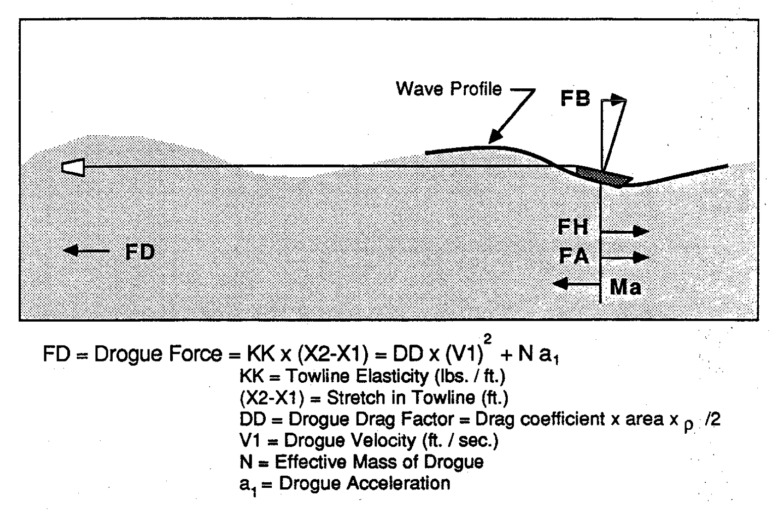

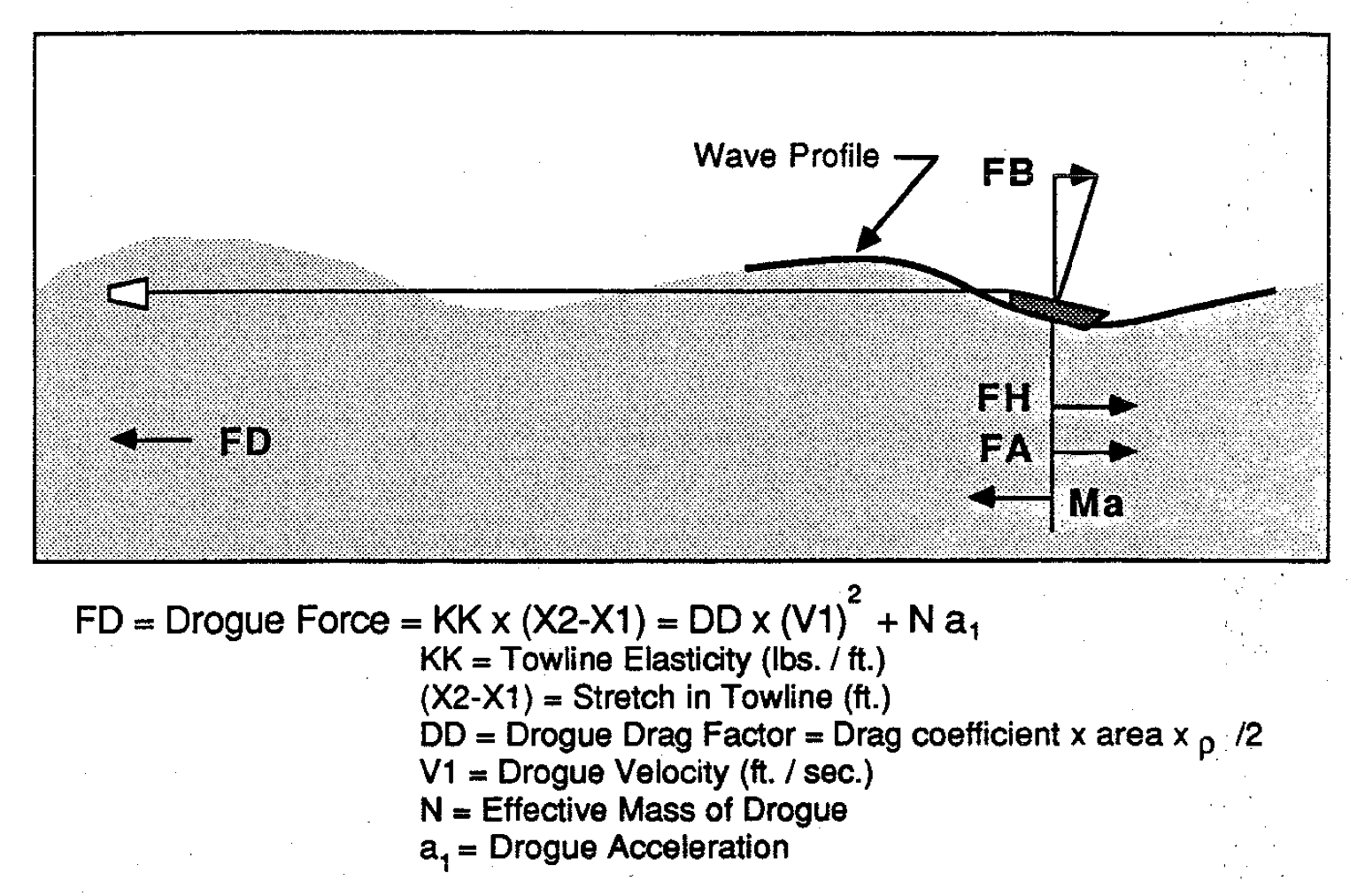

The concept of the second wave distance from the boat was identifeid in the CG report. Practical or not, it's application is to maximize the opportunity for the drogue or sea anchor to stay buried in the water and not be pulled out of the water as the boat rises and falls on the waves.
The work of many suggest 100 meters of rode to accomplish this condition is not impractical.
Here is an image from the CG report illustrating what the CG considered.
It is up to each skipper what safety plans and considerations to make, that are practical, for the safety of their crew and boat.
