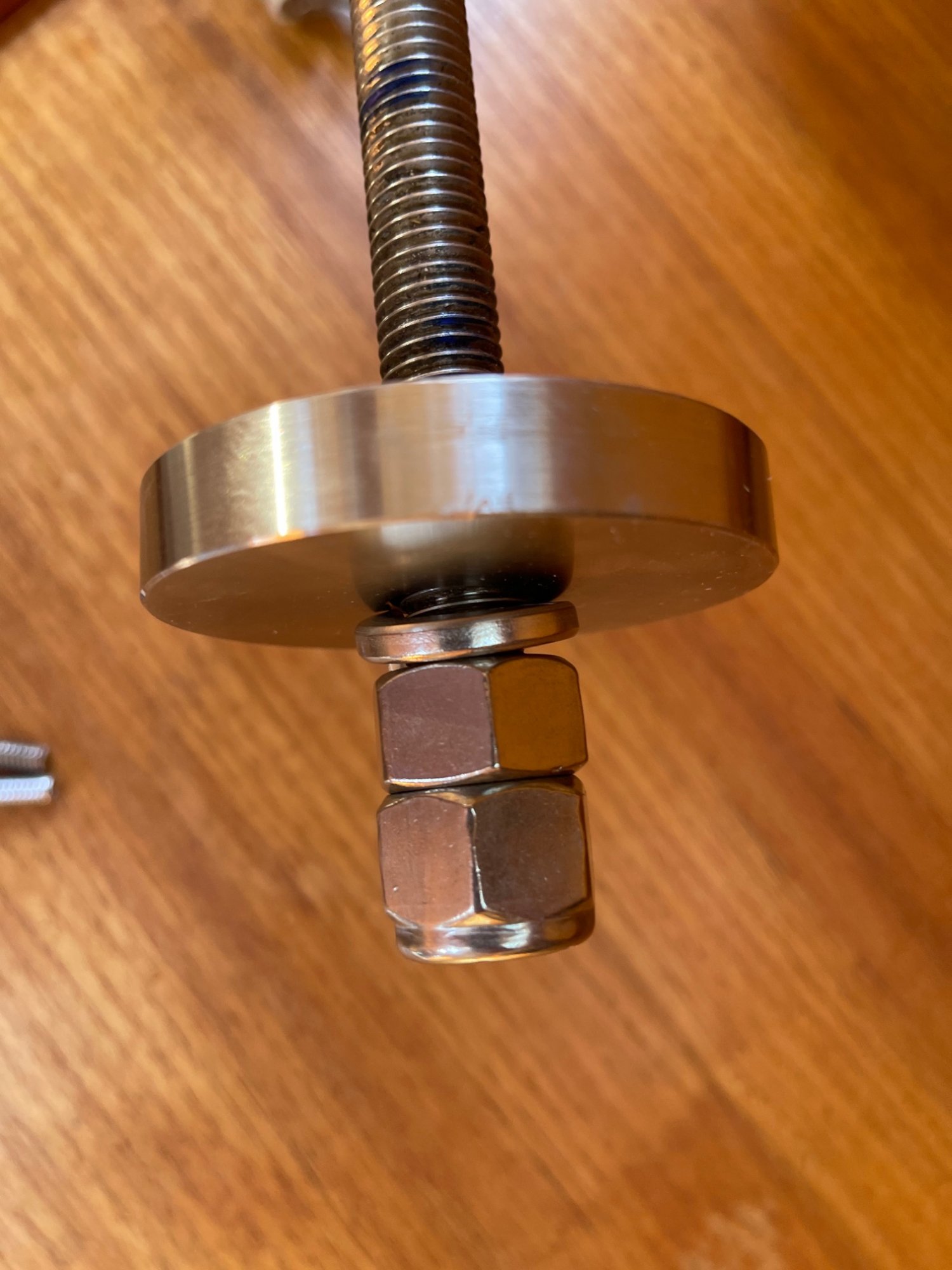

First image is the new chainplate, new spacer, new lock washer and new nut (hand tight)

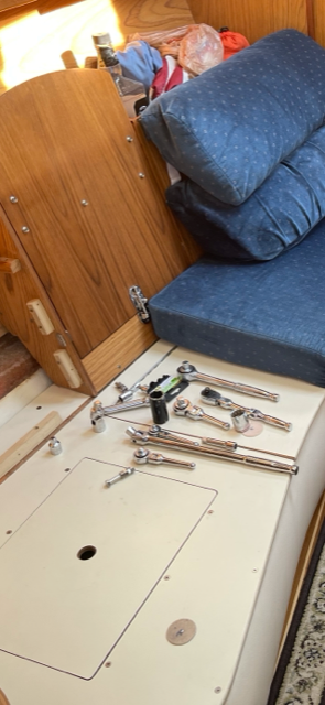

Second image it the assembly prior to installation

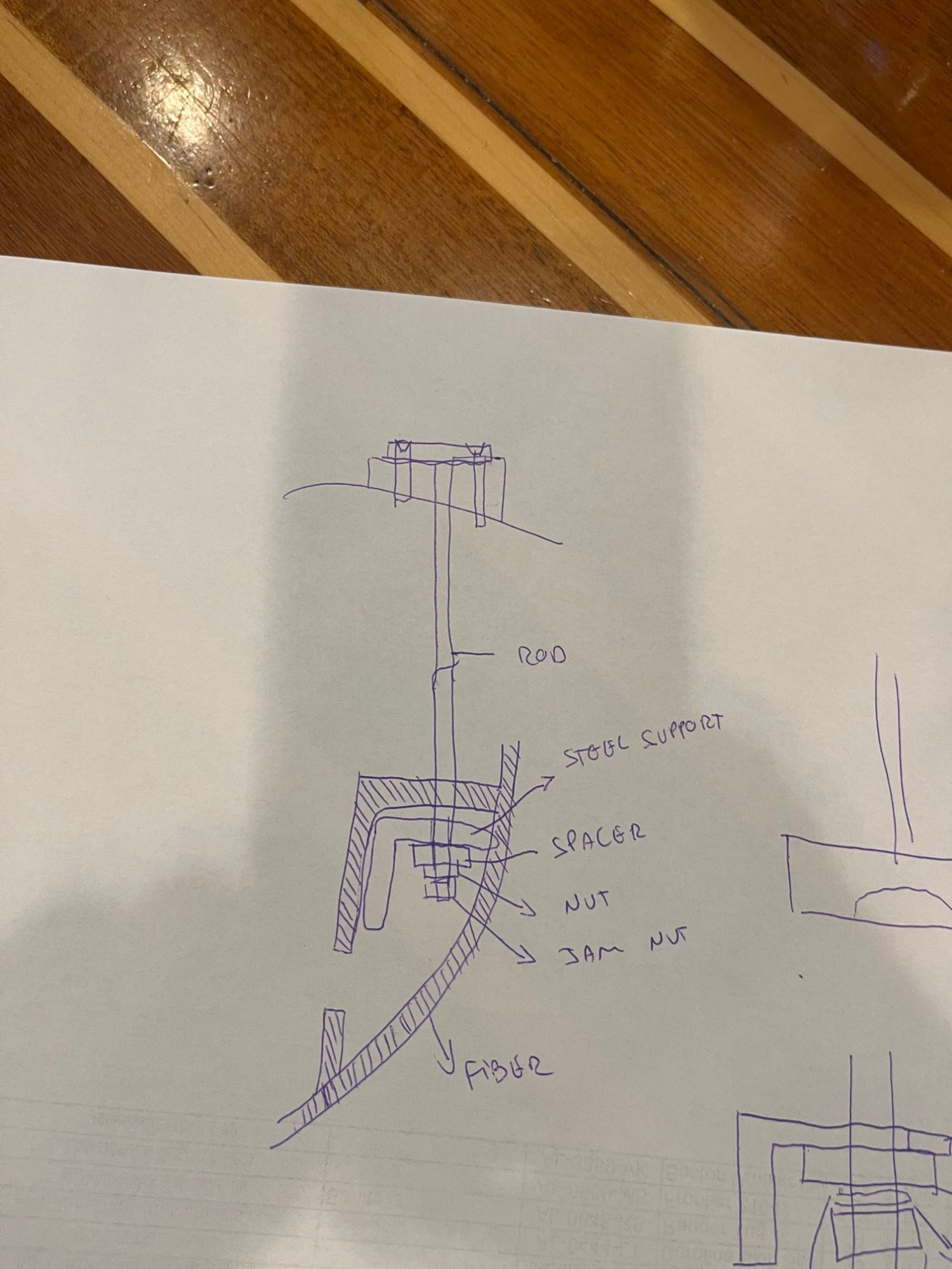

Third image is a sketch showing the extremely lack of room to work with.

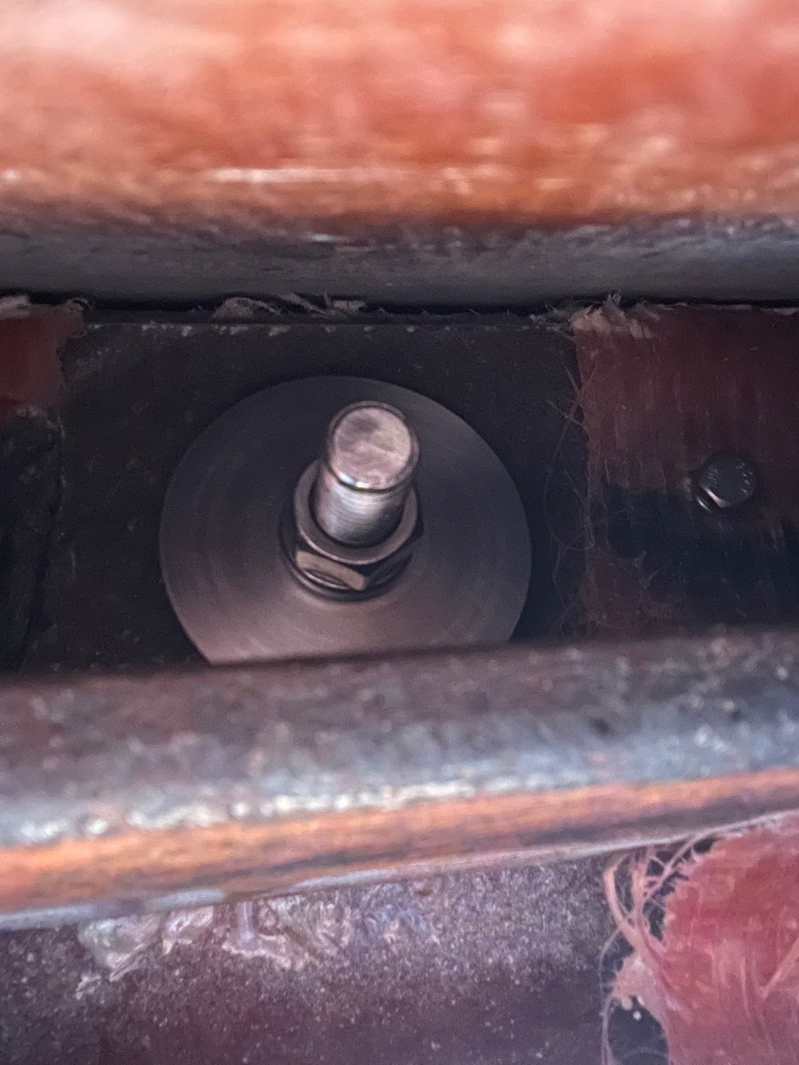

I have managed to put a 15/16 socket around the nut and turn my has up to the point where the lock washer needs to be compressed. There is just not enough room for any kind of tool to turn connect with the socket.
Image 4 shows all kind of tools I have purchased such as universal joints, adaptor, flexible wrenches, swivel ratchets... etc
I am in trouble and in desperate need of any suggestions. Hopefully some either has had to replace the chainplates on hunter 380 or know someone who has done it.

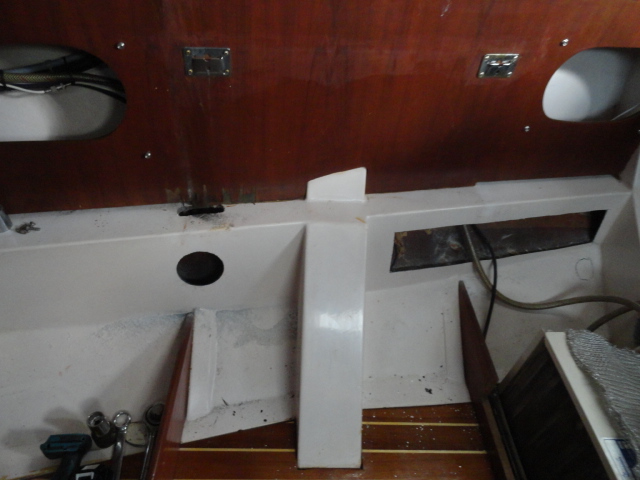

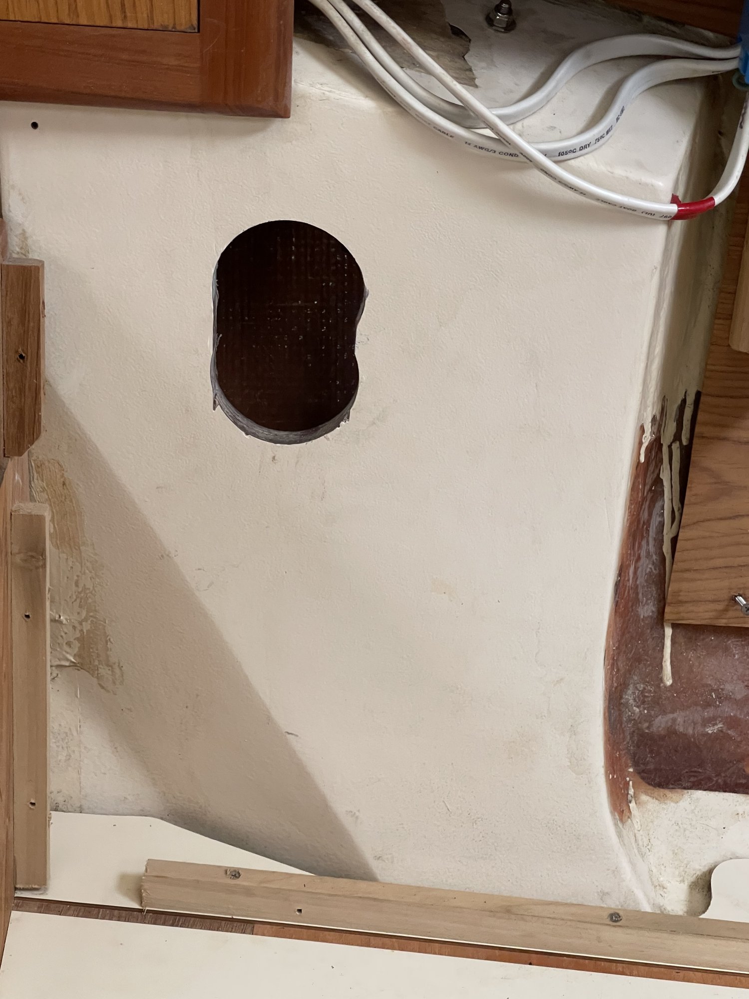

Keeping in mind what I had to do on my H31 chain plate/rod repair and looking at your sketch photo, it appears you may have room to cut an inspection port or cut open rectangular opening in the liner inside the boat in order to access bottom of rod/nut. Afterwards you can glass black over or cover. Can’t tell from your sketch how much room you have. Pic from my boat cut outs. Round opening has a cover for maintenance inspections. rectangular was glassed back over and painted.

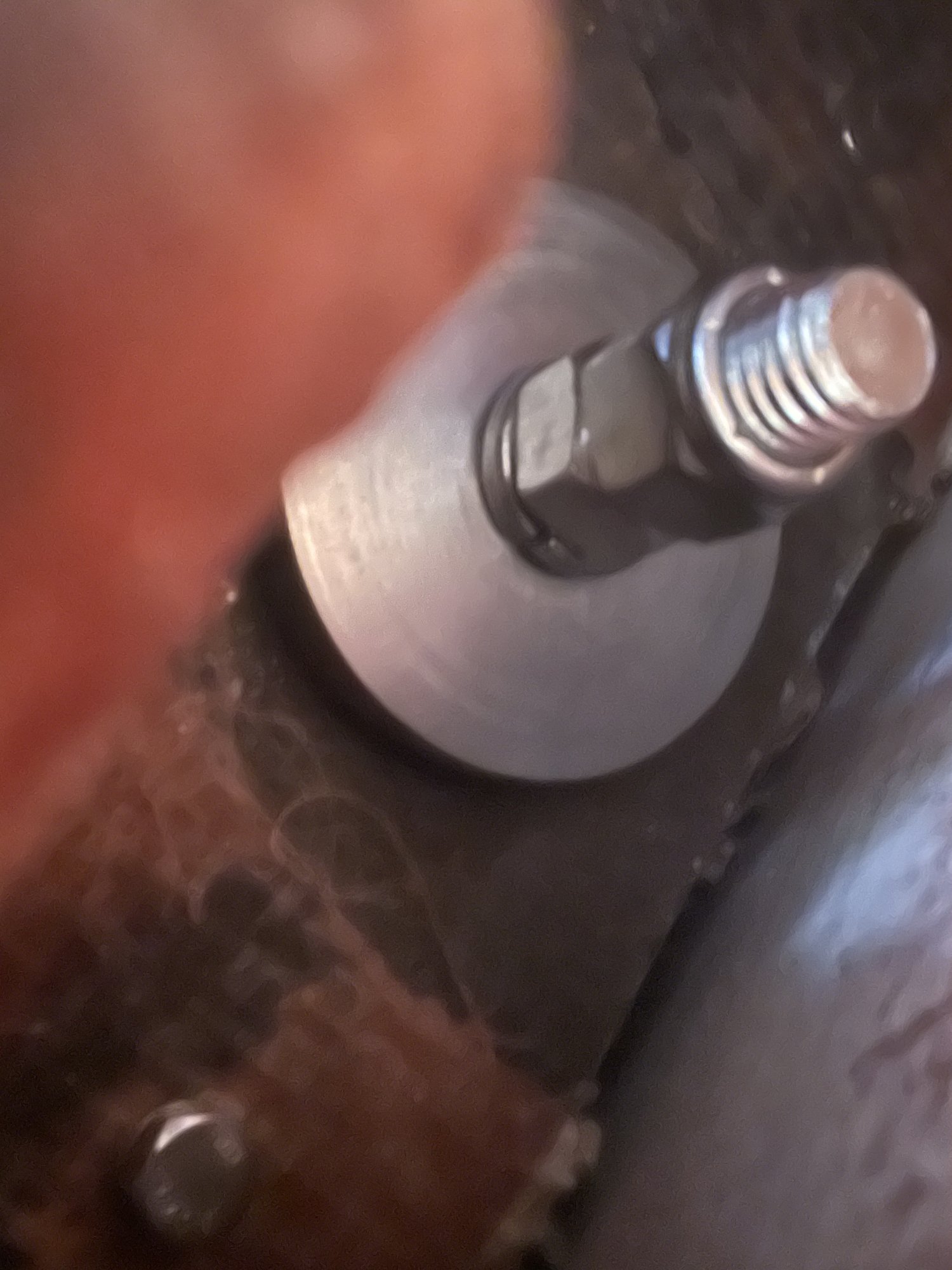

Ended up cutting a small 2x2 access in the lower flange of the steel support bar that is attached to the fiberglass, the additional “room” allowed me to use a modified socket and fasten the nuts.
Did some engineering, had to dig up my old materials and structures books from college, and determined that a 2 x 2 window on a 5 x 5 1/2 thick angle steel plate would not weak the system. The weakest link is still the cable !!
Thank you so much for all the ideas and recommendations. PS: the crow foot wrench did not fit there either!
