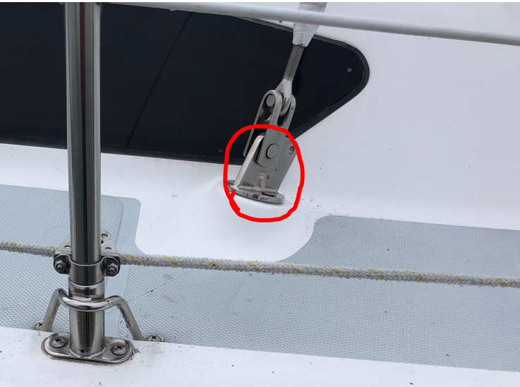

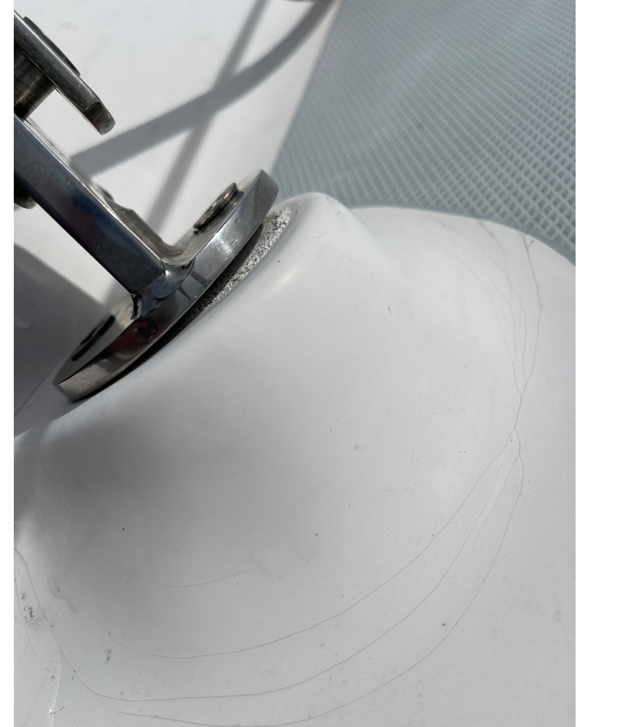

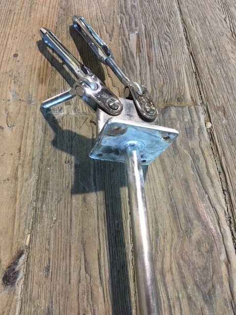

To all Hunter B&R lovers out there, if you are a hater please just keep your thoughts to yourself. I have owned a 2001 Hunter 380 for about 18 months and last weekend I noticed that the chainplate adaptor on top of the deck was separating from the deck itself.
There are 2 5/15 bolts that secure this piece and absolutely no access down below. I removed one of the bolts and it had about a full inch of thread engagement and some signs of wear on the portion that was in contact with the thru hole in the adaptor plate(picture attached). I place a new bolt with the added 3M 5200 sealant. Has anyone seen this condition before ? Is it an actual problem ? Does anyone have a sketch or print showing how the chainplate is attached to the adaptor ?

Carefully check the tie rod that attaches the chain plate to the grid structure. It looks like the tie rod may be kinda loose and the screws are pulling up on the deck.. The gel coat cracks around the chain plate "bump" tell that same story.

Are you saying the 2001 H-380 does not have the same design as the 1999 H-310 for the shroud attachment shown below ?
You should find this in the cabin directly below the deck mounted attachment on both sides of the boat. Yours may be hidden behind cabinetry. The attachment in the H-310 has a 1/2" stud welded to the bottom of it and the plastic cup covers the 1/2" nut and stud. Under the nut is a heavy washer (approx. 1/4" thick). The cabin top assembly that supports this whole assembly is solid FG and capable of handling the load many times over.
On deck, the two machine screws (seen in your photo) are there to keep the shroud attachment from rotating. I don't know if this is what you removed but they are considerably less than 5/16".

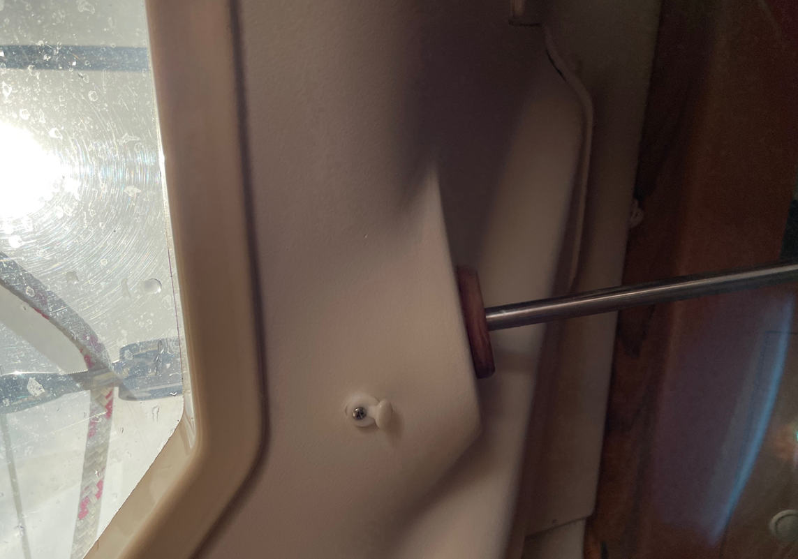

Last night I spent a lot of time studying the problem, it appears structurally the system is fine with the plate in questions as merely a cap/rotation preventer and a loading point as I originally feared.
The cable/turn-buckle is directly in line with the rod(welded to the plate) and transfers the loads to the hull at a attachment point behind some cabinetry. I suspect a not so precise tolerancing in the manufacturing process that let the fiber and gelcoat at a not so precise angle with the shroud.
The picture below is form the archive of images I got days before buying the boat, that condition has always been there but for some reason I never noticed before !!! Last year during the pandemic I sailed/motored 3000nm !

Gus, just a thought.. ya might have to remove both screws and the shroud from the chainplate , inject a good sealant (795 or 4200, etc) underneath at the deck, then rotate the chainplate one turn to tighten it against the deck then replace the screws and shroud.. if you carefully mark the turnbuckle threads before loosening, you can put it back where it was. The turnbuckle may have to be loosened 1/8" or so to compensate for the one turn of rotation on the chainplate.. The chainplate should not put any upward force on the deck at all and those cracks in the gelcoat indicate that the plate may be pulling pretty hard.. Consider calling in a rigger to look that system over.. That chainplate is attached similarly to the attachments on the H-34/H-31.. search the posts on this site to get some visuals that will help.. Good Luck.

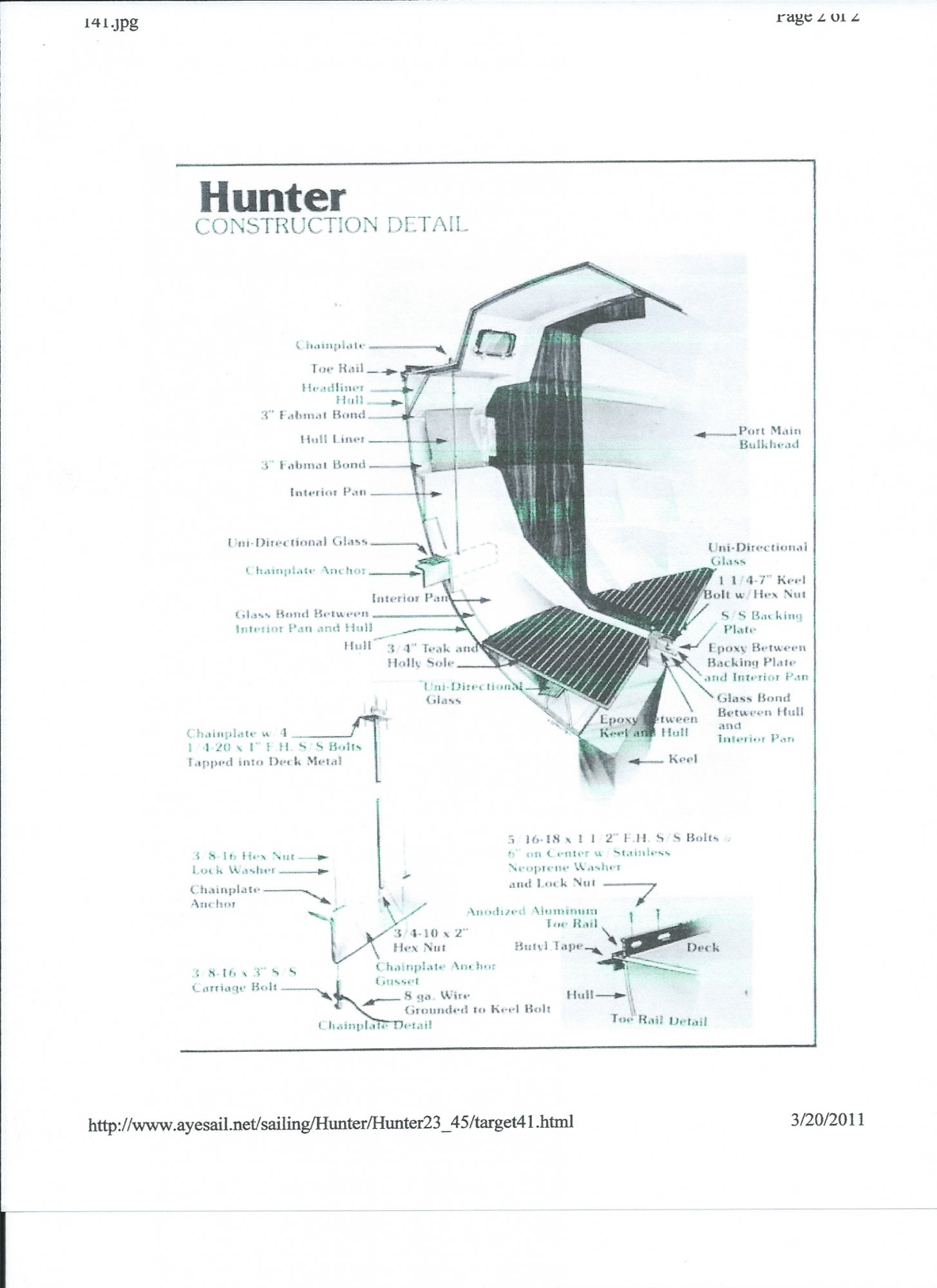

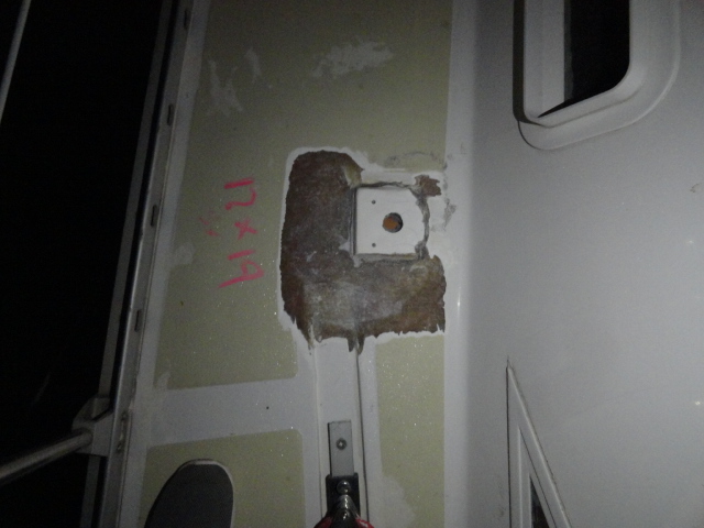

I can't speak to the H38 but here is what Kloudie mentioned for a chain plate configuration on the H31. The base plate on deck is attached to the fiberglass for holding with 4 small screws (see H31 construction pic with details on 4 screws). The actual chain plate attachment is welded to a rod that is screwed down into a castle nut that is welded on the underside of the chain plate anchor. I've attached a few pics of my H31 when we had to replace the chain plate anchor. Pics attached are from the H31 owners manual on chain plate set up and actual photos of the deck chain plate base, rod and attachment to foundation plate.

A half turn was all it needed, replaced the crews with new ones and added a slant to prevent leaks. Today I went out to test it out on 18knots and it was like it came out of the factory 20 years ago !

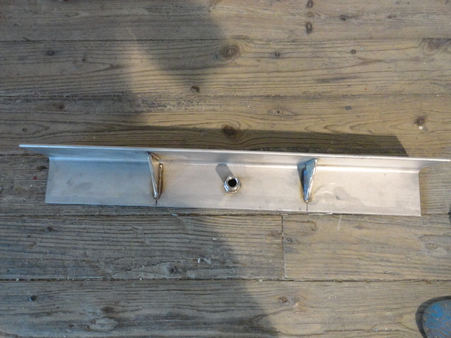

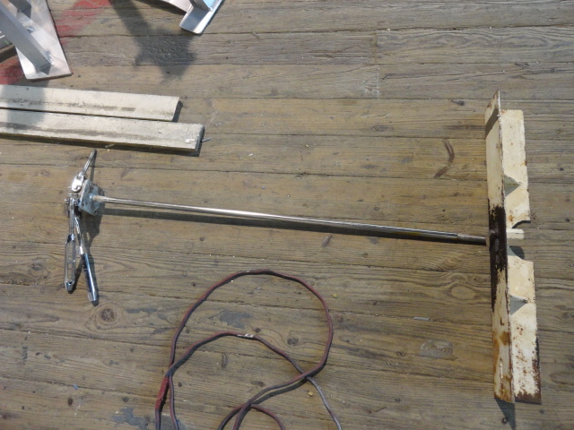

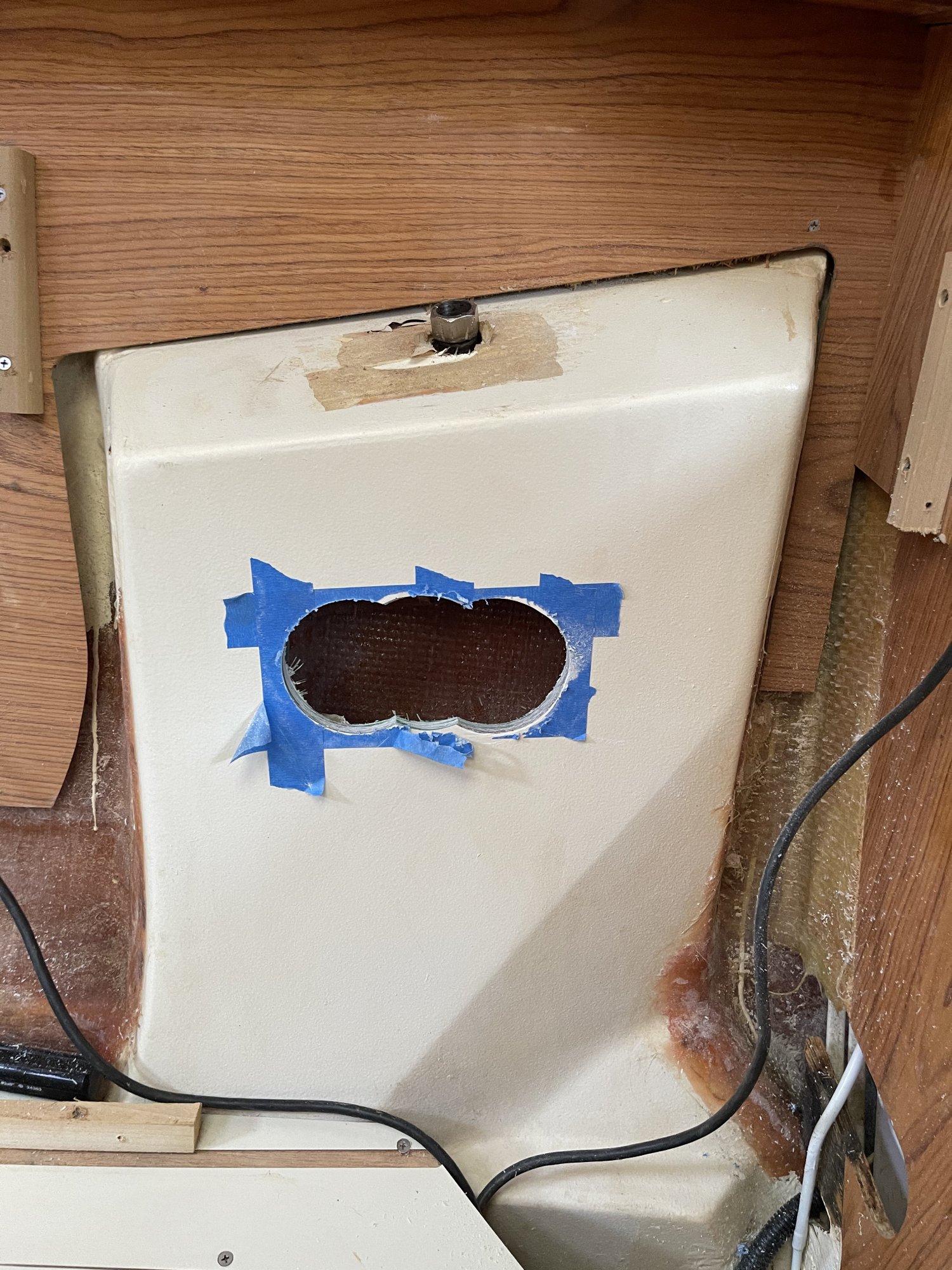

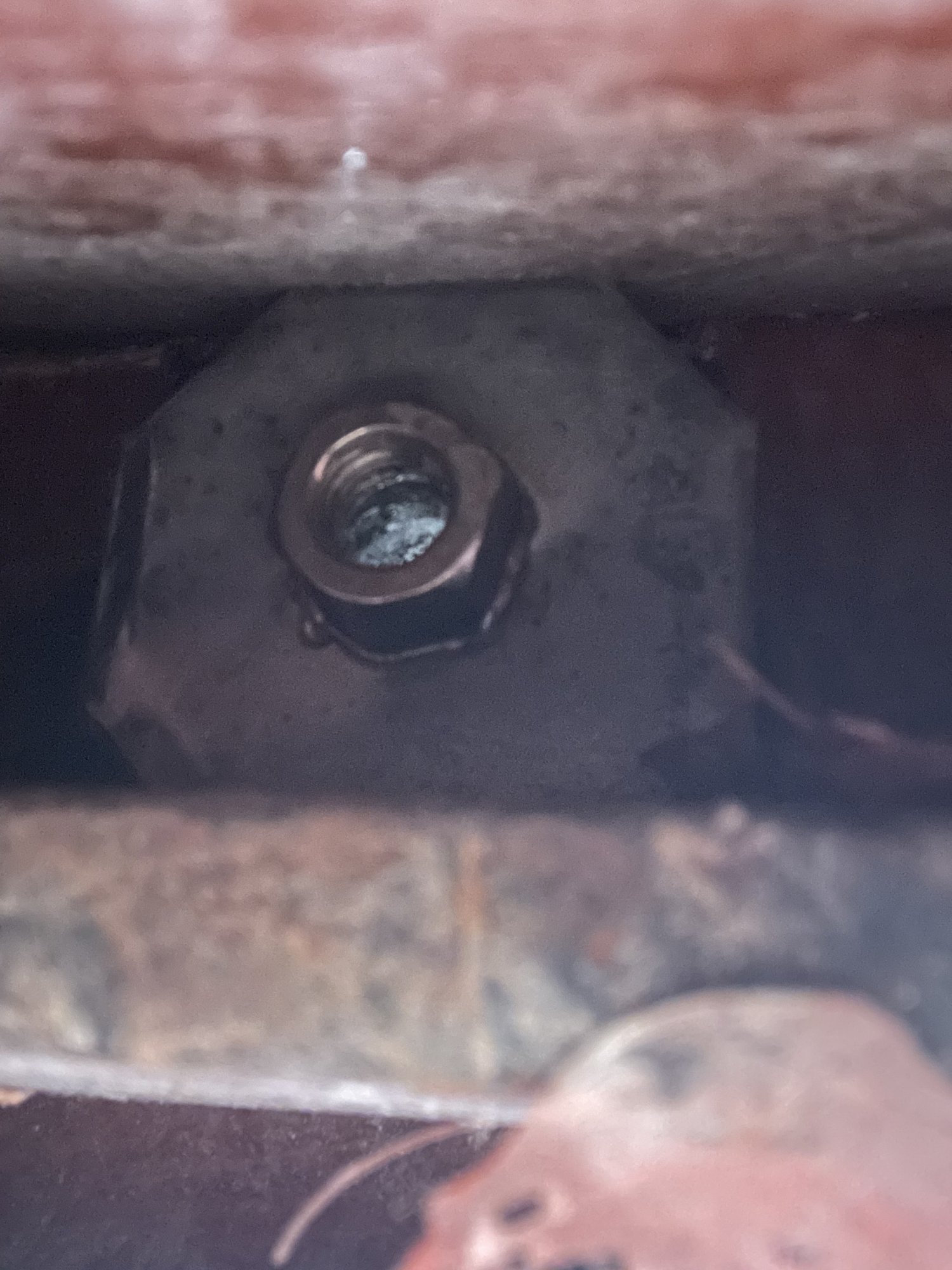

A sad update. I ended up losing the entire rig a few weeks back. The chain plate in questions pulled out completely and everything else went....

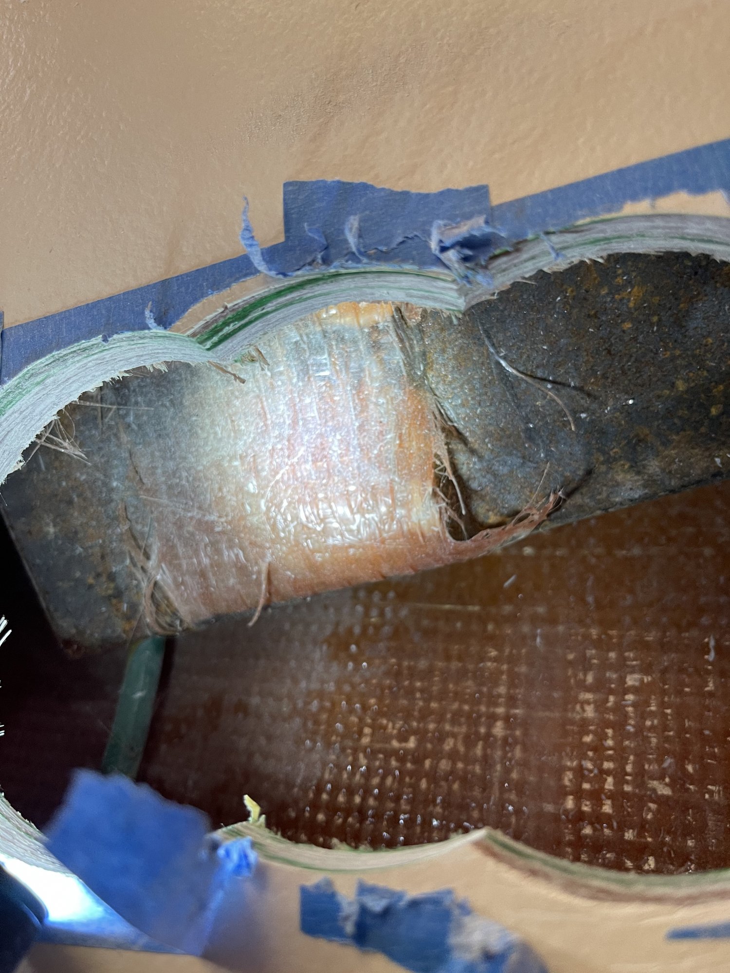

Been trying to dig information on how to rebuild it but not very easy to get it. Unfortunately the way the boat was constructed there is absolutely no way to inspect it unless one disassembles a significant amount of wood work and cut as access hole into the fiberglass. I have done all that and have more questions than answers.
Found a pipe with a square plate, nut and pipe welded assembly that I can only assume it was used to tension the tie rod. My assumption is that once the rod was assembled and tensioned, a vertical steel bar(looks mild steel) was fiberglassed in place to prevent the assembly from rotating itself lose. Lastly the entire area would be encapsulated by fiberglass.
Has anyone encountered this issue ? any suggestion ?

I don’t really know what parts I’m looking at, but IMG_0892 looks like fiberglass that isn’t very well wetted out. Maybe a previous repair or just not very well laminated in the first place?

That is a steel bar that is lose, I also do not know what the heck it is...in the image 0884 you can see it from below.
