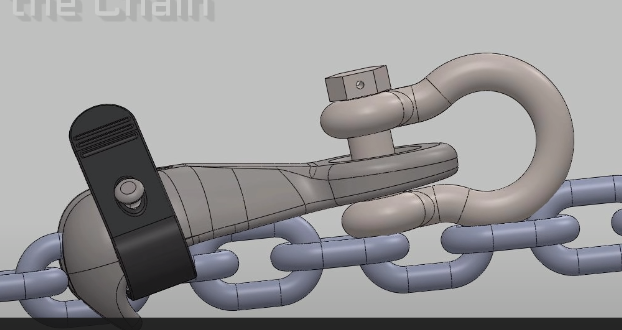

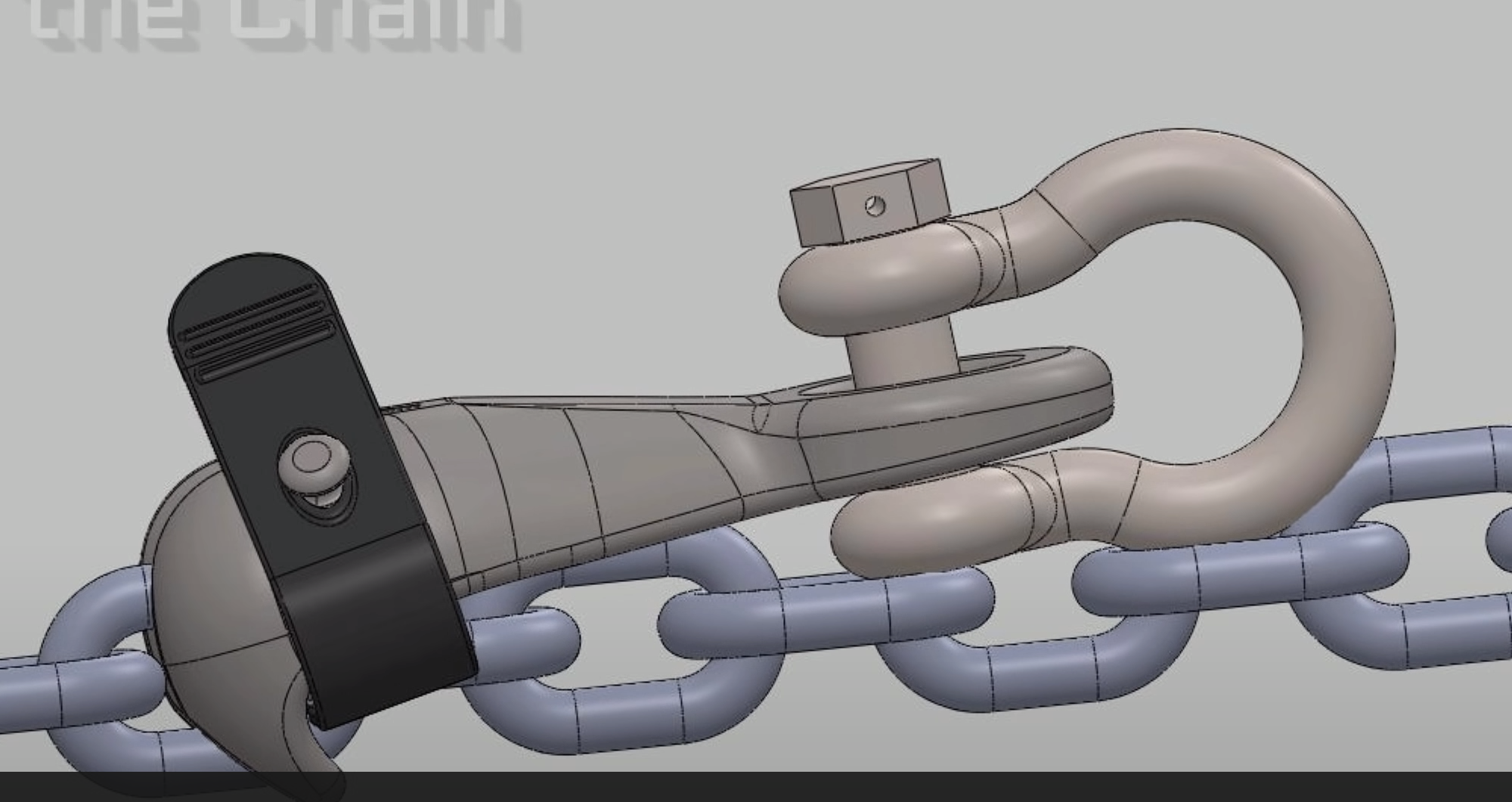

So you have the Mantus hook with the rubber strap like this?:
dLj
Mar 23, 2017
4,808
How long have you had it and how do you like the rubber strap?
Yes, works great. I had to replace the rubber strap after about 2 years. They sent me one free of charge. New one has chaffe protection on it.
They also make a pretty nice bridle. Made my own for a lot less cash, but mainly did so because the lines on theirs are overkill for our 35' boat and I wanted more stretch than that.

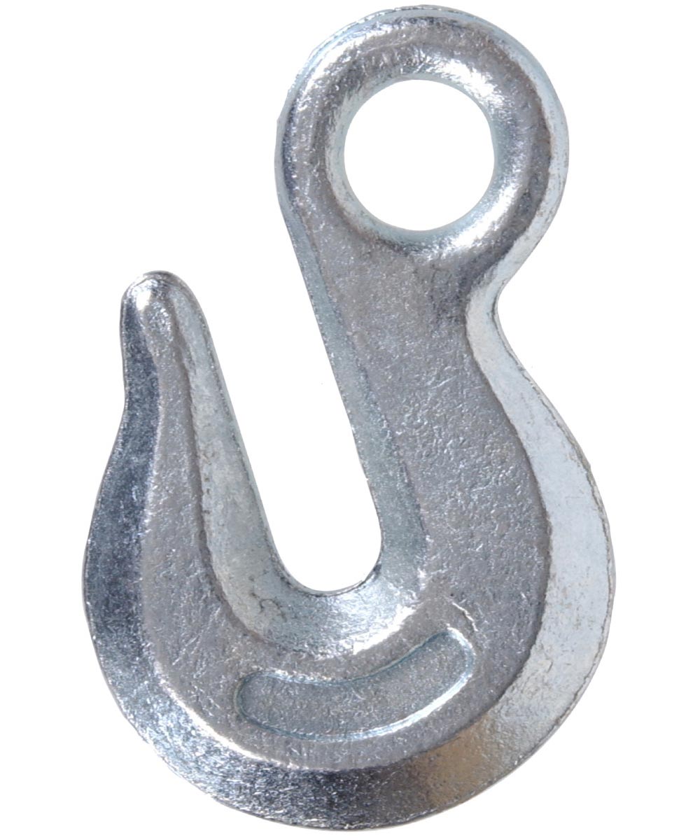

I use a simple chain hook and a single triple twist nylon line. One issue I have with the hook is that I sometimes have difficulty attaching it to the chain that has already passed through the bow roller- its a reaching/stretching issue over the bow seat and down to the chain. The other issue is that under light air, low current conditions, somehow the chain hook becomes unattached after anchoring. Since the chain hangs on the chain hook, I don't understand how this can happen, but it does.
I use one like pictured here with a shackle and a 15 foot 3/4" line with a stainless steel thimble.
