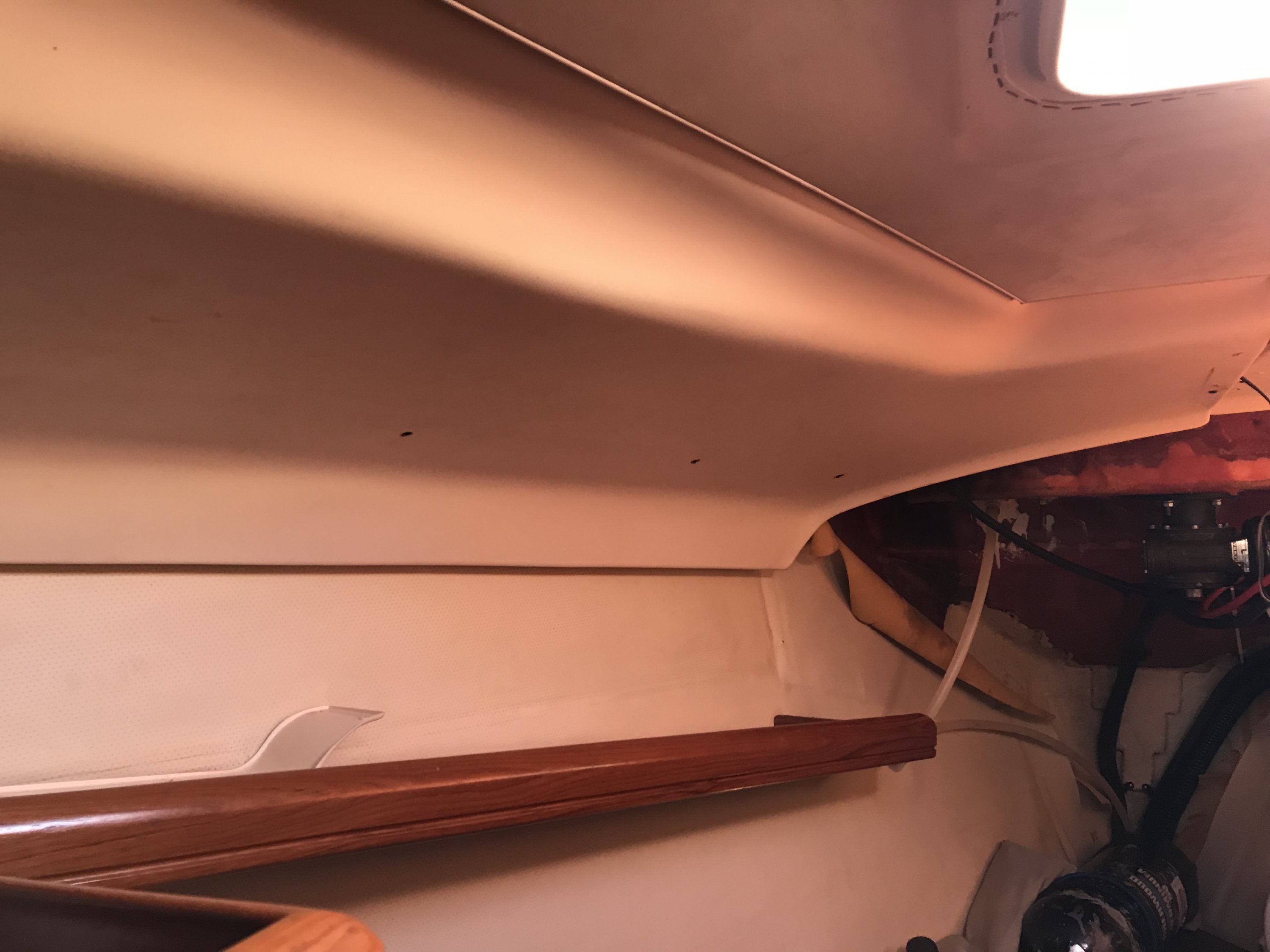

I have a leak in my vee berth on my 2007 H-36 and took as much as possible a part but need to take down the plastic ceiling part and the vinyl part at the hatch and can see many screws holding the plastic part.
Have not found leak but will have impossible time trying to rebed the stanchion.
Any one try removing the ceiling in this vee berth.
I have been spraying water hose and watching when raining for leak but no luck so must be very minor leak.

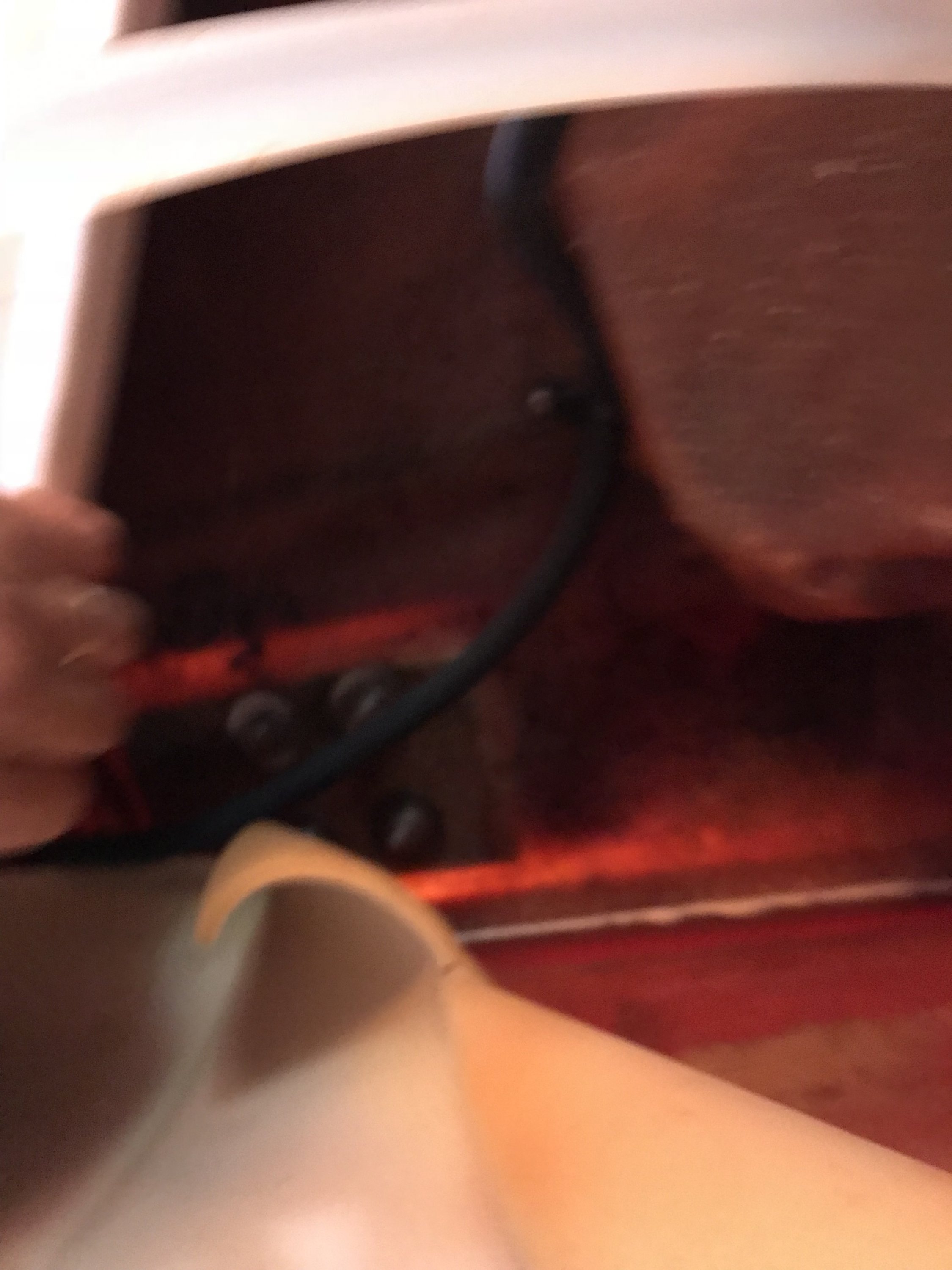

Yes I have seen the removal of the material in the main cabin but in the vee berth looks very different and don’t want to damage it.

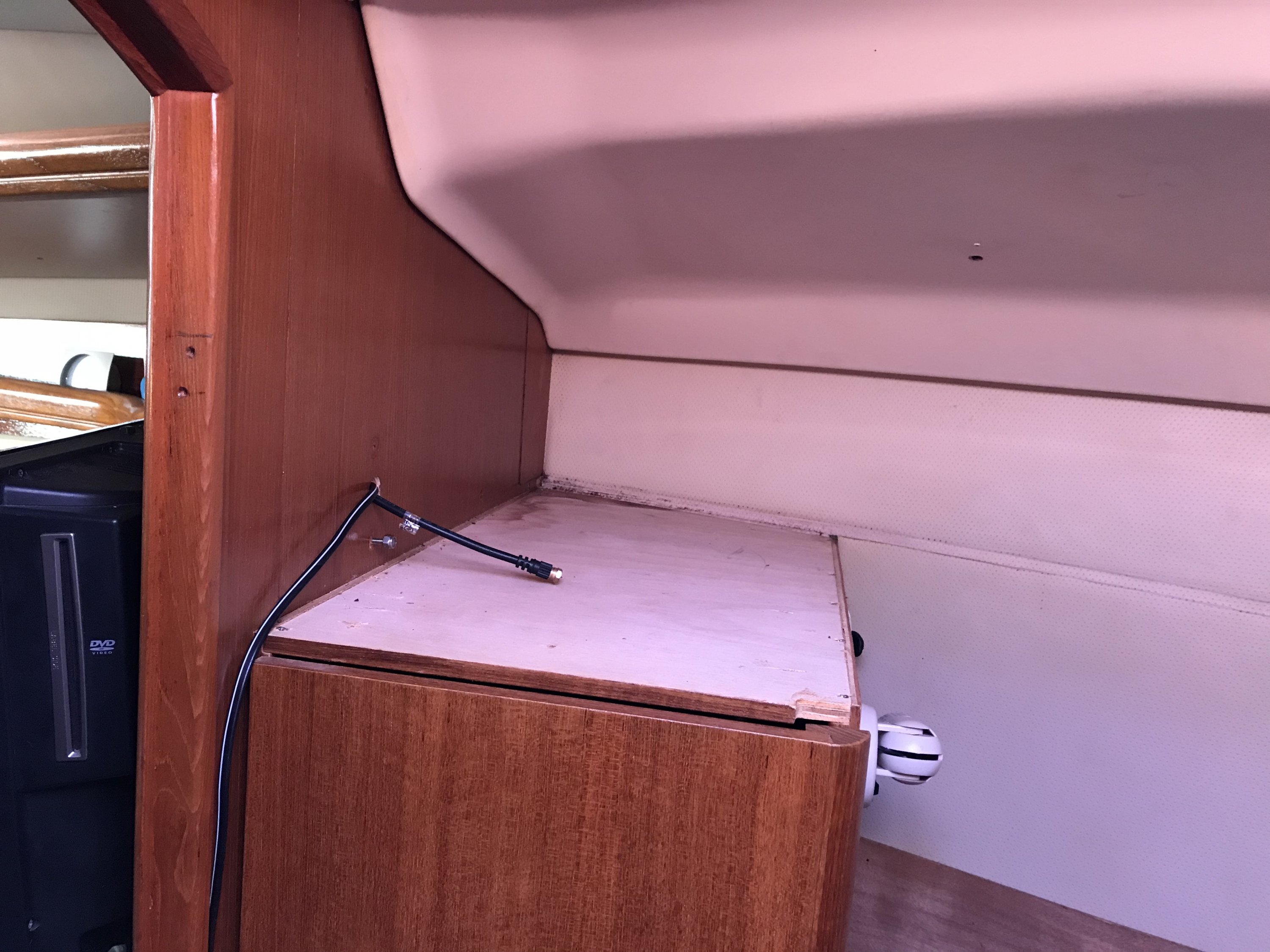

The leak is not from the windlass for sure and right on the port side of the vee berth onto the plastic part of the ceiling and only leaks very heavy rain here in rainy season and the leak is dirty like brown running down the corner above port cabinet in vee berth.
I may take photo’s and not only have the 2 piece wood covering windlass but removed the longer wood piece that goes port to starboard and with that removed I can see with flash light
Into the lip where leak collects and leaves dark satin water.
Photo’s to follow.

Please post the photo. I have only pulld the plastic head liner to inspect the windlass from the vee berth.

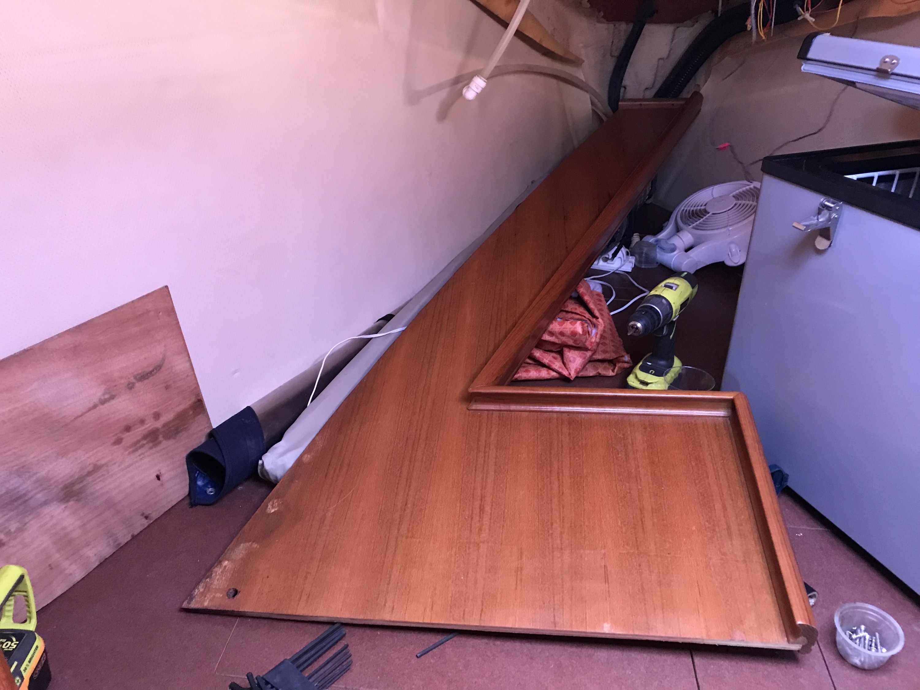

I have taken the cabinet at the windlass and also took the windlass all part and replaced the windlass seal and bearing and totally resealed the windlass.
I took apart the some of the wood in vee berth to try and find leak in vee berth ceiling and decided to rebed portside cleat and stanchion and don’t anyleak at hull seam.

Screws in ceiling of cabinet and removed wood up at the windlass 3 pieces of wood forward around windlass.
Having hard time rebeding bow cleat need 2 person and bolts were cut after install making harder to remove bolts down under.
Getting help tomorrow with second person top side while I hope to
remove lower nuts holding bow cleat,by removing shelf from top
cabinet can get at stanchion in bow area

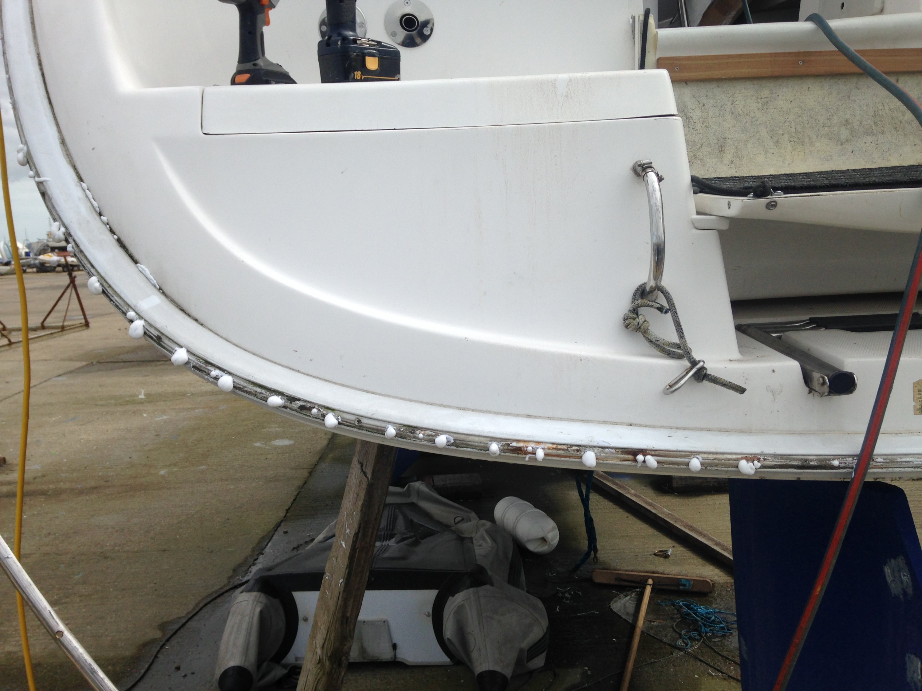

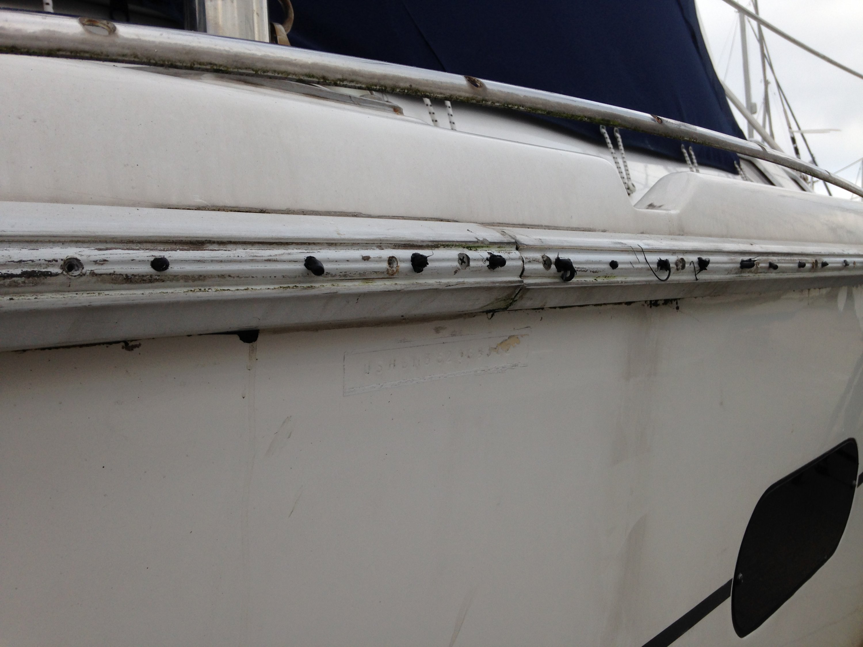

I had a similar problem with our 356, the water was leaking through the deck/hull joint somewhere fwd and running back along,
down, then over the portlight in the main cabin, this caused the wood to rot away. I also used a endoscope to find its source. But for me access would have been almost impossible to access the leak from the inside. So I took off the stainless capping strip on the rub rail, drilled holes at about 6" centers (I did the whole boat as I found leaks elsewhere) and used a compressed air caulk gun and low viscosity silicone to inject into the rub rail. Where there were leaks I found the silicone inside the flange (where I could actually get to it to see it).
I would pump silicone into one hole, move to the next and inject until it was forced out of the next hole along so I knew it was being really forced into the joint. (that is why you can see the silicone coming out)
Before I did this I used compressed air to force any water out of the area behind the rub rail.....a lot came out!
I had leaks in the sugar scoop join also.
Neil

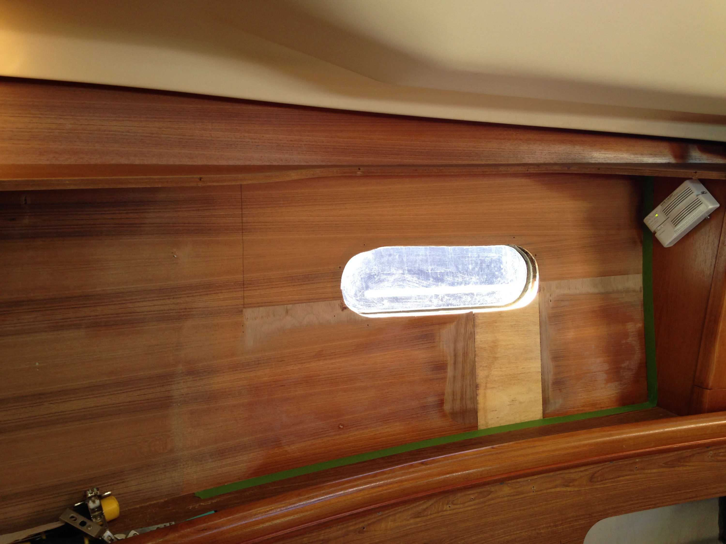

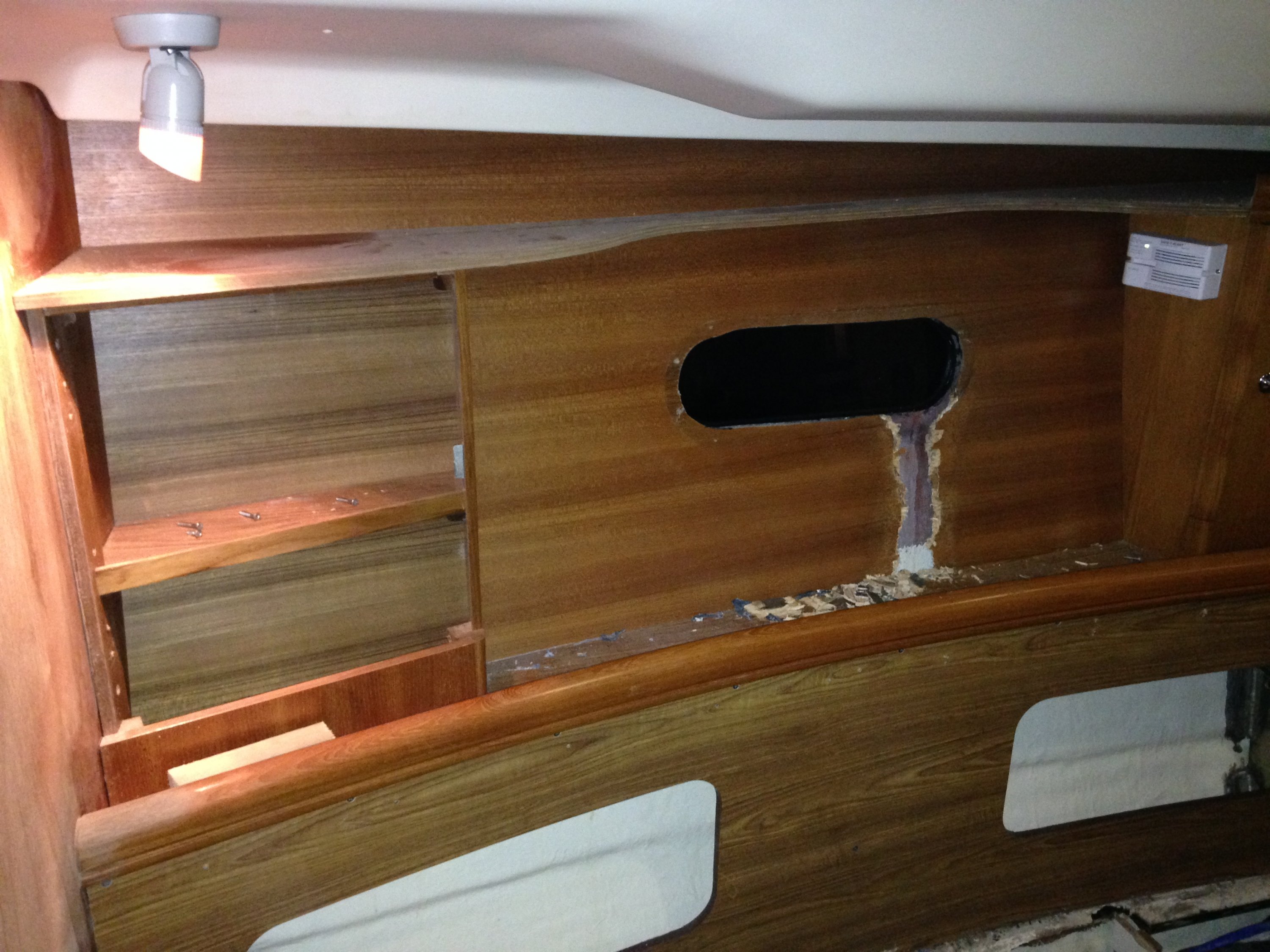

On the interior I scarf joined a repair panel in and re-veneered. While I was there I decided I really didn't like the plastic window frame so fabricated one out of solid Teak & Teak veneer. I think it really lifts the quality of the boat. They were a sod to make, but worth it.
Neil

Nice work Neil. The screws the hold the cap strip on my 36 goes through the hull. Looks like they saved screws doing it that way. I still see screws in your rub rail. Interesting idea and approach though.
Edit: Attached the deck bonding procedure for the 356. Now I understand why it would be difficult to pull the rub rail off. I like your approach even better now. ;-)
