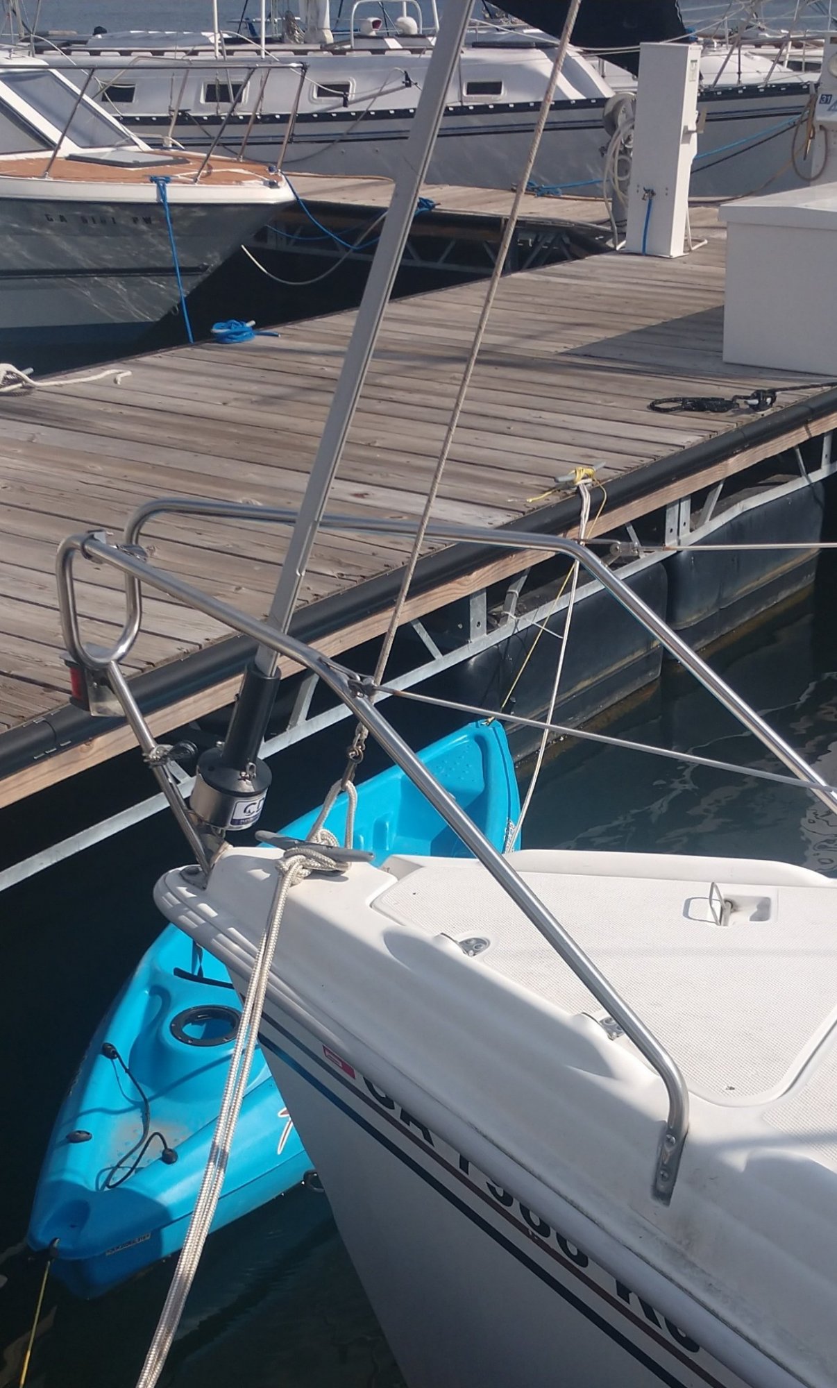

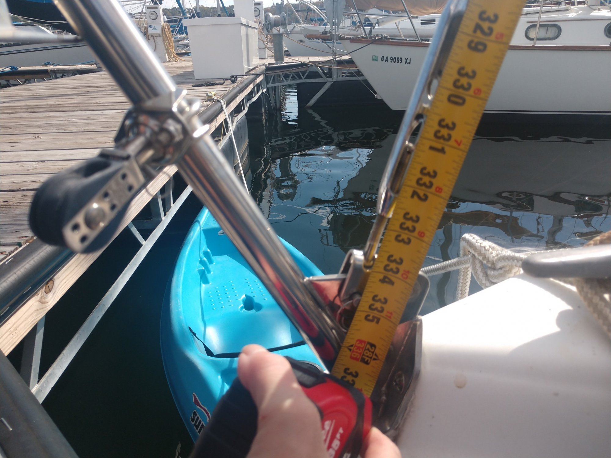

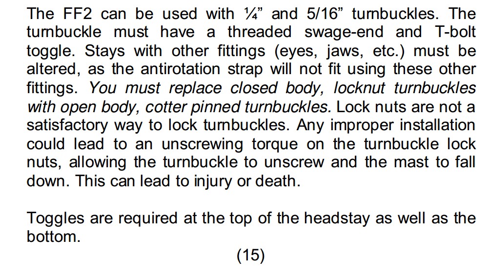

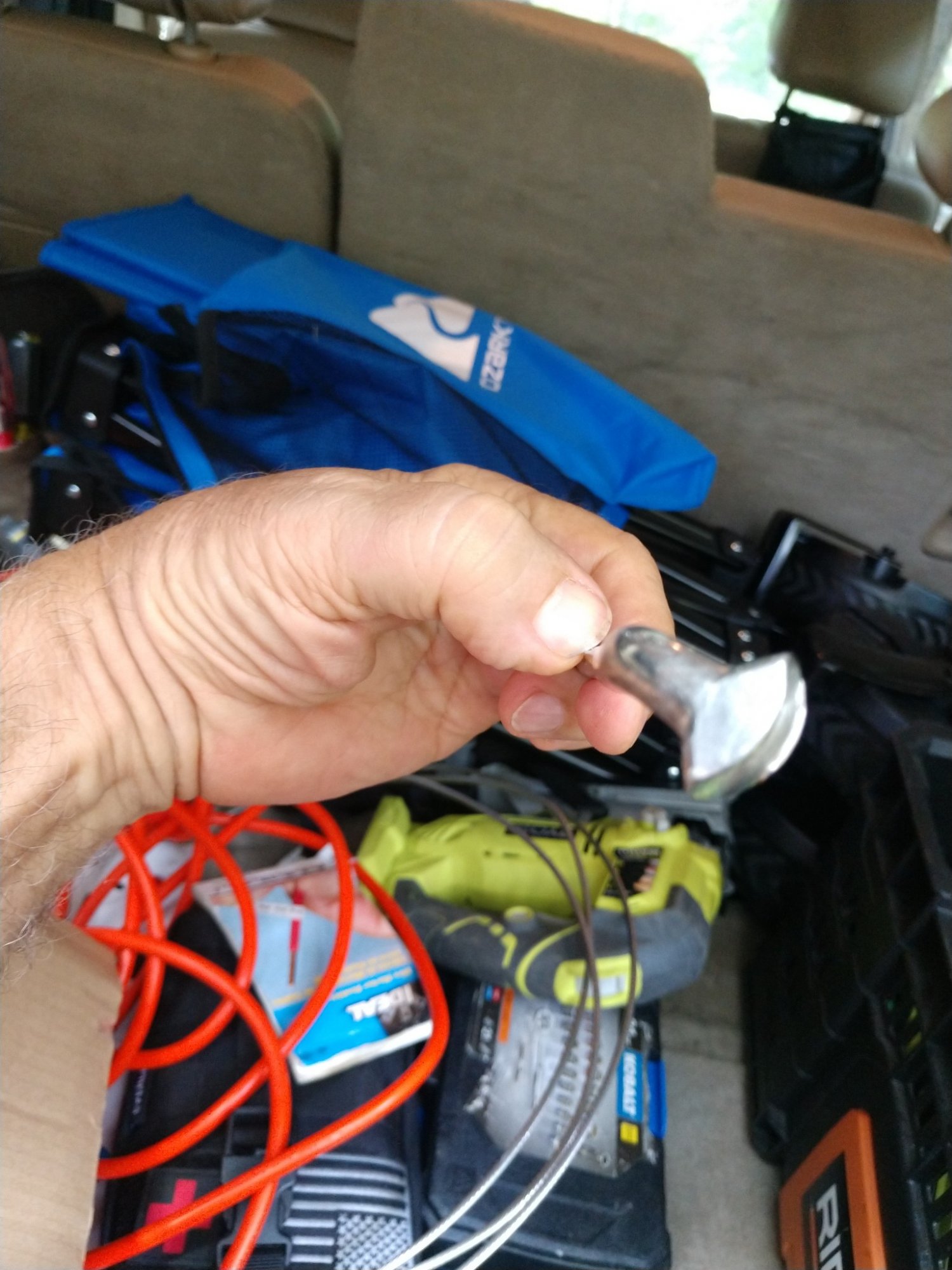

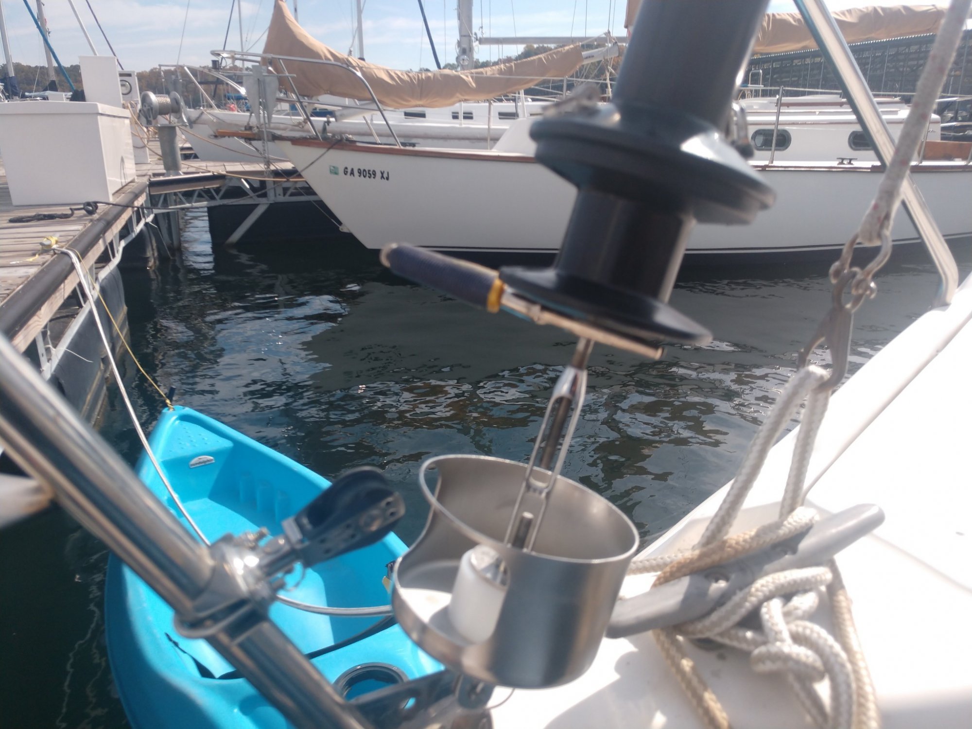

I am getting ready to pull the trigger on roller furling for my H240. I have settled on a CDI FF2 (probably without ball bearings) because of it's simplicity. I will need my jib modified with a luff rope and a UV protection strip added to the leech. Are then any recommendations for who should do the sail work? I think that I can do the fore stay work but I am not a sail maker. Any and all suggestions will be appreciated.
