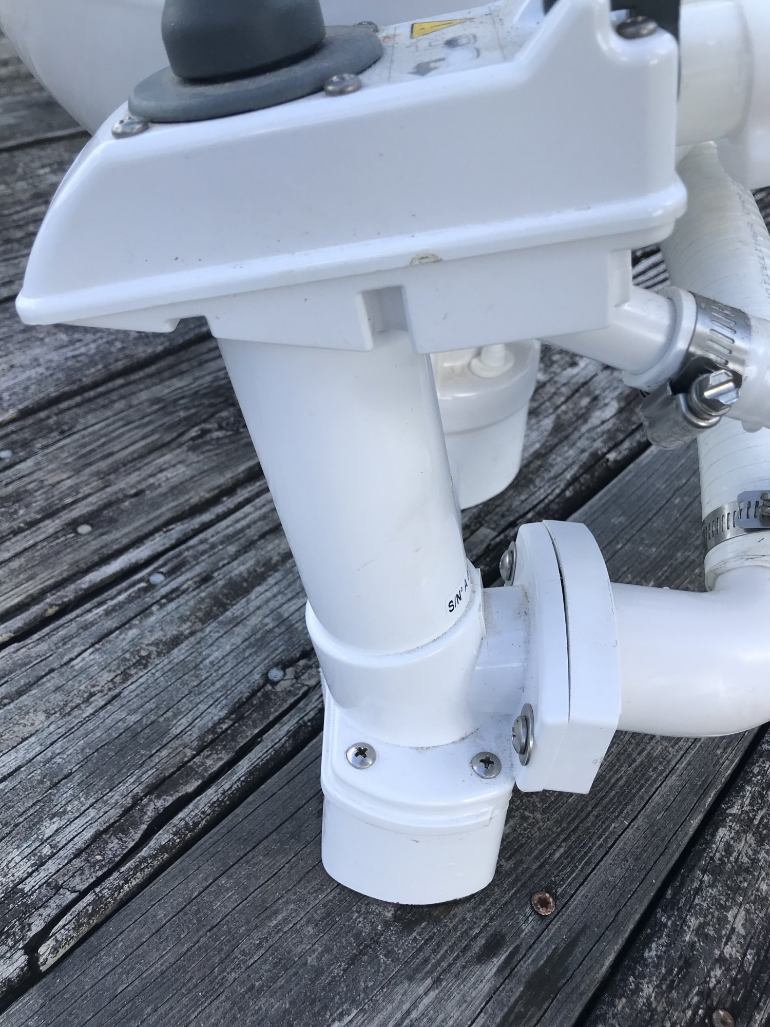

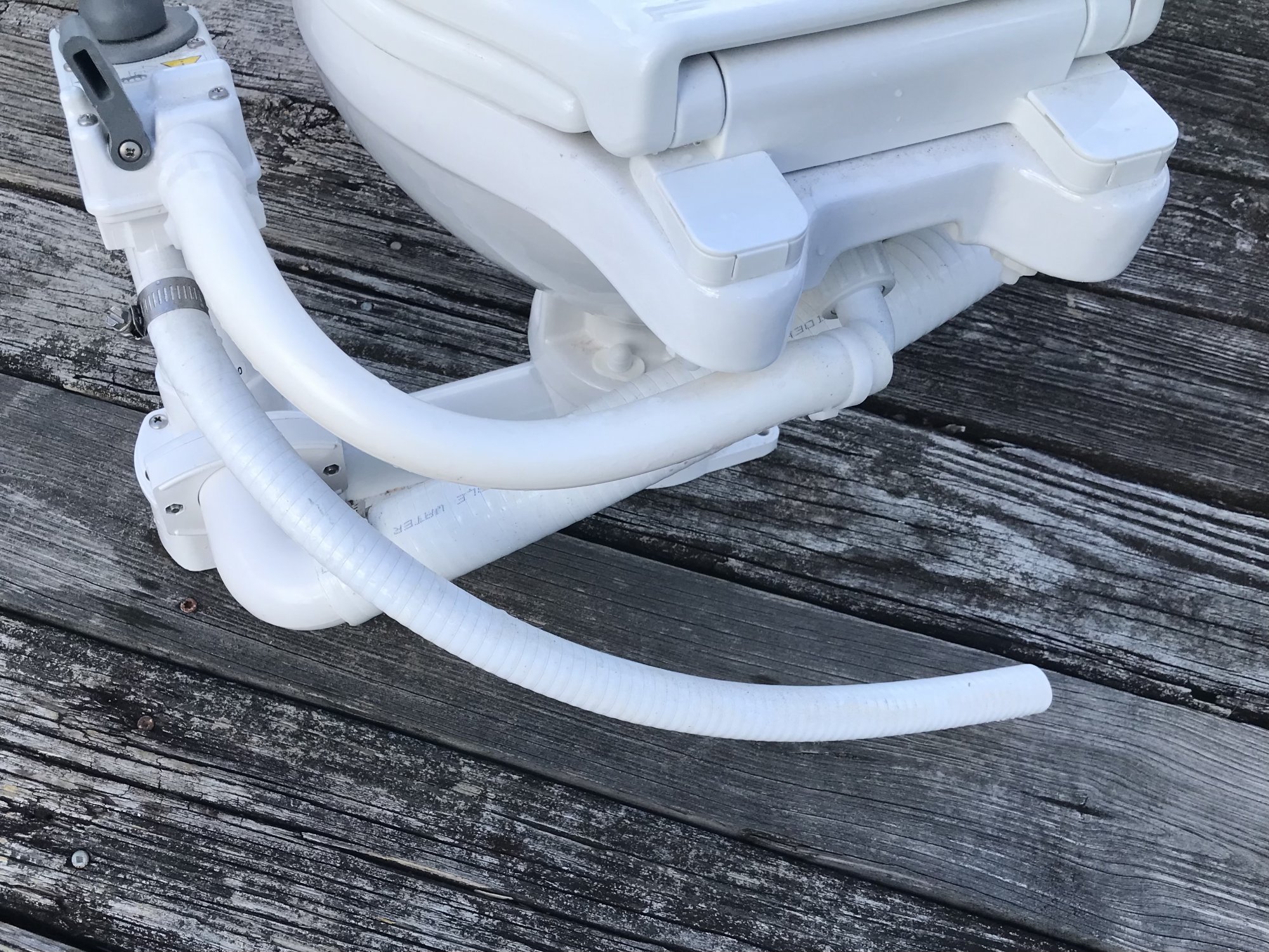

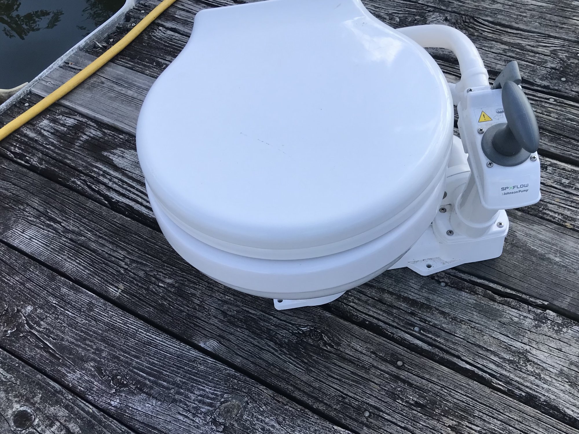

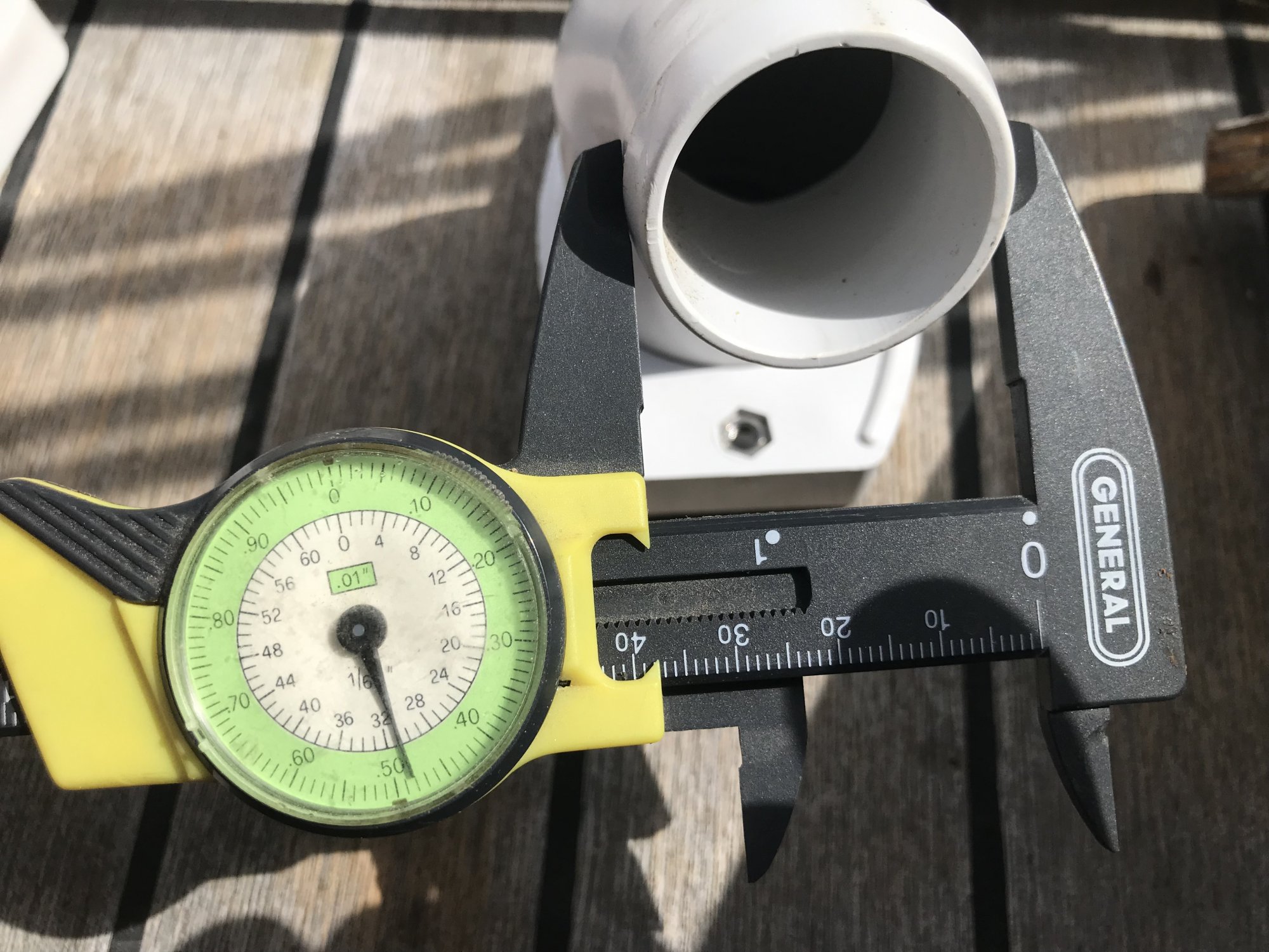

Johnson SFX compact toilet. $129.99 at Defender. Bought as ‘expedient’ alternative to restoring 1970s Raritan Compact head that was original to boat (sadly now lost).
1. All-plastic construction. Pump mounts using sheet-metal screws into blind holes in base. These screws must be kept in tension to ensure flapper valve/gasket does not leak. Any disassembly destroys plastic threads and causes a leak.

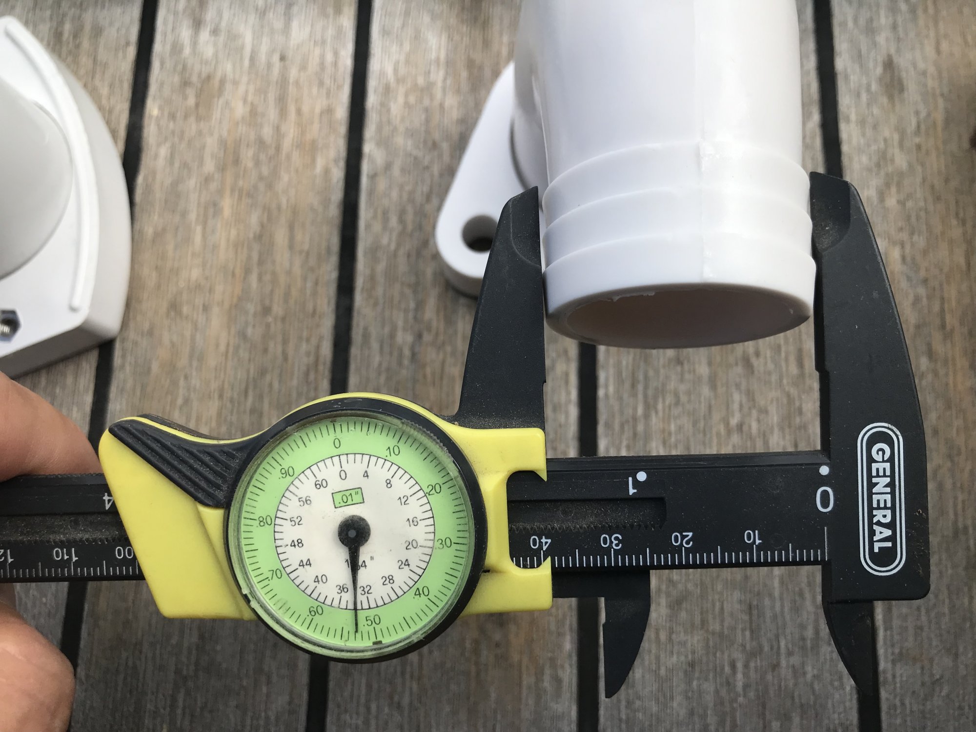

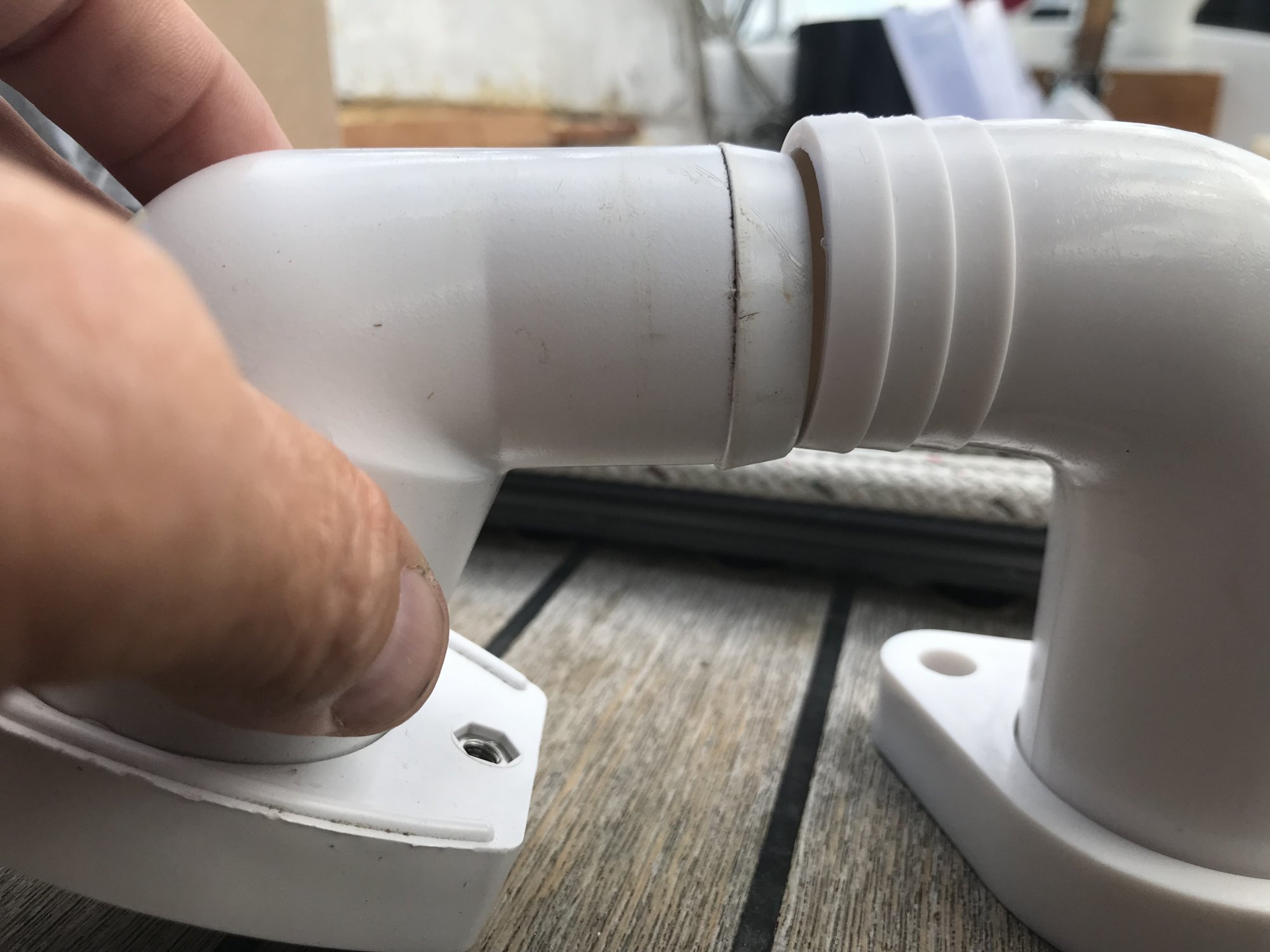

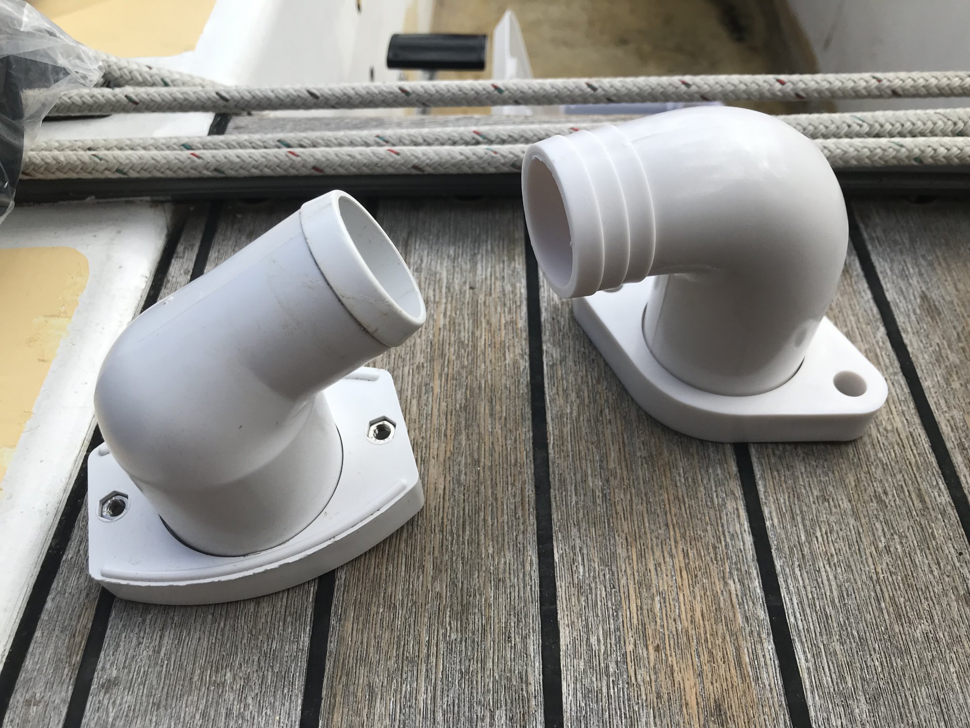

2. Undersized (metric) discharge elbow does not fit world-standard 1-1/2” hose. World-standard type-148 hose will NOT crush enough to seal, guaranteeing that any pumping will pour bowl contents out onto the cabin sole. (See photo of micrometer.)
3. No online service or tech help. No phone number to call. No e-mail contact. No warranty information. Johnson is a world leader in raw-water and bilge pumps. But none of them know anything about this toilet.
4. Defender is of no help at all. My experience is that they have no expertise about products they sell. Every time I’ve called to get help, I find I know more than they do; their advice seems silly. Why did I bother calling them then?
I attempted to remedy the discharge-elbow problem by substituting a Raritan elbow for the undersized original. Spent an hour gauging the fit and then sanding the plastic mounting flange to achieve a really good seal. The flange part of the joker valve is in fact the sealing gasket (same as with Raritan) so I ensured that was was soundly clamped.
Could not align hose to 90-degree elbow without removing pump; so removed pump from base, then could not align pump to base with hose connected; so unbolted toilet from shelf. Reassembled as required. (BTW I have like 40 yrs’ experience with installing and maintaining/rebuilding boat toilets.) Tested pump for leaks using river water before bolting down toilet. Seemed okay.
Pushed toilet into position to align mounting bolts. Dropped one into place. Toilet gushed water from pump base. Apparently the flexing of pump where screwed to base opened up a leak. Yet screws were properly done; surfaces met adequately.
This pump is NOT meant to be maintained or rebuilt since flapper valve doesn’t realign itself and sheet-metal screws rely on virgin factory holes in the plastic base. You take it apart, you'll replace the whole toilet. End of story.
I’ve left it bad reviews on Amazon and at Defender.
Realized this toilet will never be reliable, removed it, photographed it for this post, and will shortly fling it (never used) into the dumpster. Ordered new JABSCO toilet through distribution. Will install (with all new hose) tomorrow. Trip south delayed down to all this hassle - got nothing else done today while wrestling with this junk.

They are only destroyed when re-assymbling if you do it wrong. Insert the screw and turn backwards by hand until you feel the original thread. Then gently start by hand. Tighten as usual. In this way you are not cutting new threads each time. A good rule to remember for wood screws also.
Not sayin' bolts aren't better, just sayin' you can live better with plastic if you know the rules. I didn't know this rule until someone explained it to me (the Head Mistress).

The stripped blind threads aren’t the only problem. And of course I know how to reinstall it. I felt the threads let go the moment I backed them off. That meant a goner right there. Thing was designed to be not disassembled without fatal damage (low-end product with no maintenance kit available for under-35 ‘everything’s disposable’ consumer generation, or motorboaters; take your pick - Ranger Tugs use these exclusively). Should have dropped glue or something down each hole - and did consider LifeSeal (as I was certain I’d never disassemble it again); but it was difficult enough just getting the pieces lined up and the flapper valve in right (it didn’t realign with its own locator divots which may have been the problem).
