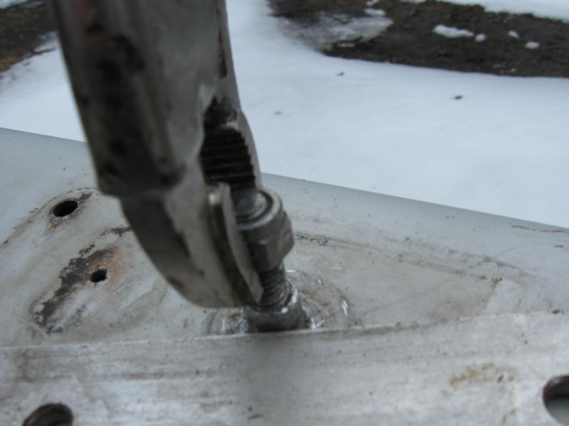

Ok its been gone over but upgrading / rebuilding our 1982 Cat, wanted to pull the spreaders and of course could not get bolt out 31 years can do this aluminum and stainless steel do funny things, some have found out.
not sure Id try this in a bosun chair!

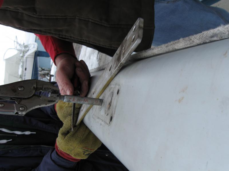

Cut the head off the one end bolt side was my failure side so I just pried up spreader bracket a bit and used a hand saw, And leave nut or vise grip on other side.
Next clean the nut side out a small dremel tool bit would of been sweet ! bushing compresses the aluminum mast and sort of flares hole so no way you can get froze bolt and bushing out till you clean it out good luck!

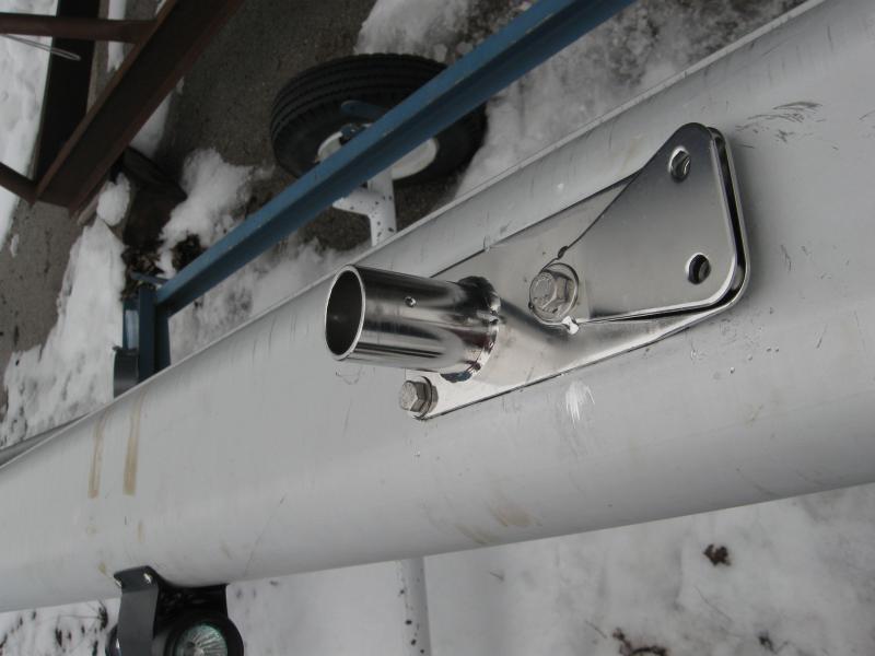

Its what was on there the Stainless brackets,
Yes were doing the whole shebang with new spreader brackets and poles as other spreaders were worn flat on one side,

I had the same problem on my 1980 C27. I cut the bolt head off flush and then started drilling out the flush cut end untill there was enough clearance where I could cut the other side flush and have the bolt/tube fall out. I did mangle the hole a little though in the process. What a real PITA. When I tried to take the mast head off that bolt would not come out either. I assume there is some kind of compression tube in there as well. Just left that one alone for now.

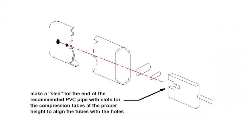

Inserting a compression tube in a mast? I built a sled on a long PVC pipe, and lightly taped the tube onto the sled. It slid exactly into place. Insert bolt, pull and remove sled by breaking tape...

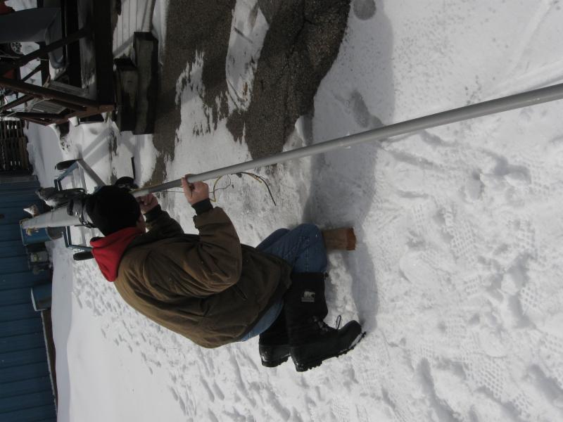

Phil, yes it can be done but we made the fatal mistake of having the wire tracers or lines in the mast for pulling new coax and new wiring in, this got all tangled up as I spent 2 hrs in the freezing cold just trying to get the old one pushed out.
Just before I thought about taking a sawzall to the mast and a can a gas to the boat I realized I was fighting my lines, Pulled that stuff out and old one pushed out new one (2) new ones pushed in on 3/4" pvc electrical conduit with v notch and electrical tape holding bushing on with the better half with a eye on the holes and we were done!

Glad you got it done. Here is a pic I drew of eeh sled I built. Sorry, I should have shared sooner. This was a push into place and then walk arond and poke bolts through process. I did it solo.

Hey Phil, that little sled thing you built/used is cheating. I mean really now!!! That completely eliminates the fun, vocabularly improving, process of trying to blindly move and position a snugly fitting pipe on the end of a 20 foot wobbly piece of pvc.
Actually, that looks pretty handy. That might even encourage putting the two compression posts in there . . . in the right order too!!!
