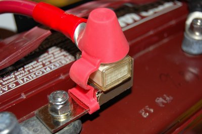

Separately, Davidasailor said "There’s probably also no fuse at all between the engine and the batteries". That's probably true but that doesn't mean there shouldn't be. See mainesail's articles at marinehowto.com about battery bank fusing:
Make a contribution if you can. If you are unfamiliar with the articles there it is probably some of the best free advice you can find.

Stu, I'm not clear from your comment what you mean but to clarify mine I was referring to mainesail's articles espousing that the battery wire should be fused within 7 inches of the battery. So to me that means before it gets to where ever it is first going, be it the battery switch or anything else. In my mind the battery is connected to the engine through the starter and thus the battery is connected to the engine, albeit indirectly. You can look at it however you wish.

There is no "fuse box" on a Catalina 320. You will have an electrical panel with breakers at the nav station and it may have your 1+2+B switch (that's where mine is located). You may have a fuse or fuses on or very close to your battery terminals (one for the house bank and one for the auxiliary battery) but I doubt it. They are not standard issue. Boat production did not fuse the battery cable, but the previous owner may have. I think we are all very skeptical that your starting issue is related to a fuse. It's not likely at all. You'll have to describe your system and the difficulty you are having in much greater detail.
