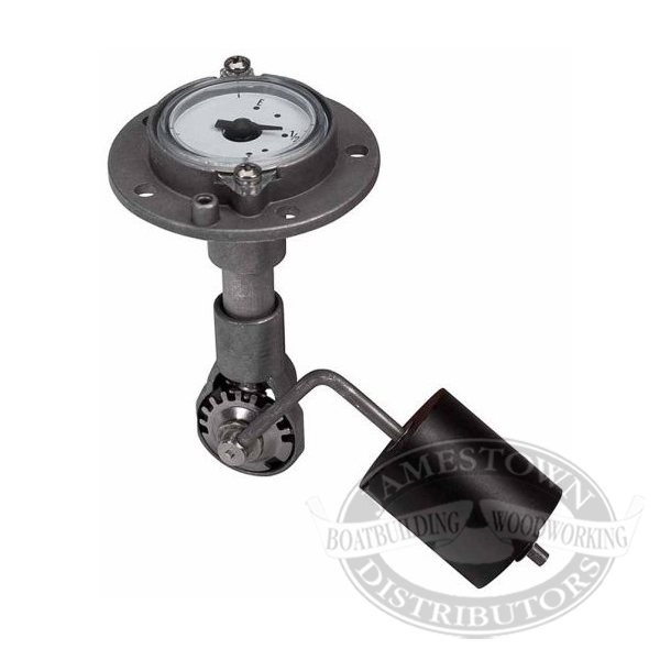

It looks like you have a mechanical fuel gauge, similar to this one:
I'd suggest just removing the 5 screws and pulling it out to inspect it. Maybe there is something just gumming up the gears, or perhaps the float fell off. Worst case, you could replace it with a new one for $49.
Alan...this looks like an exact match. (Minus a little grime and a few dings). Thanks for the analysis and feed back.
