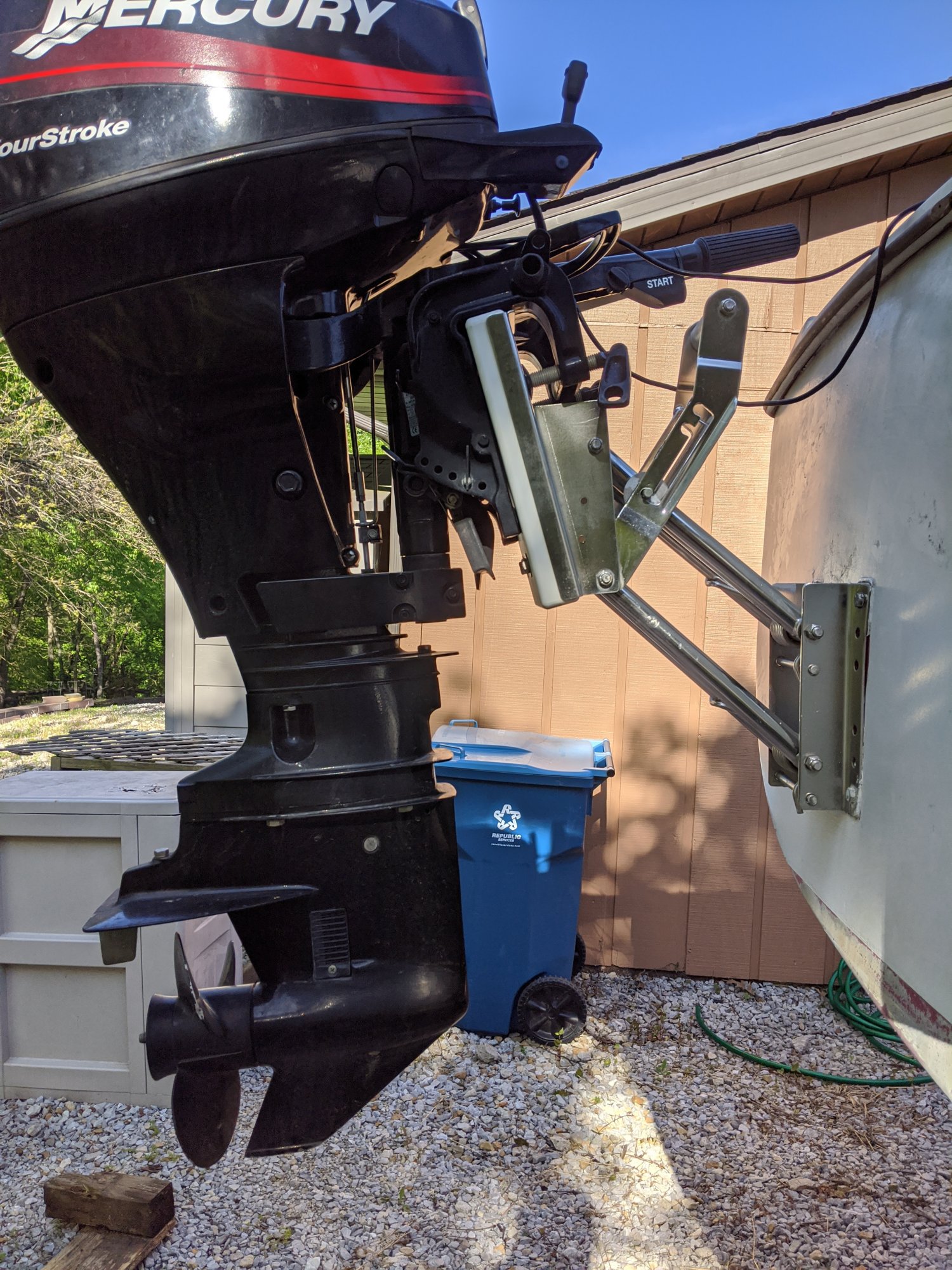

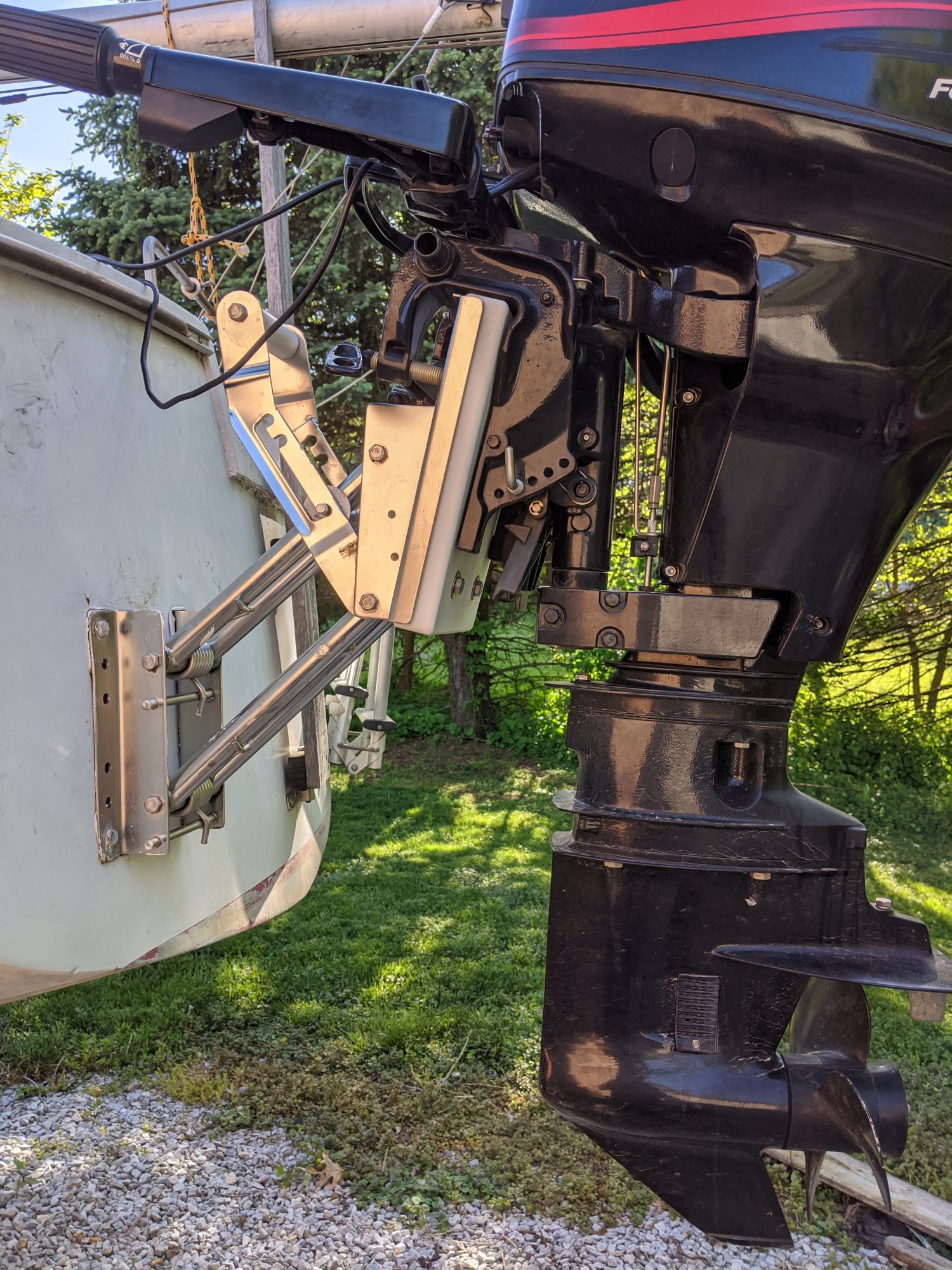

the outboard motor was pointed straight ahead so as not to affect the steering
The outboard motor could be the culprit. You should be able to raise it with the mounting bracket.
Then lilt it so the leg and prop are clear of the water.
Even if this is not causing your steering problem , it is considered "bad form" to sail with the leg in the water.
Best of luck with sail trim, too.
P.S. I would not tow the boat with the motor mounted as per photo.
gary
Well heck, I didn't know it did that!
There are a few settings on the lower part of the motor that I really have no idea what they do. What do I push / pull to make the thing tilt?

I am guessing 10 - 15 HP (number 12 down from the top.) these engines share a lot of similarities even if the capacity is not the same.
Download from here and go to page 30. there is a description of the tilt mechanism.
