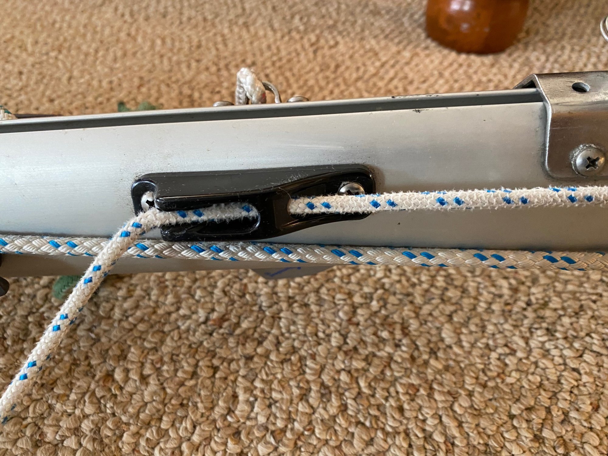

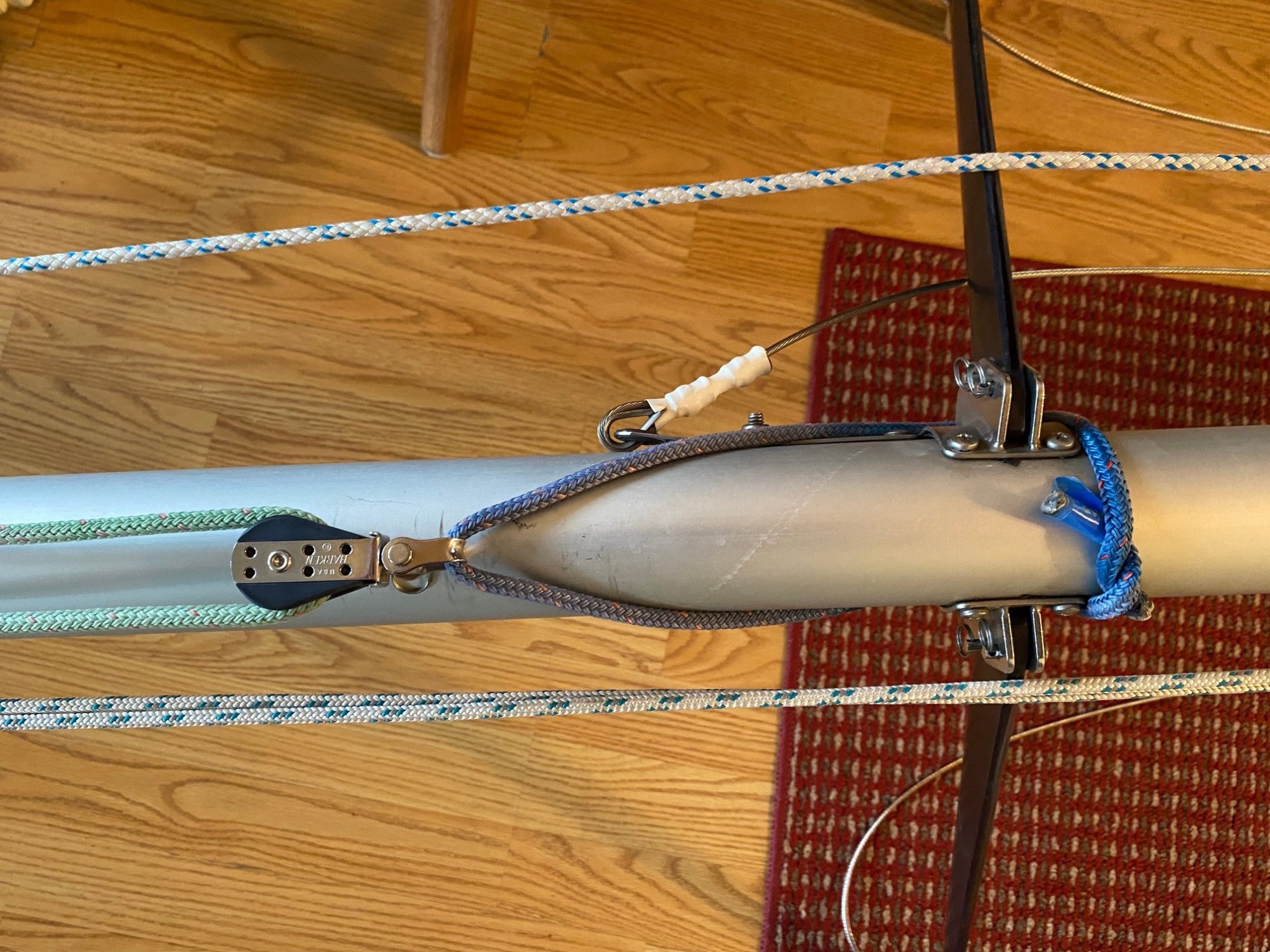

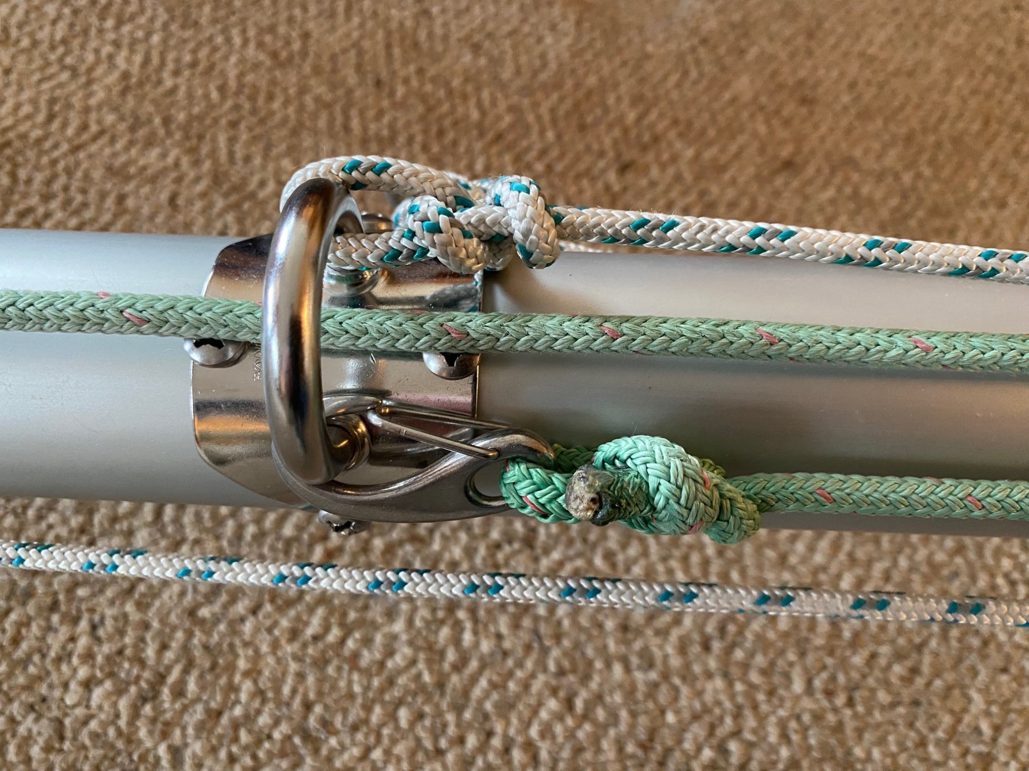

Hey there, I am new to sailing and just purchased a 2004 Catalina 16.5 and had a couple rigging questions. For the most part I’m comfortable with everything except a few lines attached to the mast that I’m unsure of what they’re for (see pictures and description below). Thanks for your help!

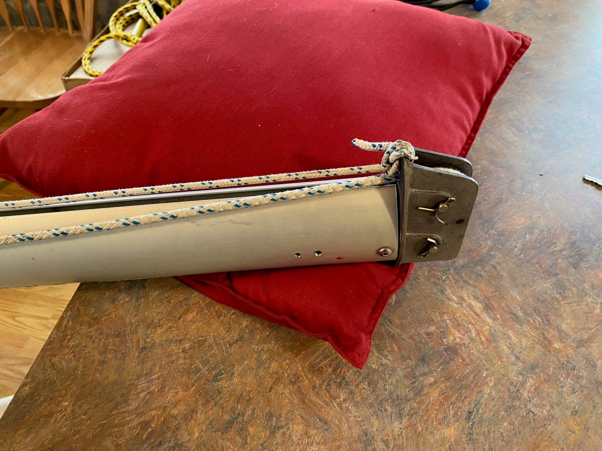

LINE #1
The boat has a FurIing system for the Jib so I’m wondering if this line is a halyard for a standard jib?
1st picture
Port side toward bottom of mast (Below)

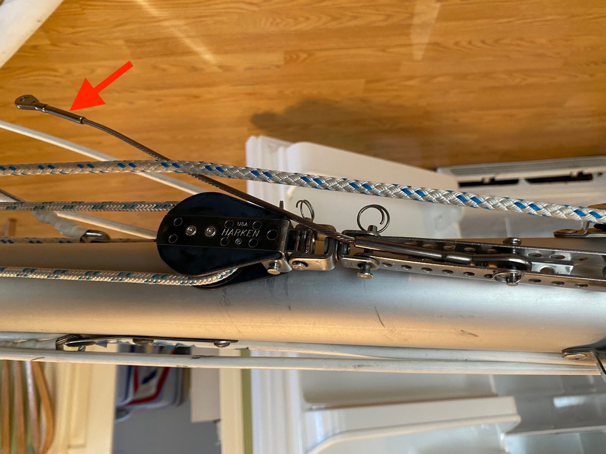

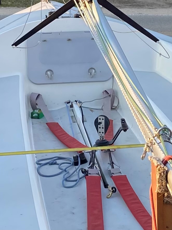

2nd Picture

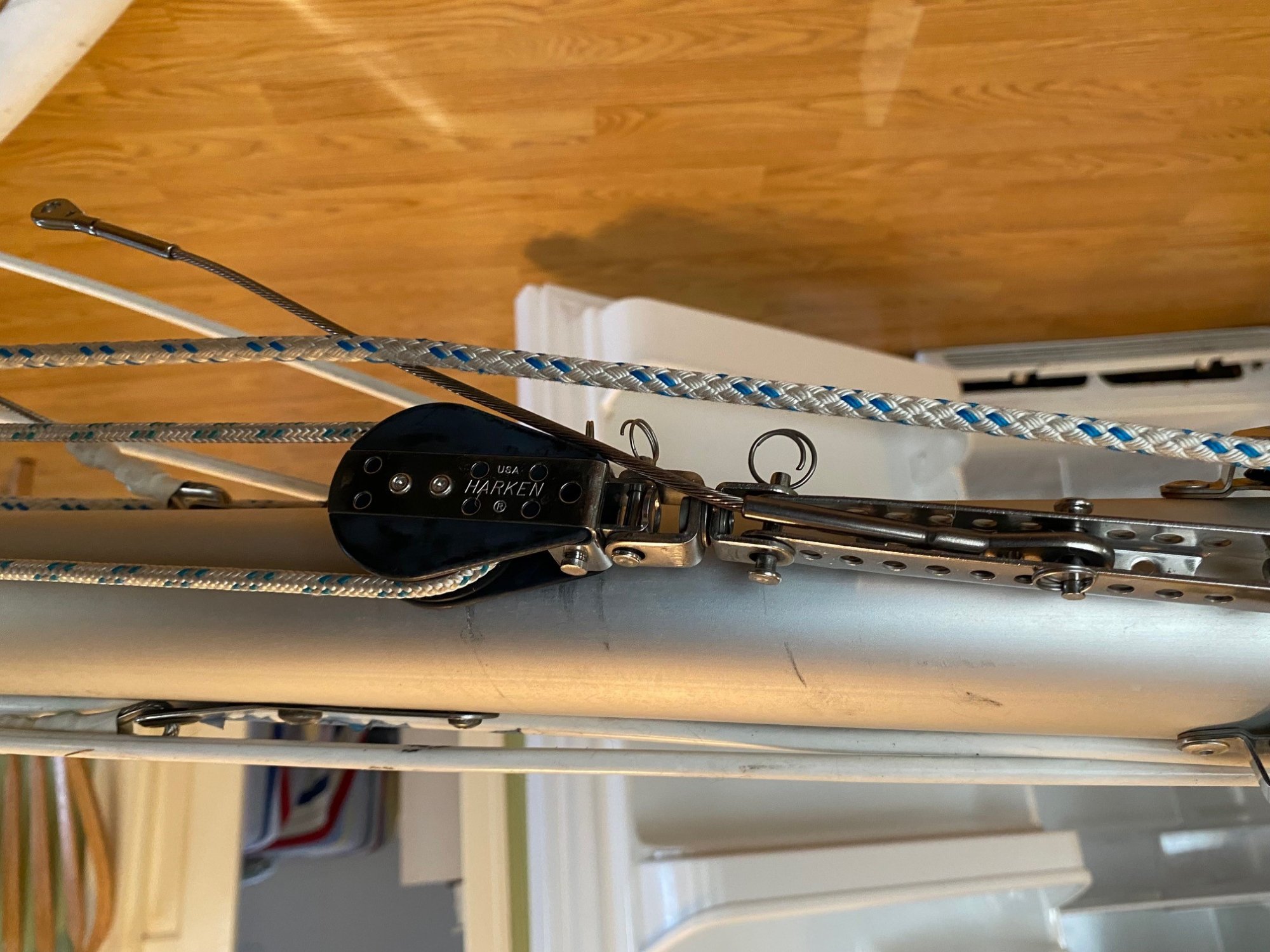

Forward side of Mast towards top – line goes through the block (Below)
3rd Picture

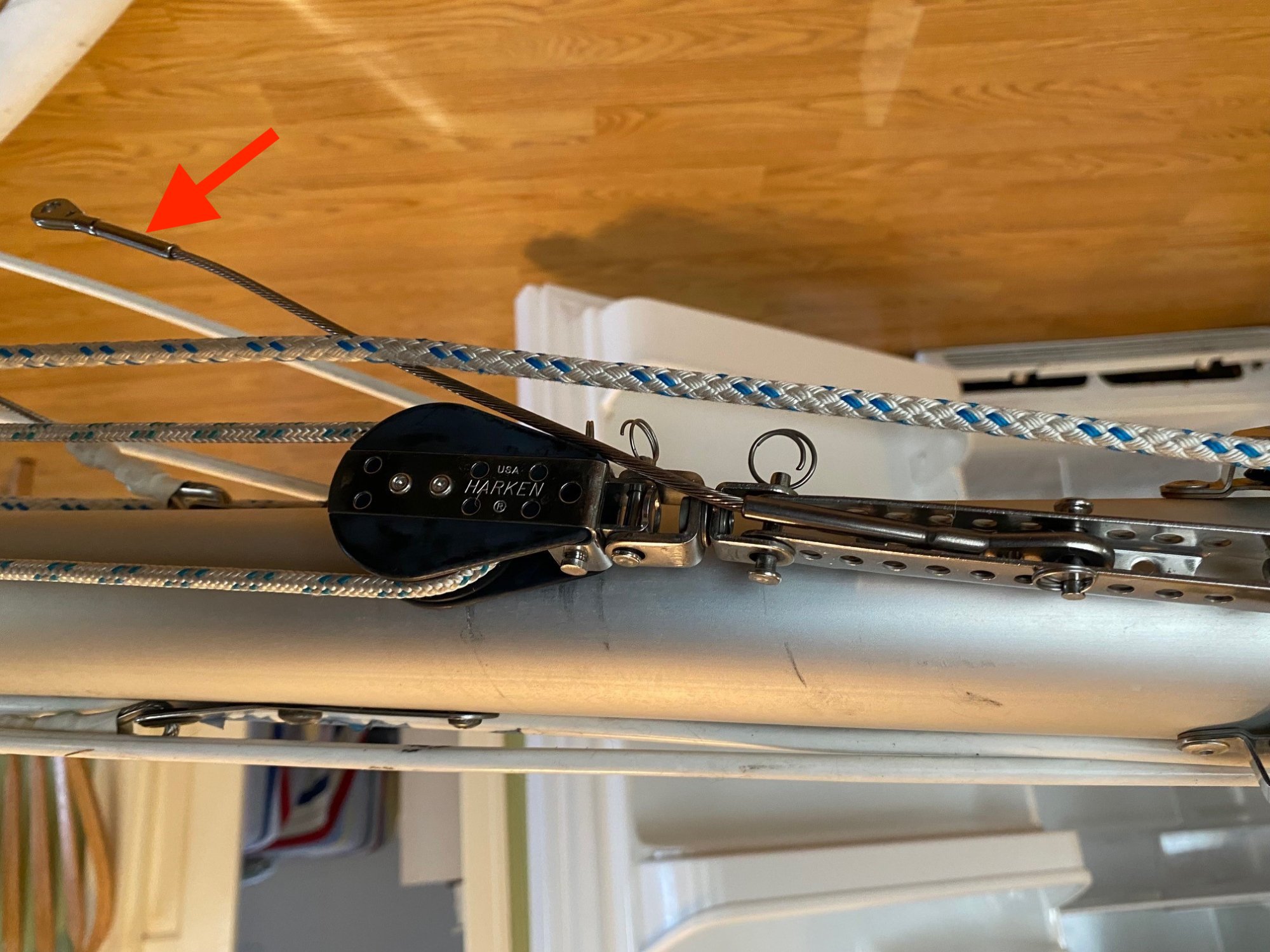

Forward side of mast towards bottom – line is tied and has snap hook on end (Below)

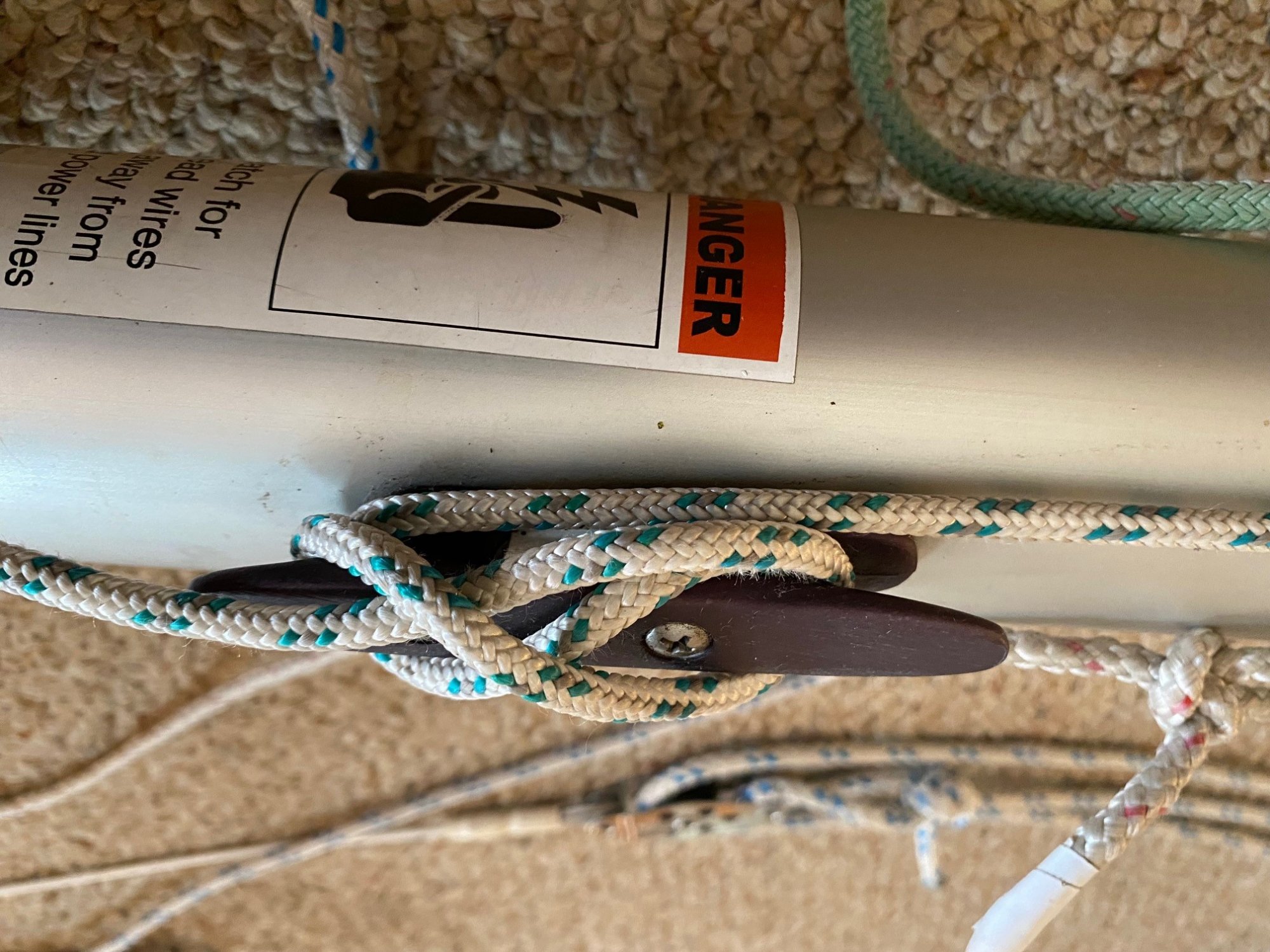

LINE#2
Is this a line to hold the boom level?
1st Picture
Starboard Side near bottom of mast. Bottom of line is in a clam cleat (Below)
2nd picture
Aft side of mast . Top of line is connected to the top of the mast (Below)

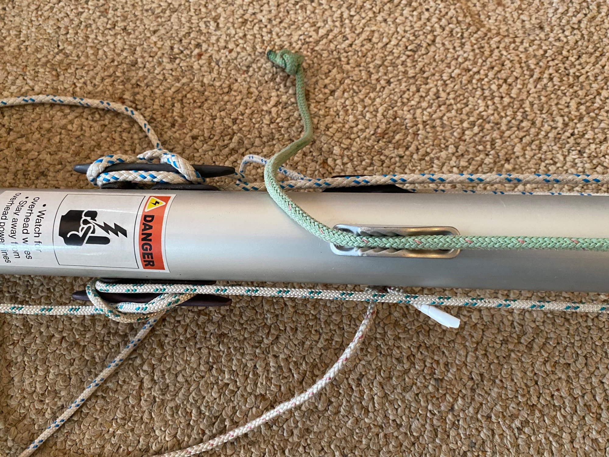

Line #3
No idea what this one is for
1st Picture
Forward near bottom of the mast. Line is in a clam cleat (Below)
2nd picture

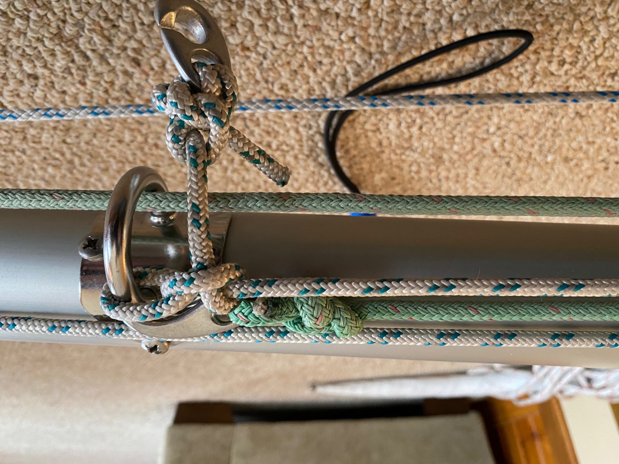

Line (green) goes through a block held by a rope (blue) that goes over the spreader bars (Below)
3rd picture
Rope comes from block in previous picture and is hooked on this loop (Below)

Line #1: looks like a halyard for a spinnaker, asym, most probably.
Line two: looks like it might be a topping lift, just as you thought.
Line three: don't know. Did the previous owner sail with a radar reflector or hoist an anchor light at night?
I'm not familiar with your boat's rigging, but those all look like they are owner installed, maybe not the a symmetrical halyard.

The image shows a Catalina 16.5. It shows that the jib is fractional. It means the jib attaches to the mast somewhere beneath the mast head (top of the mast).
You mention a Furling system. Which one?
Furling systems often are over a shroud (a wire that runs from the bow to the mast). Sometimes not. Your image #2 shows a black wire with an eye. That leads me to ask is that to be connected to the shroud? The mast end attachment of the furler. If so then the block in image #2 serves to carry the jib halyard. The sail inserts into the furler and is hoisted using the Jib halyard.
Image #3 That is a "JAM" cleat. Often used for lines that are in frequent adjustment. A Jib or Main halyard are to be secure. The Jam Cleat is used for something else.
Just a guess, it could be to used to help you hoist the mast. Since it is in temporary use a jam cleat makes sense.

Third line looks like it could be a spinnaker pole topping lift, though the blue line looped around the mast at the spreaders makes it look a bit less permanent than standard. (Looks like it should be re-tied, in any case.) Agree with John that it could be a temporary setup to help get the mast stepped.

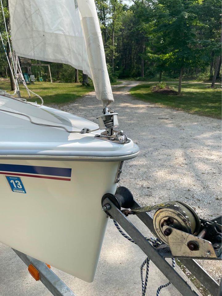

Good info John, thank you. The furling system is over a shroud. The attached picture shows the end that attaches to the drum (?)
24,926
As a guess that looks about right. What about the other end of the shroud?
24,926
Do you know the make of the furler? Perhaps it is printed on the drum.
Could it be CDI?
That answers some questions but leave others unanswered.
24,926
Ok.. Looked for a manual on the System 350. Problems with the Schaefer site.
Got this on the site:
Convenient and reliable "Free-Furling" allows you to quickly set or furl your jib or staysail without leaving the safety of the cockpit. The sail furls and unfurls on its own luff wire and is easily removed for use on trailerable boats or for light-air staysails and gennakers on larger boats.
These lightweight swivels utilize clear anodized, marine grade aluminum and contain hi-load Amoco Torlon™ bearings to ensure smooth and reliable performance. Precision computer machined races maximize bearing contact area for ultimate strength and durability under load providing you with safe, easy furling.
it is typical of furlers for small boats. I would roll out the sail in your living room (hopefully the family is ok with this) and examine how it is attached at the top to the mast.
Your image shows a wire. I am guessing you have an attachment point wrapped in the sail at the head. The halyard I would think is used to hold the sail/furler in place.

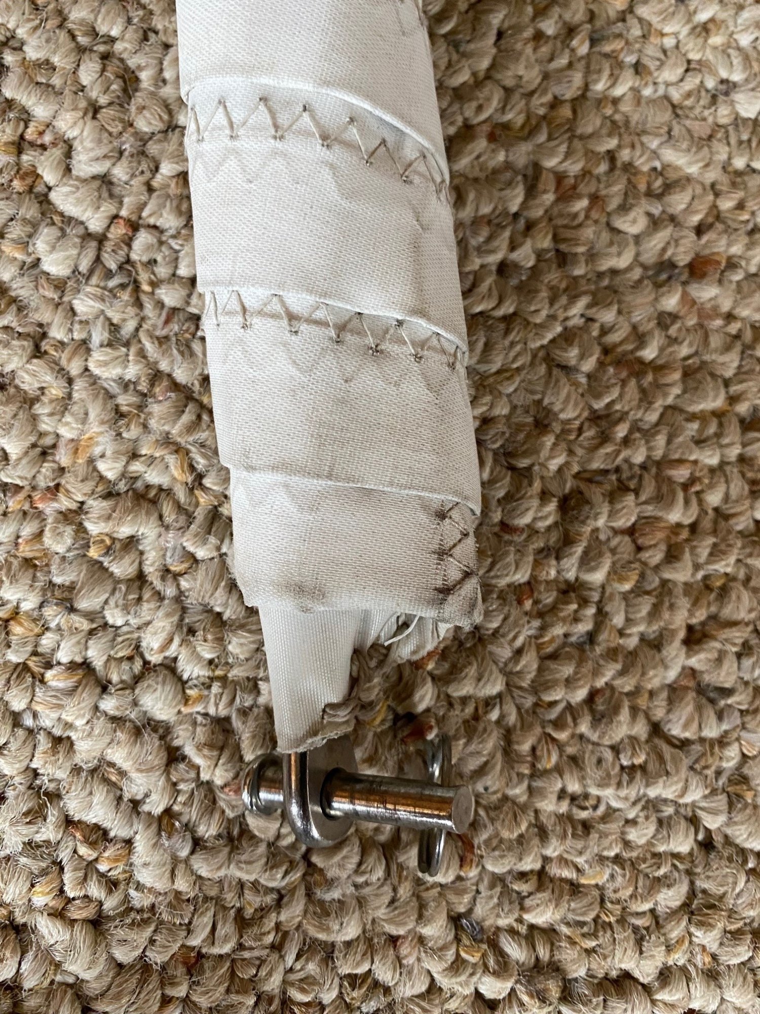

Your image shows a wire. I am guessing you have an attachment point wrapped in the sail at the head. The halyard I would think is used to hold the sail/furler in place. View attachment 214283
Yep, there is an attachment in the sail head that hooks to that point. It does make sense that the halyard is holding it in place. Any reason why it should be held in place?

Do you have a picture of the top of the jib?

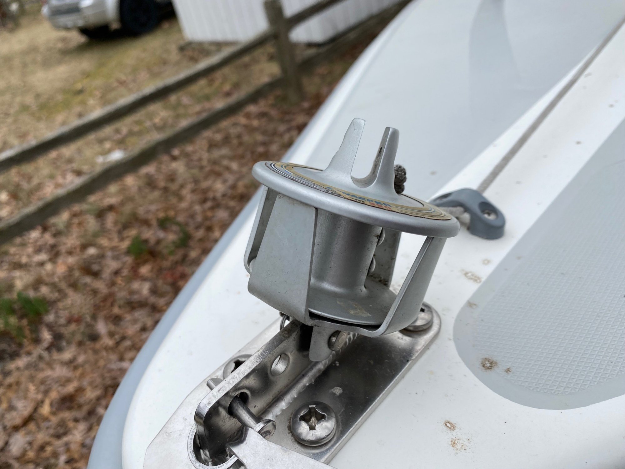

Take a photo of the furler drum and post it. I was a Catalina dealer now retired introducing the 16.5. Is your boat a swing center board?

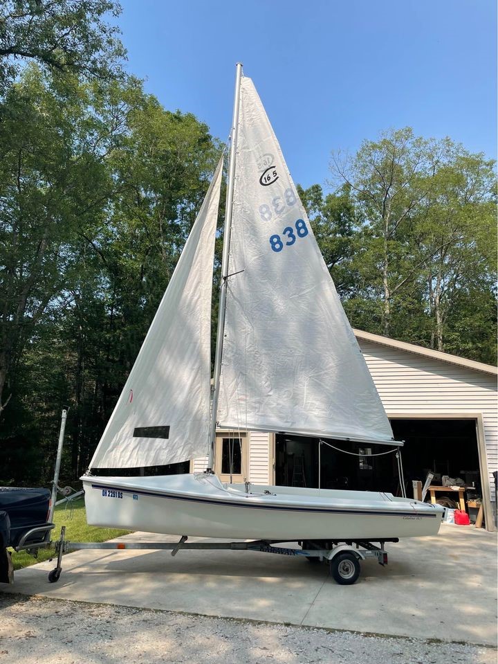

Below are a few snaps of the furler drum and entire boat as well as a picture of the centerboard.
Oct 19, 2017
8,193
That block on the bow, ahead of the furling drum, that looks like a tack block for an asym.
