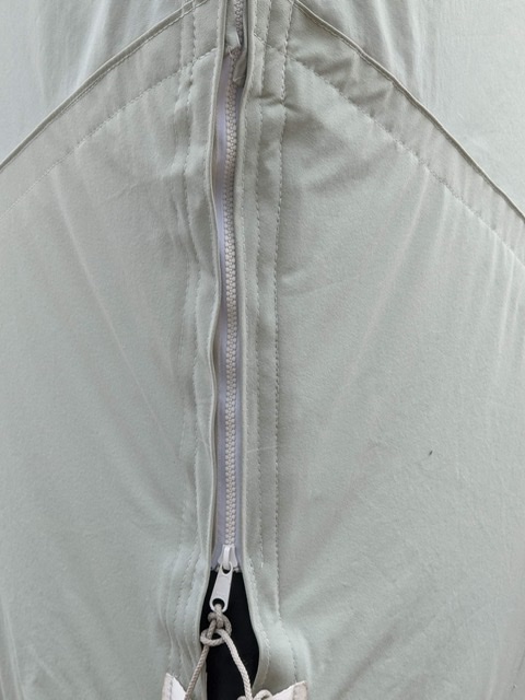

I took some photos of the zippers before removing...

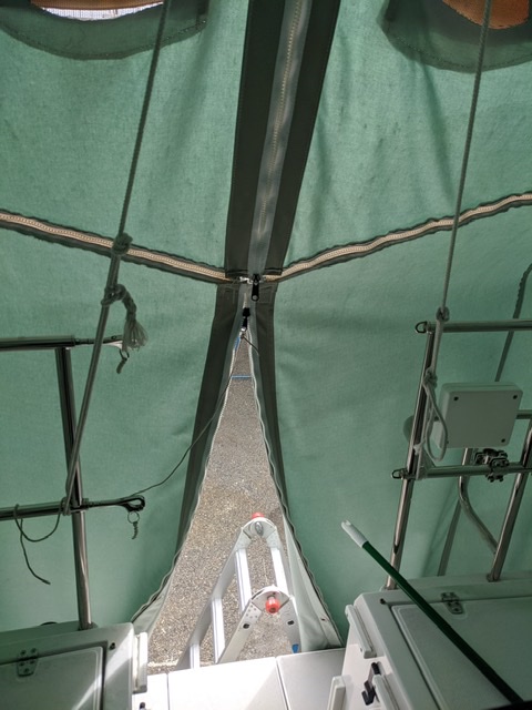

I took some photos of the fore and aft zippers where the lacing is on a standard Fairclough. Makes getting in the boat during the winter much easier than using the side door

Solstice, thanks for the pictures. Simple, elegant and why didn't I think of it?? In the winter, I usually board thru the rear with a step ladder and letting down the rear boarding ladder. It has always been a PIA to untie and relace thru the grommets. Can't wait to add this improvement.

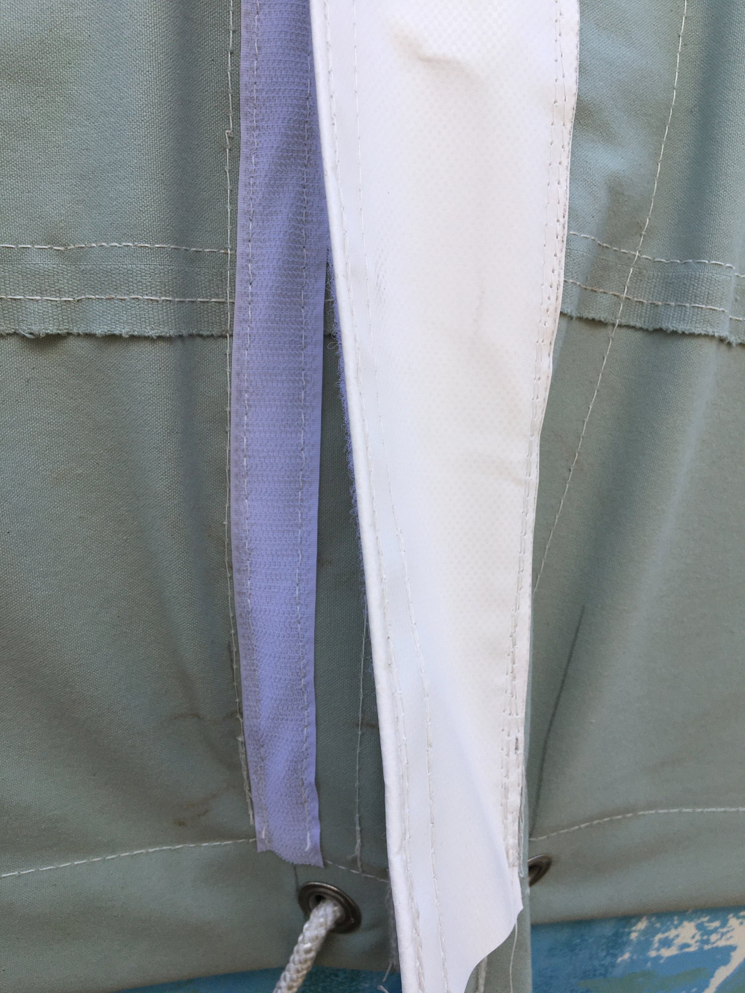

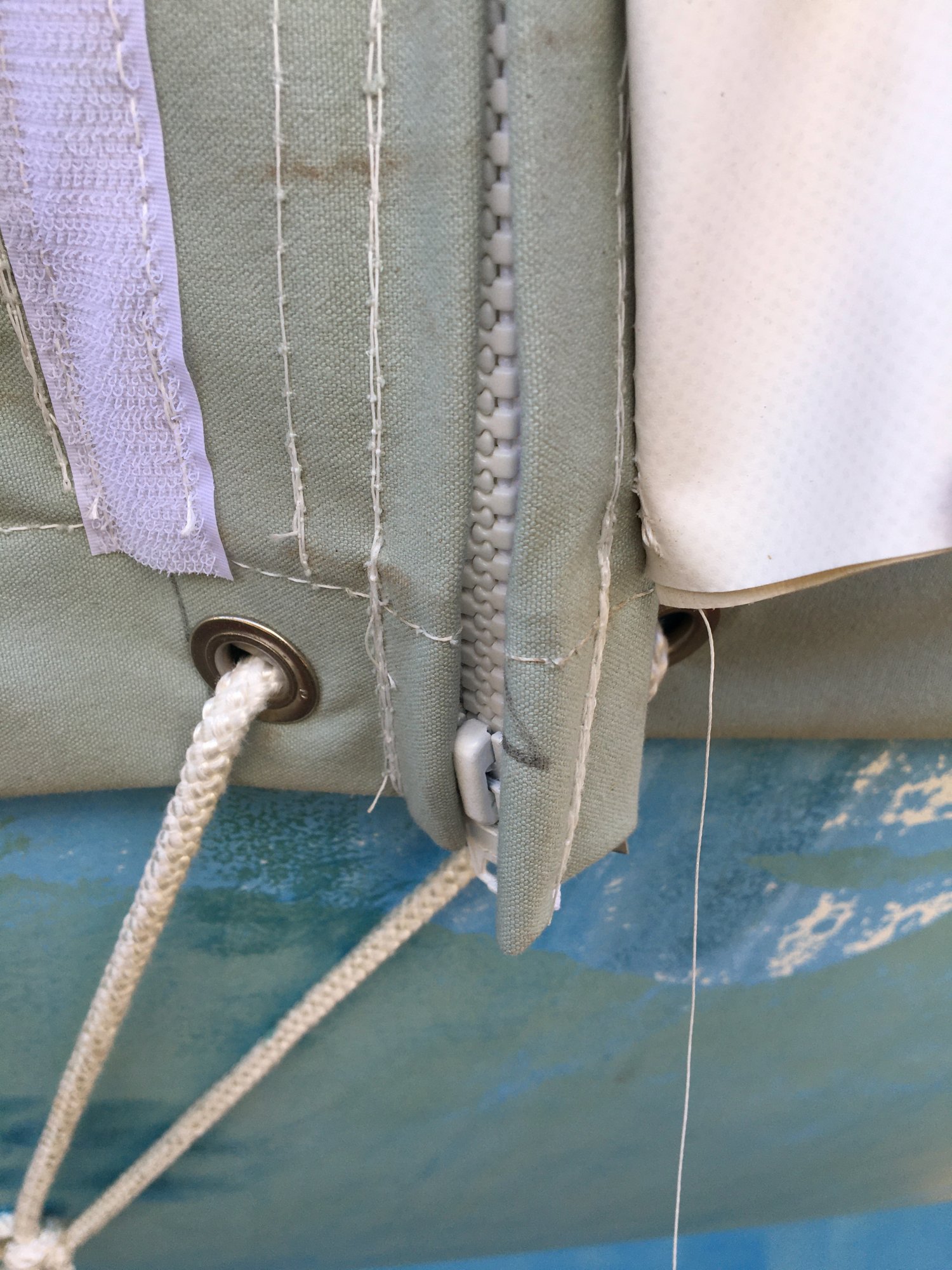

And more zipper photos. These are details of the zipper install. This splits the cover in half. The Velcro is a belt and suspenders approach.

Very nice. How does the bow end zipper around the anchor roller? Do you have a wider view that shows that detail?

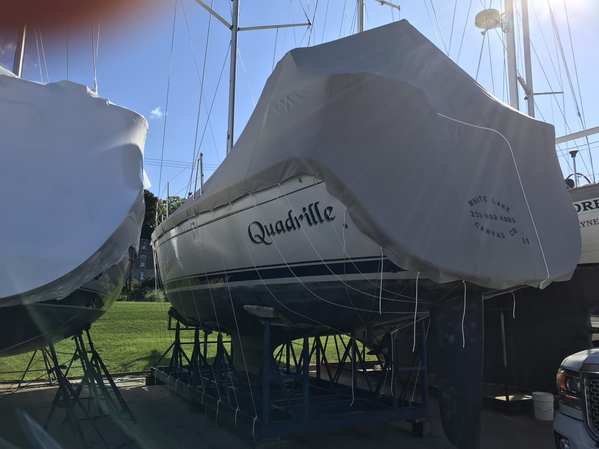

I had a new one made last fall. The previous one bit the dust after 10 years.
It is made in 3 sections using zippers to connect the sections. Zippers also to fit around the shrouds. Uses the boom as the ridge pole behind the mast and a 2x6 with a support in front of the boom.
The best part is that the company that make them also provides a service and in the fall they put the cover on for me. In the spring they take it off, inspect and repair if needed, then store it for the summer. Since I sold the house and moved to a condo it sure is great that I don’t have to deal with storing it.

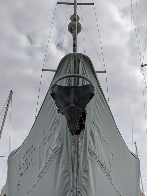

For the bow, there is a zipper from the forestay to the top of the anchor roller and another from the bottom of the anchor to the water line. Just replace the openings where the original grommets were.
This definitely doesn’t impact breathability but certainly keeps wind driven water out much better.

Here is another pic of the bow setup. I have a couple more but having trouble downloading at the moment..

Very nice. I originally thought that the entire anchor would be enclosed. Your setup is much easier and allows for breathing.

The guy that makes them here in our area has the cover come down inside the bow pulpit and the stanchions. Makes the angle of drop steeper so that the snow doesn’t build up and put pressure on the stanchions. The anchor is outside the cover as well.
