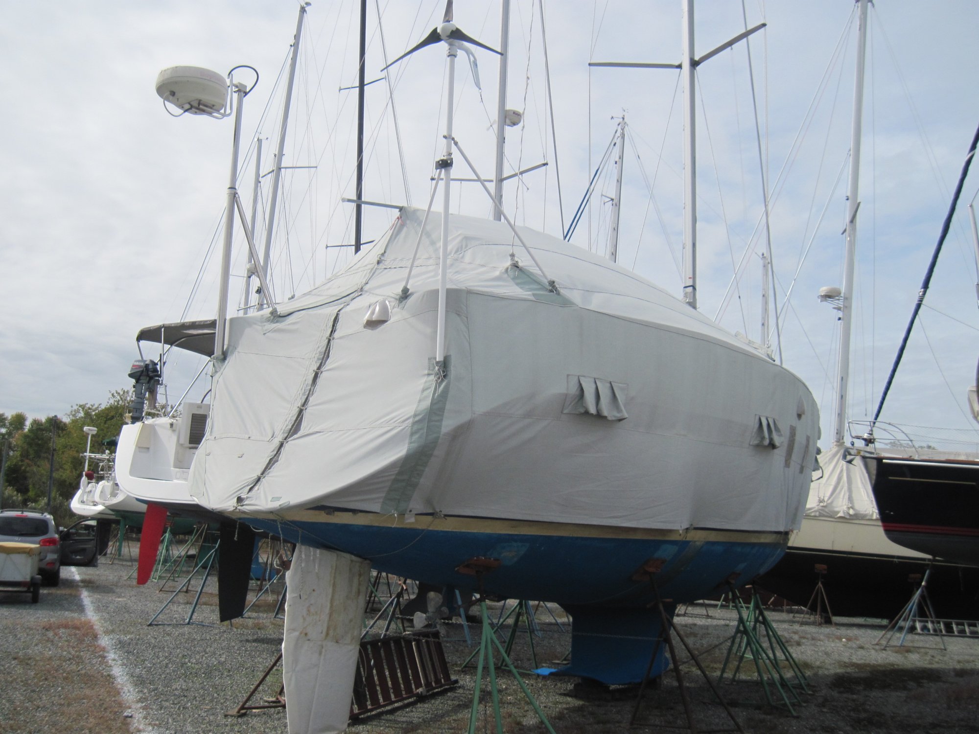

I bought a Fairclough cover the first year I bought my boat. I have used it for the last 22 winters. I have replaced/added zippers to accommodate wind generator and radar poles and have done re-stitching as required. The framework is in like-new condition.
It is on from October to April- about 6 1/2 months each year. I think it has been very beneficial in preventing sun and UV damage to the gel-coat.
This cover extends to the waterline and I can work inside warmly on late fall and early spring days. For your location in NJ I would think a cover would be a benefit. I don't know if covers are used in the south, but we are considering a move to SC and one of the advantages I was anticipating was not having to install and remove the cover each year. On the other hand if you boat is going to be on the hard in the south, and given that the potential for sun damage is greater, I would think that a cover would be good down there too.

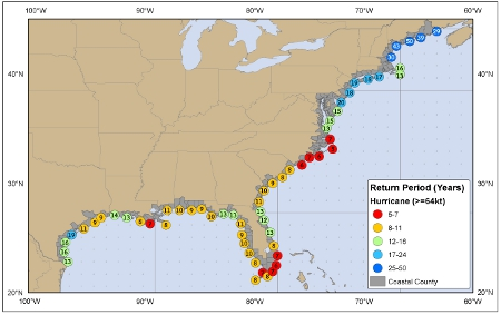

Many people leave their boat in year round and only take it out to bottom paint. It is not uncommon for there to be a perfect day for sailing in the middle of January. I went sailing twice in December, once in January, three times in February.. actually my avatar was taken in February... (now I'm just rubbing it in ... sorry).
Georgia has a lower hurricane landfall rate than does north Carolina ... and if you get down far enough you get into the 12-18 year interval region. What I have heard of people doing is paying a premium to be at the top of a haul out list if landfall is foretasted for you area.

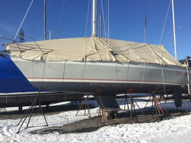

Check out North Shore Canvas.... I had a cover made for mast up storage and it fits like a glove with no frame.... 3 piece. Guy travels to take measurements... I'm on year 3 so it paid itself off..... And no polluting shrink wrap.

I store with my mast in, although the cover is designed for mast out as well. And it can be installed in the water or on the hard. I have done it all ways.
I have a wonderful friend who has helped me every fall and spring to install and remove the cover for the last 22 years. For my h40.5 the cover is in two pieces- one from the mast forward and the other from the mast to stern. They zipper together. It takes the two of us a full day to install- framework, wood strips, and cover pieces. Removal takes about 1/2 day.
If I was getting a new cover, I would have the aft piece (from the mast to the stern) made into two pieces that zipper together. Me at 73 yo and my friend at 71, the aft piece is right at our limit of handling.
