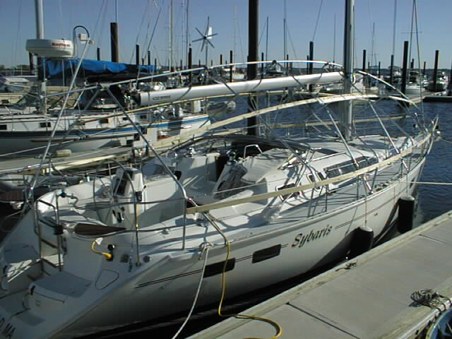

The framework for my Fairclough cover is made from 1" metal electrical conduit. Couplings connect the pieces together. If I were going to make a frame, I would use the metal conduit and not wood.

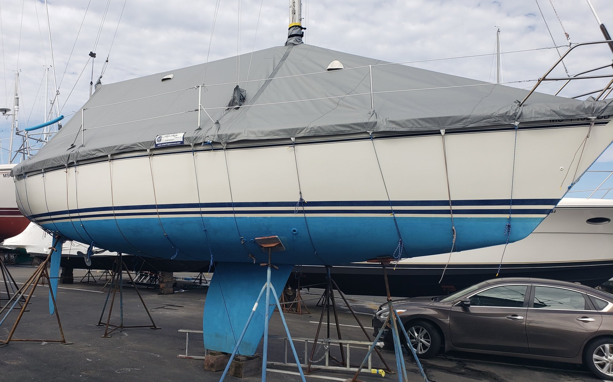

Three years ago I bought a deck tent cover from ShipShape Canvas in Duluth for $2,000. I have found it to be a wonderful piece of gear, using a very durable fabric, you can see in the photo have well it fits. After three years the cover is still like new, and has paid for itself versus shrinkwrap. It takes about three hours to install and remove, using the boom and whiskerpole for framing.

Second vote for ShipShape. Used it through 3 harsh, windy, snowy Kansas winters and it has held up extremely well. Two pieces zippered together. Get the door with a zipper! Two of us can put it in place in about 2 and a half hours. Hanging the sandbags (a must to keep it taut) takes another 15-30 minutes. Uses the boom and we have PVC pipe that we use for the framing from the mast to the bow. Takes about 45 minutes to take it off after the sandbags are removed. Very little wear after three years. Good ventilation.
The guy who runs ShipShape was very easy to work with - they already had a pattern for our O'Day - but still sent measurements. The cover fits perfectly.

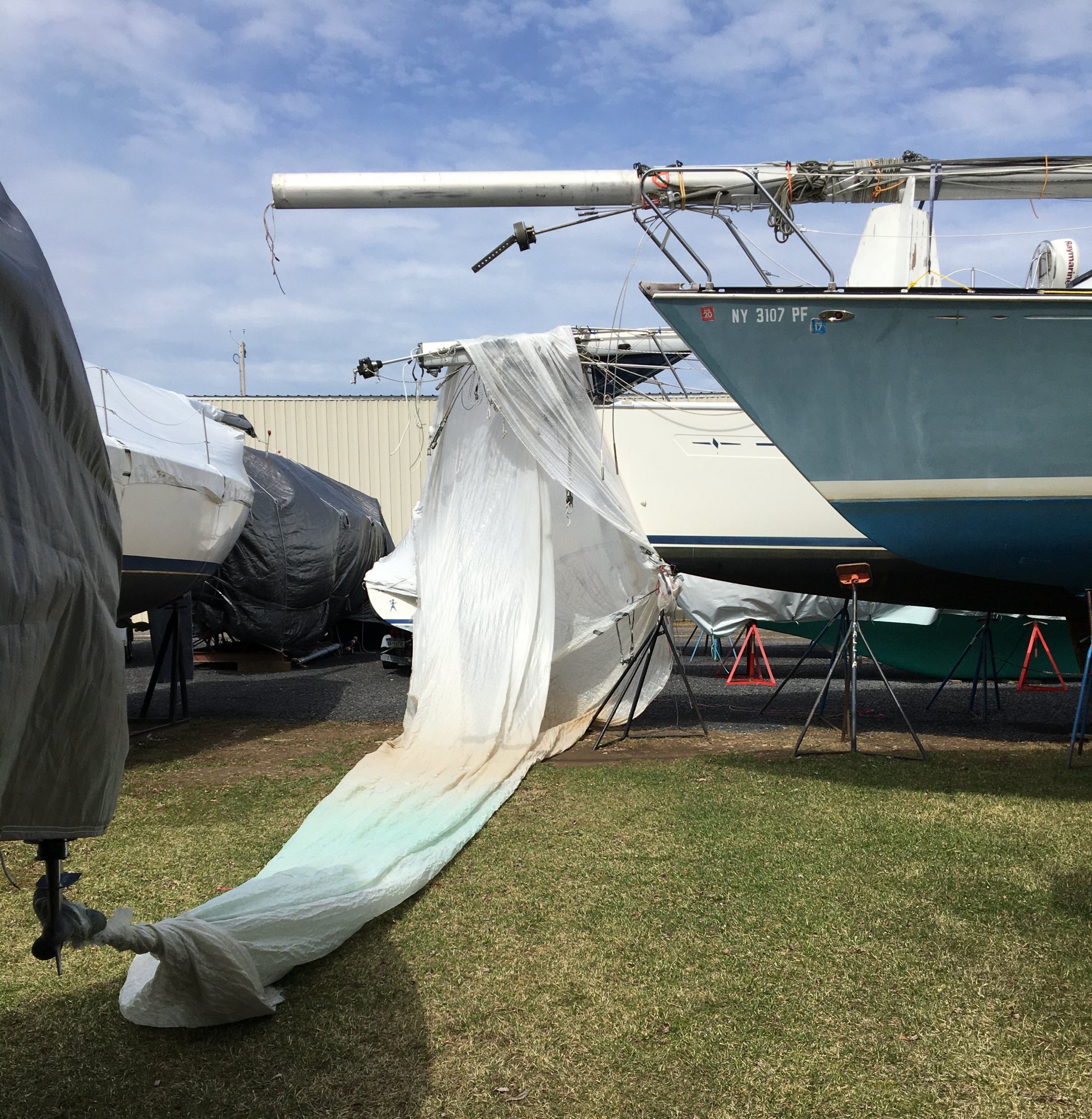

For those who wonder why lightweight tarps are a bad idea, here's a good example from my marina. Notice how it is wrapped around the prop on a neighboring boat and if you can see clearly it is wrapped around the forward jack stand.
