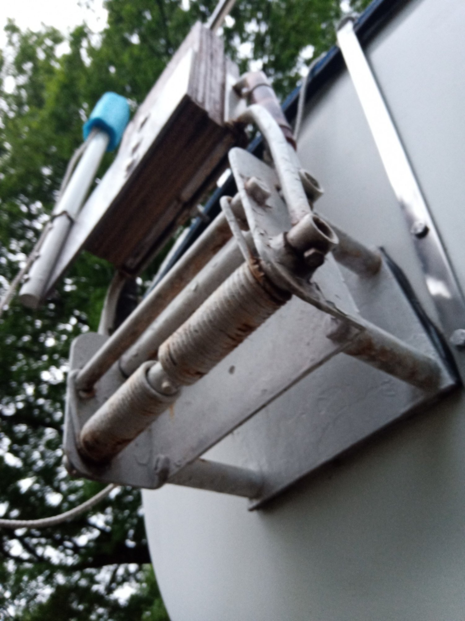

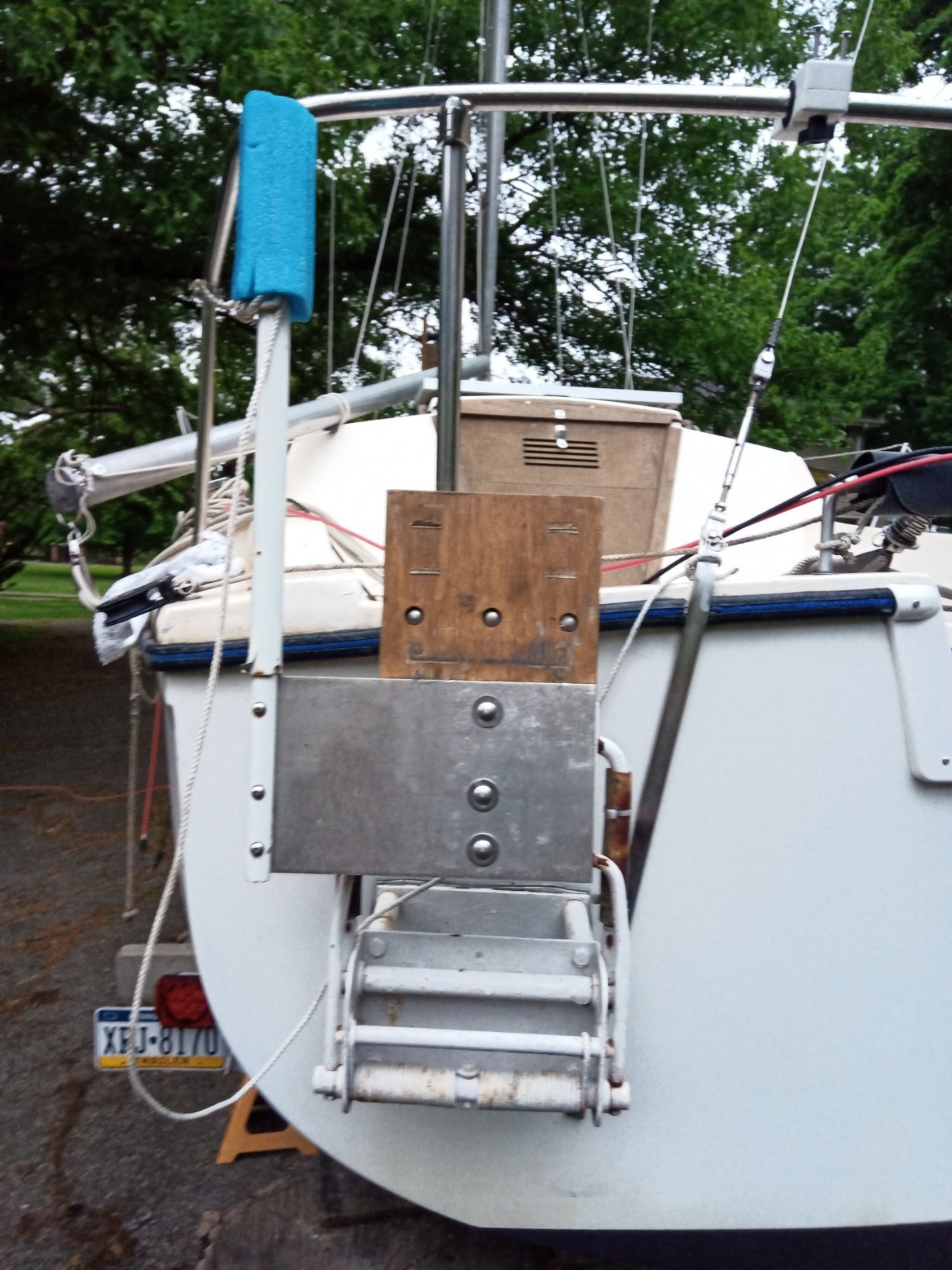

Can someone tell me whats going on with this old motor mount?
Sep 30, 2025
222
Catalina 22 Davis Hollow - Lake Arthur
This is on my 1971 C22. Just got the boat and know nothing about this motor mount. It wont budge? I put a lot of force on it and nothing... and was afraid to put more cause the vertical pole seemed like it was going to start bending. I know most have a lock but I don't see anything that resembles a lock at all? The boat sat indoors for a couple years so not sure if the springs are seized up and locked or what?
Also confused about the vertical pipe with the blue foam on top... It has a string tied to the boat and it can be lifted off the motor mount. I cant figure this out?
Wanna put in the water tomorrow but afraid wont be able to get my outboard down into the water?

It's really hard to say from here . However I will venture a guess. The plate moves backwards and down to rotate.
If it were me , I would be spraying PB Blaster everywhere ,that little red nozzle would fit .
I think the blue foam is a handle for pulling the outboard up out of the water .

Whats the foam for though? Its just like chinsy foam that would come off easily. Can you explain how that would pull a outboard up? The weird thing is that the rod with the blue foam comes off and has a rope tied to it. Why would the last owner make it so you have to take that rod off and whys there foam on it, lol?
I'll try to spray it but it feels really solid where it is. I'd be surprised if it was just that stiff...but I guess its possible.
Every motor mount has to have some sort of lock on it, right? Could the rod with the blue foam be some strange way to unlock it? I'm puzzled.
Oct 19, 2017
8,174

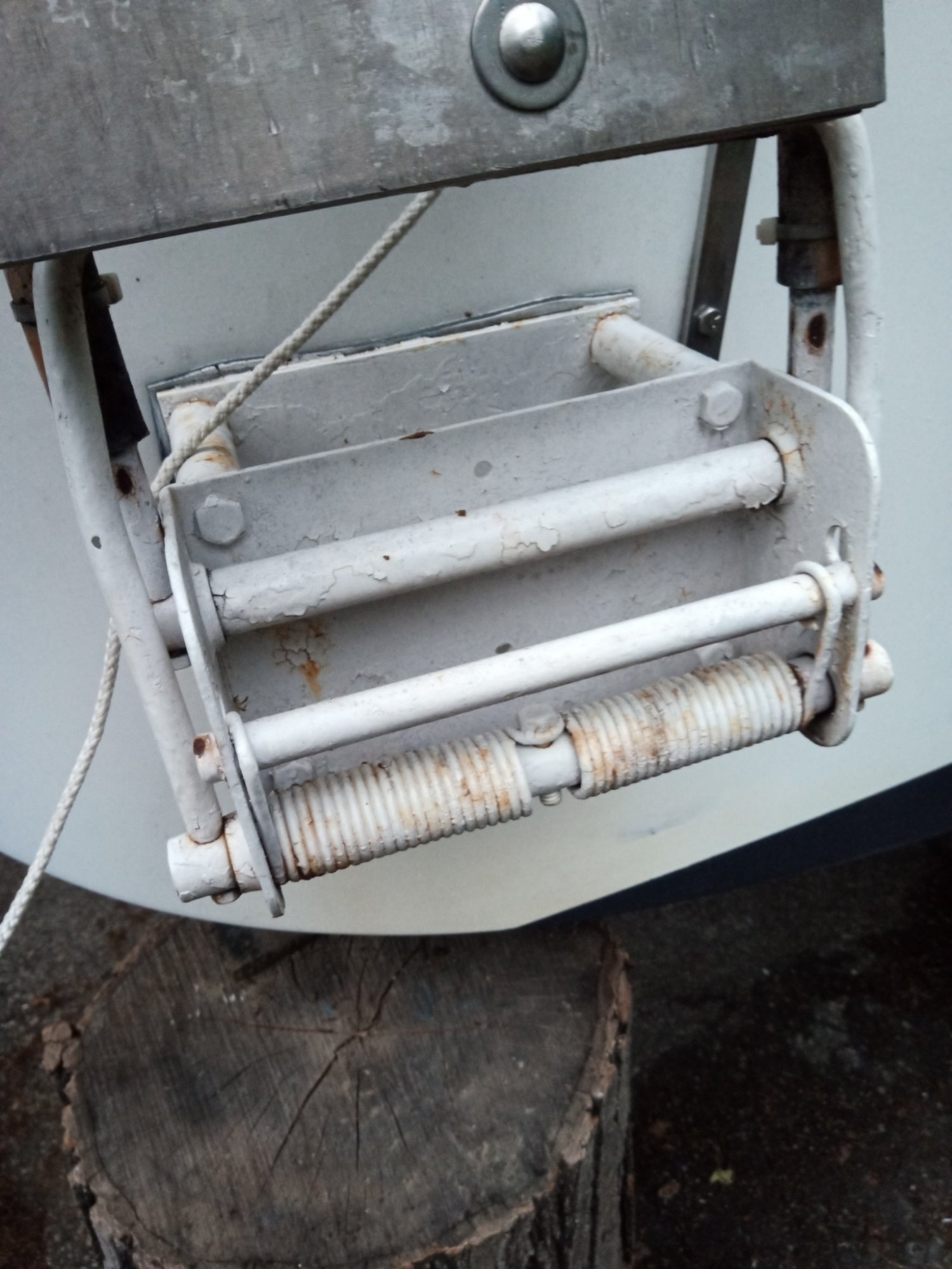

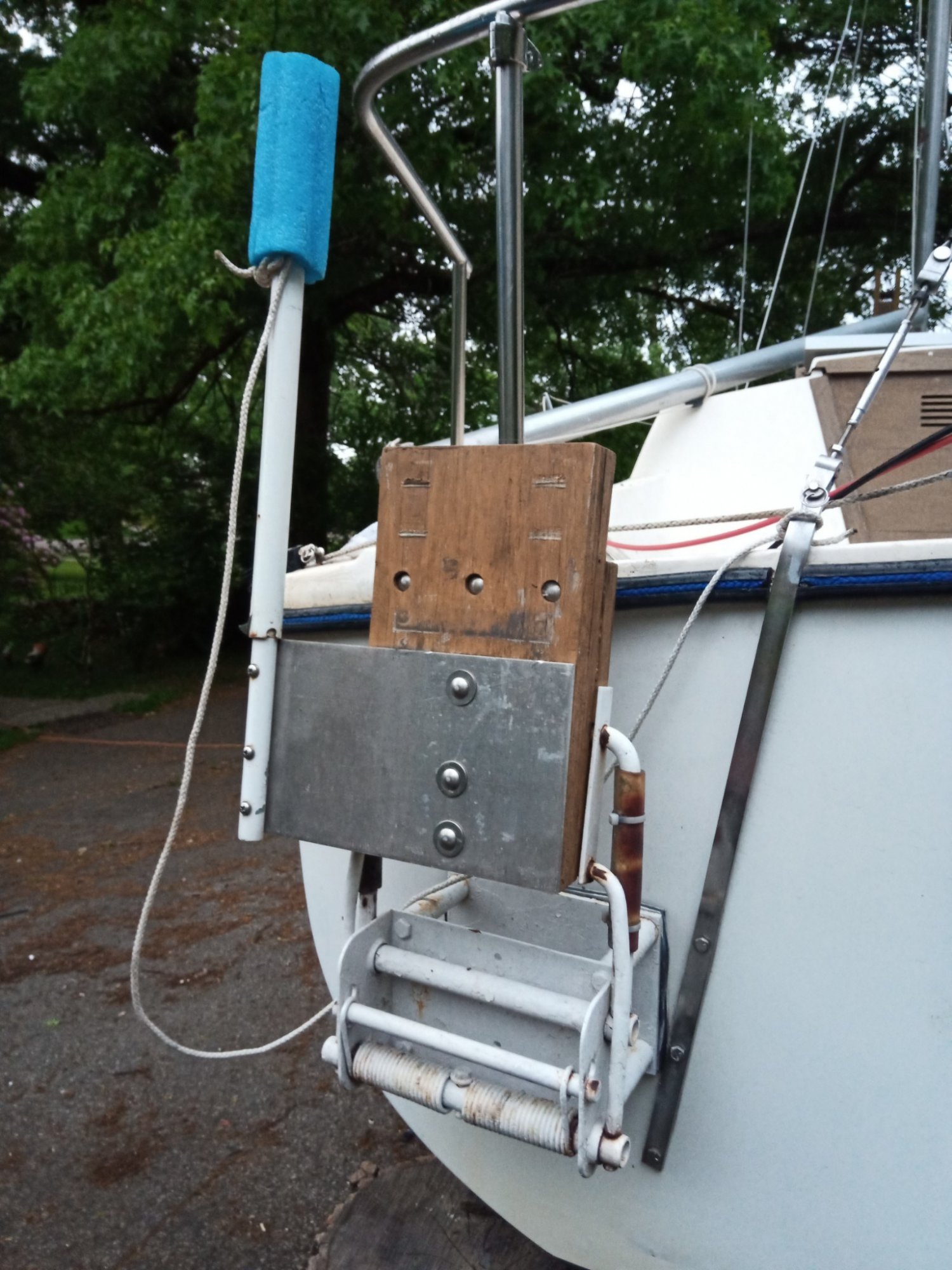

That is a very good set of photographs you've posted. It seems to show everything.
I don't see a locking mechanism, except for perhapse the cord connected to the vertical handle. I would guess the foam was to keep the handle afloat in case it was dropped in the water. It also looks like the spring may be binding on the port side, but the paint over rust can't be doing it any good.
A penetrating oil wouldn't be a miss. Maybe tap the ends of the spindles, particularly the one the spring is wrapped around, with a hammer.
To get the spring installed, it looks like the anchoring spindle is settled into a slotted hole on either end, the pressure of the spring holding it down. Try putting a couple of heavy clamps on either side of that bar and the top bar to flex the spring by lifting that anchoring spindle to the top of its slot and back down.
I have absolutely no experience with movable motor mounts, but If you can't budge it, it is likely a seized spindle or spring. Be prepared for the spring to break. Old rusting spring steel, in my experience, fatigues and snaps easily.
Good luck.
-Will
10,253
I think Will has it. Spray a good penetrating oil on all 8 pivot points where the swing arms pivot, and on the spring. Tapping lightly with a hammer will help. I don't see a locking mechanism on the mount. I have no idea about the pipe and rope thing Good luck !
24,871
I have been trying to understand the mechanical structure. I think you may be on to something with the pipe. The wound spring appears to be untensioned. My SWAG says pull the pipe down towards you, and the spring should be tensioned. The rope may be there to pull the pipe back to the vertical. Certainly, spraying the pivot points with penetrating oil will help.
That is a stout system. You may need the weight of the outboard on the mount to give you the mass to help put the outboard in the down position. It appears to work much like a garage door spring.

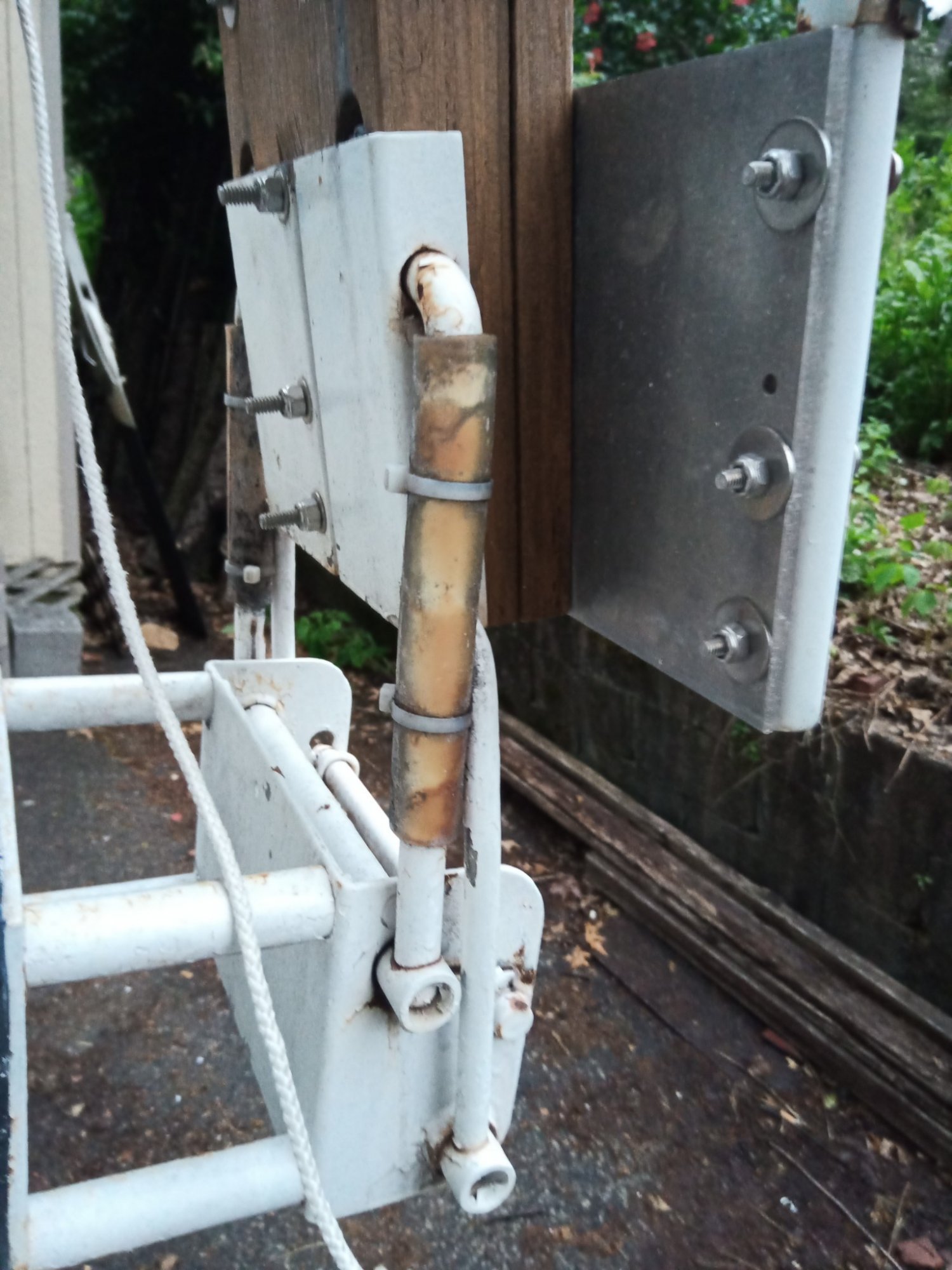

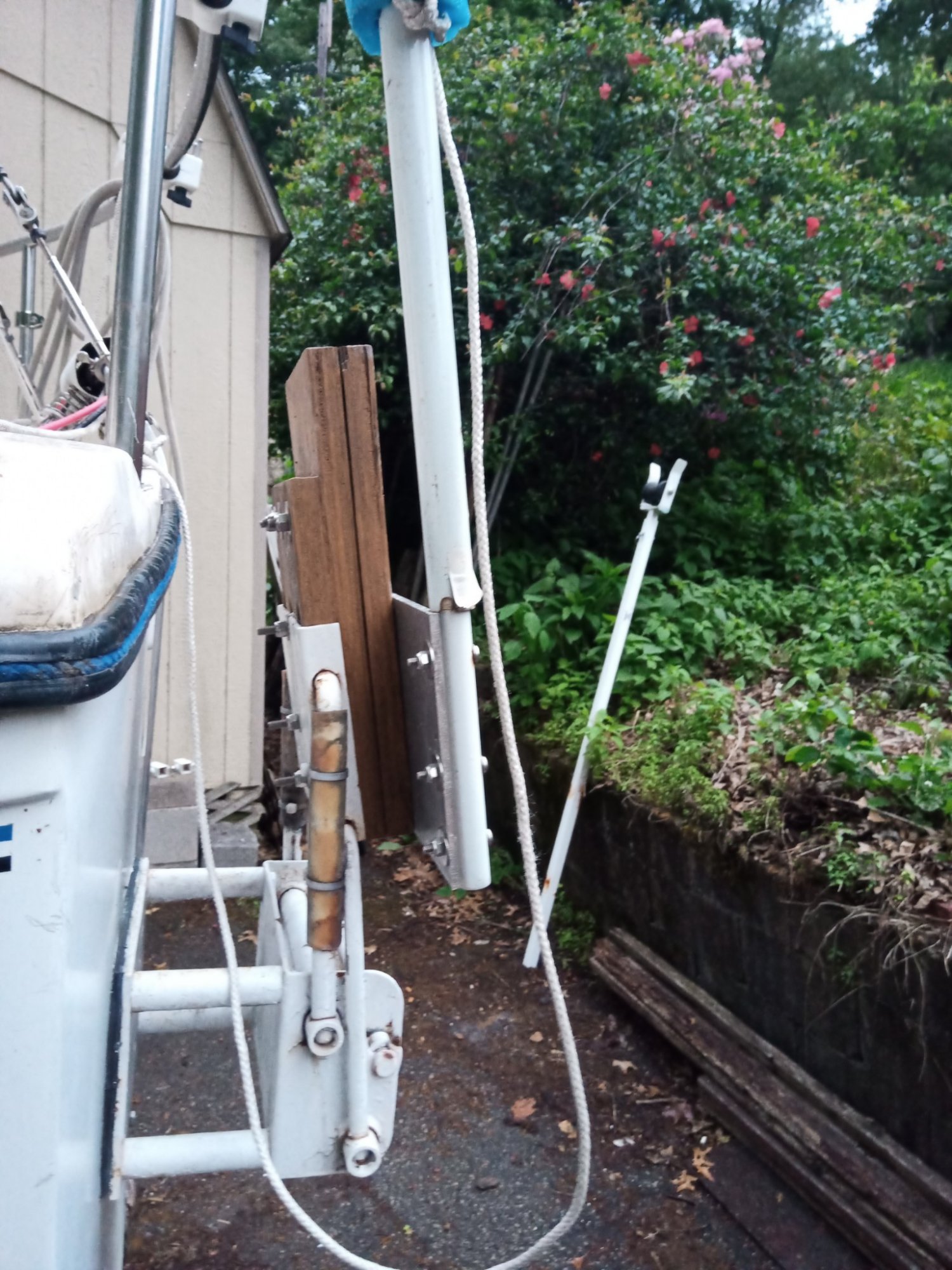

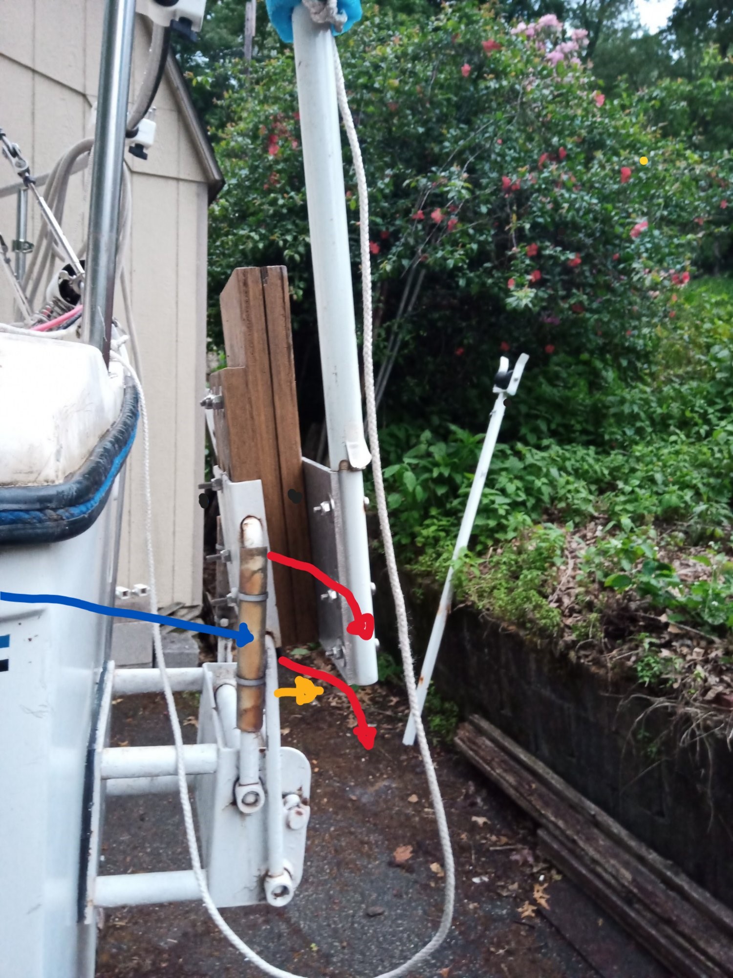

I finally figured it out. Its real weird. Not sure I can even explain it but..... I took it all apart and accidentally figured out how to drop it down. The 2nd horizontal bar, the bottom one, of the 2 that is behind the metal plate, need to be pulled super hard, by itself at least 2 niches in order to let the upper part of the structure to (get by) it. It takes all my strength, with rope, to pull it out 2 inches!! Then I guess he just stuck that bar (with the foam) in between them so he didn't have to pull like the dickens just to get it to go down each time. Weird but glad i figured it out. Thanks for all the suggestions.

You'd think it would be.... But its actually harder because the motor weight doesn't help at all, actually makes it more awkward, to (pull) that lower bar out the 2 inches it needs in order for the top one to get by it. It required a lateral pull for the bar, where the weight of the motor is downward so it doesn't help. I'll get some photos next time I'm on the boat.

I don't see anybody recognizing this mount as a commercial product and it looks like a Rube Goldberg contraption to me, with all the home-made components. Only the spring-loaded mount looks like a commercial product to me. It's probably seized by corrosion and paint. The simple solution is to replace it with a product you can buy and install. Something new should look far more elegant than what you have now.

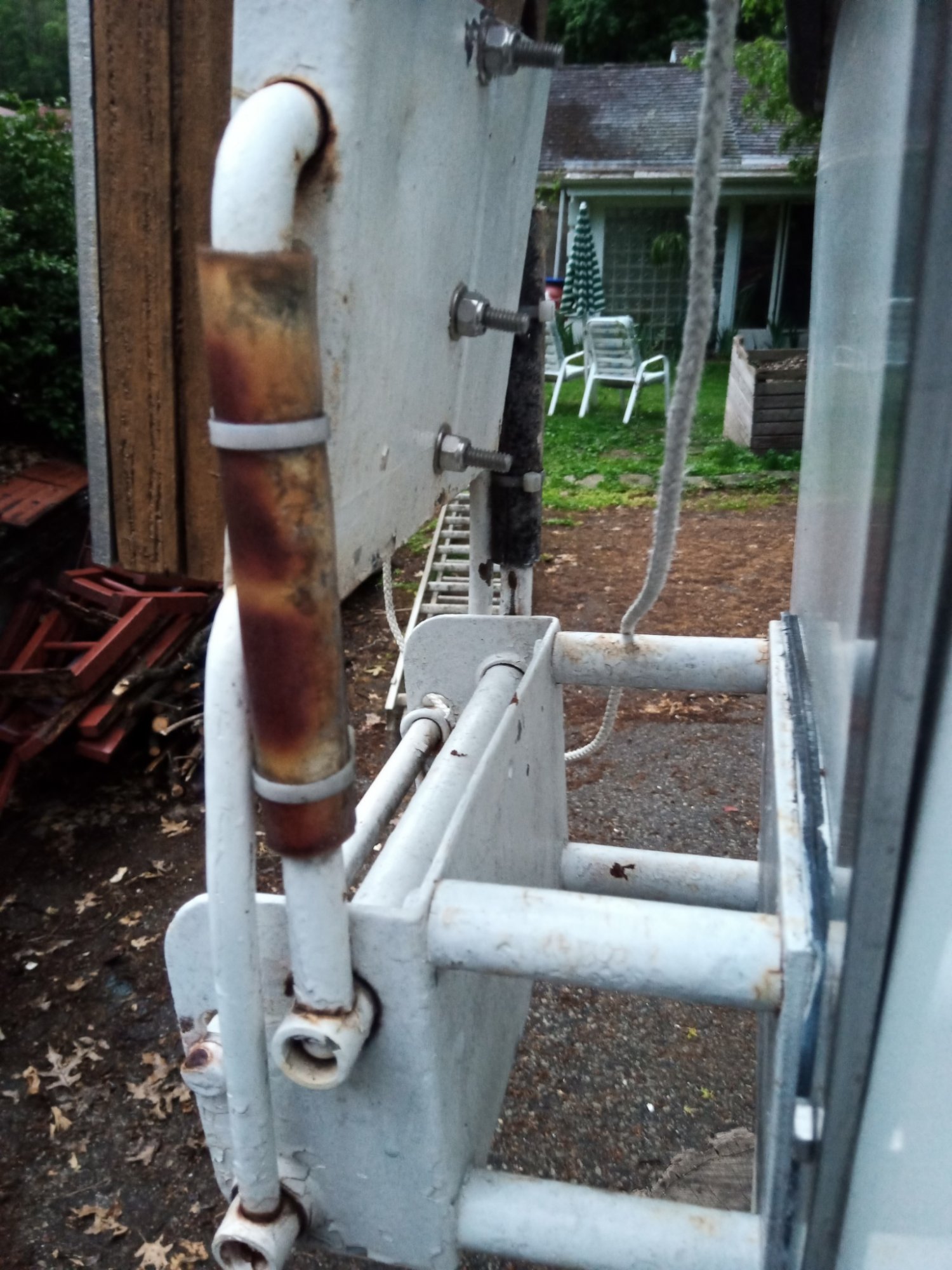

It wasn't seized up and wasn't really too rusty under the paint. Here's the deal. See pic
(yellow arrow) - Have to hulk up and pull this out (2") enough to create space here (blue), then, and only then is the top able to come down with the bottom. Otherwise they are just "locked" together and going nowhere. It ain't easy to get that initial 2" with all the springs load on it, especially when I'm up on the boat... but I did get it. Then I wedge that pipe in at the (blue line) so that the 2" space is always there. Then with just a little force it goes down without too much trouble.
Does that make sense? And what do you guys think about all that?

The motor mount should be difficult to move when the motor is not installed. The spring is there to help lift the motor, so trying to lower the mount when it is empty should be difficult, it should be fairly easy to raise the mount when the motor is off because it is not necessary to over come the force of the spring.
