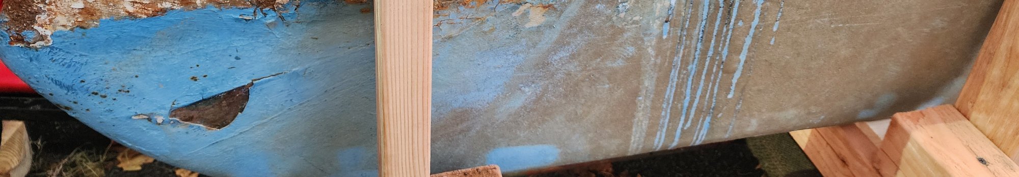

Can anyone tell me what kind (brand) of Bottom Paint this might be?
Sep 30, 2025
222
Catalina 22 Davis Hollow - Lake Arthur
Hello all.
Boat will be in a slip all season in western PA on freshwater.
I bought this boat with no knowledge of anything except that they had sanded the hull down, and painted with some sort of bottom paint, a year before the old owner passed away. Its a light sky teal/blue color and comes off very easily on your hands.
I need to paint the boat but I have no idea what bottom paint this is and I hear that they are almost completely UNcompatable with each other.
1. What would you do?
2. What would happen if I just painted VC 17 over the old paint?
3. Could I do a light sanding/cleaning to just get the ablative bottom paint off, then paint on something like VC 17 ?
(If so what exactly... cleaning and sanding protocol should I follow?)
4. Does the light blue color give away what it is or no?
Thanks guys!!! (and gals)

Almost certainly an ablative conventional hard copper- based antifouling. Looks loose, so at least some of it needs to come off. Fix the dings first.
You can, in fact overcoat most ablatives with hard paint, but ONLY if you do a really, really good job of sanding the hell out of them first. In your case, that means taking back to a bare hull. It looks mostly gone, so sanding with coarse paper with a RO sander should do it in a few hours. I don't think the complexities of stripping are merited for this little bit.

Sounds like some form of ablative to me. Usually hard paints don’t slough off that easily. Generally speaking ablatives can be over-coated with other ablatives after just enough sanding to remove loose paint, but going over them with hard paints or VC-17 is not recommended without first removing what’s there.

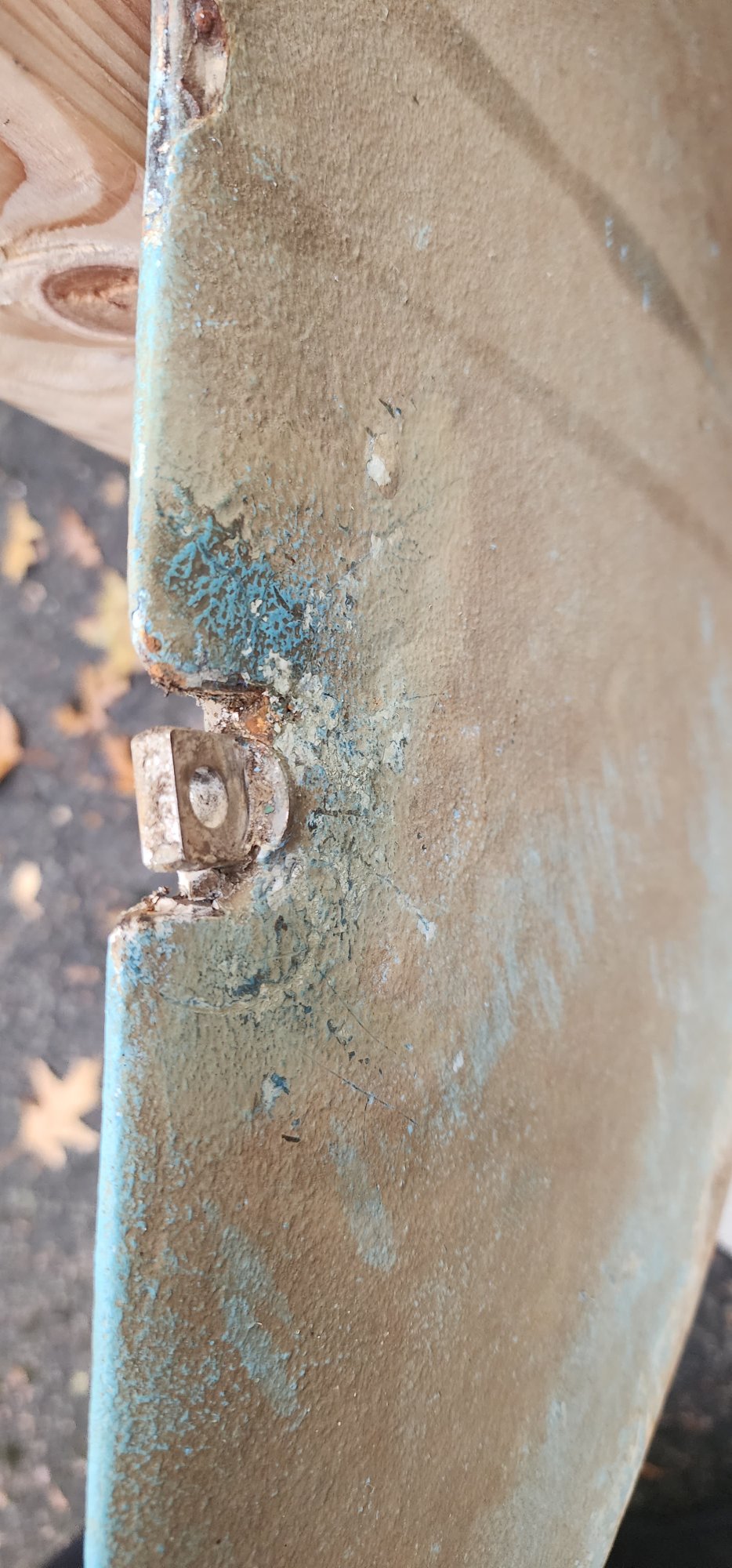

4 - Tape bootline. Use Pettit Vivid in the color of your choice. Pettit Hydrocoat is another good alternative if you want a water based ablative. Follow maker’s instructions. (You mentioned VC-17 - I don’t recommend it and have no experience with it. I read that it’s not compatible with everything unless you strip down the bottom to base and start over, and it can’t be overcoated with other paint types in the future unless it’s completely removed first ).
The keel appears to be cast iron and rust has caused paint adhesion issues in some spots. You can slap some paint on it and go sailing, or you can try to correct it.
Correction takes a lot of work. Rust is like a cancer and the keel needs to be stripped (start with 60 grit), then coated with multiple epoxy barrier coats, then painted with antifouling paint. To get a good bond you need to do the first antifouling coat within hours of the final coat of barrier paint cure. Follow manufacturer guidelines.
