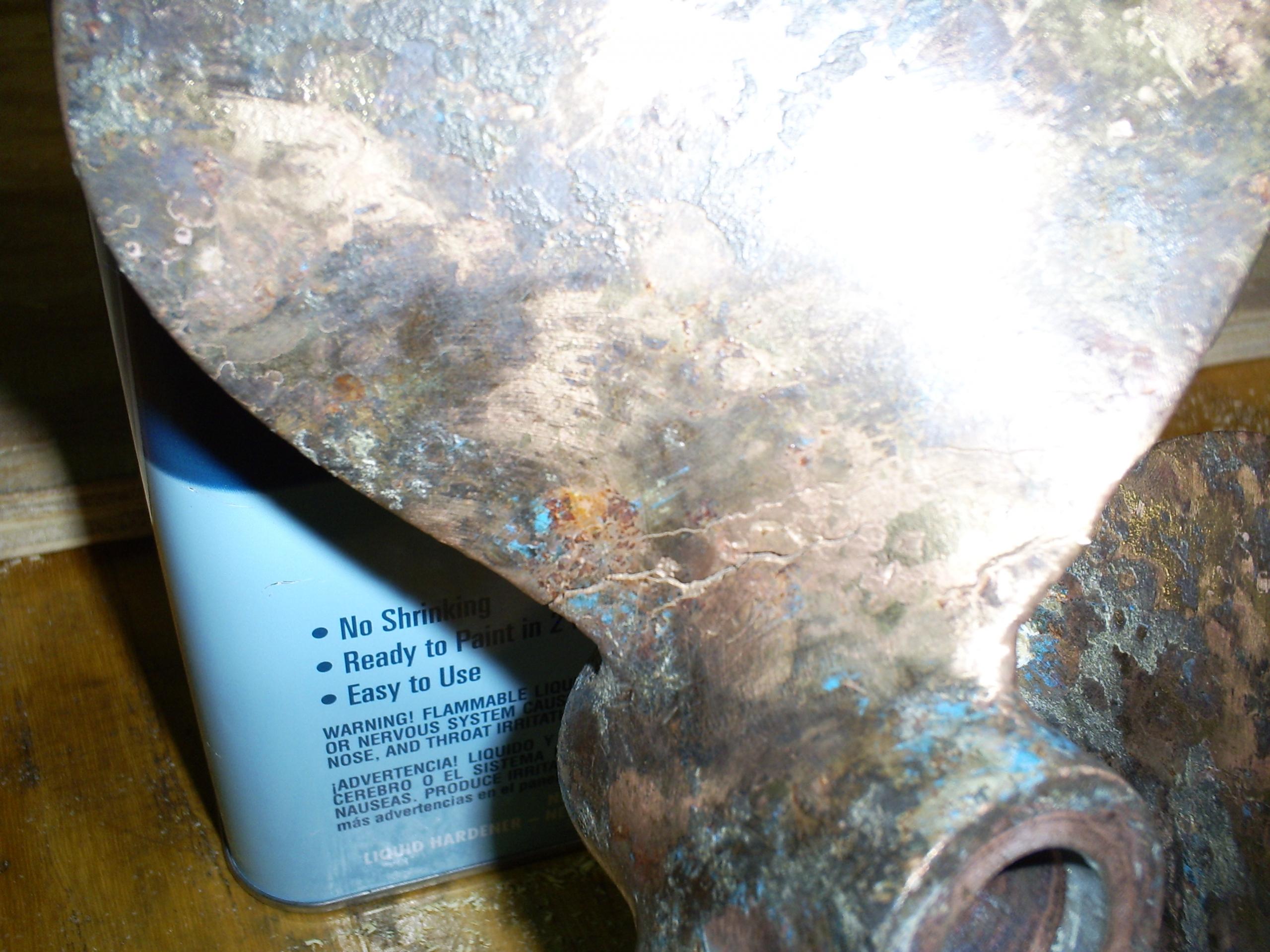

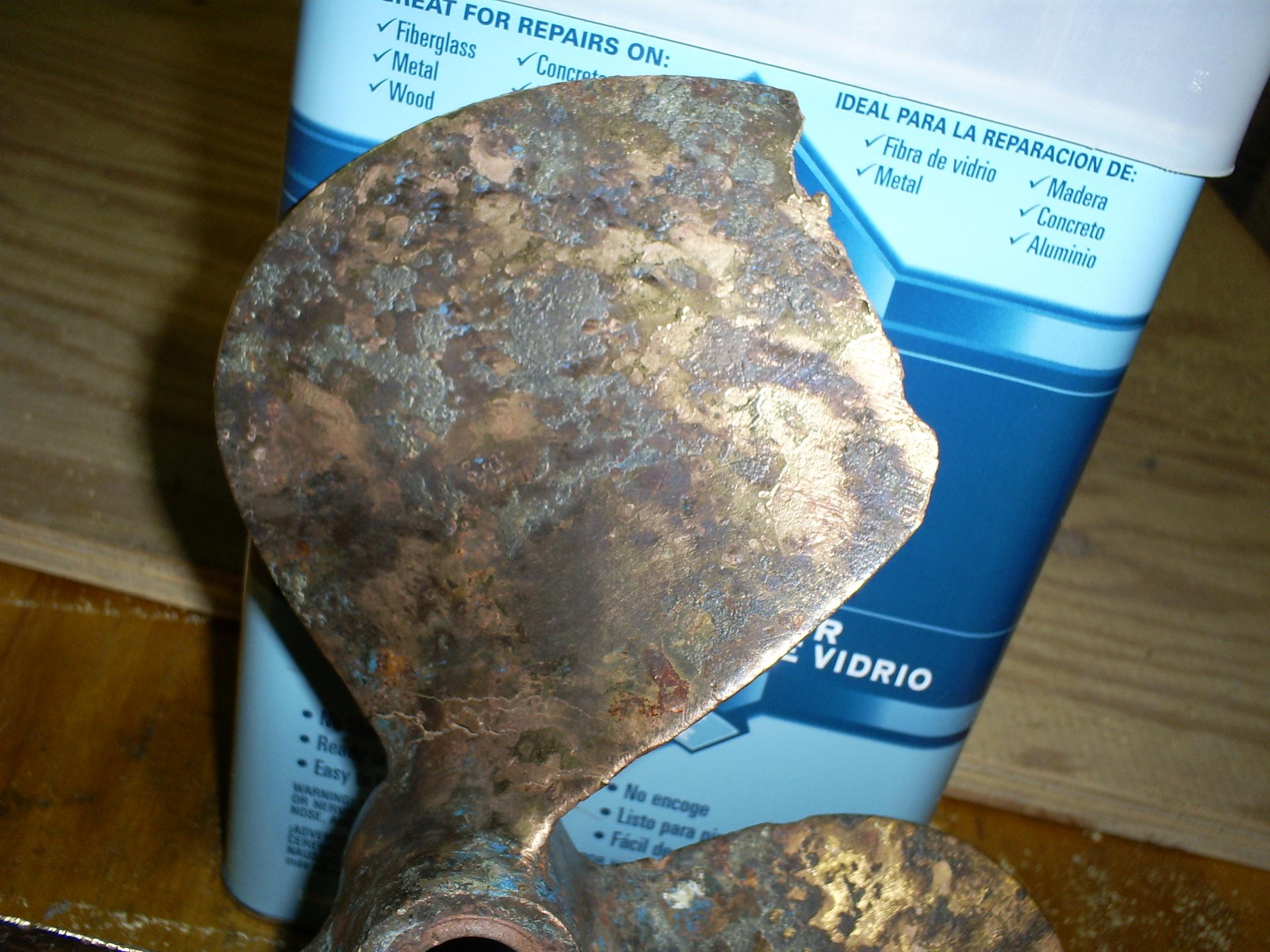

This was on my boat for probably five years or more with no zincs. Apparently someone cracked a blade and didn't know/didn't care and left it that way. There was/is bottom paint, a black layer and a blue layer, black may have been primer. The surfaces are pitted. I wire wheeled it and the bronze underneath shines pretty good. What is the price range to restore this prop? Can a prop like this be restored?

I'm pretty much with Randy on this.
I'm a big fan of repairing instead of replacing, But this one looks as though there is enough damage that it would come close enough to the cost of a new one to make it not worthwhile.
I'd take it in and get a free repair estimate, then base your decision from that.

Too far gone
You are concerned about the edge that has cracked off. Look at the cracks in the base of the blade where it attaches to the hub. Toss it. Depending on budget, buy a used replacement or a nice new folder. Either way, I would go for a 2 blade to help with your boat speed under sail. A fixed 3 blade like that is really better suited for offshore work in big seas. That thing is like a sea anchor.

Dezinctification of Bronze can not be repaired unless you melt it down and start over..
The pinkish/coppery colored areas on the prop look like areas of dezinctification. You can see one area where the prop has cracked near the hub, right in what looks to be a heavily dezinctified area.
Unfortunately it's time for a new one.... Did you have a survey??
The pinkish/coppery colored areas on the prop are areas of dezinctification. You can see one area where the prop has cracked near the hub, right in a heavily dezinctified area.
If you polish the hub the alloy name should be stamped in there. not all bronzes have zinc in their alloy. My prop is Nibral ( nickel aluminum bronze). I rather agree that your prop should be replaced. Check with the shop that was/is going to work on it and see if they have a good reconditioned prop if yours can't be reconditioned.

After reading everything on here, I think that the prop is now a paper weight. As maine said the dezinctification can not be cured. I will have to find a replacement. I have been calling around but no luck yet.
