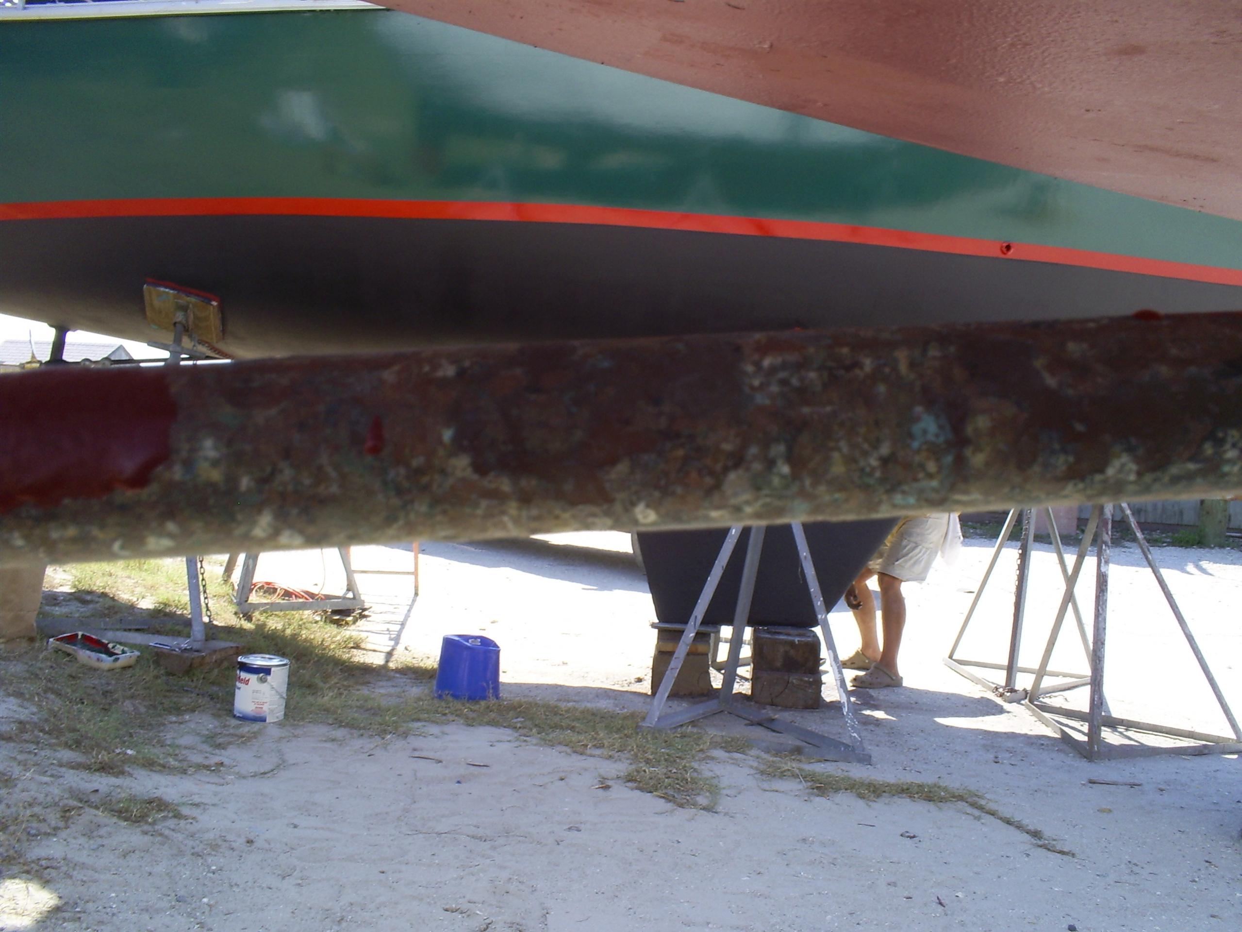

I pulled the shaft. Well I tried to pull the shaft, I ended up just cutting it in two with a thin grinding disc and letting it fall apart.
I got one of those 'slam rods' with the 5 lb. weight on it and put 2 prop nuts on and gave it all I had and slammed the weight to the end of the rod and it ripped the threads clean off of the prop shaft! The threads were inside the nuts laying on the ground. At that point I decided the shaft was trash along with the prop.
I ordered a new cutlass bearing, bought a prop on Ebay and hopefully getting a used shaft from minnies. By the way if they have what you are looking for, they are the cheapest with out doubt.
My only problem is I had a 12 LH 10 and the one I bought is a 12 LH 12. I am going to go ahead and install it as is, and see how it preforms. If it's too much, which it probably is, a prop is a job done easily in the water.
THe toughest part of the prop shaft is getting the flange and the shaft seperated. This is not a job done in the water unless you can easily seperate the flange and prop shaft. I don't recommend replacing a prop shaft or cutlass bearing in the water.
The one pic is my rotted shaft. lol

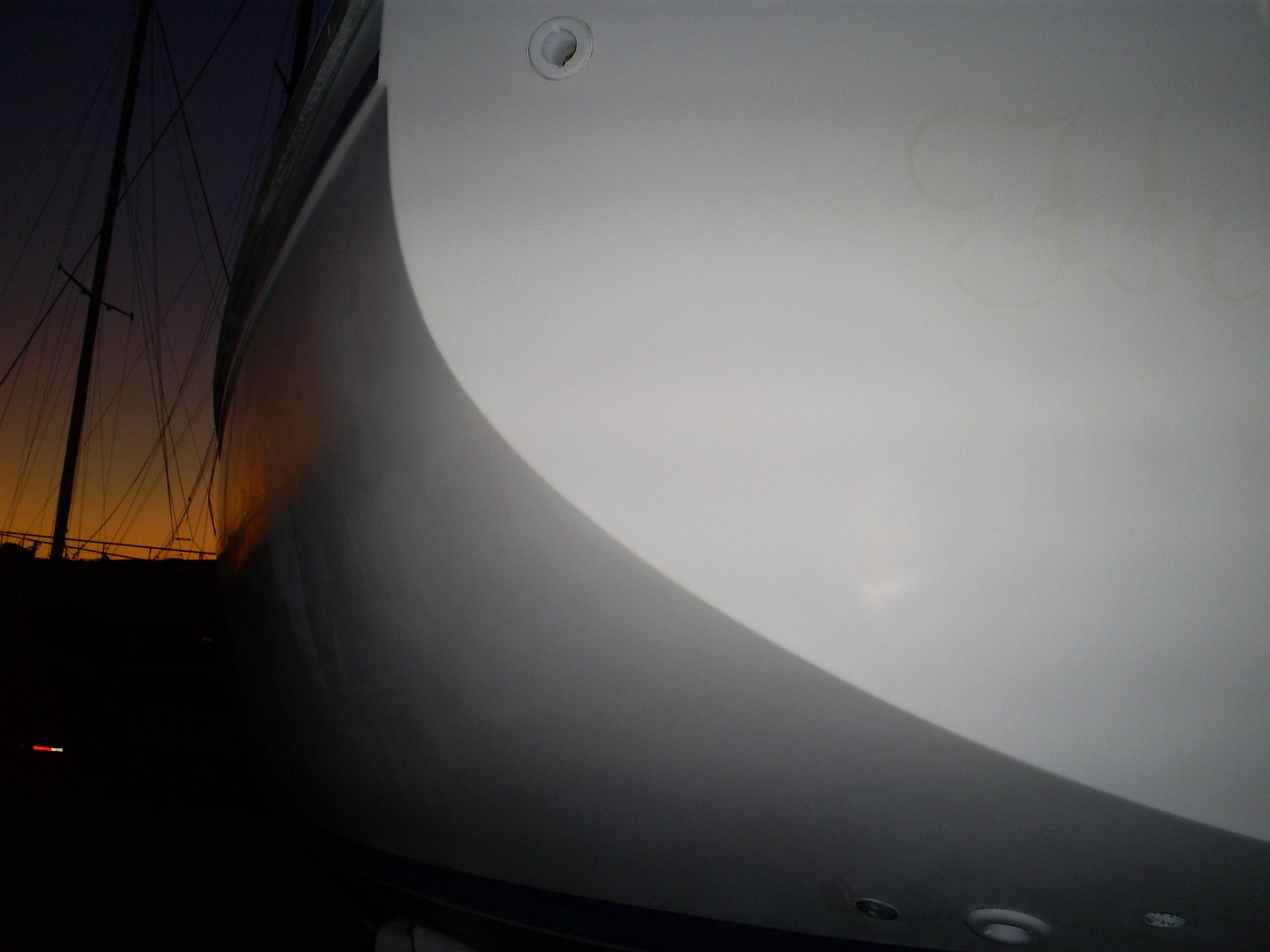

The other is the transom after wet sanding and compounding, the maine sail way. I removed the old name, I can't seem to get rid of the yellow under the name though. I thought some one had painted the transom, it turns out they gel coated the transom, apparently over another name.

Hermit,
Please, please, pleas do yourself a favor and DO NOT use a slide hammer! You can literally split your trannie casing apart and at a minimum damage the bearing races and bearings them selves. Slide hammers are NOT a good idea unless the shaft is NOT connected to the tranny. The only time a slide hammer should be tried is if the shaft is out of the boat!
If you ripped the threads off the prop shaft you may have done some damage to the tranny..
P.S. the yellow under the name will only go away with time and UV exposure. DO NOT try and wet sand it out as it is very deep into the gel... UV is your best friend and it will diminish in good time. Shine it up, put the new name over it and in a year or two you will barely notice it. I know it's a pain but there really is nothing but good old UV and time to even things back out.

The new shaft will need to be checked in V-blocks
Most SS shafts are not that straight and will need some help because even .002 run out in the middle of the shaft will cause vibration at some RPM

I had thought about the damage to the transmission, so I tried pulling it out just slamming it by hand against the tube. Now I will have to do a little fiberglass repair to that before I install the packing housing. And I thought the shaft would pop right out. Fortunately the bearings are cheap in the transmission case and not a problem to replace. I will find out when I crank it over and try to run it and test out the new prop.
The shaft I am going to buy will be straightened when I buy it. It's from a prop shop. I can do better on the machining cost though. I guess it will be aquamet17, I will see if the guy will give me reasonable deal on some 19 or 22.
Ripping the threads off was probably a good thing, that absorbed all the shock.
Monday, I will continue on the top side polish. I tried to use a cheap synthetic wool pad to do the compounding. Then I put a real wool pad on and it was 10 times less work with better results. I bought all body shop compound polish and pads. And I got the collonite fleet wax.
Maine sail, I have your long post saved titled 'there are no short cuts in life' After you compound, then finesse it, then McGuires #09 do you do something after that? Do you use a glazing, like a number 10 rated cut McGuires product or #9?
