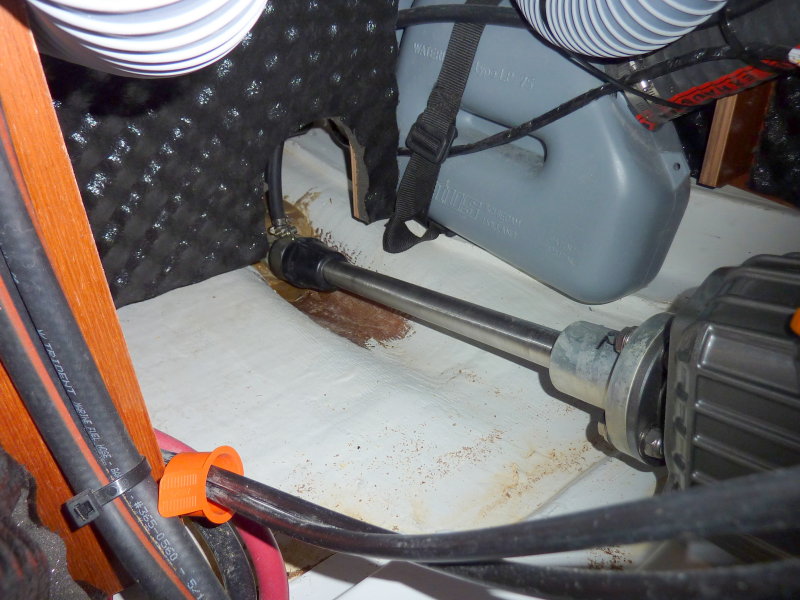

we got the survey results back, and although the boat is not quite as bad as I expected, the value is still down due to all the little stuff that is wrong with it... although the negotiated price and the value as surveyed is almost the same, im still going back and forth on the decision to purchase or pass...
there are soooo many little thing that it must have been done by someone who had no idea what an ABYC standard is, or that there even was such a thing:confused:.....
the decks sounded a slightly higher than expected moisture content with the meter.... there is no saturation at all, and the decks measured about the same thru out... due to the higher than expected reading, extra time was put in to hammer sounding, and could find no abnormalities.... suggested core sampling, then drying if neccessary. no rot was found.
there seems to be nothing expensive to repair, individually, but collectivly it may add up to a grand.... if I do the work myself....
the blister repairs and bottom paint, and the dodger and bimini will be quite a bit more....
I have included here what is in the survey...
replace non-stainless hose clamps, install 2 clamps each connection below the waterline, install GFCI in 120V system, clean up wiring and remove deleted/dead wires, replace non compliant hoses on seacocks, repair nav lights, remove extension cords that run to the microwave and tv, install gimbal lock on LPG range, repair non-compliant LPG system, replace hot water heater safety pop off, expired safety flares, mount fire extinguisher, install CO detector, no horn on board, auto bilge pump switch does not work (manual switch does), 120v appliances/outlets all wired on same circuit- split to individual circuit breakers (available but not used), wrong style of main breaker used, reverse polarity at 120v outlet in galley, new 12Vcircuit panels installed, but some switches are mislabled or not marked as spares-2 indicator lights out, corrosion at battery terminal and at starter terminal, wing nuts used on batteries, all wiring is loose, messy and unsecured, clamps used on push-loc hose fittings, plastic fuel filter bowls, fuel filler deck fitting not marked "diesel", fuel level sending unit is moist with fuel (exterior), ABS pipe found in wet exhaust system, corroded and inadaquate number of exhaust hose clamps, dormant zincs, 5-10 hull blisters approaching 1", needs bottom paint.

Does not sound like a good deal, considering the sketchy survey notes provided.
Elevated moisture readings (in any cored structure) is a bad situation; will result in structural deterioration. .
Did the survey report denote certain items as critical/essential/must do now repairs?
Blisters (5-10 hull blisters approaching 1") are a significant problem. Were the blisters examined (popped open to see if they were wet/seeping fluid from osmotic process degrading the frp. laminate or "dry" ie. laminate voids; either situation is a problem. (Think about what could be hiding under layers of anti-fouling paint. Blisters do not go away on their own; they increase in size & / or number.)
Unattached items/upgrades can denote neglect / lack of interest / other problems by the selling owner.
Take the deficiency list to a boat yard; get estimates for doing all of the work (especially blister repair / remediation). (Then add a minimum of 25% for the inevitable surprises.)
The boats purchase price should be significantly below the book value for that year & model in good condition (needing no repair / significant maintenance and certainly with out blisters on the hull or wet deck core).
