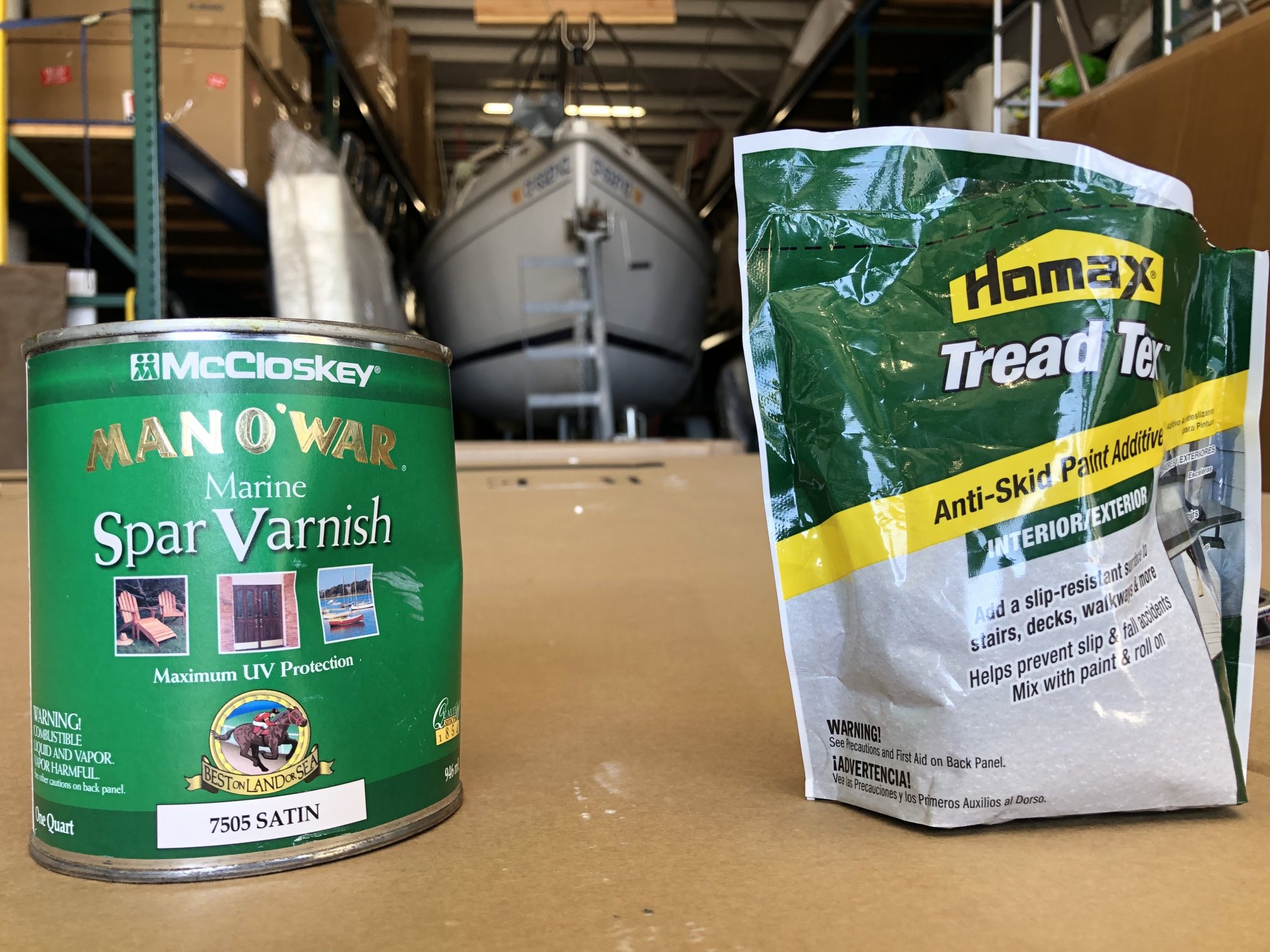

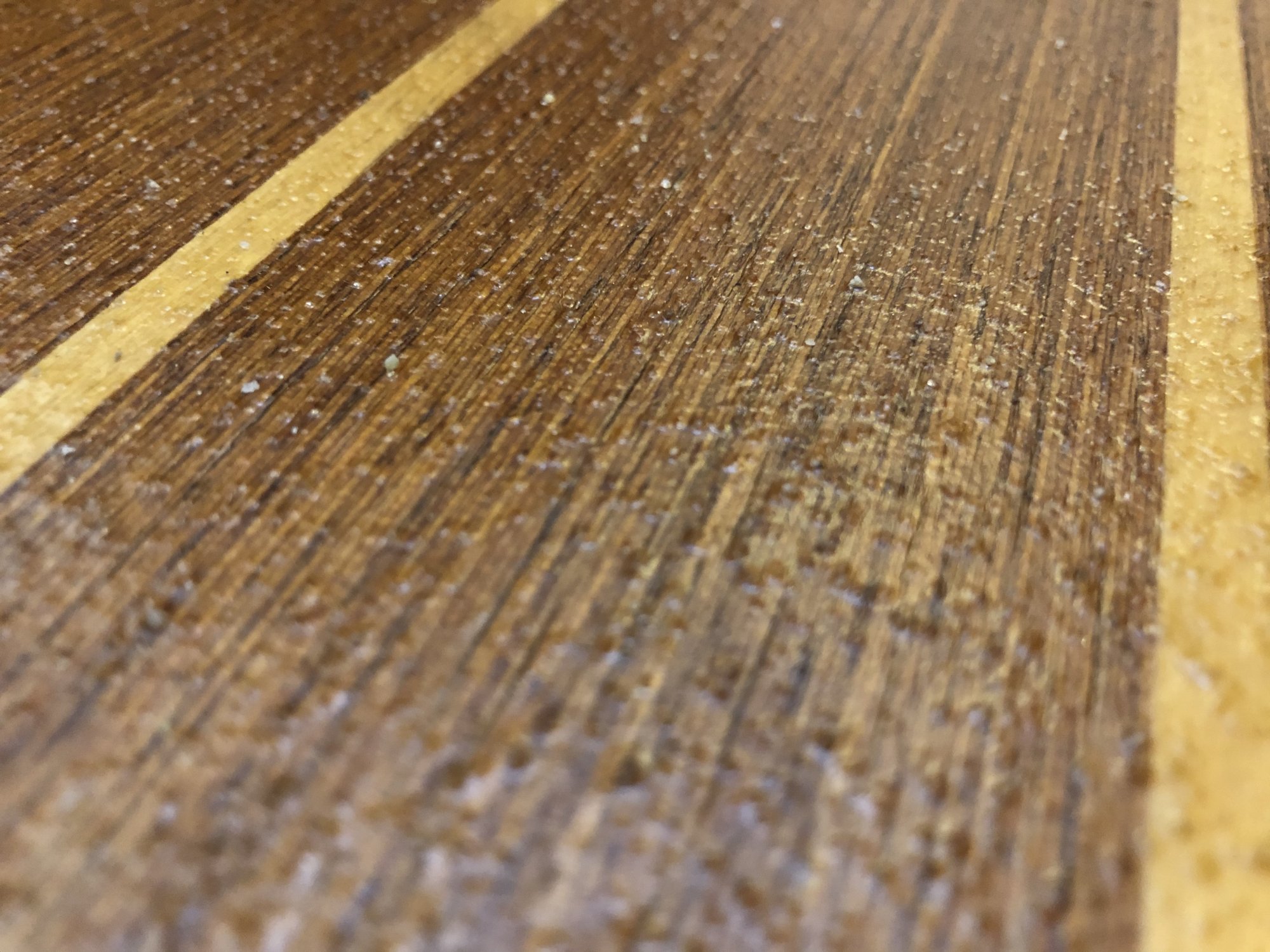

My floor is wood and I sanded mine down. Tried peeling it up but it was too difficult. I am planning to finish it with a marine varnish and adding some anti slip silica to the varnish. Will post photos once done later this week.

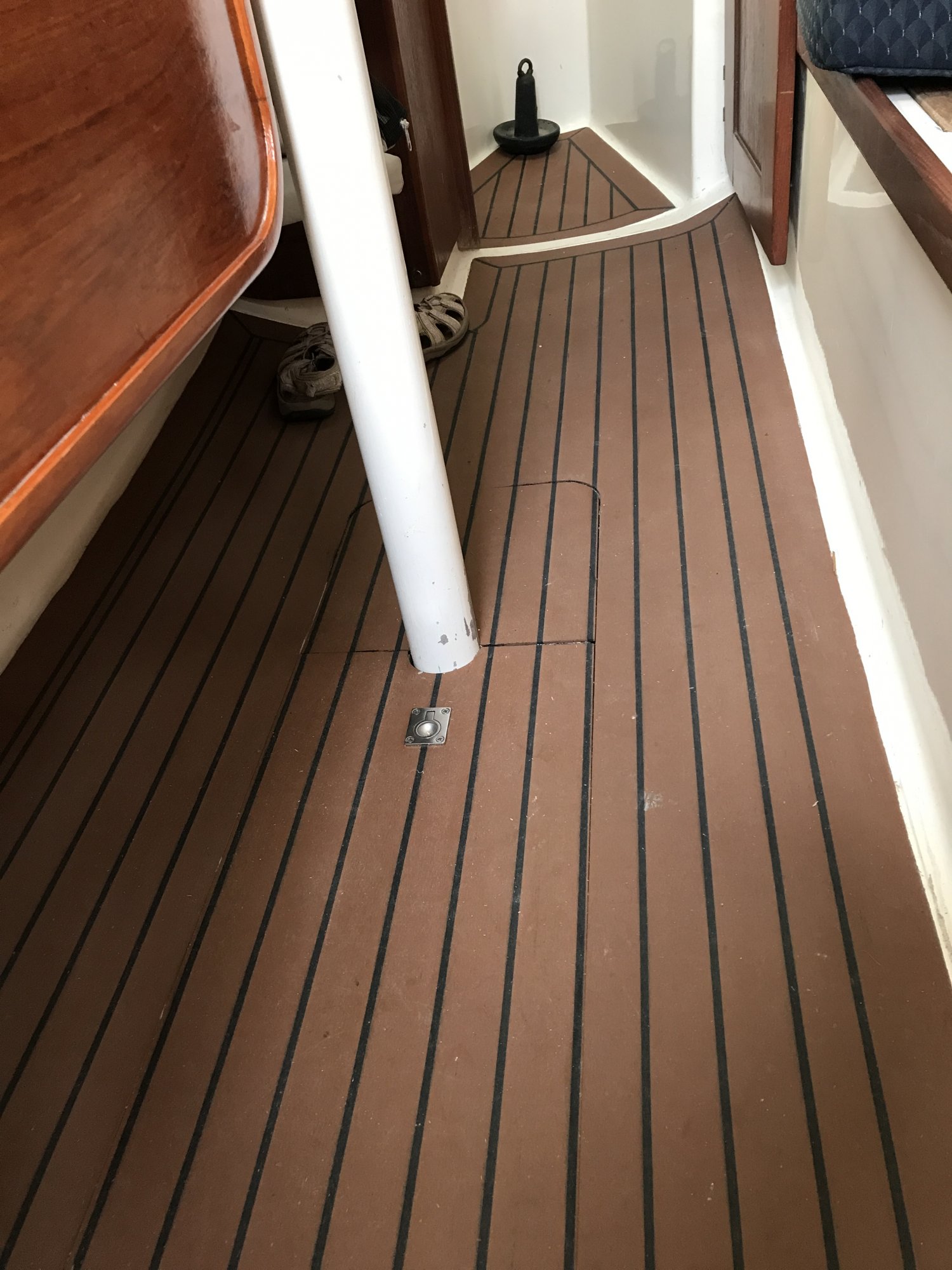

I had to pull ours last year after the ply completely delaminated. I replaced with a plastic laminate plank. not sure if it survived our winter yet but will post a follow up in a few weeks. This is how it it looked after installation.
That looks great. How thick was it?

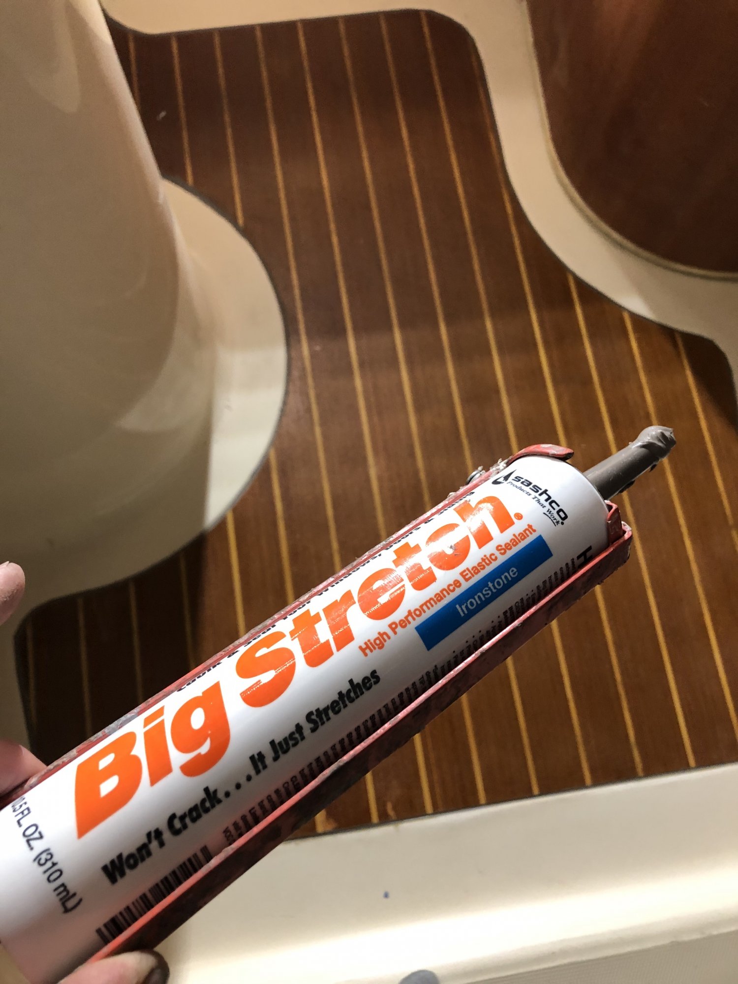

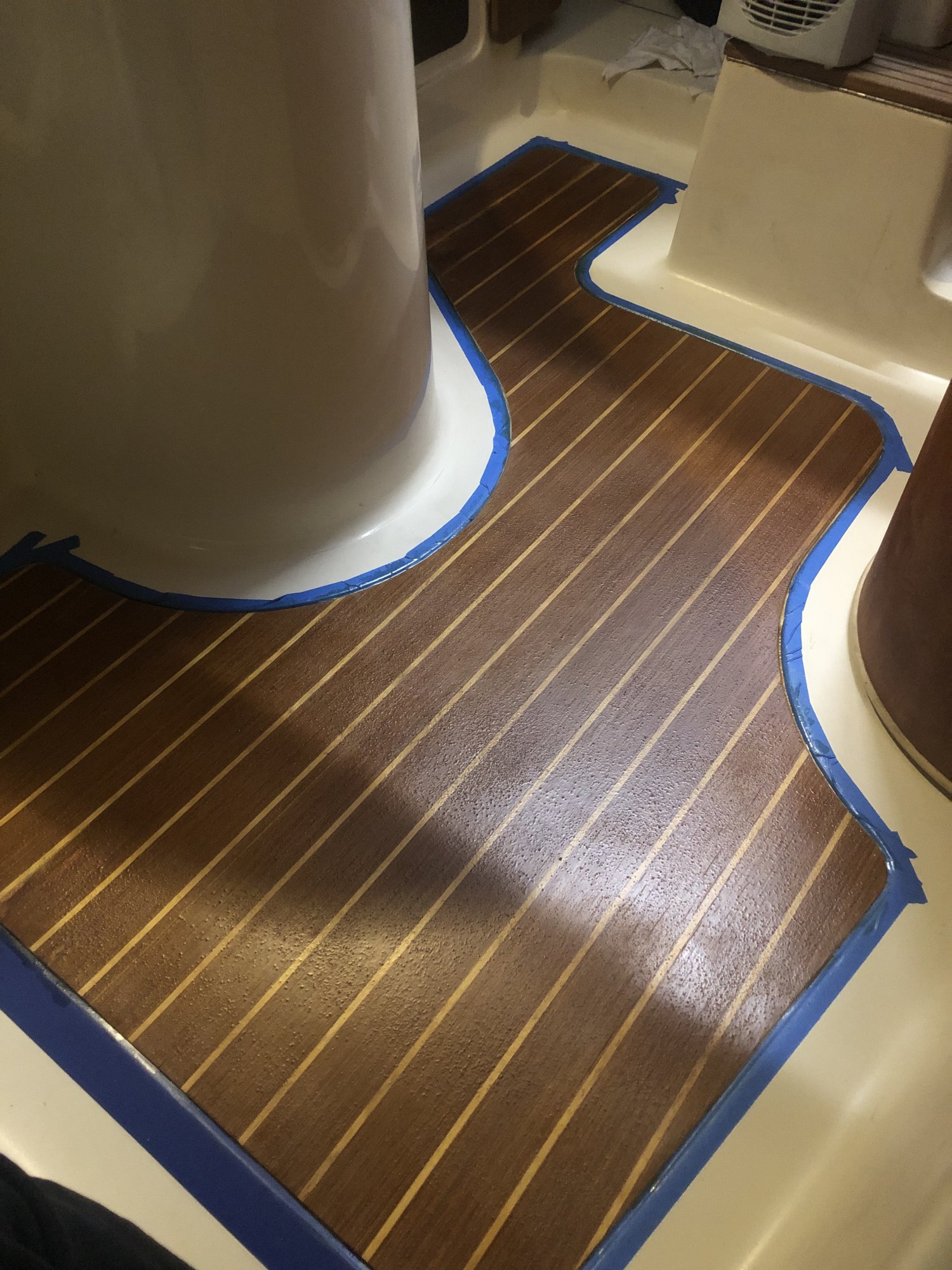

The problem with the floor was that it was really dry and started to peel, wood started to separate. This is how my floor turned out. I used a marine varnish, pretty high VOC but it completely seals the wood to prevent moisture getting under it. These where the steps AFTER sanding which took about 10 minutes with an orbital hand sander!
1) Remove old sealant around the edge with a razor
2) Vacuum
3) Mask off outside edge
4) First Coat wait 24hrs
5) 2nd coat and then lay down silica sand to prevent slipping when wet wait 24hrs
6) 3rd coat wait 24hrs
7) Remove masking
8) Mask the "channel" to install new sealant
9) I used "Big Stretch" sealant. Its a product I am familiar with and it will allow for the expansion and compression of the wood/ fiberglass.
10) Remove masking immediately after completing sealant.

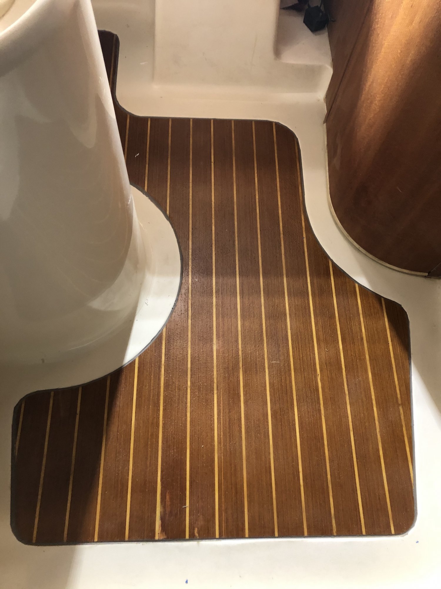

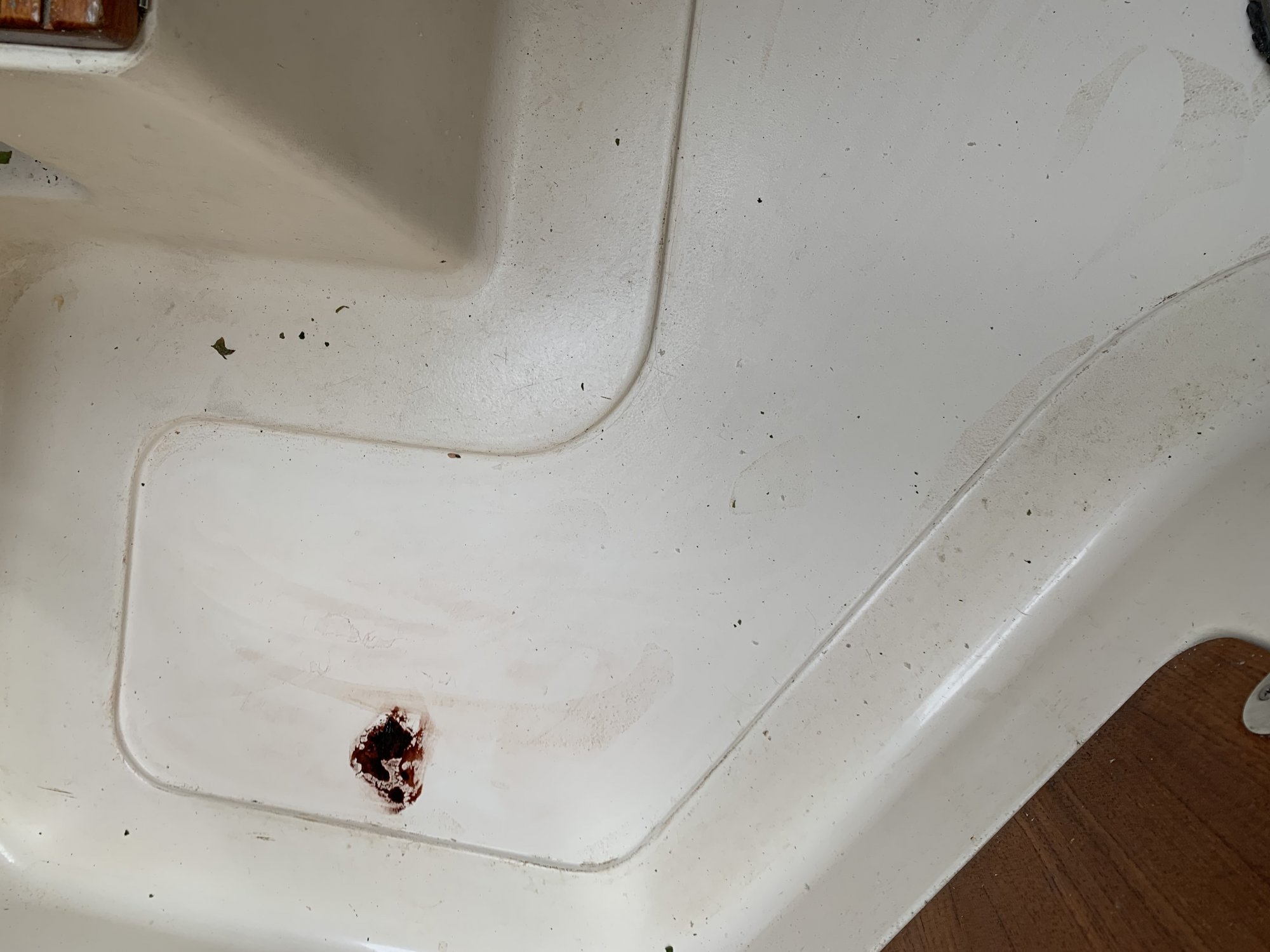

This is the area beside the galley in front of the companionway step. Unfortunately the only photo I’ve got at the moment with the wood removed showing the cabin sole.

Thanks Twalker, so the wood floor is not directly over the the ballast top. Any hole giving water access under the wood floor from the ballast top?
I have a Hunter 26 1993 and i have a leak from the pole base bracket/bolt. Water is coming out from the edge of the wook floor and i try to understand how its goes there, and if i should remove it or restaure it on place.
10,523
-na -NA Anywhere USA
The floor pan or floor has a recessed portion to fit the teak and holly floor piece into it. The floor pan is beneath it. The teak and holly sole is glued the recessed area with Liquid Nails. There is a bead of Dow 795 between the edge
12,754
Is this where the table pole goes into the sole? If so, you may have water coming up from the keel bracket bolt. See this write up on replacing the keel lifting rope... it shows the bolt for the bracket and how to get to it.
