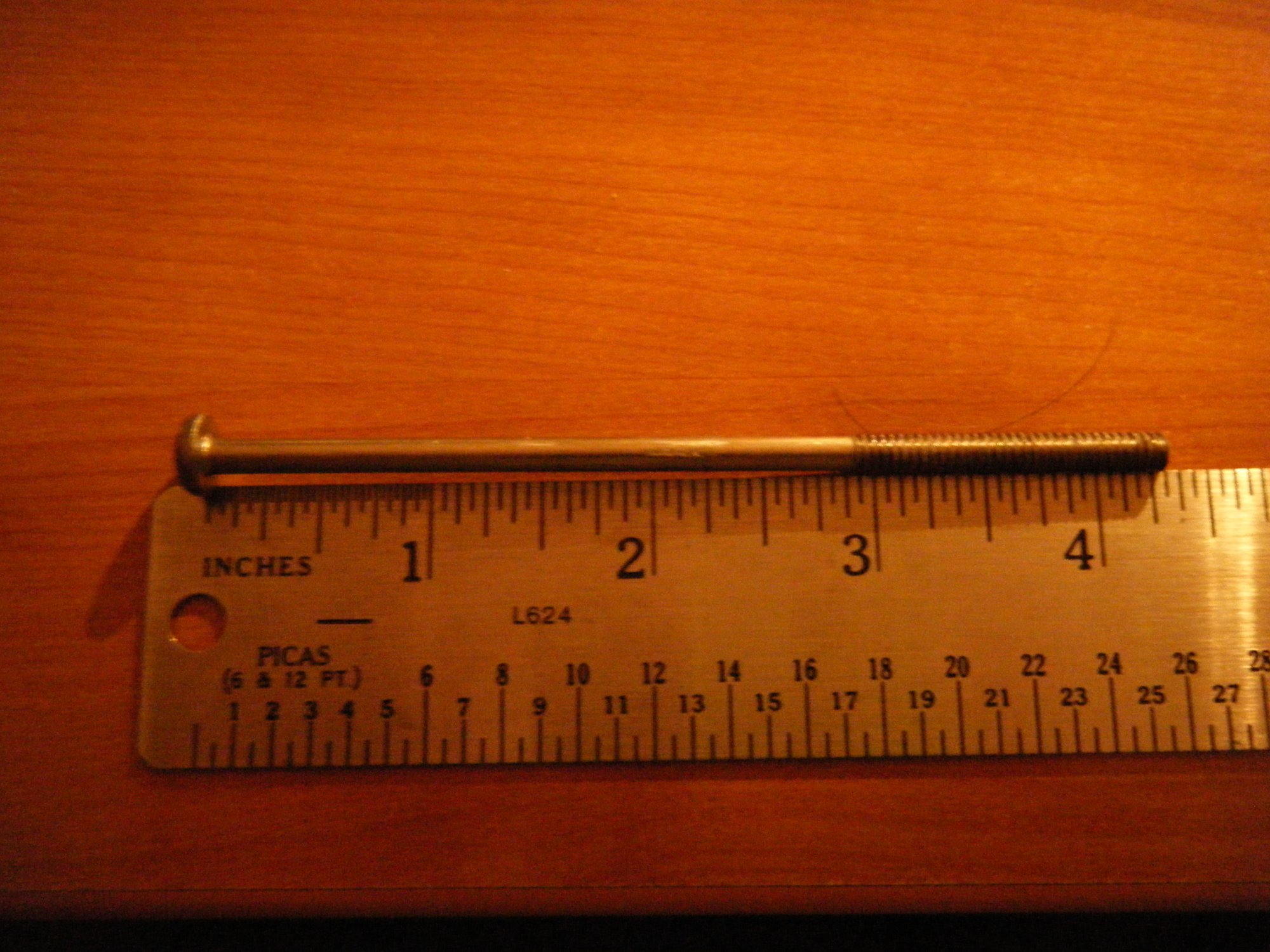

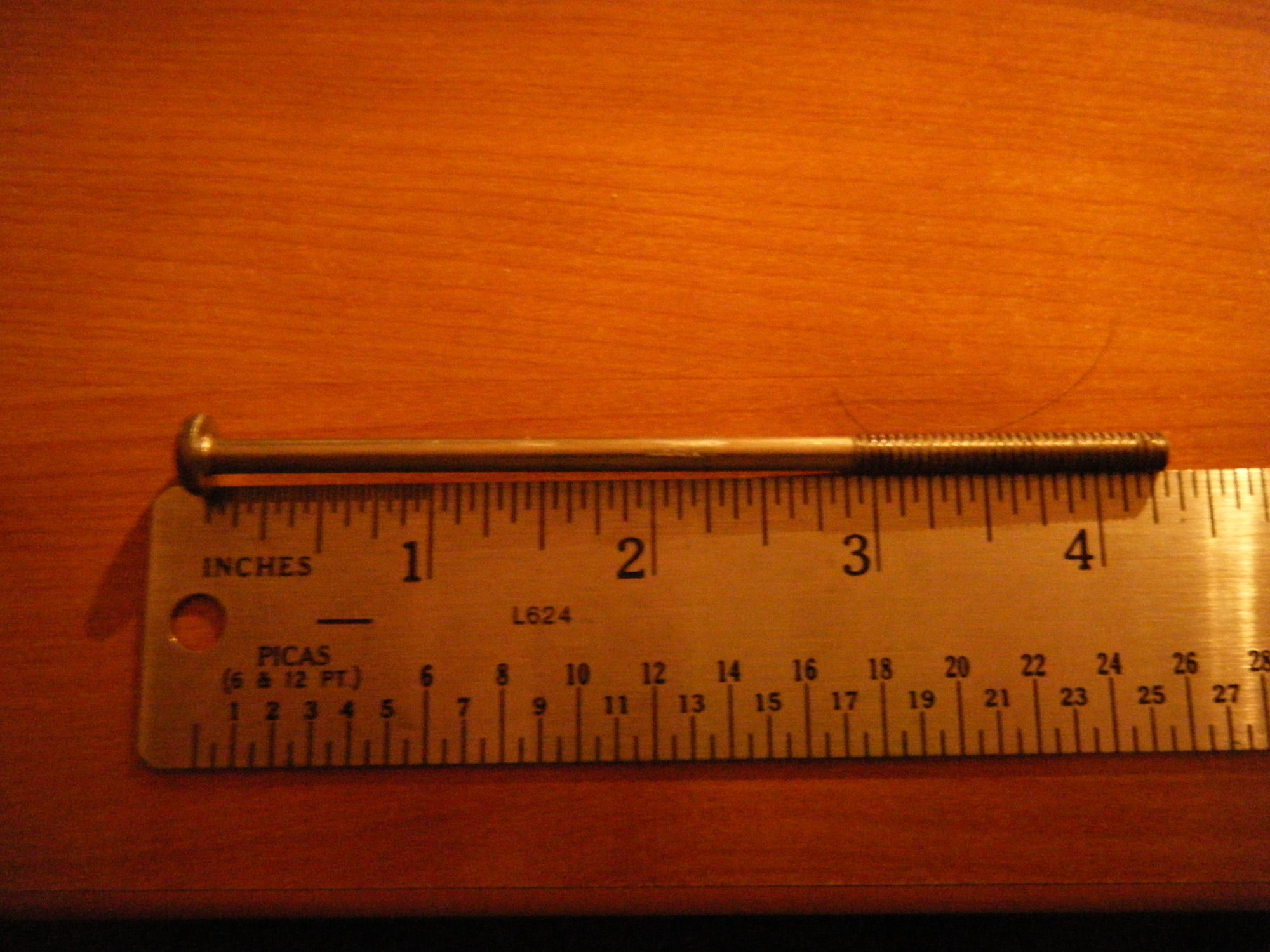

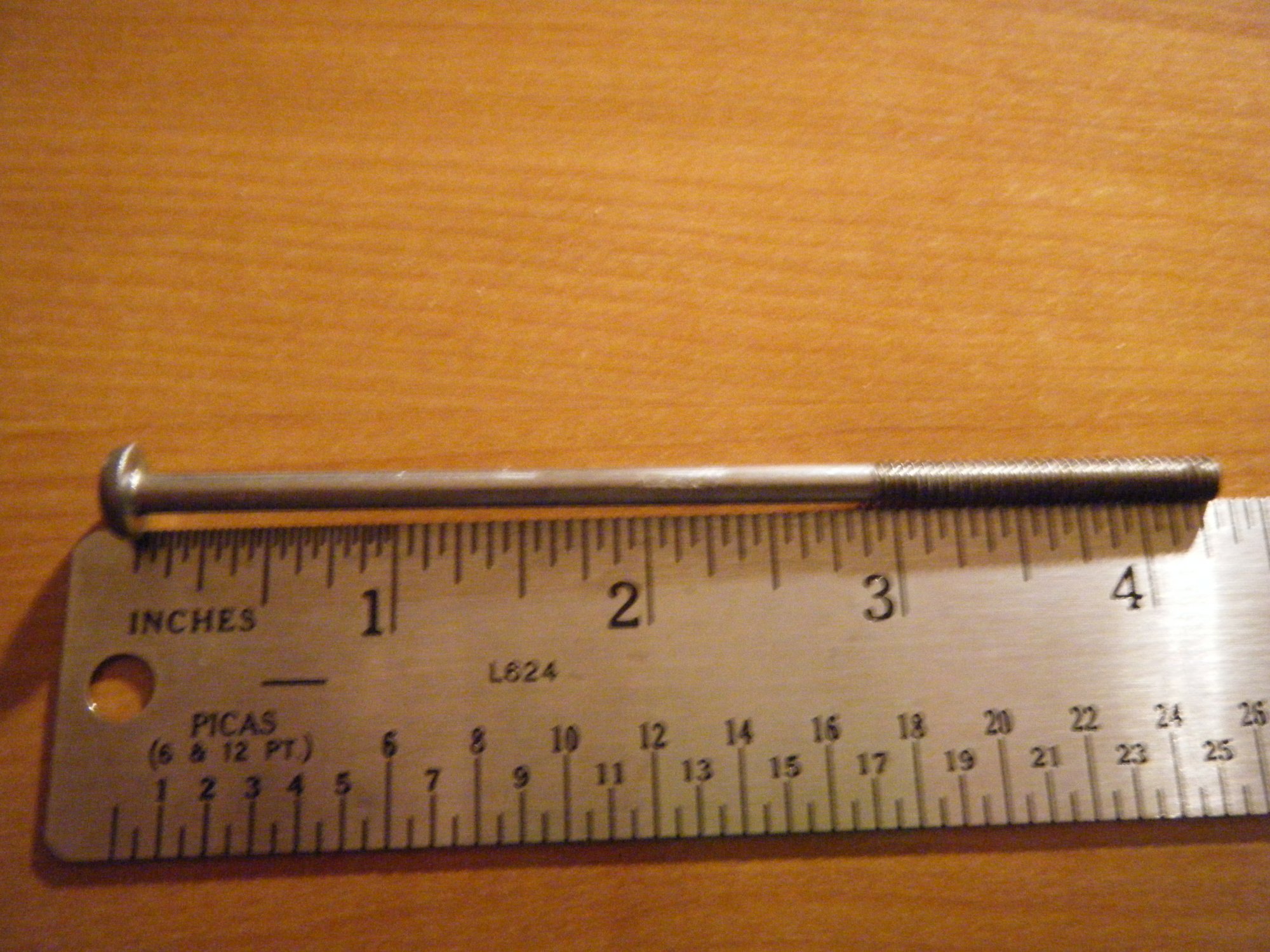

Finally did my hand rails. Turns out, we were all wrong. The hand rails were mounted with really long wood screws. One screw went all the way through the outside rails, the cabin top and into the inside hand rails. I decided to take out the inside hand rails and just through bolt the outside rails right to the cabin top.

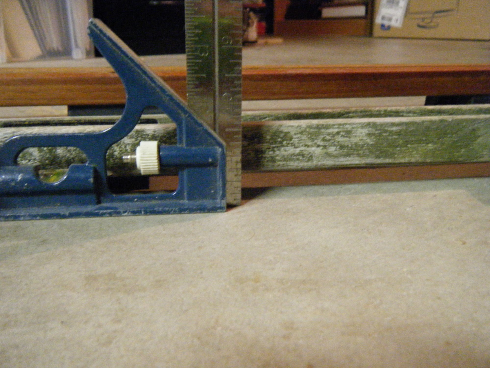

The original handrails are (were) teak, and secured through the cabin top with really long Phillips head screws.
I ordered replacements from McMaster-Carr.

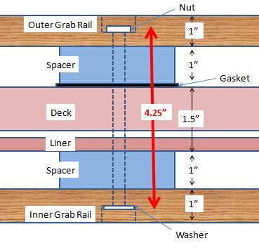

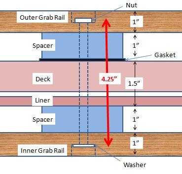

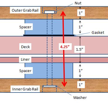

The way that they are fastened is through the inner handrails, through the cabintop liner, through the deck, through a spacer, through the handrail, and into a nut that is set into the handrail with a teak plug epoxied over it. Thus;

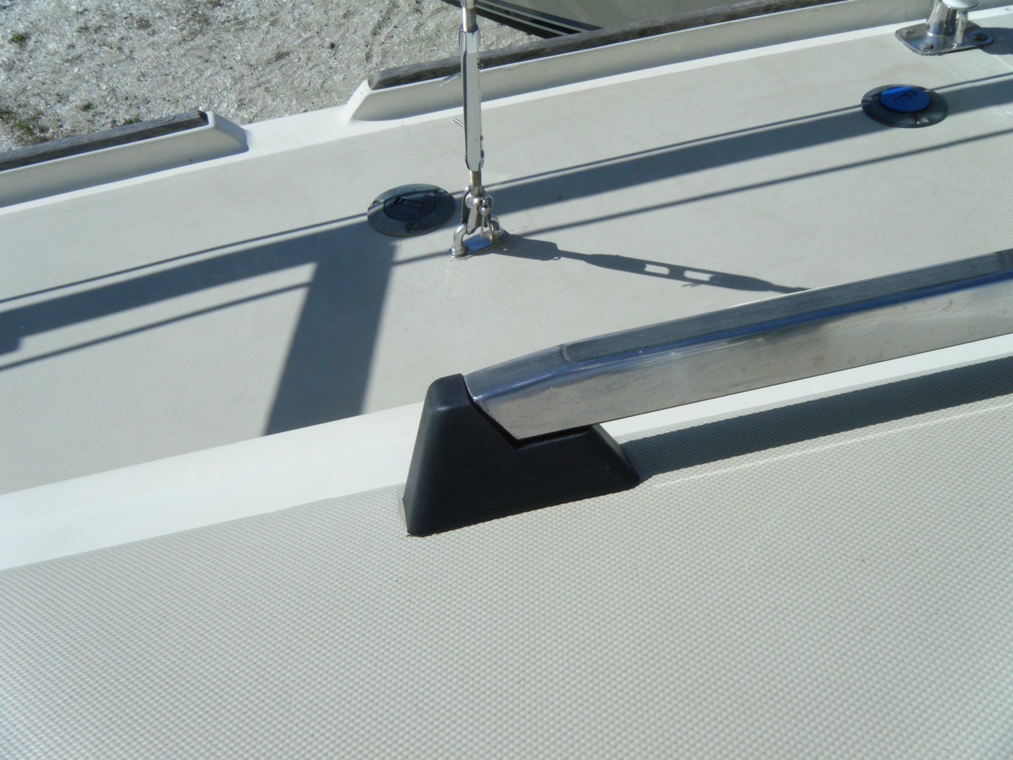

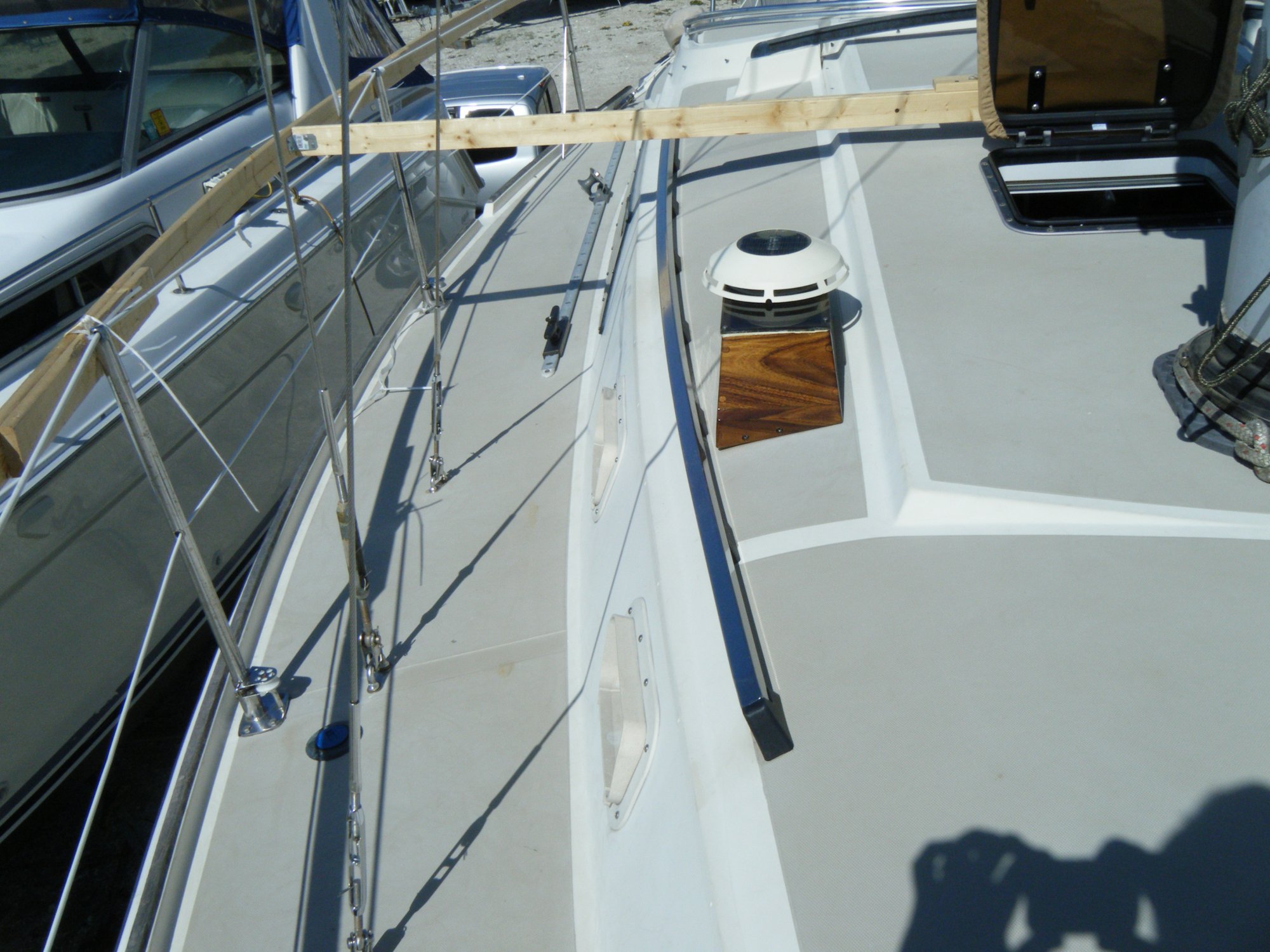

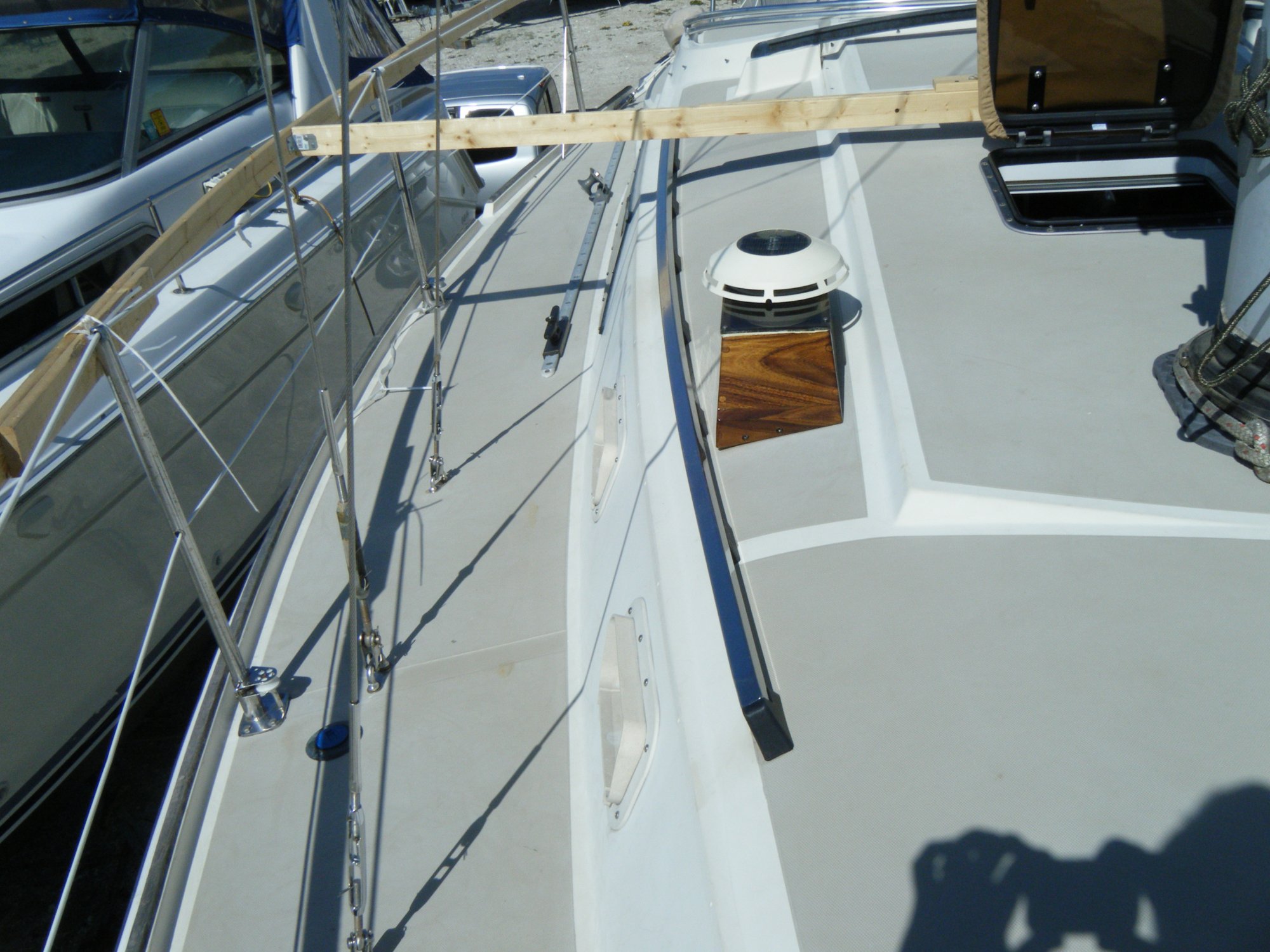

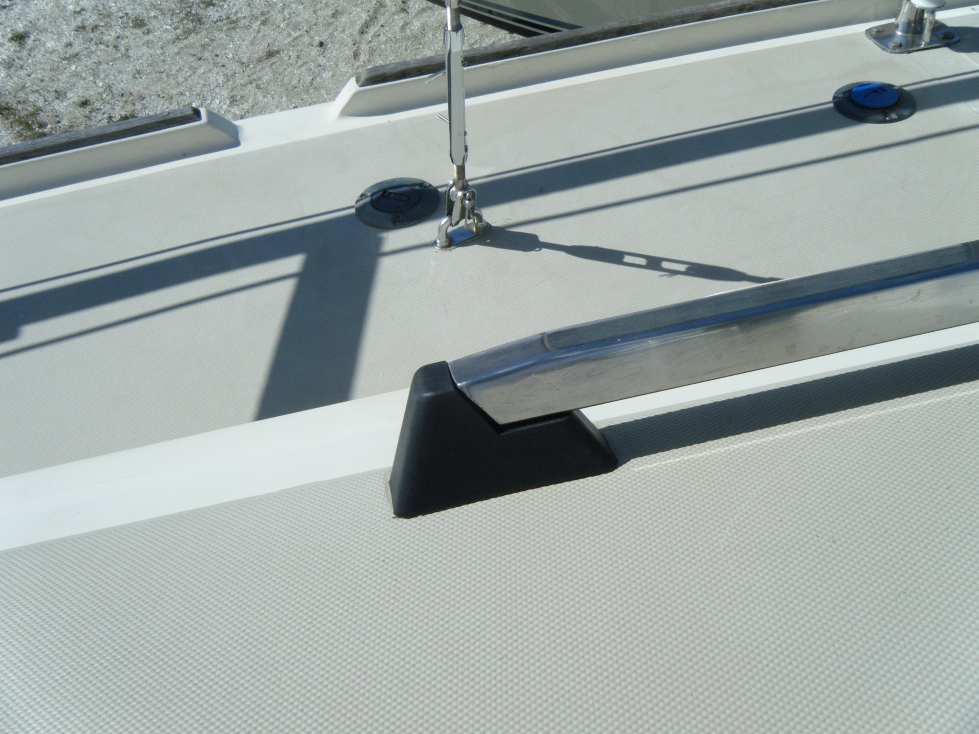

I couldn't stand the teak looking like crap, so I replaced mine with 1" Stainless Steel box tube. The problem with that is the ends must be tapered from 1" to 1-7/8" (if I recall correctly).
I got it done and this is the result, and how they look today;

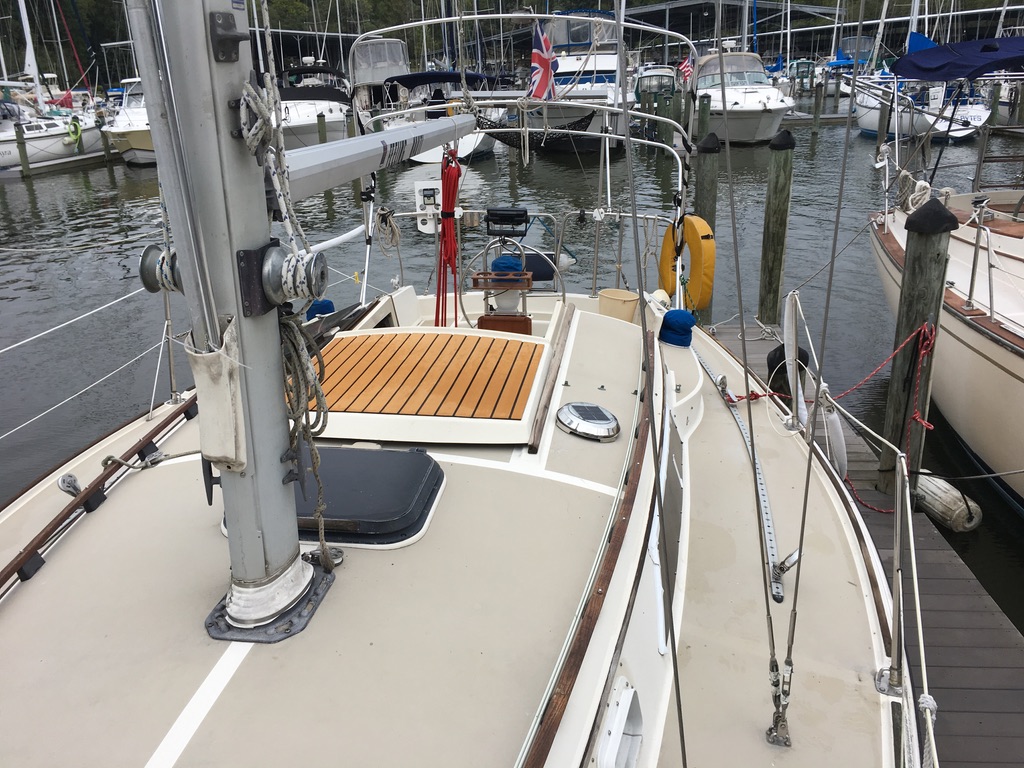

There is an O'day 34 that is used for day charters in Newport, RI, that has a similar setup to what you describe. I was looking for a static picture that would show the teak handrails on the deck, but their website takes forever to load. Instead, I found this video in which I see NO deck handrails at all;
Every time that I go to Newport I look at the boat. This time I noticed that it has an aft teak handrail with 5 attachment points (4 handholds), and a forward one with 3 attachment points. I prefer the full length rail, as I would hate to reach for the rail, and grab where the space is.
I look at that boat every time I’m in Newport also, just to compare to mine. I don’t like the hand hold idea instead of a full handrail either.
@eherlihy : Nice! The ultimate in low maintenance. I don't see any fasteners. How do those rails attach to the boat?
Did you consider using a different spacer block at the forward end to possibly avoid having to taper the tubing?
Thanks
Thanks!
I do occasionally need to "polish" the handrails with a Magic Eraser to remove the spots that invariably develop on 304 stainless.
The handrails are attached just as the original teak handrails were. The only difference is that I tapped the holes that I drilled for the through bolts (actually stainless machine screws).
I considered making new spacers, but in the end it was more feasible for me to modify the tubing. I cut a small V shaped notch in the end of the tube, held the tube together with a clamp, and a friend, who is a welder, put a nice bead on with a TIG welder. I then sanded and polished his welds so that you can't see them. I did a LOT of polishing.

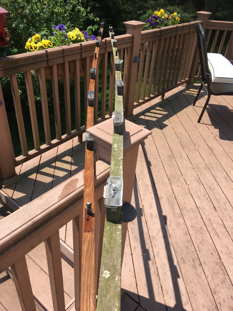

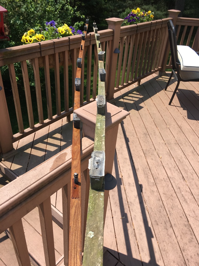

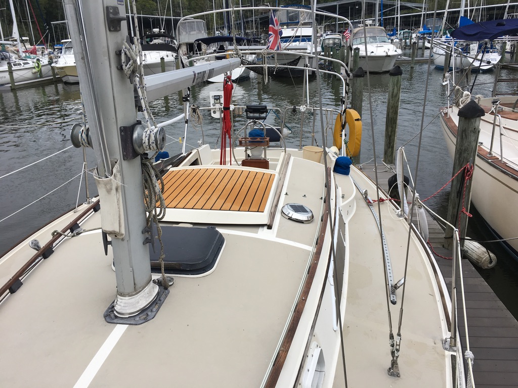

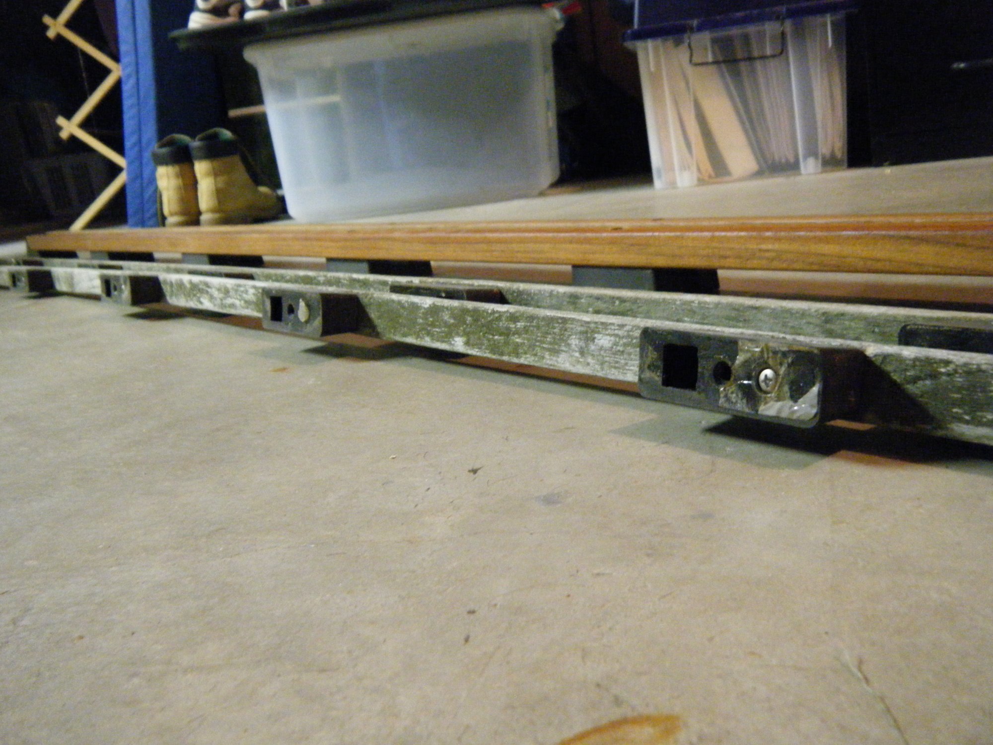

Here, in the foreground, is how the original handrails looked; (the inside handrails are in the back).
