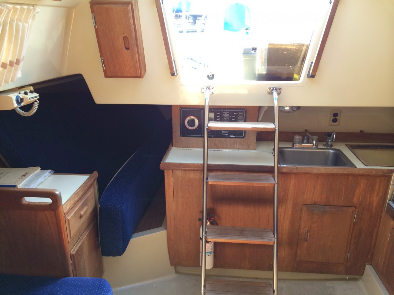

Later model 28's had a few differences from the picture you showed... Maybe some of this could help inspire some solutions for yours -
1) The barrel bolts are hidden inside the panel, and lock against the back of the adjacent panels, instead of relying on the exterior brackets.
2) The top engine cover has a frame which extends to overlap the panel on the starboard of the engine, and the panel in front of the sink. Those panels could hold the top cover and some weight even if the front panel weren't in place. I wouldn't do jumping jacks on it that way but it would probably prevent a full failure.
3) They replaced the steps with a removable ladder. Makes the first step down much easier and means you can use the engine top panel as counter space that doesn't get stepped on.

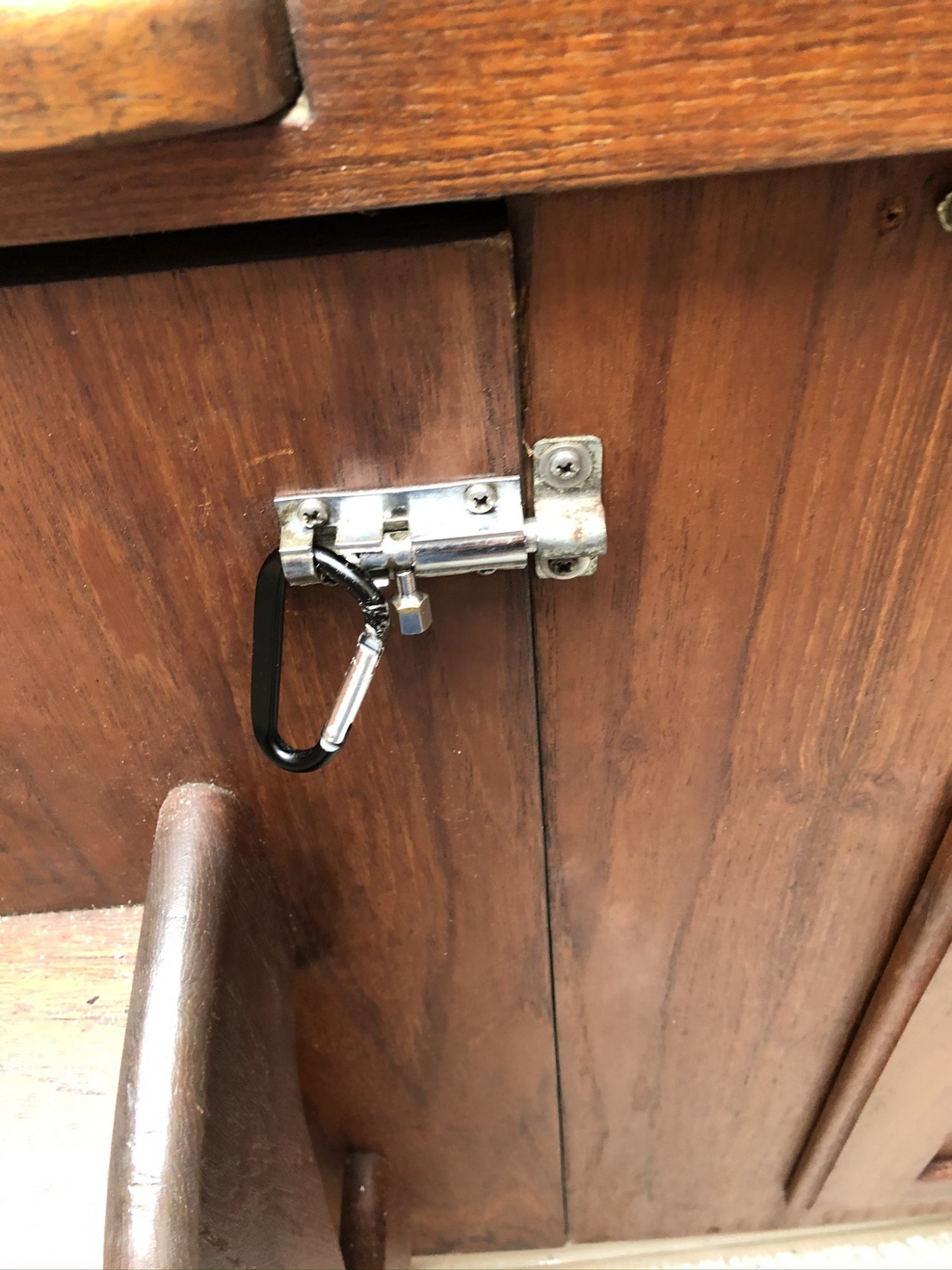

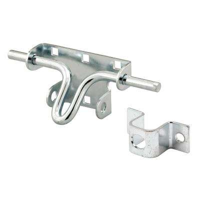

I have an O'Day 272LE and had the same problem. The shaking that occurs as you go up and down causes the bolt to want to back out and the mean for keeping it from doing so are inadequate. Worse, the more the stair shakes, the larger the hole gets and pretty soon it's awfully easy for the damn thing to back out. I added one of these between the sink and the stair. So far, no more problems.

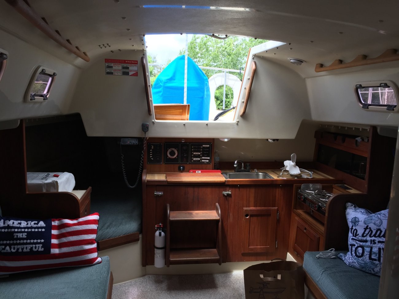

On my 30, the ladder is set up this way, as this picture . The only thing with this is "When you remove the ladder and work on or with the DC panel, watch out for the attachments bolted to the inner rim of the companion way. It hurts when you bump your head against them. How do I know.....mmmmm!"

True. Also don’t take out the ladder, climb up to throw out some trash, then forget there are no steps when you return. :banghead:
