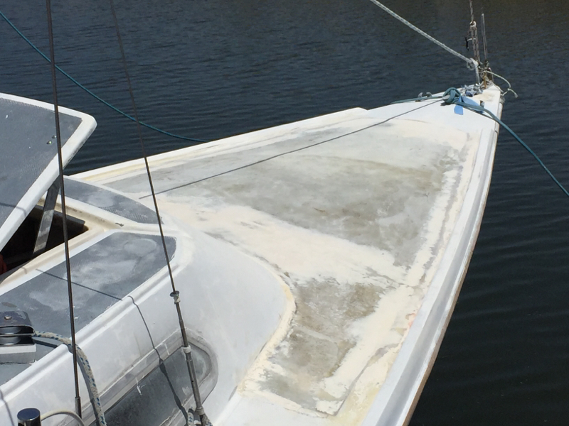

In the meantime here's a picture of current progress
