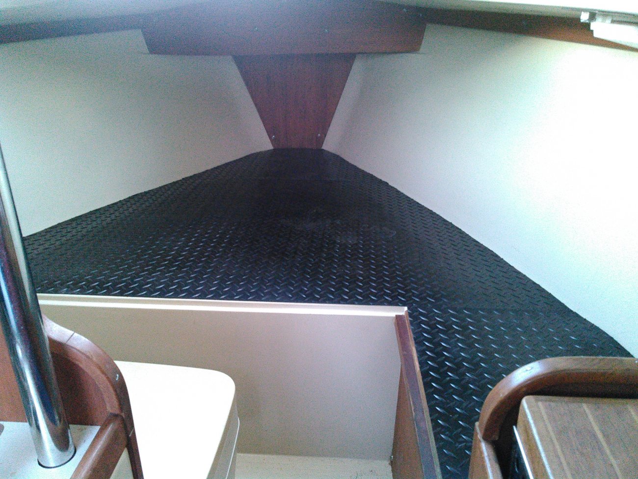

Bye Bye V-Berth Cushions:
We figure that the v-berth on the Catalina 22, as originally designed, is a PITA.
We have to move the damn cushions, and whatever is one them, any time we want to access the storage underneath.
If we want to use the portapottie we have to move the cover panel/cushion. That panel also needs to be stowed someplace else when the portapottie is "ready to go". If the panel is left in place over the pottie, it also makes it harder to reach into the storage under the cushions.
Using it for sleeping is also an uncomfortable PITA.
So our cushions are now safely stored at home, and the v berth is now a storage area.
I bought some thin, industrial rubber matting, which is sold by the foot.
I made it so that each of the 4 locker sections of the v-berth has it's own rubber mat.
The roll rubber was the correct width, to allow the factory cut edge to become a straight seam running from side to side,
where each locker lid ends. That way I don't have to lift the whole thing to get into each locker.
I also cut holes, to match up with the pull holes in the wood locker lids.
When I bought the rubber, I also picked up some SUV/Car cargo nets. They are attached along the side of the hull with the same screws that hold that factory wood trim where the hull liner meets the headliner.
So far, the rubber and netting has prevented whatever is stored in the new "V-Locker" from shifting around on each tack. The lockers below the rubber matting are very easy to access now.

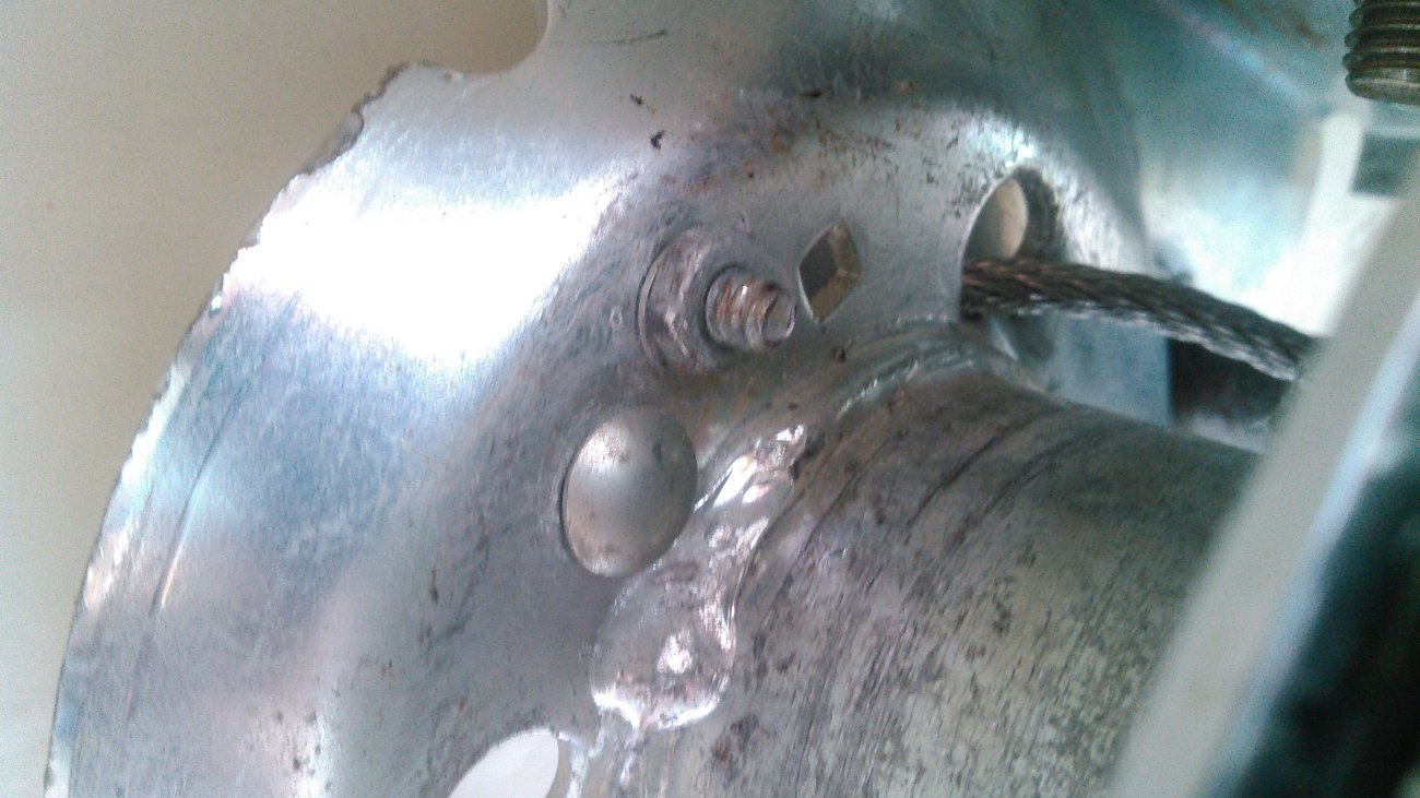

1) The keel system on Stormwatch, was serviced just before we purchased her.
New winch, cable, etc.
2) When sailing her, we occasionally found that the cable seemed to catch on something when being lowered the last few turns. "Clunk… clunk…" then the winch handle went slack as the keel was fully lowered.
3) I'd always felt that the boat was making more leeway than I expected.
On one long 5 hour tack this summer… I decided to have a quick look, while the cable was fully extended.
SURPRISE… the keel was NOT fully down.
The occasional clunk sound was the cable snagging on a nut/bolt protruding into the keel winch drum.
Depending on luck, the cable would temporarily catch.. or not… as it was lowered.
But once lowered enough, it would always catch on the nut/bolt, preventing the keel from lowering fully.
Easy fix… remove the two bolts that secure the end of the cable, and install them correctly, with the rounded heads inside the drum.
Ok… One bolt oriented the correct way…. one more to go.
First the "professionals" at the yard where the previous owners kept their boat, had the flexible furler rigged wrong, now they can't figure out how to install a cable on a winch.
Lesson: There are a lot of VERY talented and skilled professionals out there. But don't assume that ALL the people getting paid to do work, actually have the skill to do the job correctly all the time.
Every shop has apprentices/rookies, who don't have the skill and experience, but are working on customer's boats/cars/houses etc.

I, too, have put the V berth cushions in storage (we never sleep aboard). It is much easier to access things in the V berth area now. I like your rubber mat-- can you give me the source?
Sep 30, 2013
3,715
We arrived at the same conclusion, for the same reasons.
All I did was paint the locker covers to match the gelcoat. It looks good but does nothing to hold things in place. Amazingly though, stuff never seems to shift around much up there. I wisely credit this to the Admiral, for how well she packs things.;) And I installed a couple padeyes to bungee the Yeti in place, up in the forepeak. Not taking chances with that sucker.
