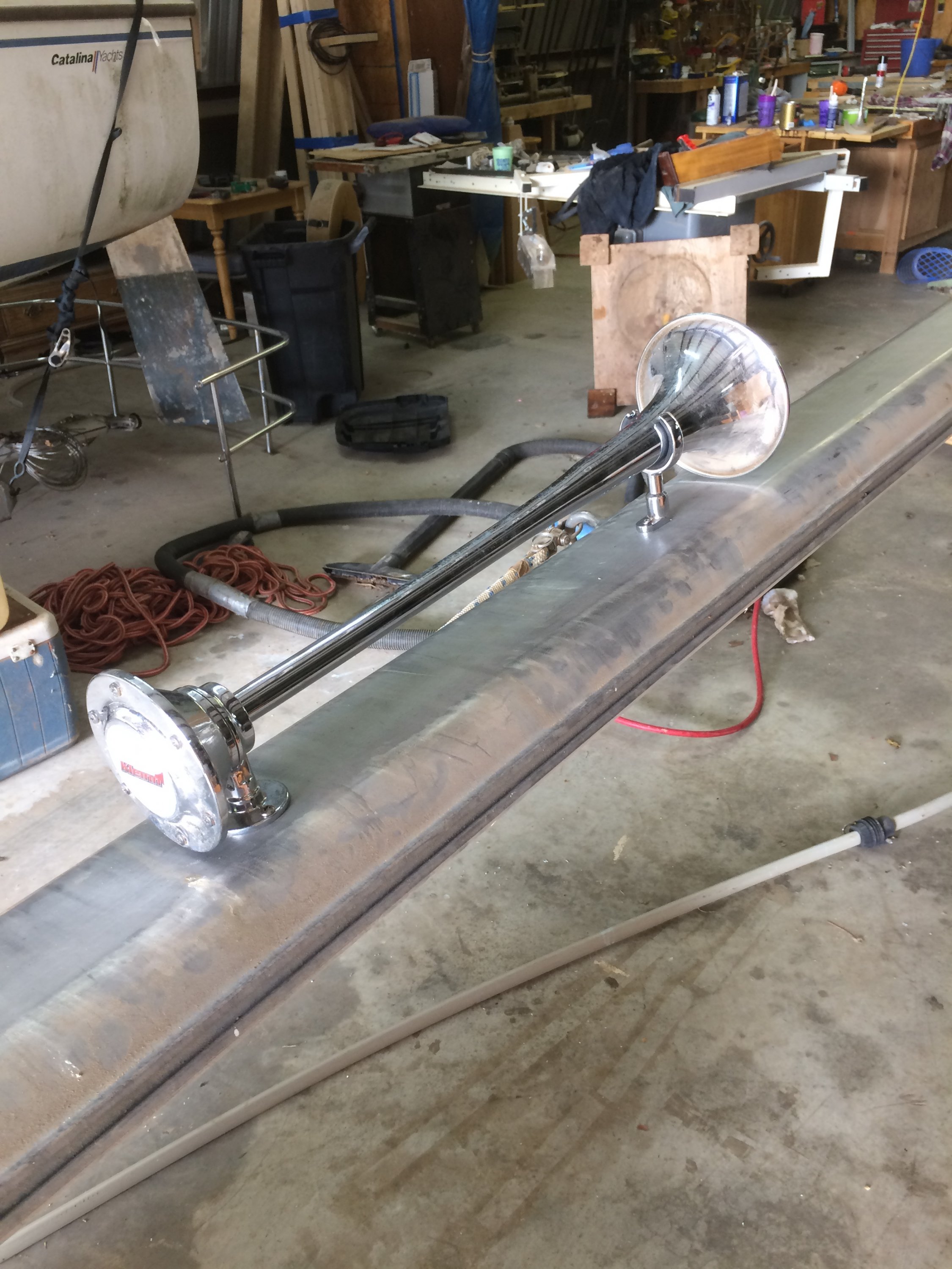

Here is the new audio signalling device...

yup...
To understand the why, you have to have been with me and my wife about 9 years ago on our Catalina 22 to enjoy the panic of being almost run over by a powerboat. Full daylight, main and 110 flying, no way to miss us, yet a couple and their dog almost broad-sided us... When they looked up and veered away in a panic, my only satisfaction was knowing they likely were needing to go to shore to change their shorts.
From that day on I had promised myself I would have a signalling device loud enough to reach out to that boat and warn them earlier... It is done...

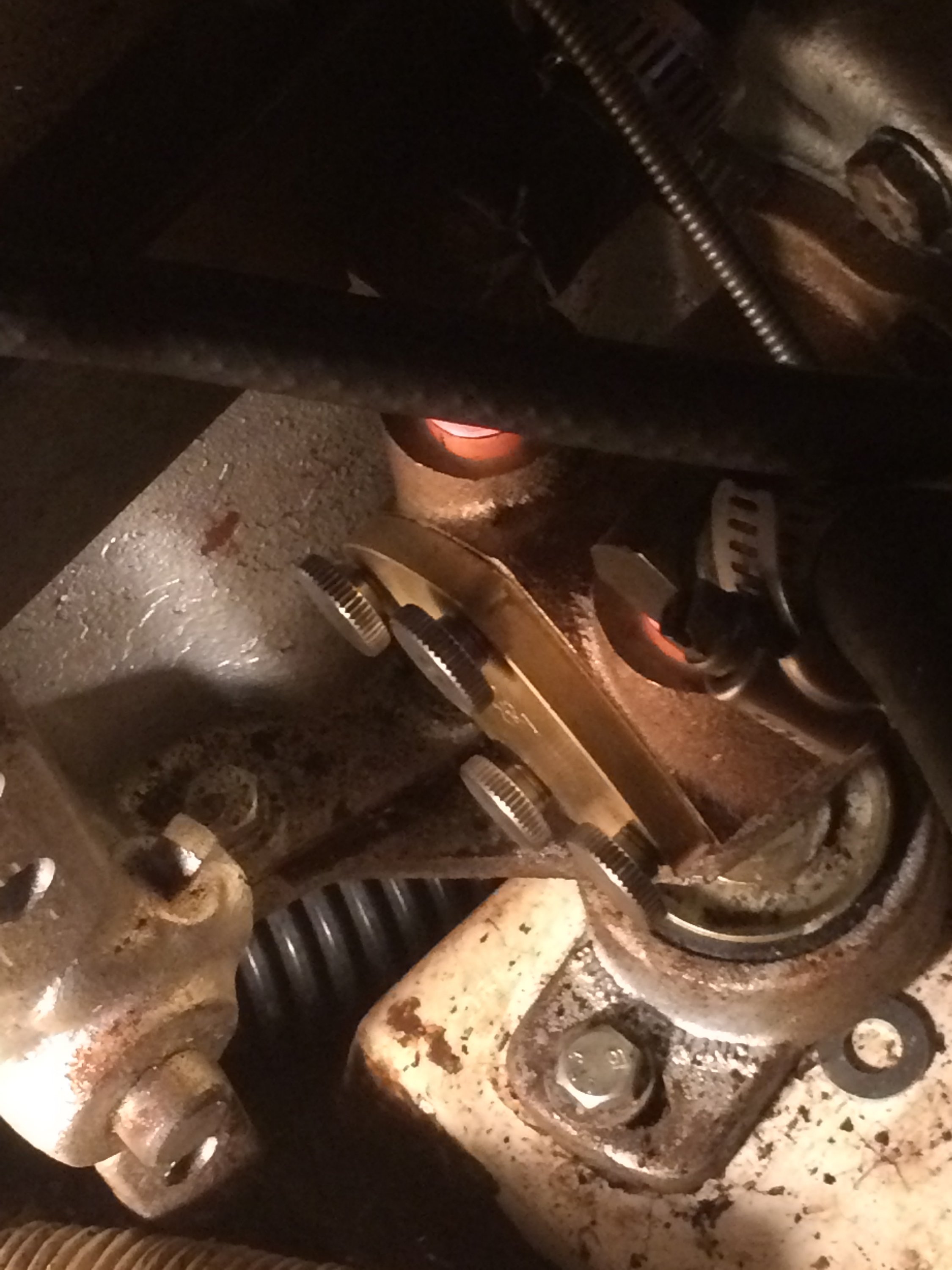

A quick update from yesterday. I found a spare gallon of pink antifreeze in the shop while cleaning up and realized that while it would not get me running and up to thermostat temperature it would allow me to crank the motor and see if it would start. We are expecting another freeze this weekend so I am not ready to be putting water through the engine just yet unless I know I can keep the motor above freezing or re-winterize it.
SO, off to the gas station to get some non-ethanol fuel. 3 gallons to be exact. I put the fuel in mixed with some Marvel Mystery Oil and then used the recently installed primer bulb to fill the Moeller cartridge fuel filter and prime the carb.
Surprise 1: It turns out that the gasket for the sediment bowl on the fuel pump was missing so as I was priming the fuel line to the carb some gasoline ended up on the floor of the engine compartment. woops... That cleanup took about a solid half hour with the vent fan running and all of the hatches and ports opened. Eventually the odor was mostly gone and all of the spill had been wiped up. I left the vent fan running while I went to the house to eat dinner.
Surprise 2: So after dinner I went back out to the boat. Despite the sediment bowl gasket mishap, enough of the fuel had apparently gone to the carburetor for the bowl to fill up and seat the needle valve. I dropped the accessory raw-water intake hose into the pink antifreeze jug, gave a quick crank of the key, and lo and behold the motor fired right up. Hurray!
I cut and fitted a cork gasket for the sediment bowl and bonded the two together with some Permatex gasket sealant. It sat overnight on a flat-plane surface to set up. Tonight I will go re-install the sediment bowl and tighten it up. Crossed fingers I have taken care of the leak. I am glad I installed the primer bulb on the fuel line; it will help me make sure that the fuel system is really tight and leak-free. The only boom I want on this boat is the one holding the clew at the back of the main sail...

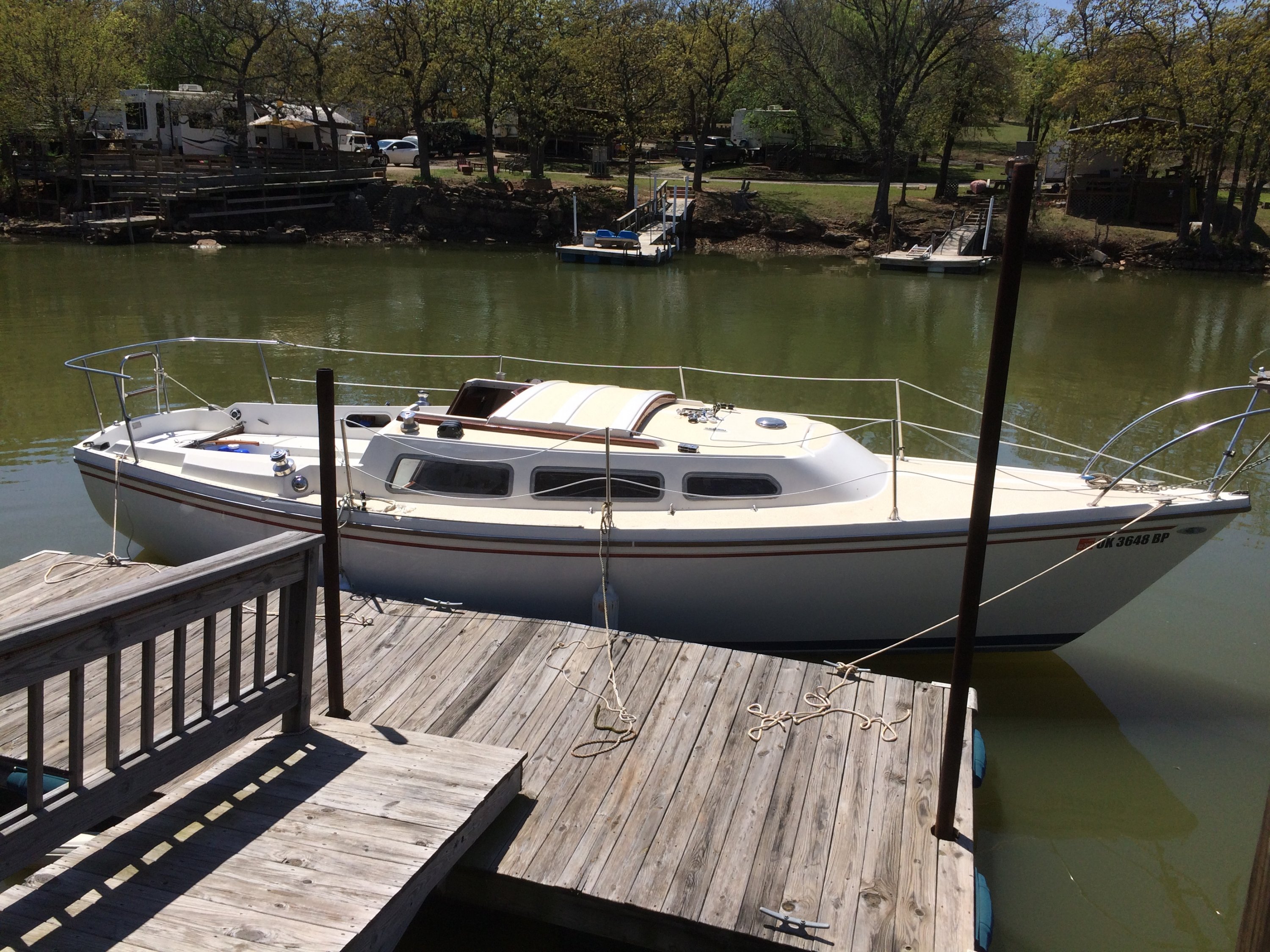

Picture worth a thousand words. Almost. :)
I have to order or build a new black pipe exhaust as mine cracked in two today after launch. Man an A4 with open exhaust sure sounds mean. LOL. Not to mention all the exhaust in the cabin! Thank goodness for a good gentle breeze today.
I'll get the stick up in the next week or so. Tension the rig and let her settle into new shape. Then I'll readjust the motor mounts to get back in line with the shaft. I'll probably call Don Moyer for the exhaust. His standard is based on the C27 so it should be bolt-on.
Baby steps but we're a few steps closer.

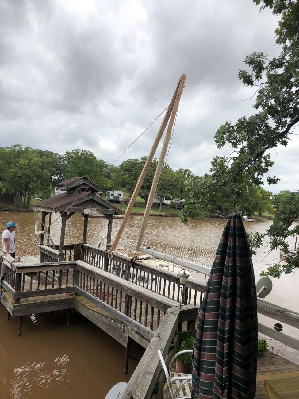

I have the A-Frame material purchased, and I have the block and tackle. The biggest issue is transport, as the most is lying in my shop about 15 miles from the boat. I have access to a trailer long enough to legally haul it. Sticking it up should really be no big deal...

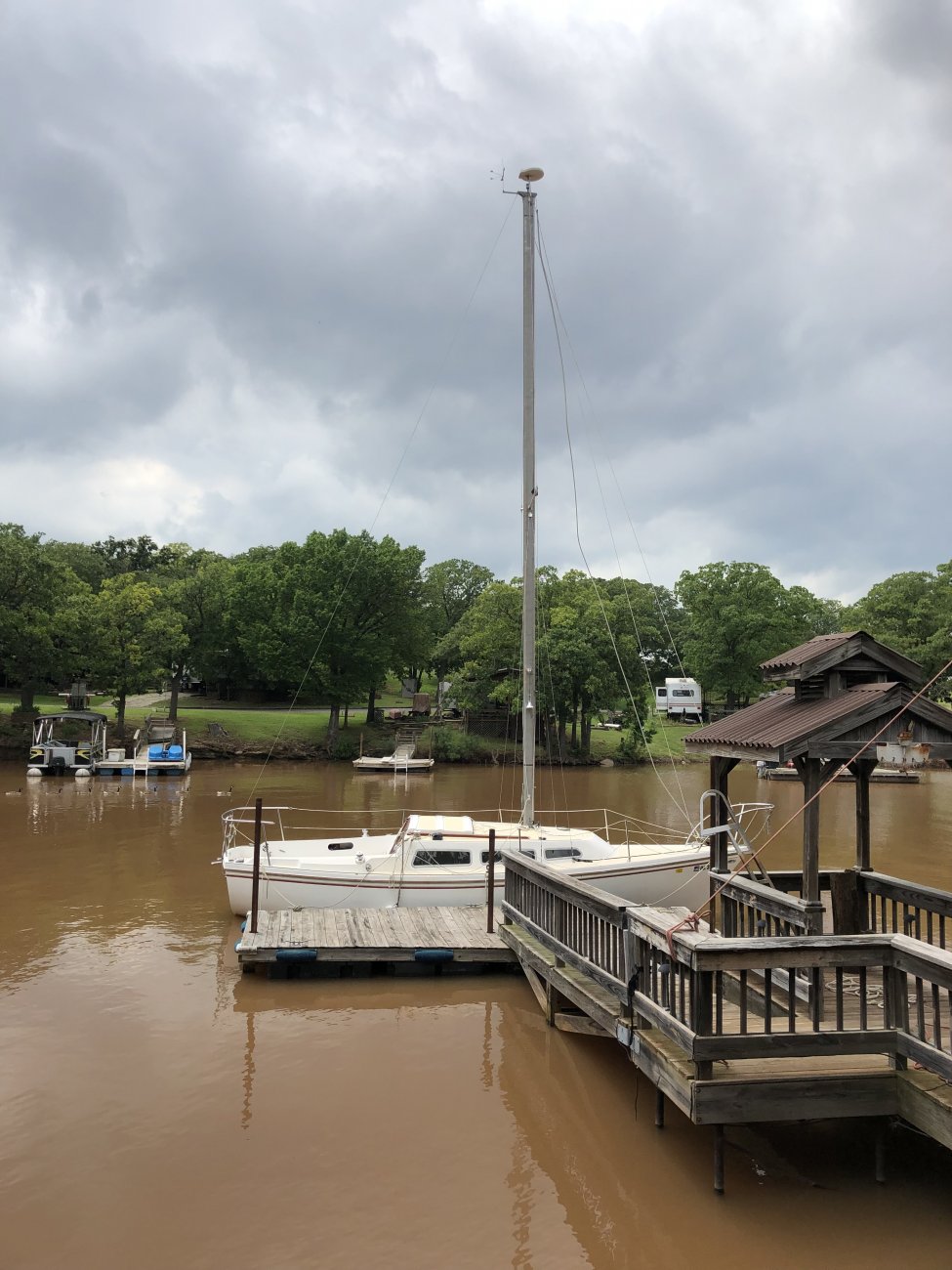

I ordered a set of 4 Schaefer 4” marine tangs tonight just now to let me get the mast completely in column. My gut says they will go inside the furler. We will see.
Carelessness witnessed a Hood Seafurl halyard swivel go in the drink. It’s in 5-7 feet of water and very silty bottom so hopefully I can retrieve it. Otherwise I’m at the mercy of the vendor to see if they will sell me just that part.
Next step. Rig the forestay, lose the halyards fore, get the mast in column and wait a week. Then start jacking motor mounts.

Well, the nice folks at Hood were able to sell me a halyard swivel, so I will be able to get the forestay attached when it arrives. I had hoped that a new 135 furling jib would be here and ready to install but my supplier disappeared. I have to find another source...
