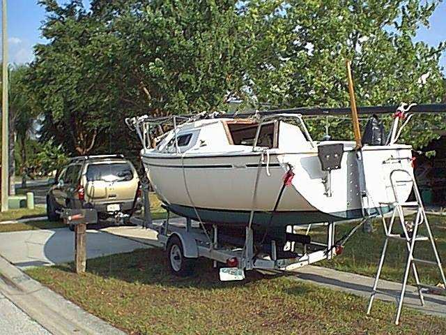

Was that the NYS regulation in 1986? It was common to find 22-23' sailboats with a single axle trailer and no brakes. States are passing trailer regulations based on highway speeds and I agree that speed is a consideration of whether the trailer is adequate. It perhaps may not be adequate for 70 MPH but if the intended use is for 45MPH roads it could very well be. There is also the tow vehicle to consider, we used to trailer a 1987 Starwind 223 with a single axle trailer without brakes, the whole setup could have been close to 4,000 lbs but we towed it with a Lincoln Navigator and had no problems braking and could hardly tell we were pulling it at highway speeds We did have a problem with having to make frequent stops because of overheating bearings likely caused by the heavy load on a single axle at highway speeds (65 MPH). We trailered up and down the East Coast, Long Island Sound, Chesapeake Bay, the Outer Banks, The Florida Keys, etc. We considered adding an extra axle but never got around to it. You can control sway by placing the majority of the load ahead of the axle and increasing tongue weight with an adjustable height hitch ball mount. Must the boat be on the trailer when you take it for inspection? Listen if you want to get brakes get them, they make sense and insurance companies nowadays are looking for every angle not to pay on claims.

The Starwind 223 had a fixed keel center board combo. It had about a 2ft draft and sat high on the trailer. We never had problems with sway by placing the outboard and most movable weight in the floor of the cabin ahead of the axle and adjusting the tongue weight. I remember those boats were sold back then with single axle trailers. A strong tow vehicle is required for highway speeds.
