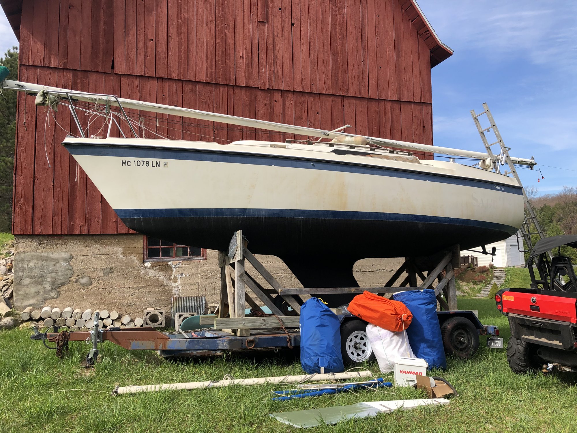

Okay guys I’m in a pickle.
I was given an 25’ O’day in hopes of fixing it up and getting it on the water. A close family friends death was the reason of this gift and I would love to honor what he had planned for this boat. I have sailed many small boats and a few larger boats but at the time of acquiring I was very new to noticing how much of a workload it has turned out to be.

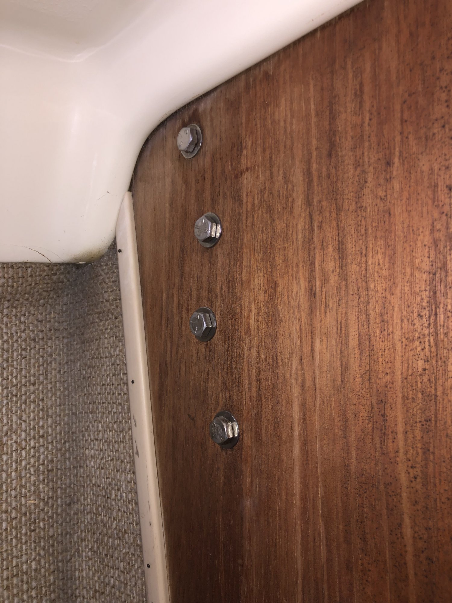

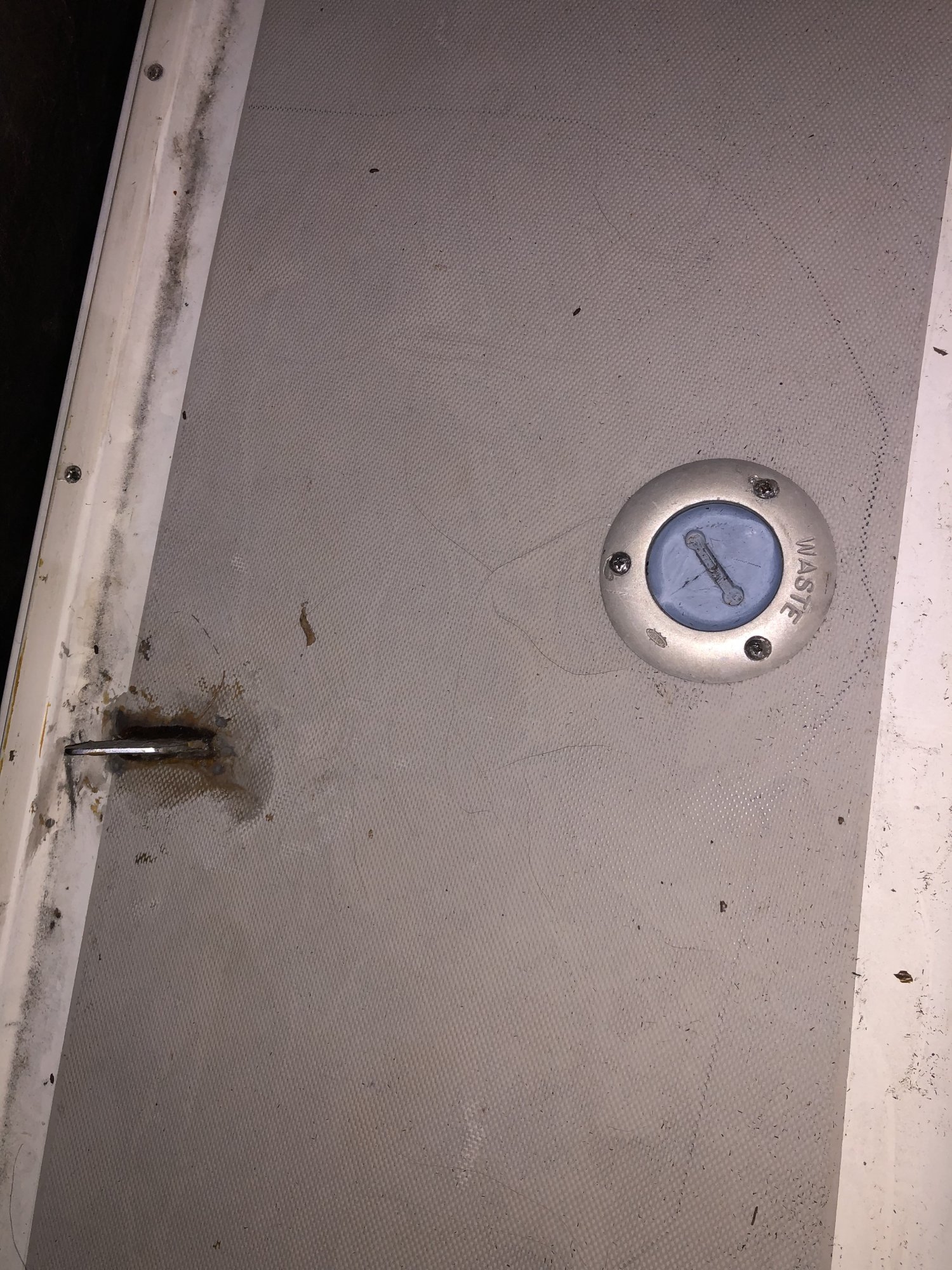

The deck is very soft around port side chainplate and both sides amidships jib blocks. I drew in pencil the soft spot around the chainplate and sewage. Also noticing that the bulkheads have received a fair amount of water damage.
It also has a yanmar 6.5hp that I want to get it going again as well. What I was told is that the lower and top end have been redone but it was having fuel issues. It was a scattered mess in the aft when I took it, so I pulled the motor in hopes of firing it on the dry.
The boat is in pretty good shape overall and comes 4 sails, roller furling, original paperwork and much more.

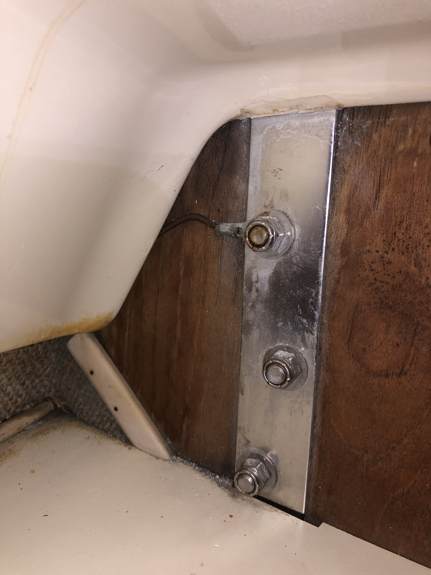

The bulkheads aren't all that hard to do . It can look pretty intimidating at first . Start with the starboard one . Use the old for a template .
most of use ended up with a nicer looking boat than when it came from the factory . I also have installed a plate on the opposite side of the chainplate so the nuts alone weren't squishing the bulkhead . looks so much more professional .

One more thing . There is supposed to be a stainless steel plate that goes over the chainplate as it exits the deck . That sir is most likely why you have leakage . If you can't find them ,they are easy to make and install . Most of us use butytape to seal them

That is smart about adding a second plate. The nuts haven’t sunk in at all on either side so I’m debating on just repairing the decks then fabricating a large plate where the chainplate could attach to. I don’t know if that’s a very smart idea though. Starboard side is definitely in way better shape and I’m not sure if i should just replace it while I’m already at it.

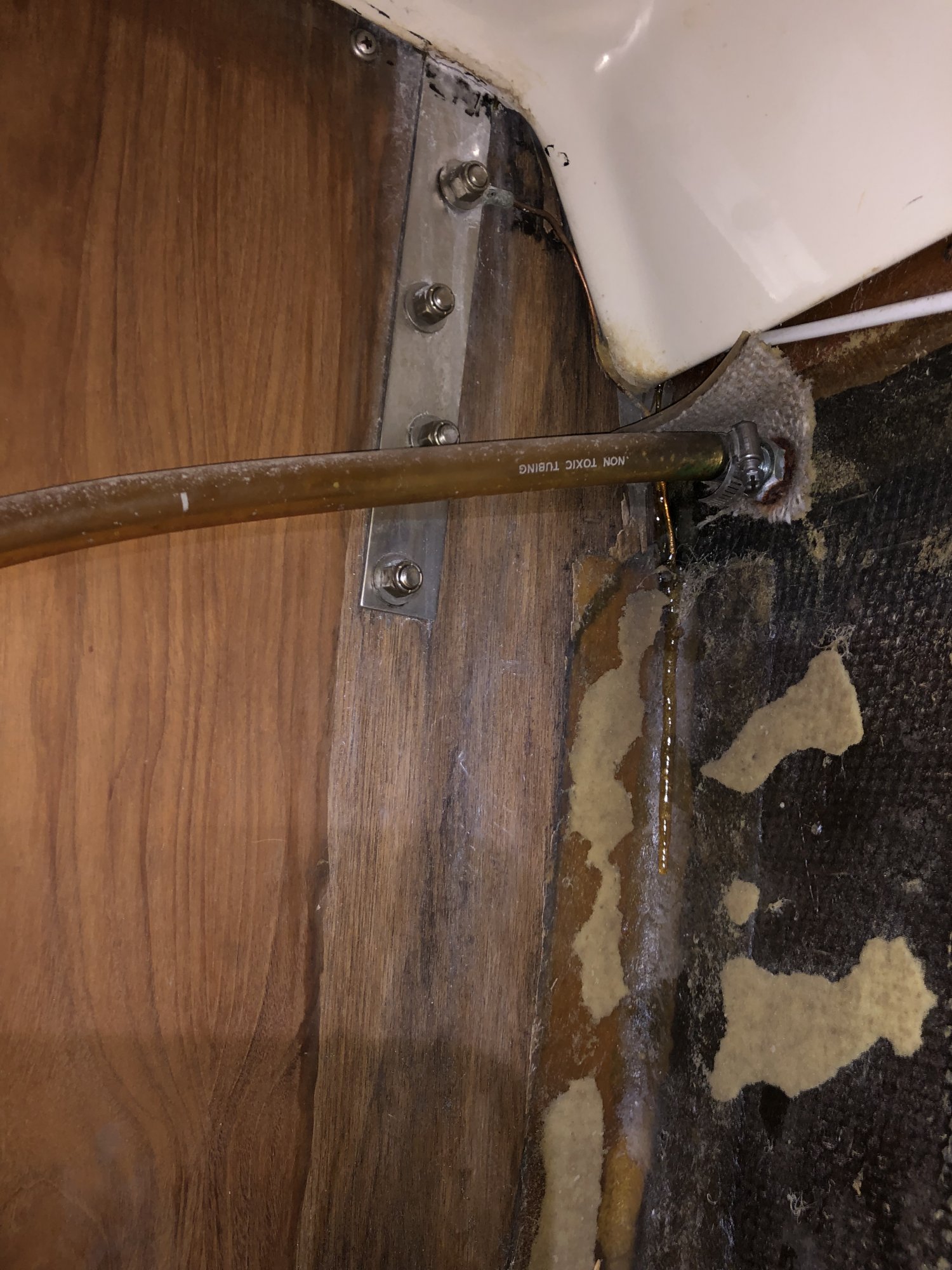

The bulkhead is time consuming but very straightforward. After all, all you're doing is replacing a piece of plywood. The PO of my boat bedded the chainplates with 4200. While I'm also a big fan of BedIT butyl tape, the 4200 kept the chainplate in the same position so there was no question on where I needed to drill the holes when the new plywood was in place. If you're plywood is a bit thicker than the original you'll probably need to sand or grind the edge down a bit to make it slide into the slot in the fiberglass. You may need to do a little bit of trim work to get it to fit but I was surprised at how sloppy the cut could be and still have it look and function well.
The port side should be a bit easier since you don't have a bunch of cabinetry to disassemble. You may run into some issues with plywood thickness when re-attaching the trim work on the straight edge of the cut board. I would also advise you to get the same width fiberglass tape as what the factory used to ensure you don't run into any issues (although they're pretty minor if you use wider tape).
A couple of areas that may be prone to water damage is the wood for the lower gudgeon and the anchor rode locker if yours' is below deck. The rode locker isn't crucial by any means and I will probably never replace the rotted plywood in the bottom of mine.
O'Day used silicone to bed the deck fittings so you'll want to rebed them to avoid more deck damage.

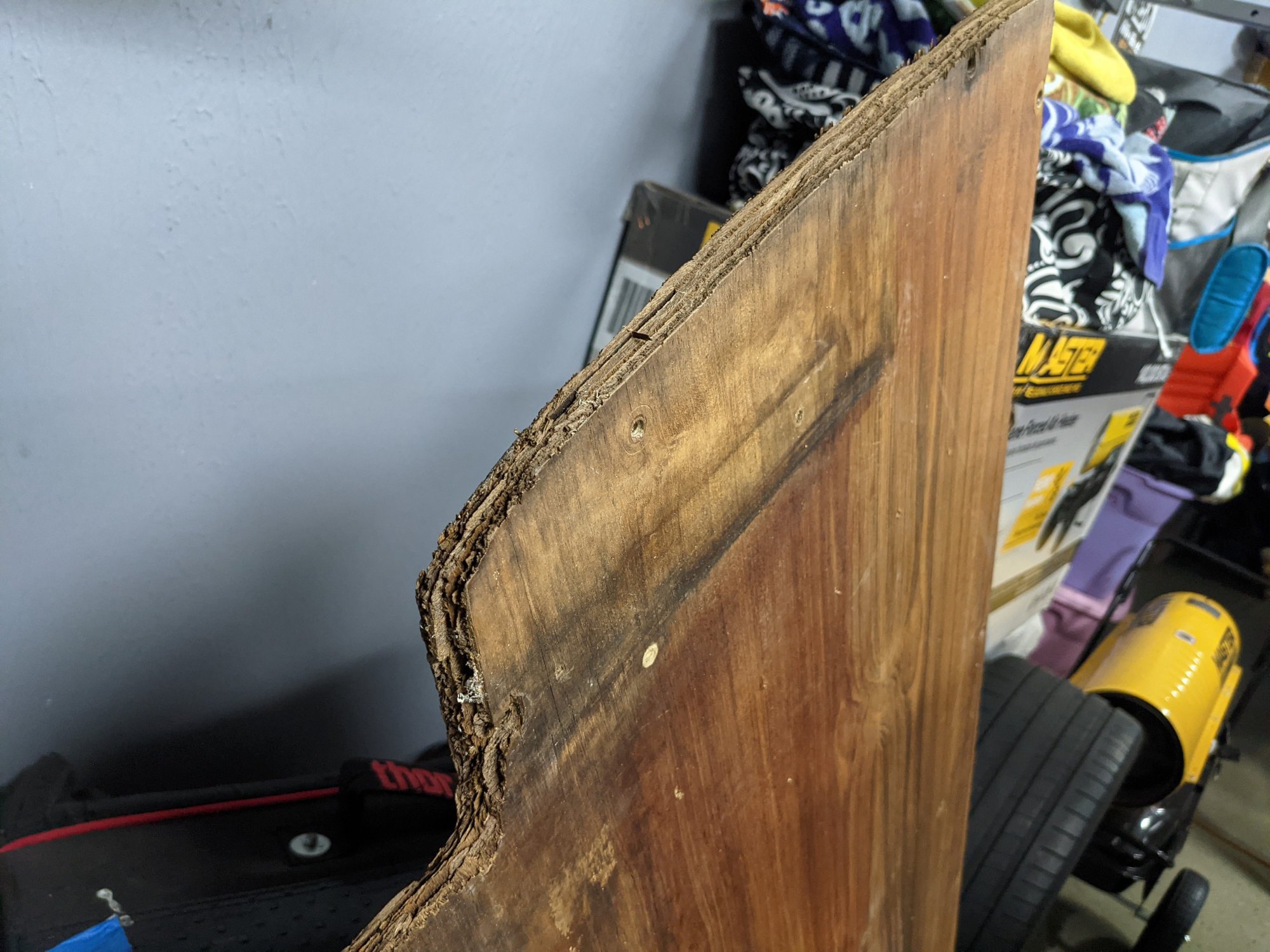

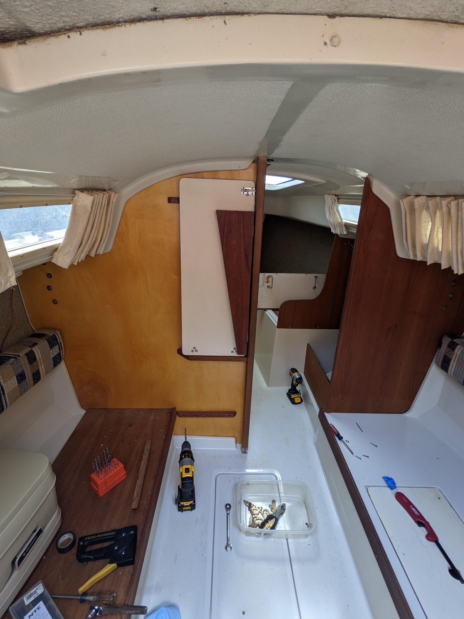

I've got an O'Day 23 that had some pretty good rot at the bottom of the port bulkhead. I just took it out, set it onto another piece of 1/2" plywood and drew the outline. Cut it out with a jigsaw, and then a sander to match it up as close to exact as possible.
Finished the edges with un-thickened epoxy, and the faces with Sikkens Cetol.
I also ran a groove across the top of it so I could run new anchor light wires since mine did not have one. The original wiring hole comes out right on top of the bulkhead, so I had to get creative.
