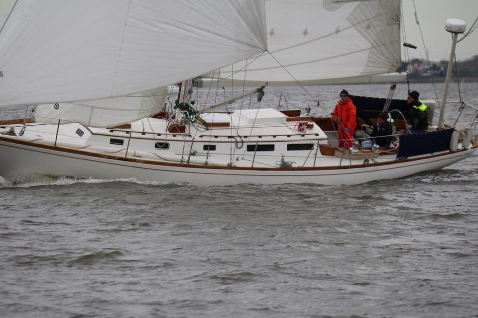

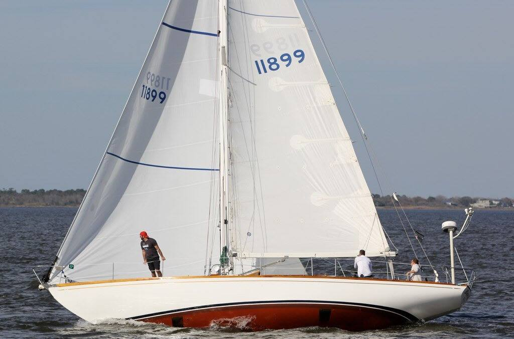

I spoke with Niels Helleberg a lot about re-rigging my Alden Caravelle and it has a taller mast not unlike the boat with the C/F mast. He did the drawings and sourced the c/f mast for that boat. Both my Banjo Girl and that boat are fractional rigged. He told me in large part the CF project went fractional to save money and be able to re-use head sails and part of the standing rigging. I chose to go with a fractional rig on Banjo Girl for other reasons. I would have done carbon if not for the cost. I can say that taking my mast up almost 5 feet really helped the light air performance and I love flying that big spinnaker off the mast head! She is a screamer downwind flying the big kite!
...and Jon, if I could get my Caravelle up there I would take you up on the race! ;)
