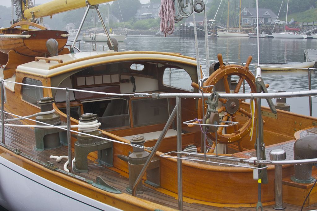

thunderhead it appears has no bench seating in the cockpit. hardcore racing/sailing work area. i like it.
She has bench's but they end shy of the bridge deck, Jon. Big wide bench aft too. They only problem I see is it would be a hot cockpit on a real warm day.
How about the mainsheet winch?

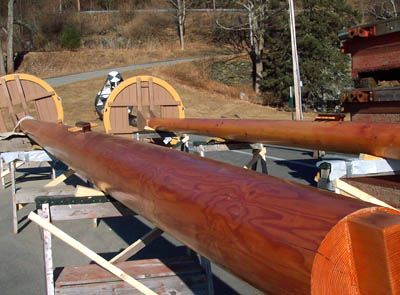

I've never seen a large spruce mast that wasn't glued up. The base often through the partners are glued up solid. Often the pieces are continuous but often joined with the joints staggered of course. Then after a half century or more many have short sections scarfed in for some repair, even after a full break.
You can nearly read the dates on the imprints the good luck coins left that are often placed at stepping.

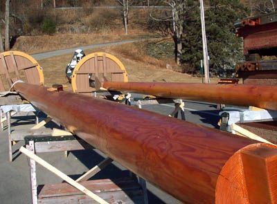

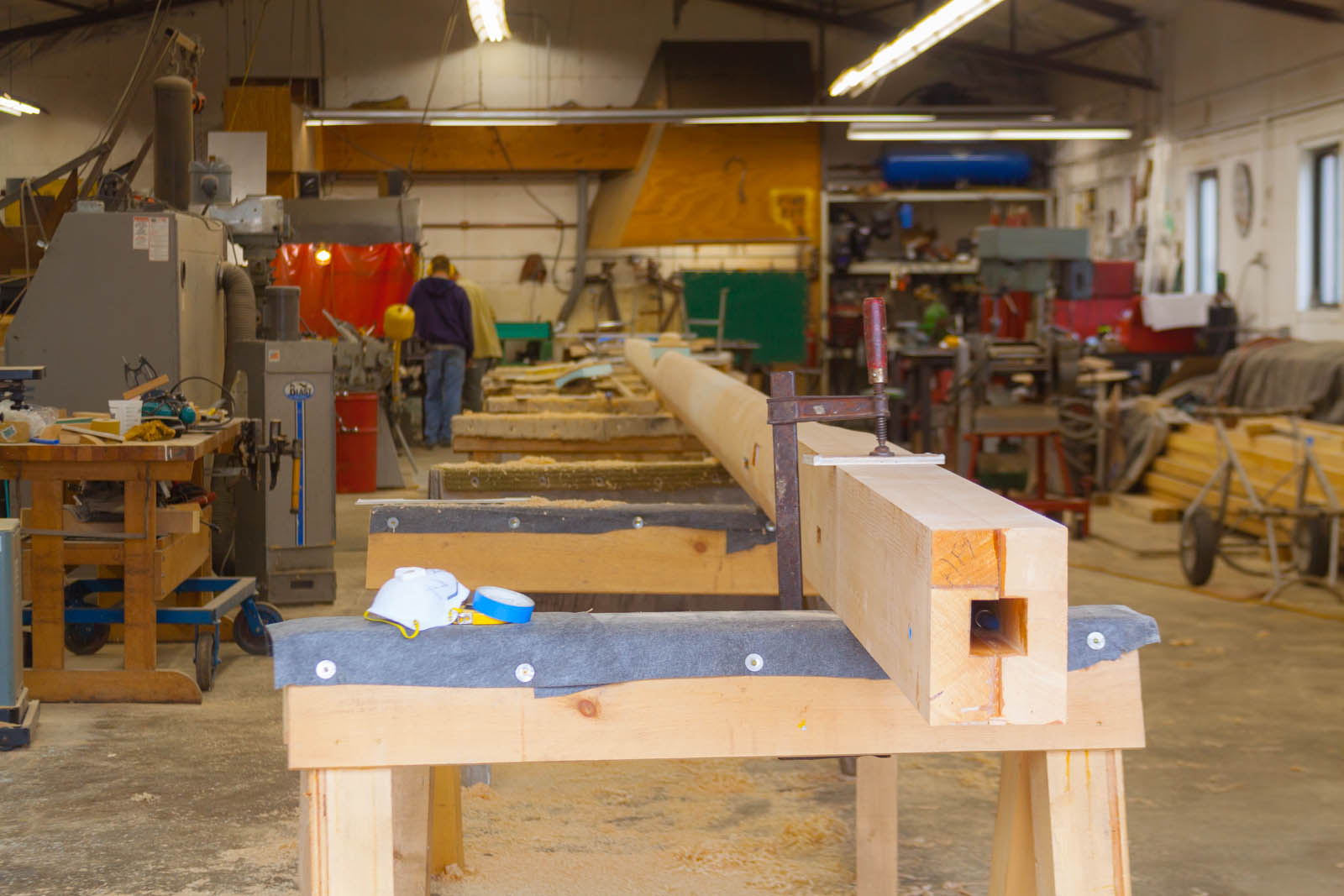

New spruce spars are regularly built today, especially here. Today it's harder and harder to get clear (knot free) stock, especially in Sitka spruce.
This spar was for a schooner that was built at this yard. It was all hand built of 6 pieces of square stock, glue, lots of clamps and a straight bed of horses. Shaping was largely by eye and hand plane, sanding with long boards, varnishing happened right here as well.
I guesstimate, from the core section of filler that is omitted to make a hollow spar - which would be about a board foot per linear foot - you'd average 2-3 pound a linear foot weight savings in the average hollow, 40' stick vs. solid.
So 80-120lbs lighter. Any idea of the finished weight of the spar?
I also wonder what the component is inside the cavity. Is it just a conduit or some type of structural enhancement?

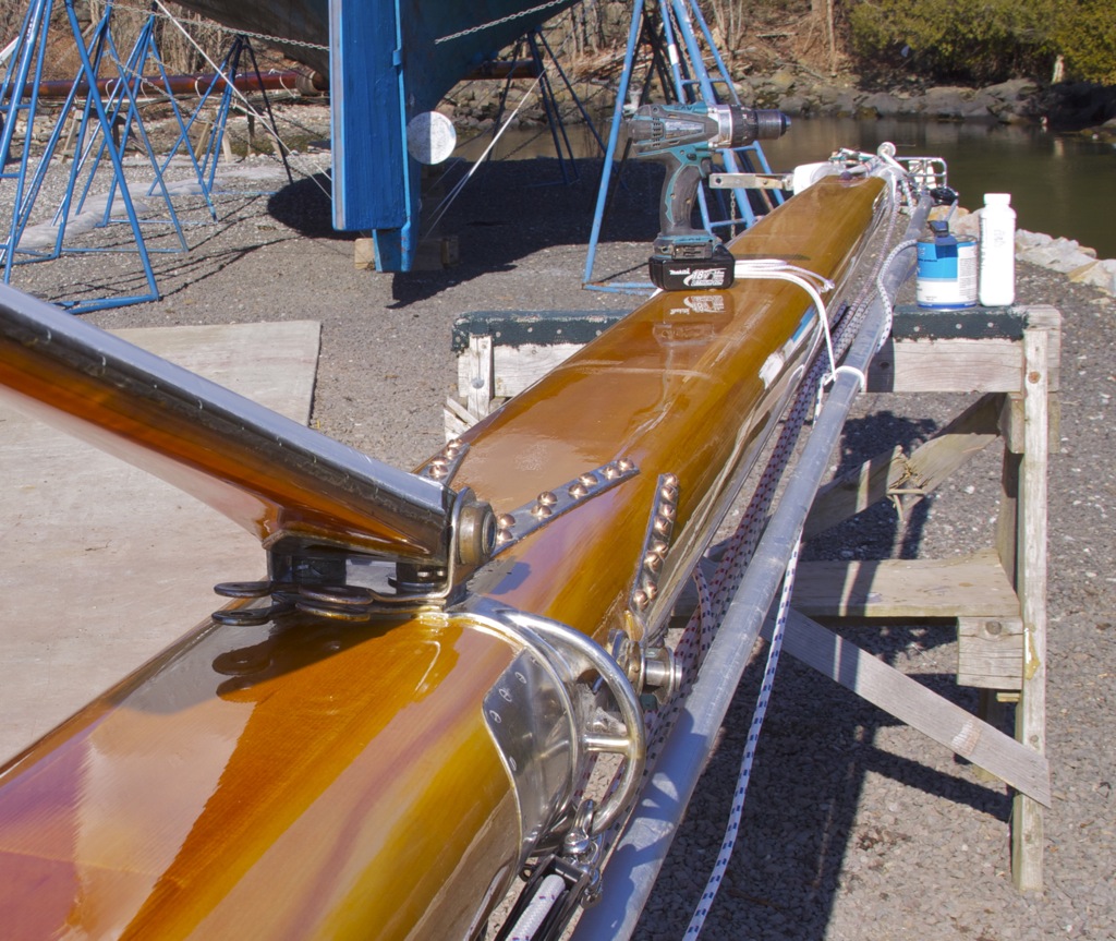

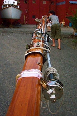

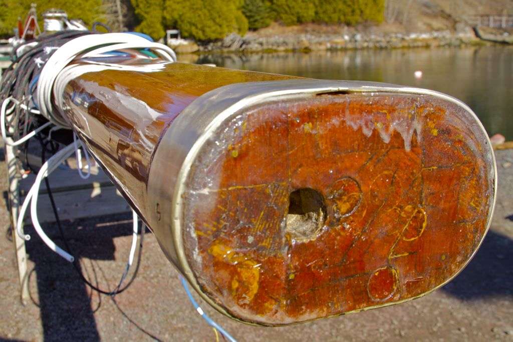

For years my family rolled the main mast to and from our boat at haul/launch, as I stored it outdoors alongside the boat.

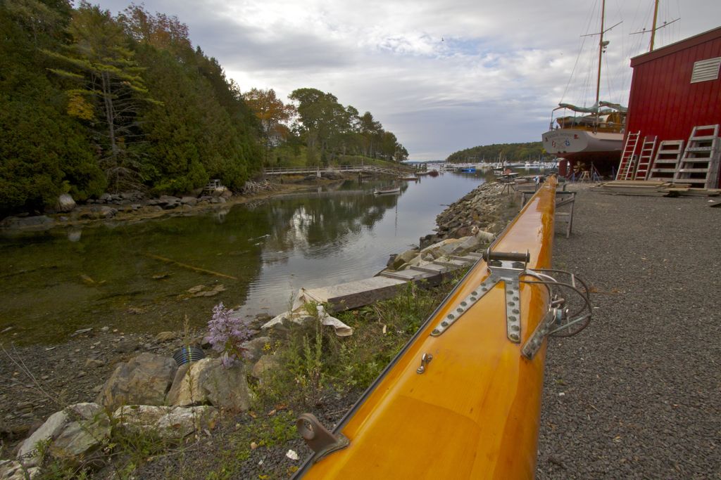

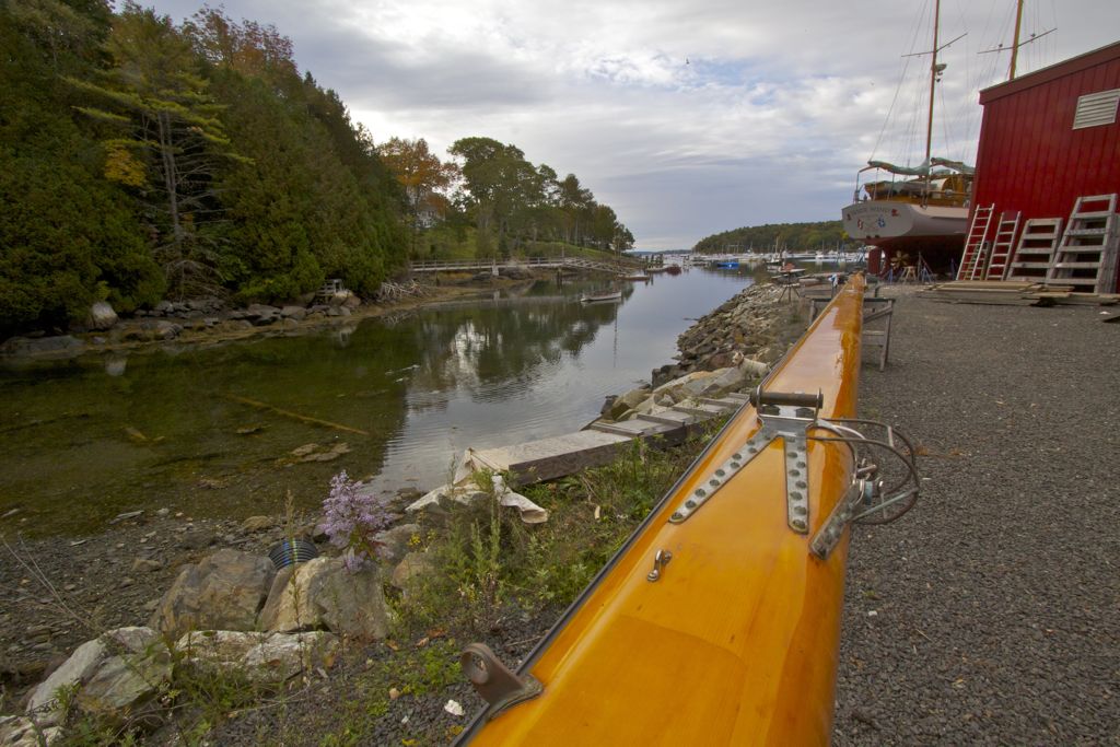

Some wooden spar photos I've taken:
The ancient boats, even if built new like GODSPEED launched in our harbor years ago, are often solid.

If spruce spars are cared for they don't seem to have a life span.

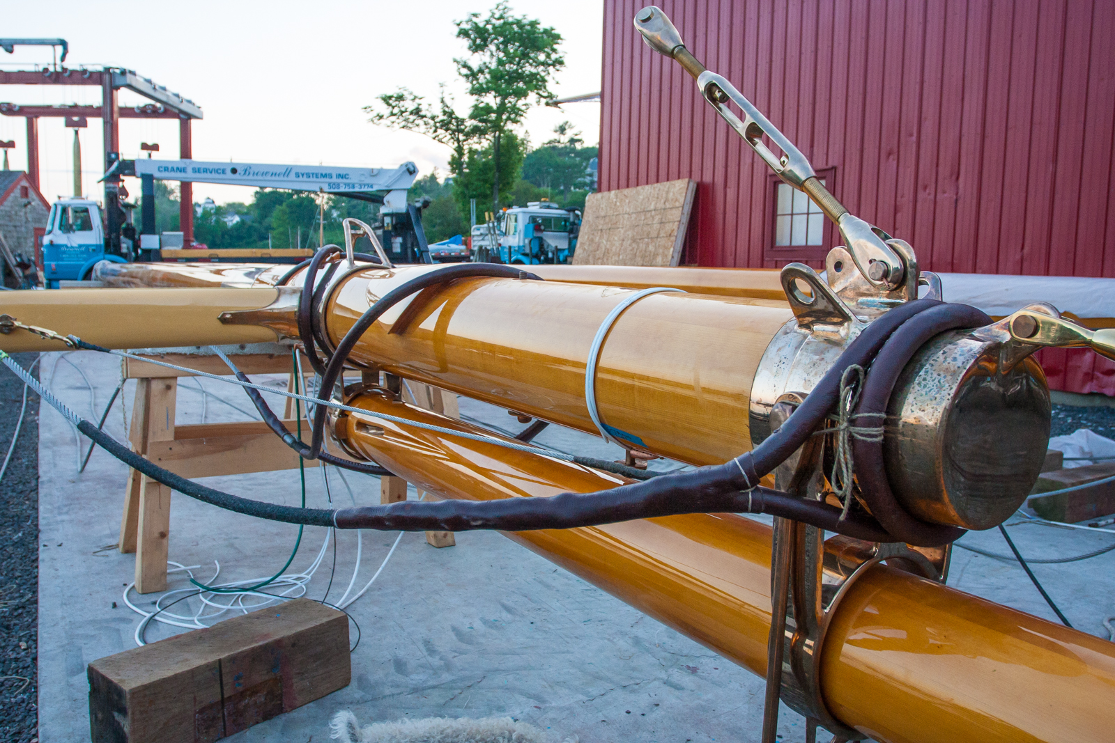

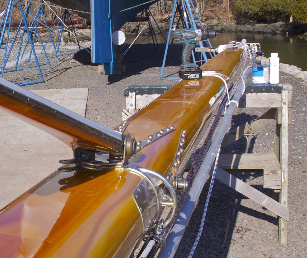

At the yard in my harbor, they not only build the spars, they fabricate the fittings.

Works of art! Thanks for sharing.
I see your mast cart is teenager powered! ;)

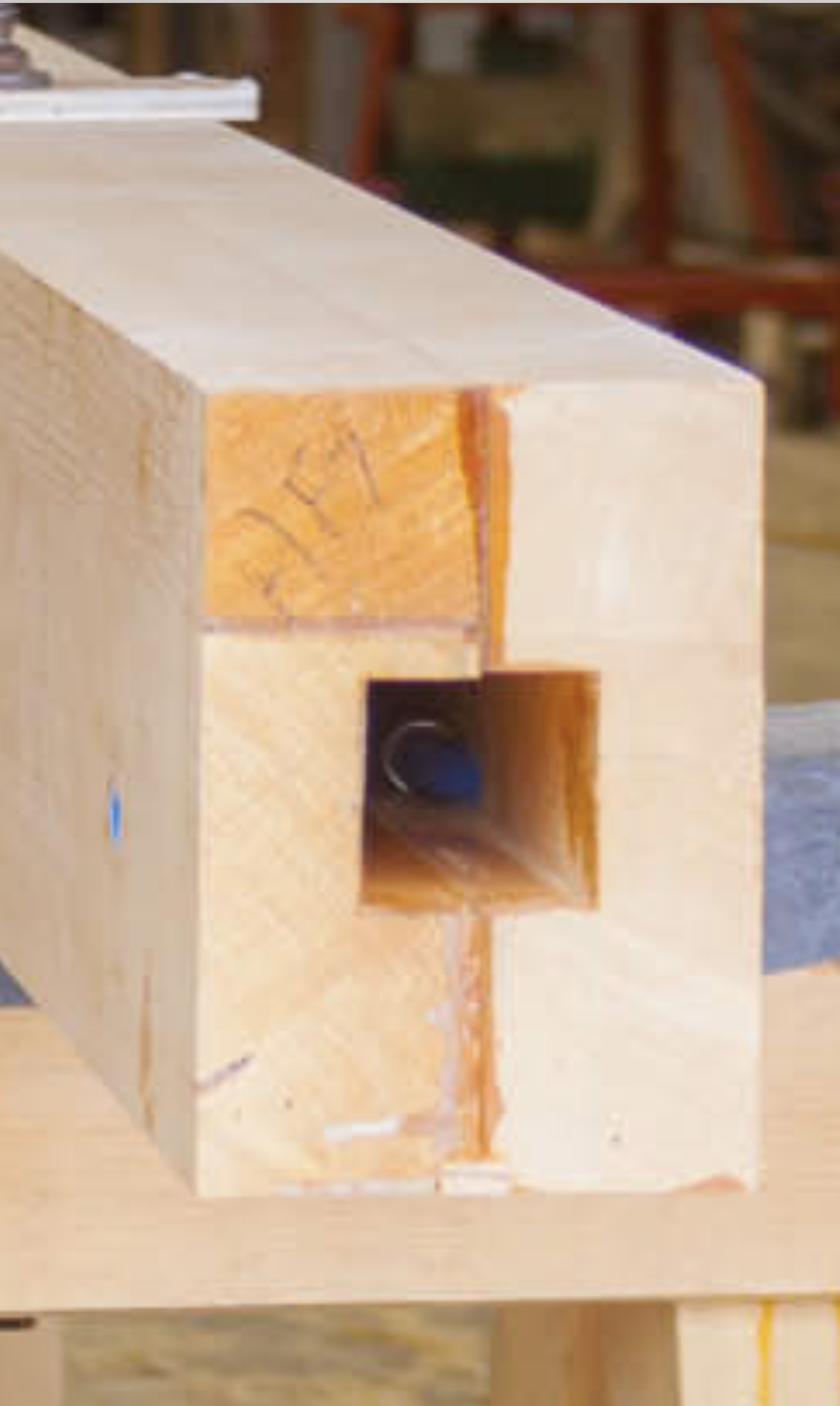

The “device” that I was asking about inside the core appears to be man made. There was also something in the video that Will posted where they laid something in the core. If I zoom the photo it looks like this.
Oct 19, 2017
8,027
I couldn't say what that was, just what I would do.
I notice there is a blue something or other that appears to be coming through the side wall and turning into the metal hoop. The metal hoop could be the end of a conduit tube or it could be an eye loop. There is a blue spot on the outside of the opposite wall that roughly matches, so, blue plastic conduit held in place by a metal screw eye?
I would definately install halyard conduits if I were going for internal halyard and certainly electrical conduits. They would make getting past the spreader braces much easier.
