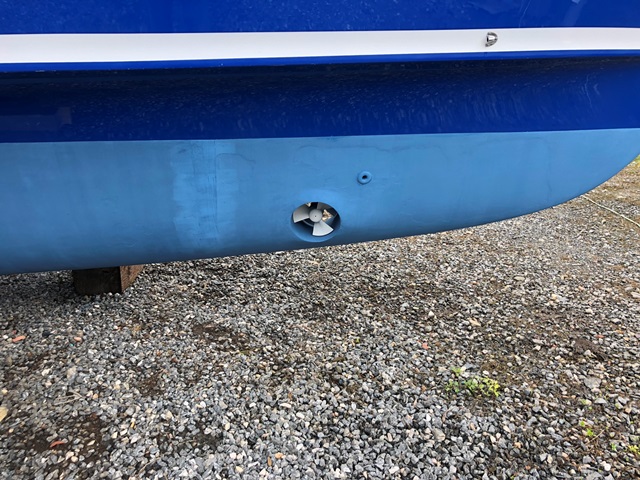

They do not require any maintenance other than inspecting the zinc during bottom cleaning and inspection when out of the water for bottom cleaning. Surprisingly, it also does not take up much space as shown in the attached photo.
Have a picture of it from the inside..

r. If they get crusted up with barnacles, doesn't that cause problems?
Only affects thrust performance, not drag, because the fouling is within the tunnel. Yes, you need to dive on them periodically just as with props. a small 1” scraper with short handle is all you need if there’s anything hard growing on the blades. My thruster blades are anti-fouling painted so there’s little growing.

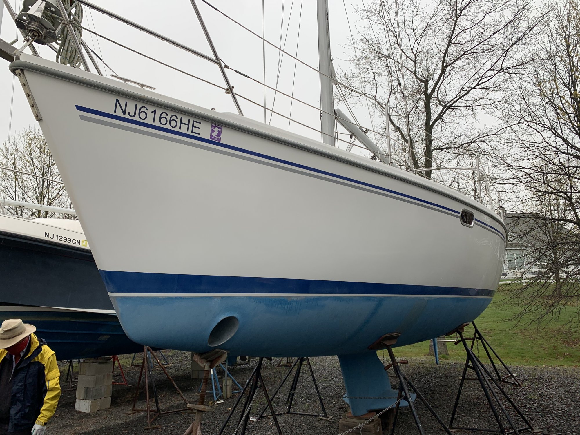

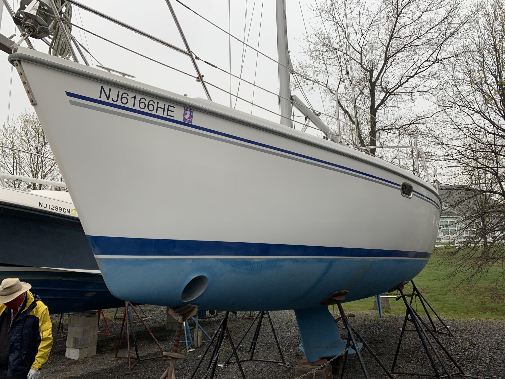

Well, it's funny. After all this discussion, I still can't make up my mind about bow thruster, plus or minus. I was mostly convinced that I should just accept it as a plus. I spoke with a friend of mine, whom happens to be a very serious racer, and he basically said I wouldn't notice it until the sailboat next to me is walking away. He went on to say ... bow thruster, in-mast furling, fixed prop, you won't be racing that boat. I had to admit to yup on all three accounts. It's only the fixed prop I can do something about. I'm not a racer, but I have to admit that if the boat was really calling to me, I wouldn't have so much hesitation. This boat on paper is mostly what I want but I'm 0 for 3 so far and still shopping!
Here's how the bow thruster looks to me and I have to admit that it is more than a little disconcerting, just for the appearance of drag. Otherwise, a beautiful sailboat!

I guess you also have to decide what you're going to use the boat for. If it's racing then absolutely regular battened main, full keel, not shoal draft, folding prop, hank on head sails, etc. etc. Strip the boat of coolers, extra batteries, minimal water, minimal fuel etc.
If it's for cruising, in-mast, shoal keel, furling jib, feathering prop, and you'll probaly ( like me) load it with 500 lbs. water, 500 lbs. batteries, drag a 250 lbs dinghy behind, 200 lbs. food, ice, beer 200 lbs. clothing and comfort necessities and not worry about trying to gain a nano-knot of speed. I can still get 6.5 knots with all of the above, so why not be comfortable at the same time.

Well, it's funny. After all this discussion, I still can't make up my mind about bow thruster, plus or minus. I was mostly convinced that I should just accept it as a plus. I spoke with a friend of mine, whom happens to be a very serious racer, and he basically said I wouldn't notice it until the sailboat next to me is walking away. He went on to say ... bow thruster, in-mast furling, fixed prop, you won't be racing that boat. I had to admit to yup on all three accounts. It's only the fixed prop I can do something about. I'm not a racer, but I have to admit that if the boat was really calling to me, I wouldn't have so much hesitation. This boat on paper is mostly what I want but I'm 0 for 3 so far and still shopping! View attachment 178915
I think you should leave it for someone else who will appreciate it. :)
My boat sails 15+ knots in flat water (even with the slightly uneven bottom paint) and it has one of those holes in the bow, too. 19 years old and no problems with the thruster so far.

@Scott T-Bird Where do you envision needing/using the thruster? I think when you race with the local club the competitor in you will wish you don't have those big ugly holes in your bow. :biggrin:

@Scott T-Bird that thruster tunnel looks over sized (8" or 10"???) which is way over sized for that boat to begin with we have a 6" tunnel in our 41 and it doesn't appear to be as intrusive to laminar flow over the hull.
