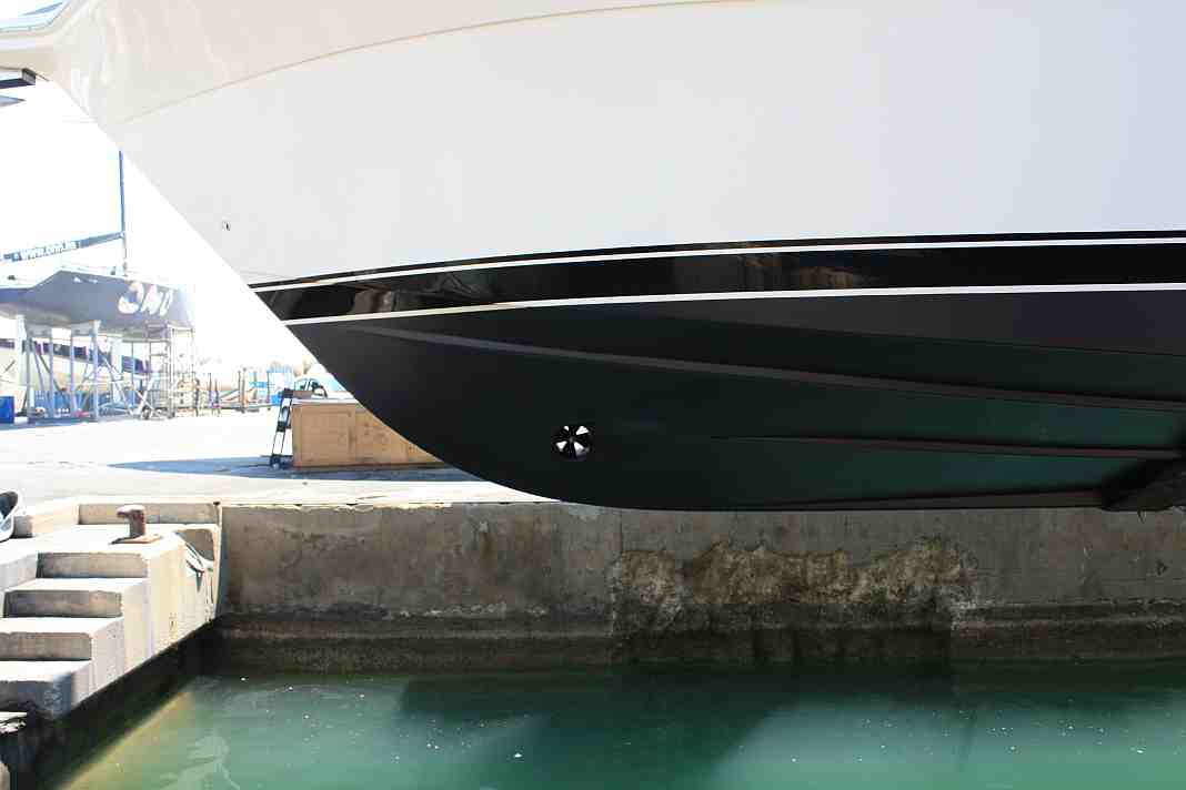

A bow thruster on a 32 foot boat isn't essential. The big hole in the front of the boat will affect sailing performance, which may or may not be an issue for you. There will be turbulent water around the hole which will disturb the water flow along the hull.

The hole in the bow will disturb the laminar flow along the hull and that will affect sailing. How much I can't really answer. It is also a nice home for those salt and brackish water critters that like to homestead on boats.

Only reason for it to be negative is if you consider it a negative. If sailing performance (i.e. racing against other boats with out a thruster hole) is the issue then at thruster hole will be a negative. You will need to be smarter and work harder then your competition.
It's on the boat, I know (or think I know) that I can't get rid of it. Is it feasible to cover the holes? I've noticed that higher-end sailboats actually build in a retractable cover for the holes.
Yes you could build a plug to install or remove. Will it be a drag on your sleek hull? Yes. How much? Only you could tell by testing it. If a 3 bladed prop is a drag compared to a folding prop, then a hole in the bow will be a drag compared to no hole.

Going back to the thruster, I don't like the hole in the bow. Does that affect sailing performance? Or am I being over-concerned about it's affect? Is it like dragging a dinghy or something I would never notice?
Without position and size dimensions there is no way to estimate the effect on sailing performance. What impact does dragging a dinghy cause? 0.5 knots - 1 knot? Do you notice that or do you accept it?
