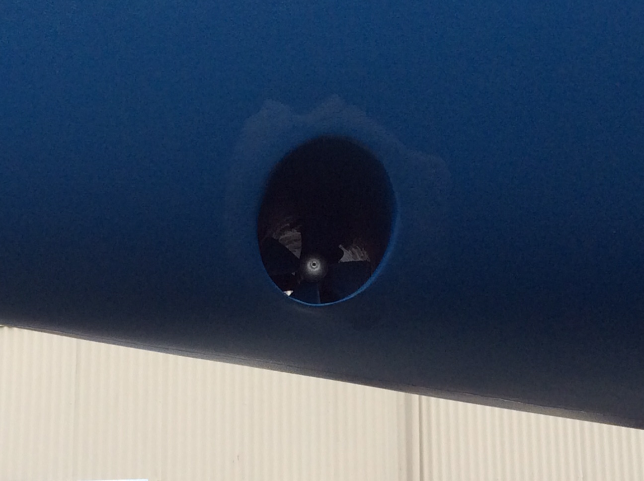

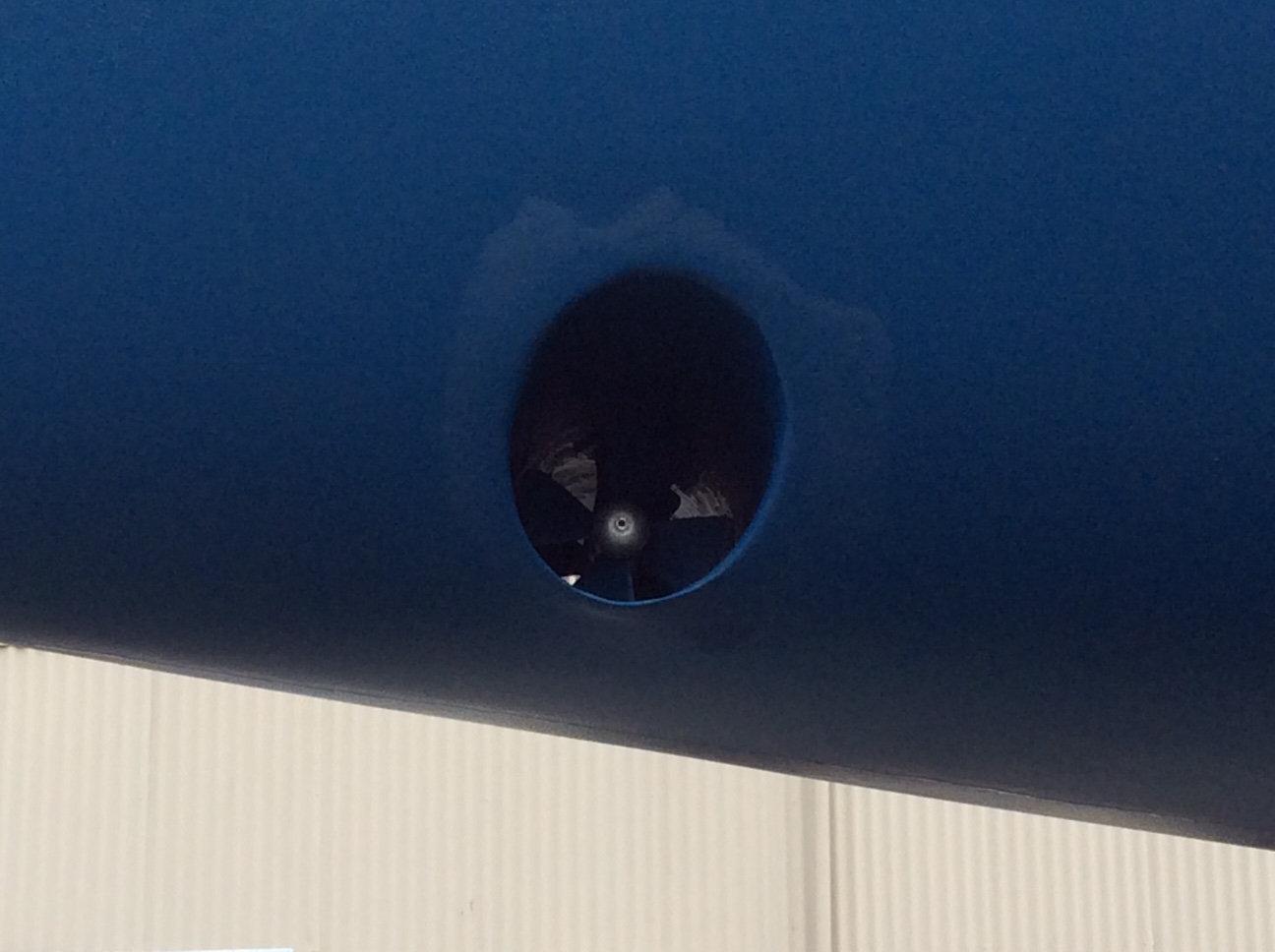

They do not require any maintenance other than inspecting the zinc during bottom cleaning and inspection when out of the water for bottom cleaning. Surprisingly, it also does not take up much space as shown in the attached photo.

Use of a bow thruster kinda sounds like the age ole argument of motorcycles with anti lock brakes. Do thruster's effect flow over the surface of the hull of course they do, to what effect, now that is a good question. I know on our hull the forward side of the 6" tube opening is built up like a smooth upward curve to direct flow over the hole with minimal disturbance. I have read testimony by one who has added a thruster to a boat that they have had for a few years and stated they saw no noticeable loss in performance.
Taken from an article in Cruising World, "You'd think that having a tunnel bisecting the bow below the waterline would surely lead to increased drag when you're sailing or powering at speed. But this can be minimized, provided that a small lip is faired into the leading edges of where the tunnel meets the hull and that a depression is created along the trailing edges. These divert the water away from the tunnel port, resulting only in an almost imperceptible increase in drag."
