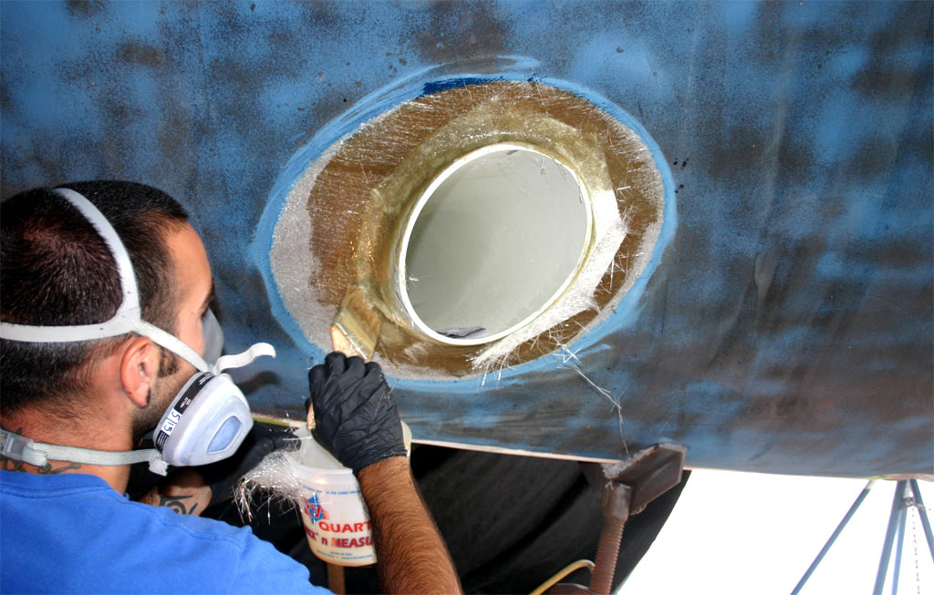

The following youtube video entitled "How to Install a Bow Thruster" shows the installation of a "tunnel" bow thruster on a Hunter sailboat about your size. These guys weren't afraid to cut those two large tunnel thruster holes in the side of their boat!! Tunnel thrusters are usually located 4 to 8 feet back from the bow. This way you can be sure the hull width is sufficient to allow good water flow through the transverse tunnel and that the thruster is deep enough in the water that it won’t suck air. External thrusters, like the Yacht Thruster, also need to be set a few feet back, although not quite as far. Plus check out the Sail Magazine article below.
