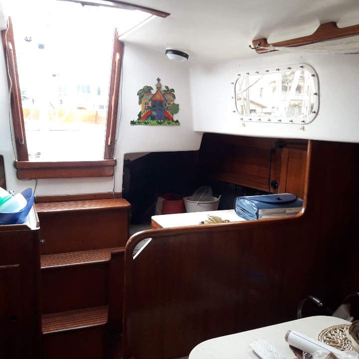

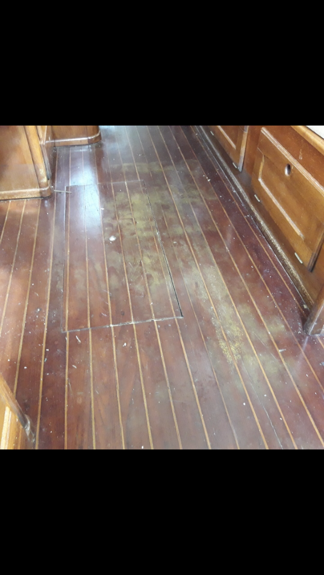

Awesome, glad to hear it started again, wood doesn't even look bad.

all I see the need for here is a careful mold inspection, wood bleach, varnish and a good amount of elbow grease. Obviously I am armchairing this one but even if you drop 10k on woodwork making her perfect you will still easily be 30k ahead on what you’d pay for her if she wasn’t a salvage. Just my opinion.

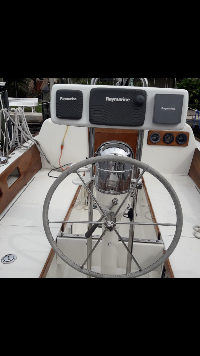

The plotter s worth as much as you paid for the whole boat.
Bristol used a very hard teak and mahogany marine laminate for the interiors, as the cabinetry is part of the reinforcing structure of the boat.

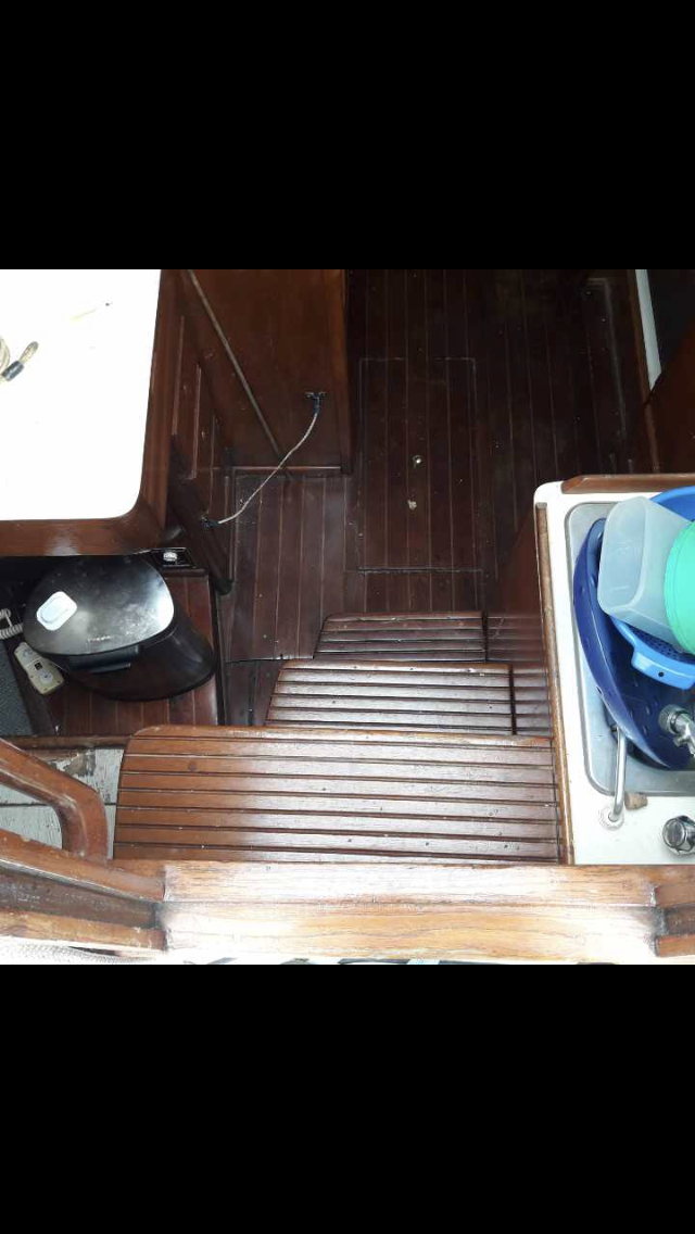

The sole is solid teak and maple, not cheeseball veneer.
Also, there is good access to the hull. No liner. So you can get at it if mold pops up.
