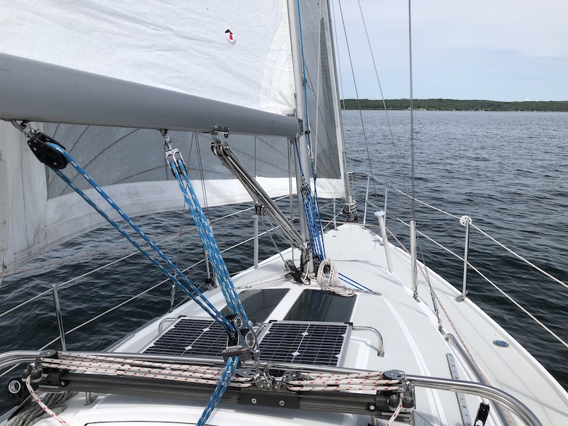

Vangmaster. Top rated by Practical sailor. Pneumatic. Infinitely adjustable. I use a Bauer 20v inflator for adjustment. Came with the boat. Expensive.View attachment 183227View attachment 183228

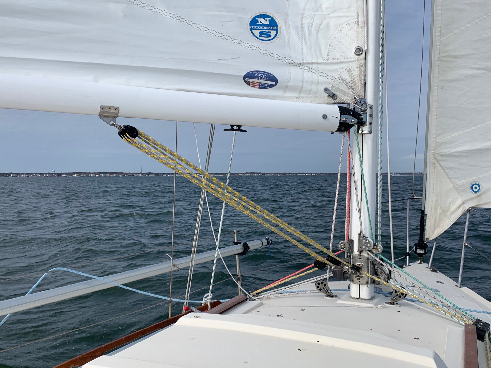

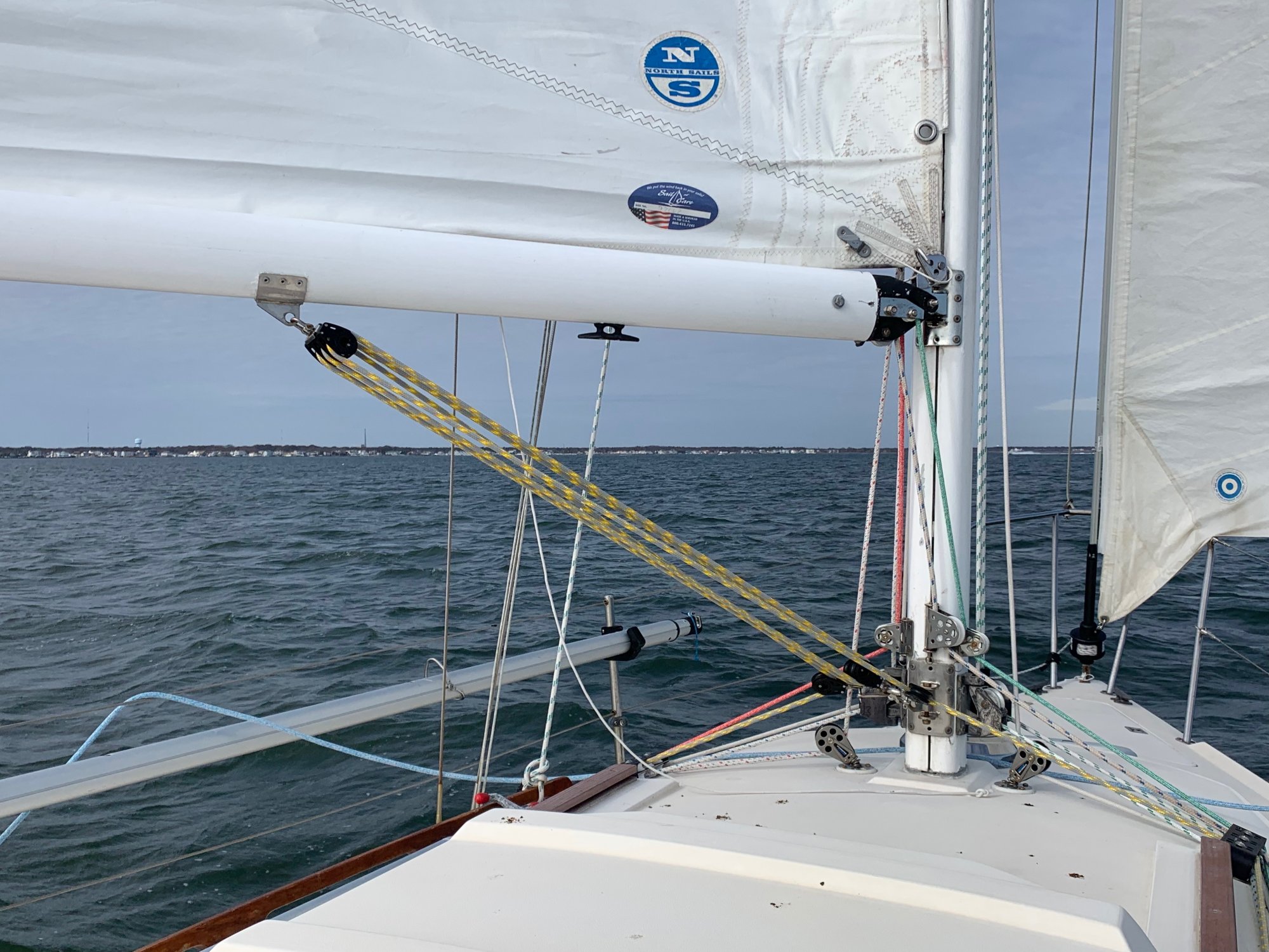

Now I have vang envy! The vang pictured in the original post is mine, after I repaired it in Edgartown two years ago. It's an Offshore Spars vang. They don't make them anymore, which might be a good thing.

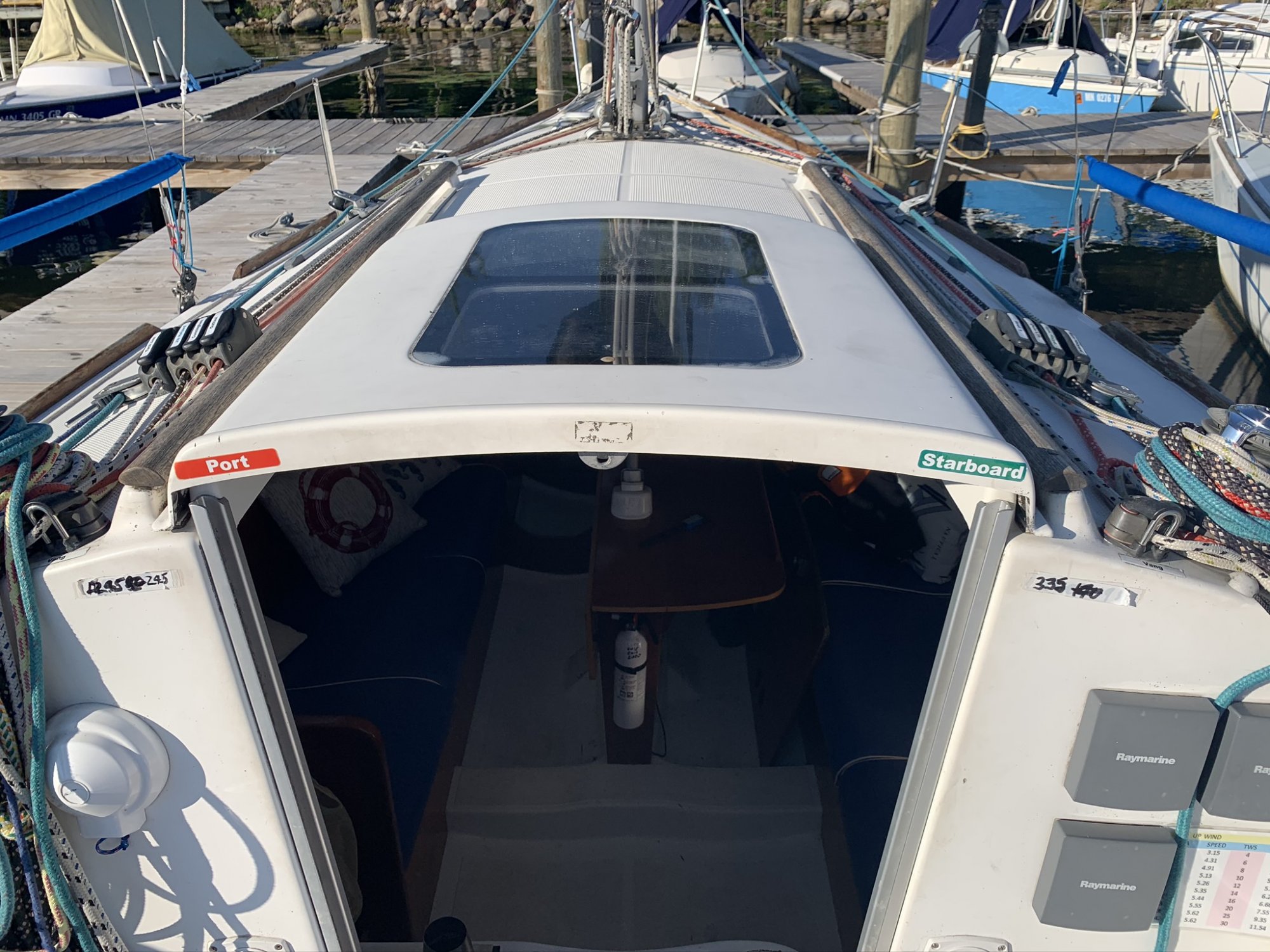

12:1 soft vang back with boomkicker. Simple 6:1 with a 2x dyneema doubler. Double ended (back to Harken 150 cleats with high-aspect angle cages) to both sides of the companionway so can be easily adjusted/played from either side of the cockpit.

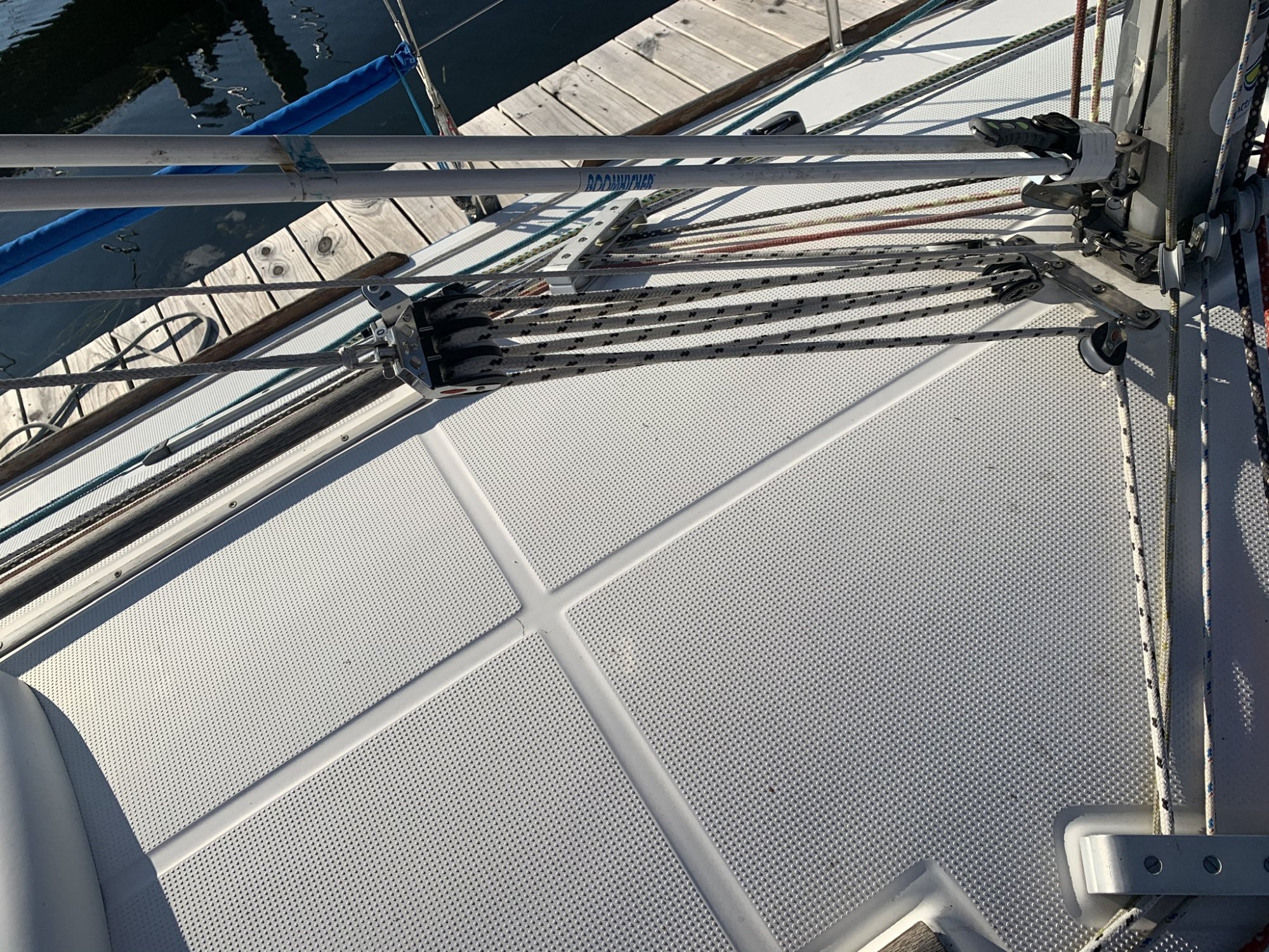

I spent a lot of time considering a Seldon rigid vang and never pulled the trigger on that purchase. I finally assembled this 6 to 1 purchase with lines leading to both sides of the cockpit.
While I couldn't effectively use the original 4 to 1 without a winch, the 6 to 1 works very well by hand. I was thinking of cascading blocks for either 8 to 1 or even 12 to 1. Found out that 6 to 1 is suitable and, for that, I'm happy.
What block you using on the cascade?

I'm breaking a running rigging rule, but I used a nylon line in the fiddle blocks to help absorb shocks from jibes to try keep expensive parts on the vang from breaking in the future. The little bit of stretch under load will not affect mainsail shape enough to worry about. Other lines coiled at the mast, red is the topping lift, the green line is outhaul and Cunningham, white is the whisker pole halyard.
You might install a boom brake, Gyb’Easy, from Wichard, to do that. No more “hard gybes” with proper adjustment.
