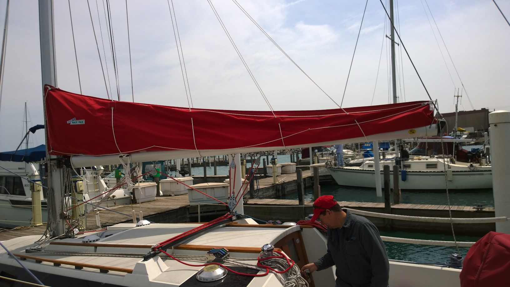

What kind of boom vang do you have, and how do you use it?
Are you using the vang that came with your boat? Chances are (for most but not all boats) thats a traditional blocks-and-rope vang.
Some owners have a more capable rigid, spring-loaded vang.
What do you have, how often do you adjust it, and what are your secrets for using the vang for better trim?

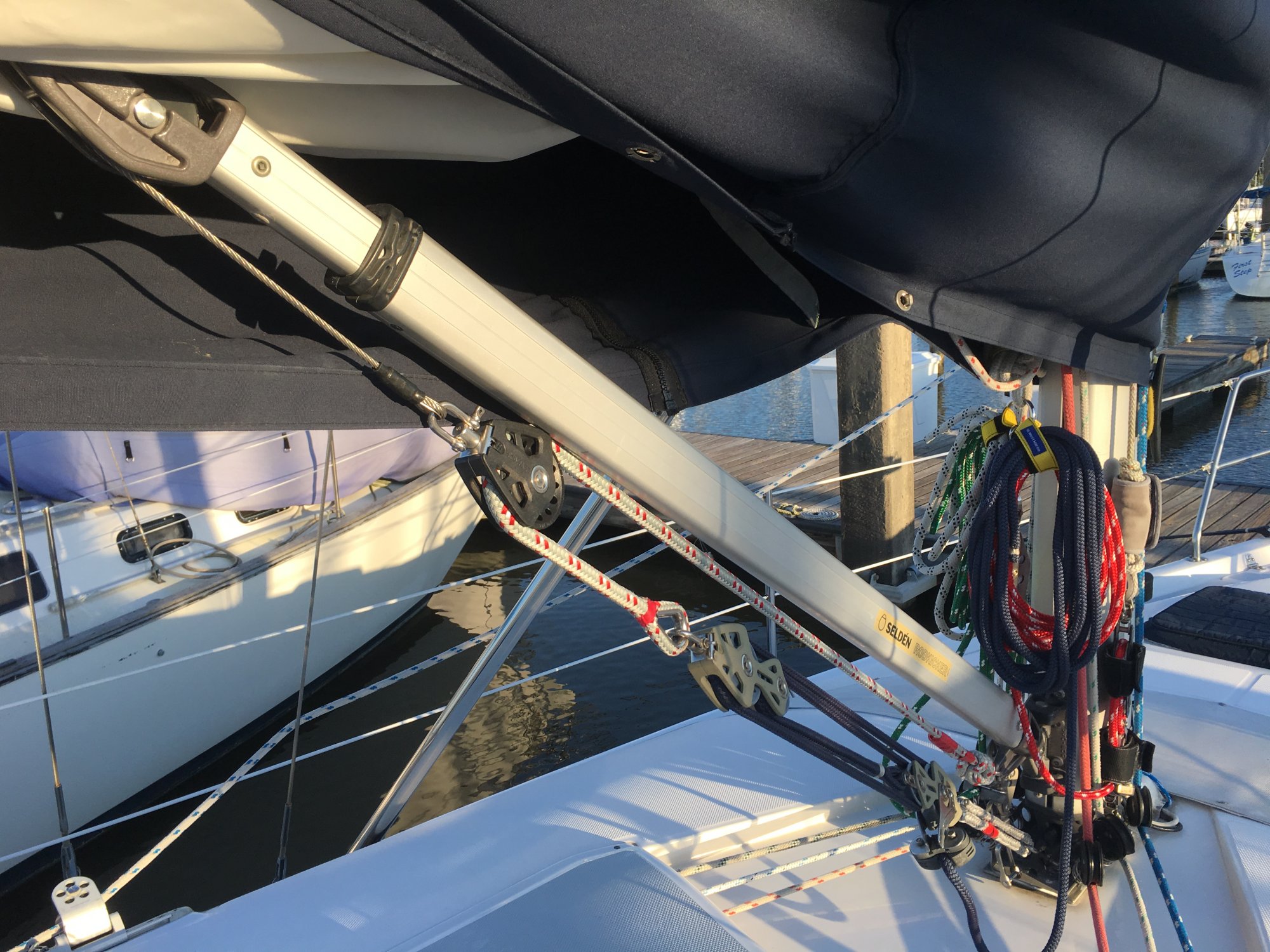

Since you asked, just finished rebuilding my vang after it failed after too many hard jibes. I added a cascade block raising the purchase to 16:1, really makes it easy to adjust under load, I'm loving it. I'm breaking a running rigging rule, but I used a nylon line in the fiddle blocks to help absorb shocks from jibes to try keep expensive parts on the vang from breaking in the future. The little bit of stretch under load will not affect mainsail shape enough to worry about. Other lines coiled at the mast, red is the topping lift, the green line is outhaul and Cunningham, white is the whisker pole halyard.

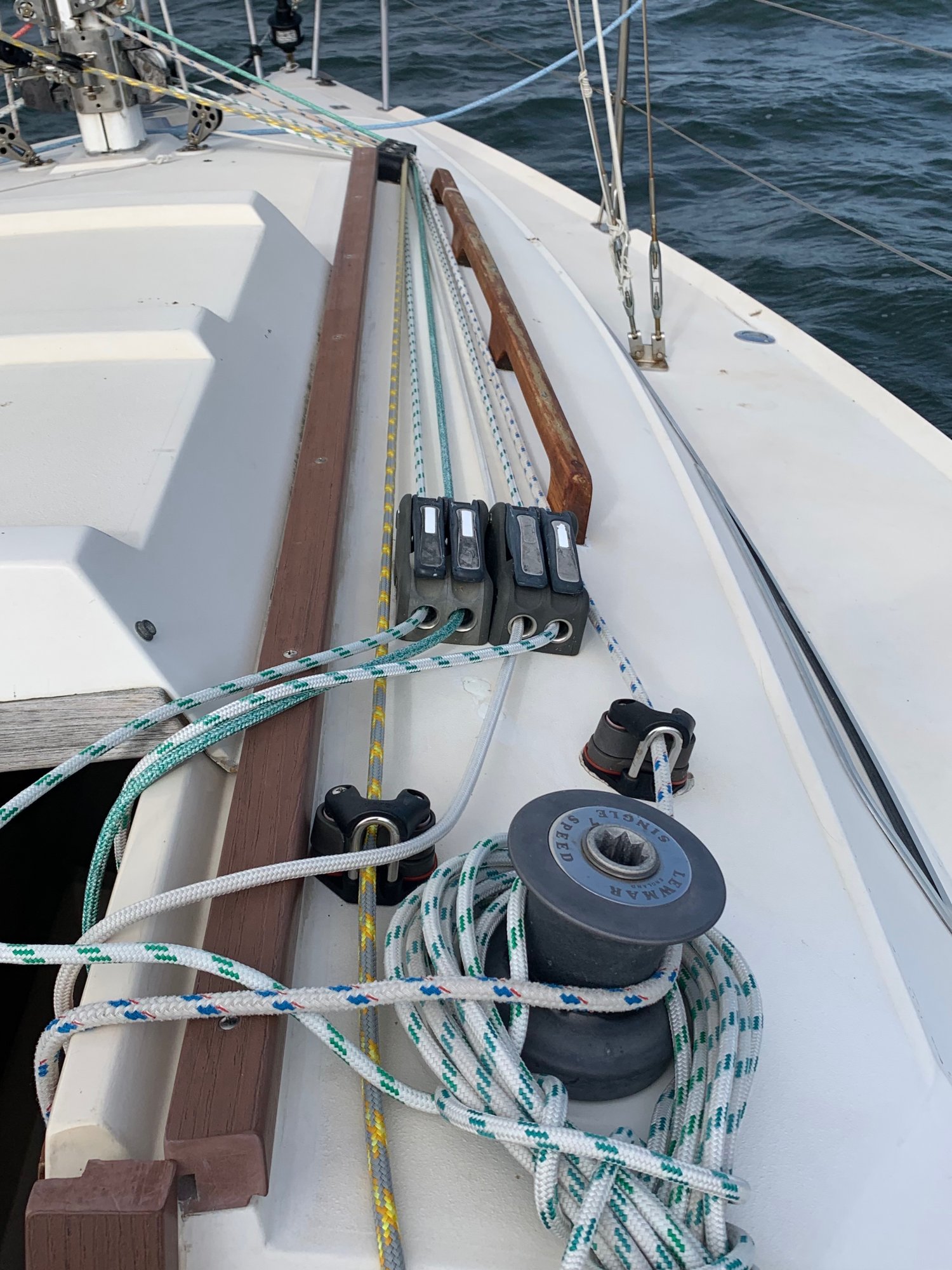

I spent a lot of time considering a Seldon rigid vang and never pulled the trigger on that purchase. I finally assembled this 6 to 1 purchase with lines leading to both sides of the cockpit.
Note all the bird crap on my roof! :banghead: While I couldn't effectively use the original 4 to 1 without a winch, the 6 to 1 works very well by hand. I was thinking of cascading blocks for either 8 to 1 or even 12 to 1. Found out that 6 to 1 is suitable and, for that, I'm happy.

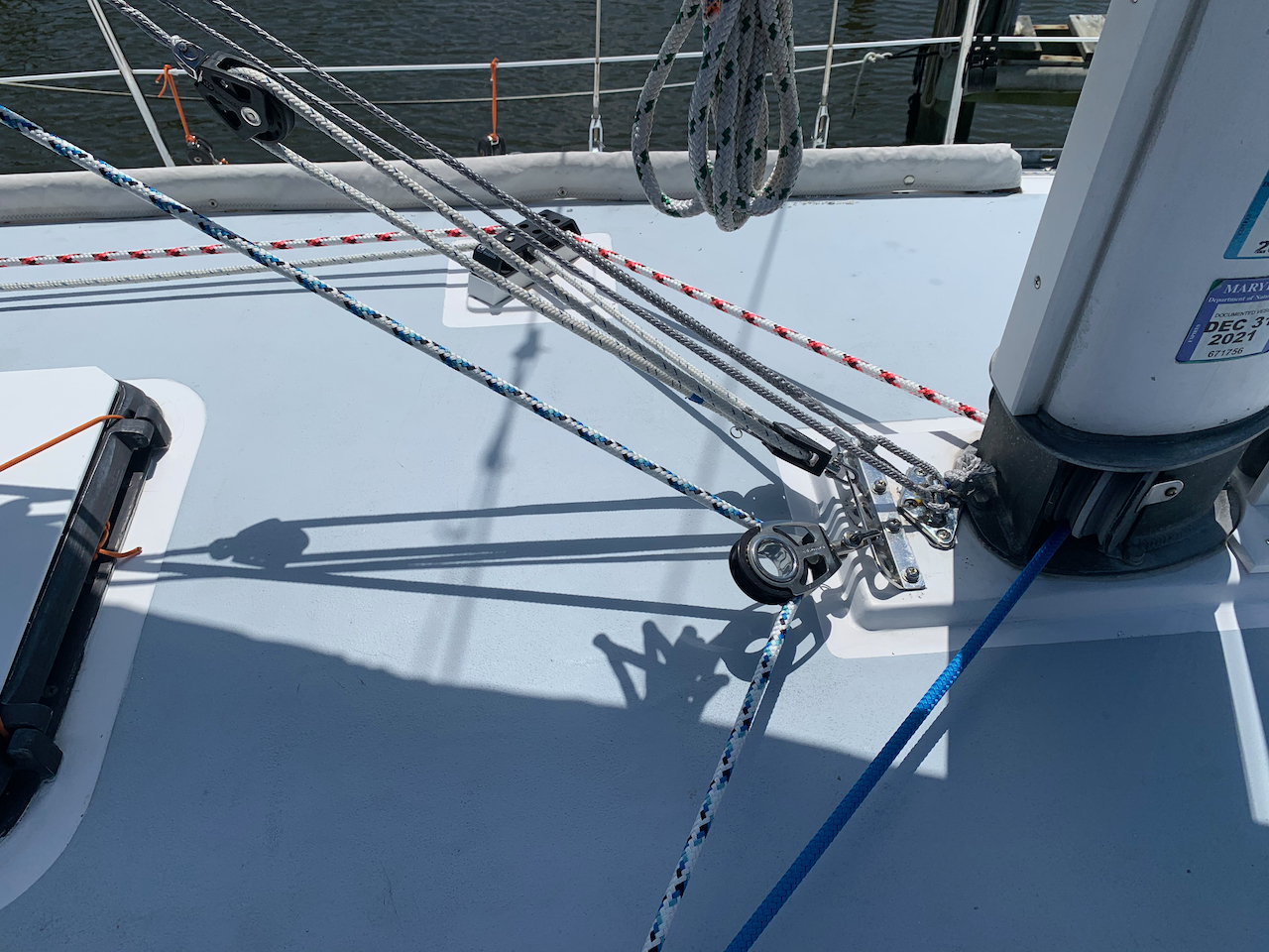

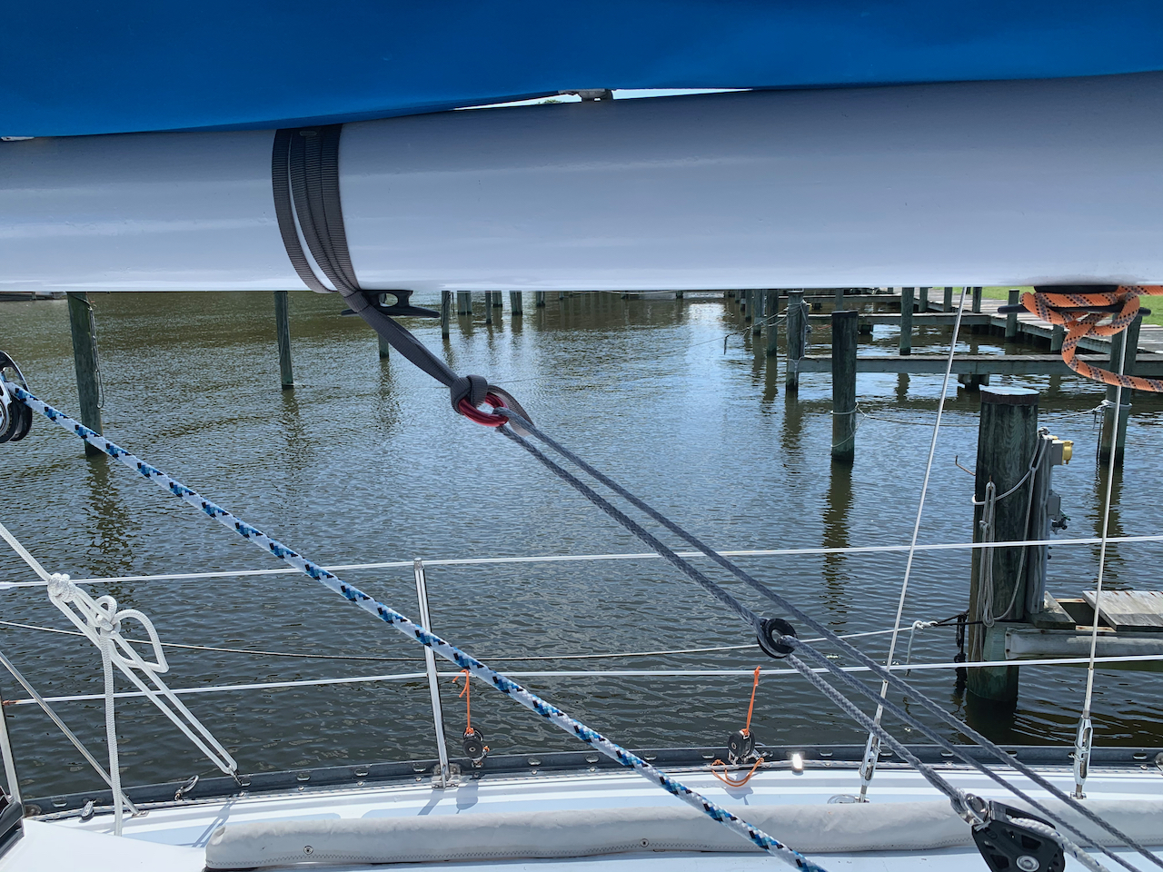

Just installed a "homemade" rope vang on our '82 Hunter 36. A couple of low friction rings and two (overpriced blocks from West Marine) plus some Amsteel Blue..line leads through a deck organizer to the cockpit with a Garhauer Rope Clutch. I haven't tested it yet though. With TS Isaias on her way I don't want to test it in those winds....eventually I'll replace the strap on the boom with a permanent, interior mounted loop.
