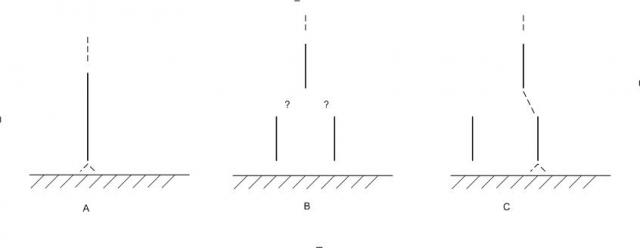

Also attached is a drawing showing the uncertainty. In all these three cases, there is ionized air involved and where the charge goes for A and C is pretty certain. But for B, who knows. It would be some what random which way the lightning goes. It could take one path or the other, maybe even both paths.
