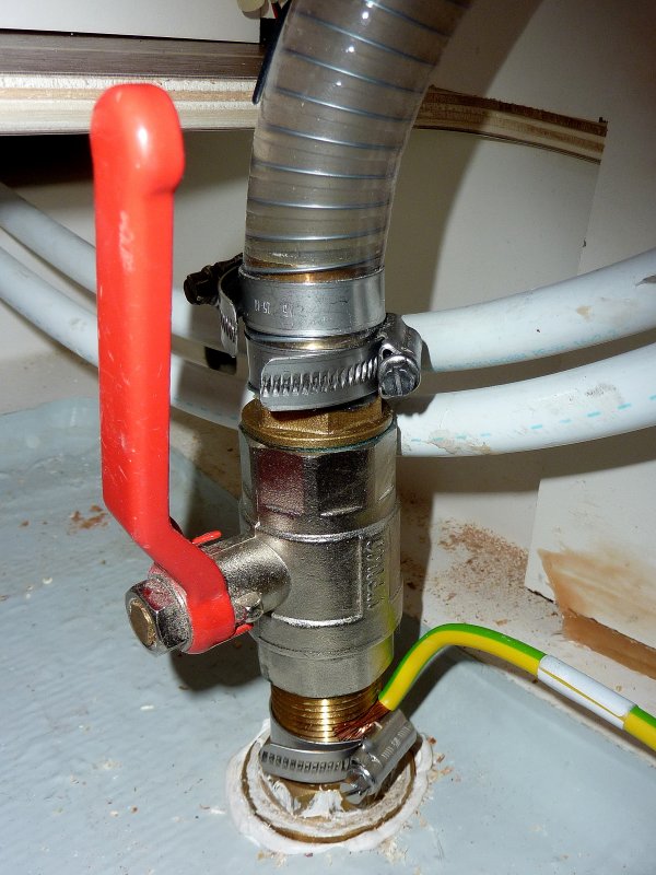

To contrast Sabre's attention to detail this was a European builders idea of "bonding"... :doh:
