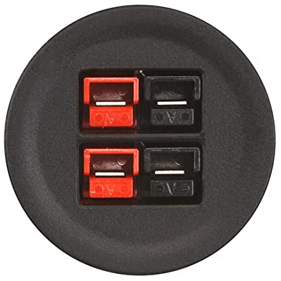

I'm sick of the cigarette lighter style plugs. I don't trust them. Looking for alternatives. So far the best I have found is the Anderson Powerpole. Any better suggestions?
Some of the devices we charge through this connection are our batteries for power tools, flood light, handheld VHF, laptops, etc.
Thanks

Anderson Powerpole are very nice that a lot of top RC pilots use on 4-5 figure airplanes and jets with real jet engines. Also used in extreme 3D helicopter pilots at our field. I'd probably leave the single lighter in place just in case but make a powerpole charging connection in a convenient place for you charging needs.

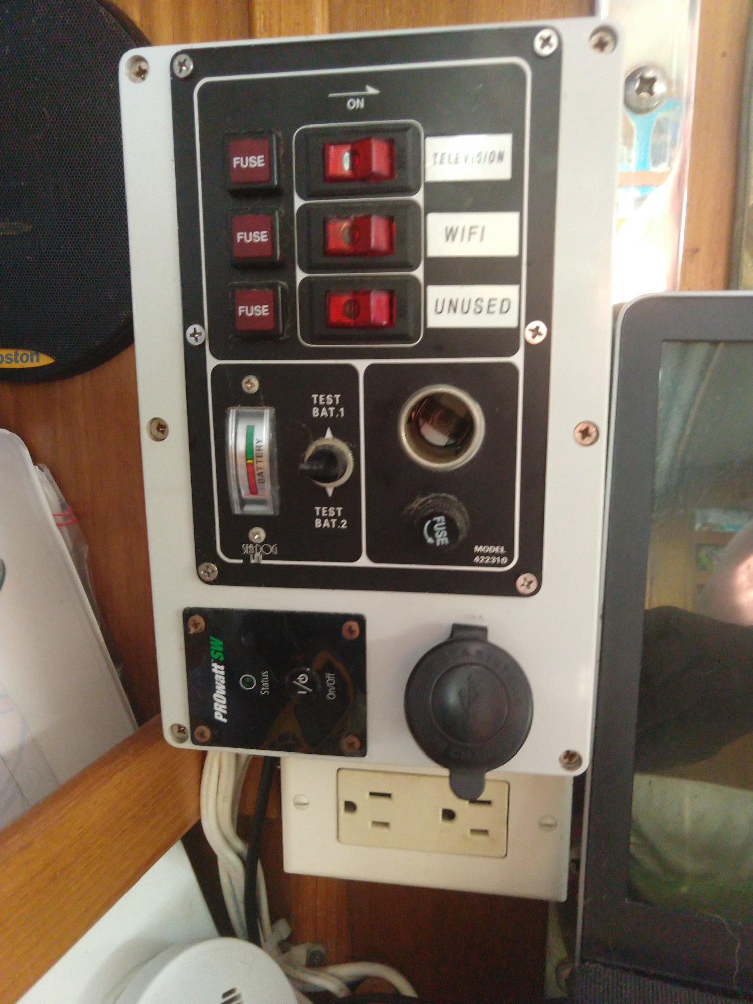

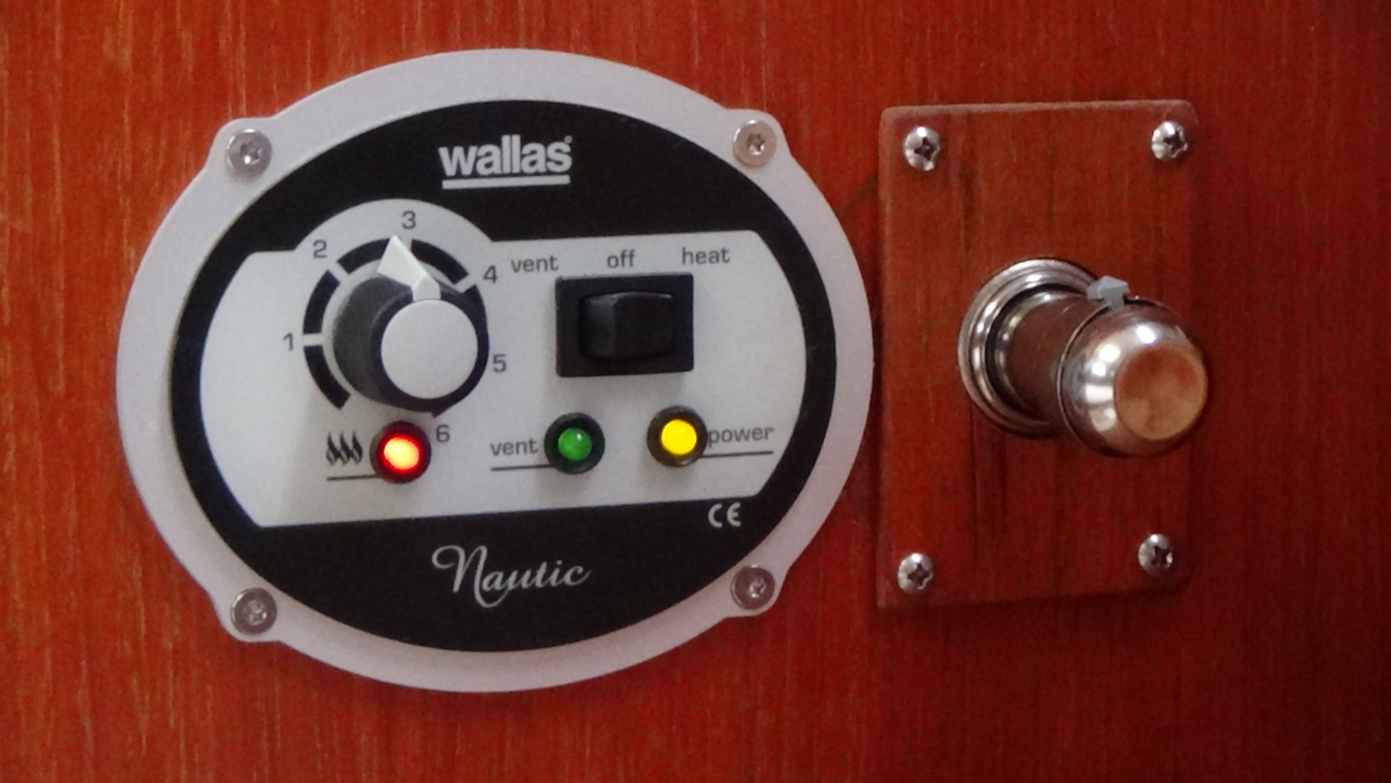

This is a secondary panel I installed several years ago. When I went to lithium batteries I moved the inverter and I don't use that remote any more. Or the 110v outlet below. So I am considering two options.
1) remove the inverter remote and put in an Anderson powerpole outlet connected to the bottom switch.
Convert my devices to the Anderson plug and have extras for the future. I could also make a Anderson to cigarette lighter plug adapter so I can bring the devices to other boats if needed.
2) Wire the unused 110v outlet to the bottom breaker and label "12 Volt Outlets". Install 110v plug on my devices and label them as well. I could make the same 110v to cigarette lighter plug connector. My concern with this is the risk of someone plugging the wrong device into the wrong plug. I could use Euro style plugs with this approach.
With either approach the cigarette lighter style and USB outlets would remain usable.
Any thoughts on the two approaches?
Jesse
14,168
Option 1 would be a better choice. Don't mix and match AC and DC receptacles, it is just tempting Murphy.

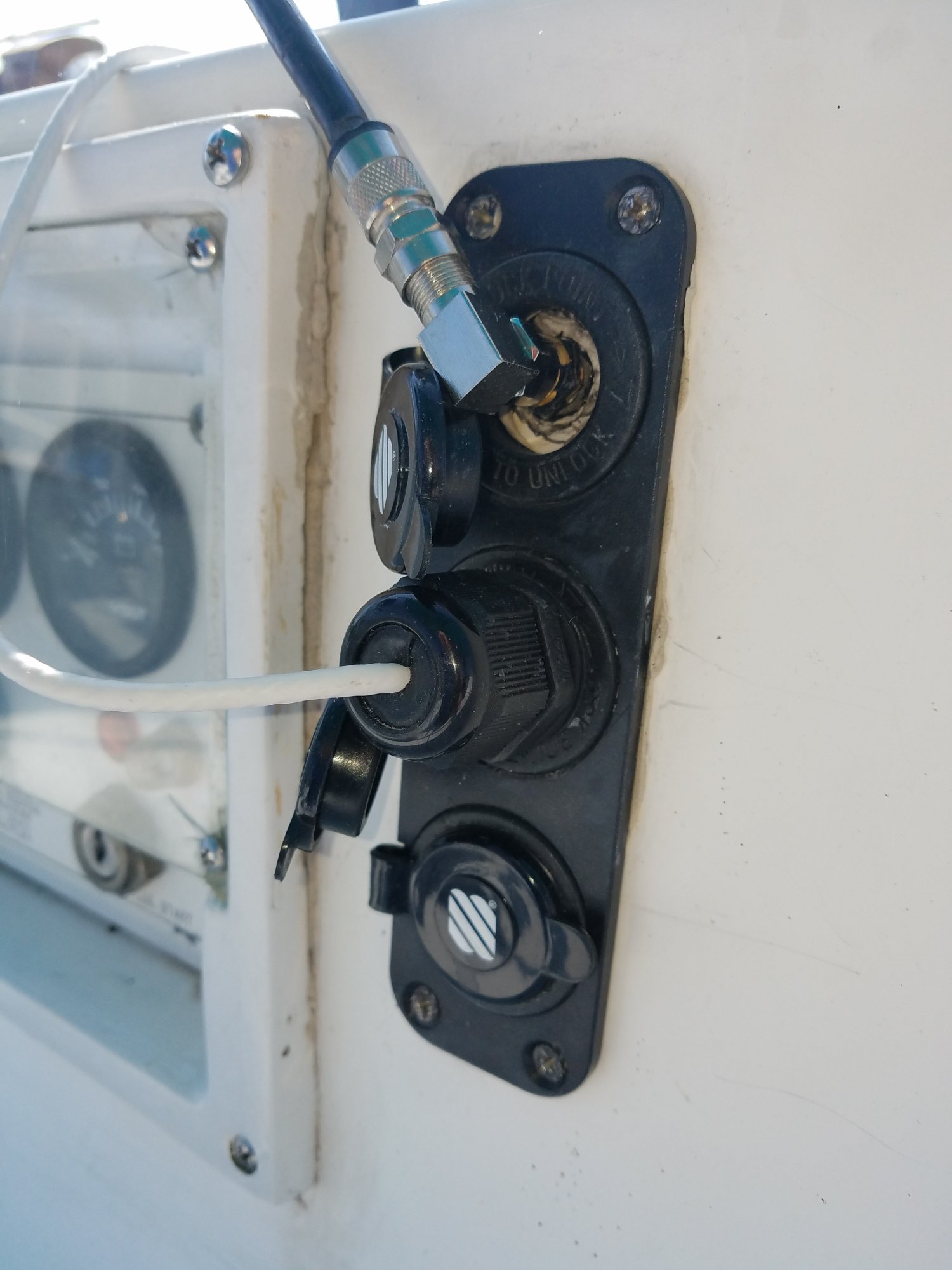

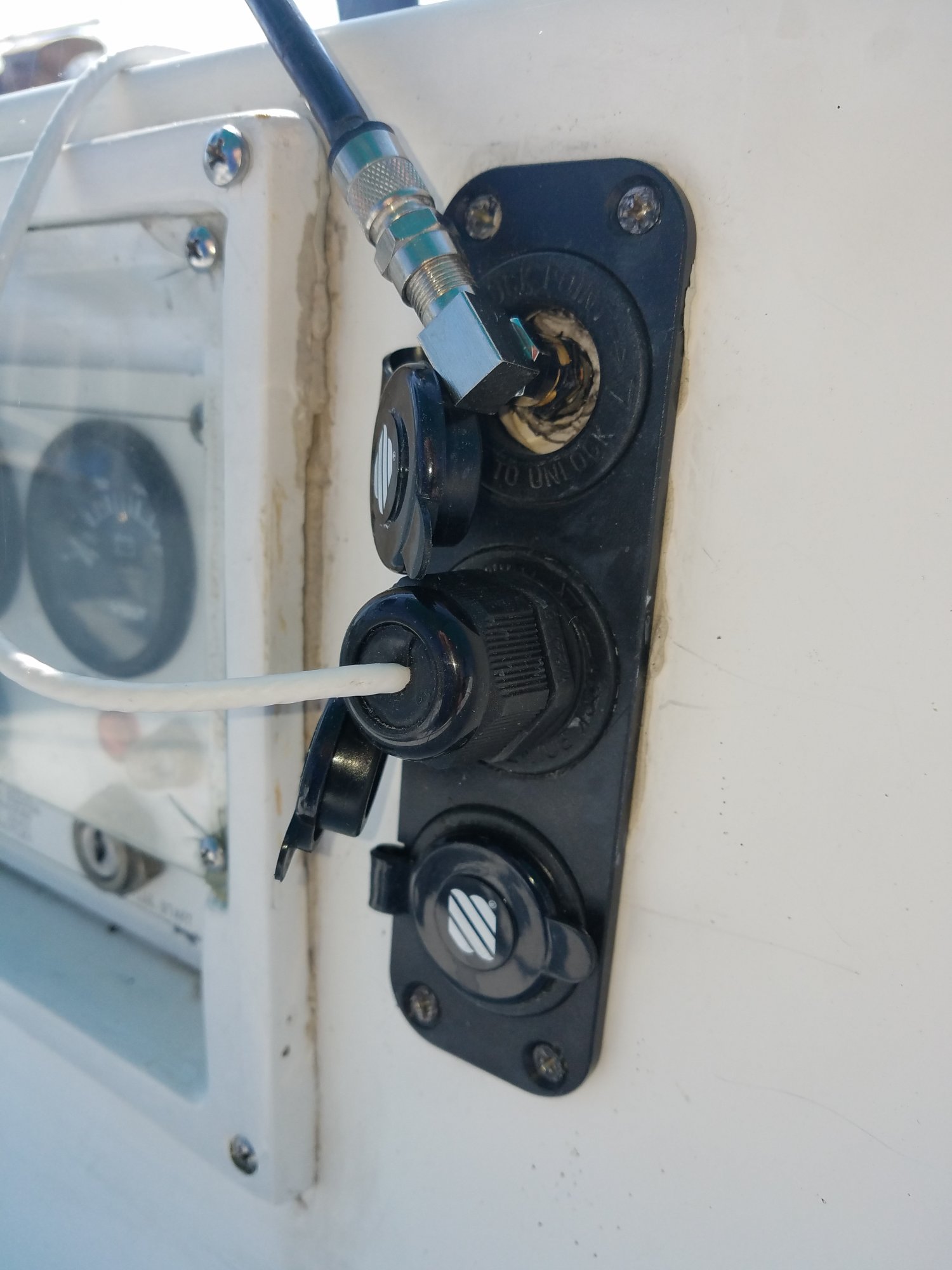

We sail on Lake Lanier, N.E. of Atlanta GA. We have a modified triple 12v outlet in the cockpit. One is the normal outlet with cover, one was converted to accept a waterproof ethernet jack and the other for an F connector with RG-6 for an HDTV antenna. We have not had any issues with performance, corrosion, water intrusion, etc with any fitting after a few years exposed to the weather. (Cold, Storms, Sun, etc.) 12v is used primarily for a halogen searchlight.

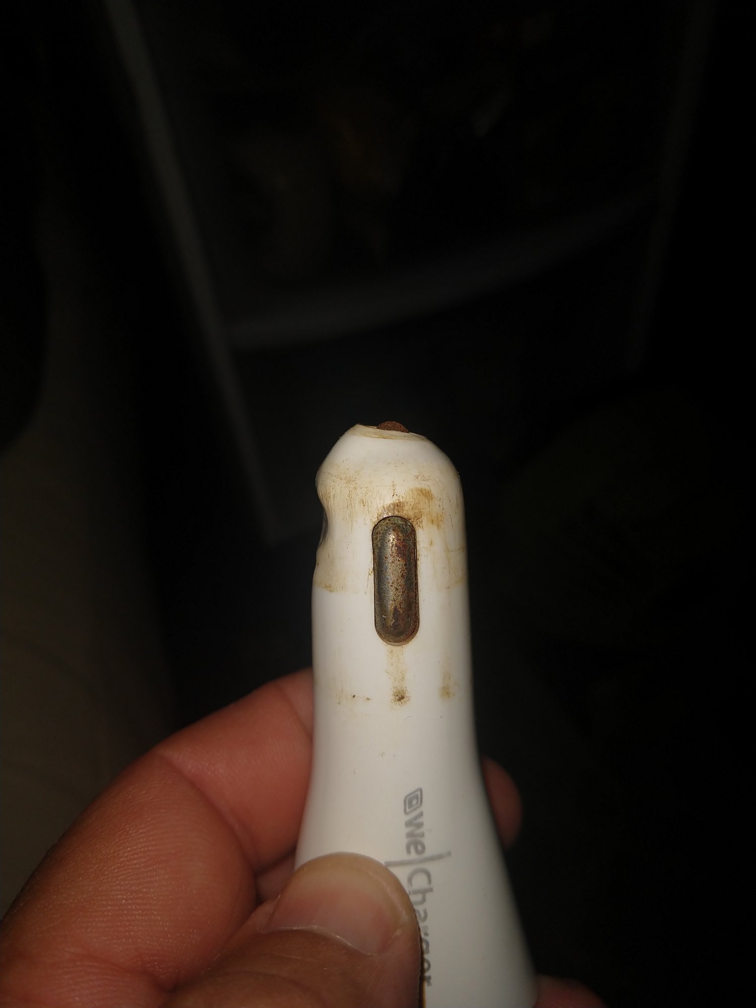

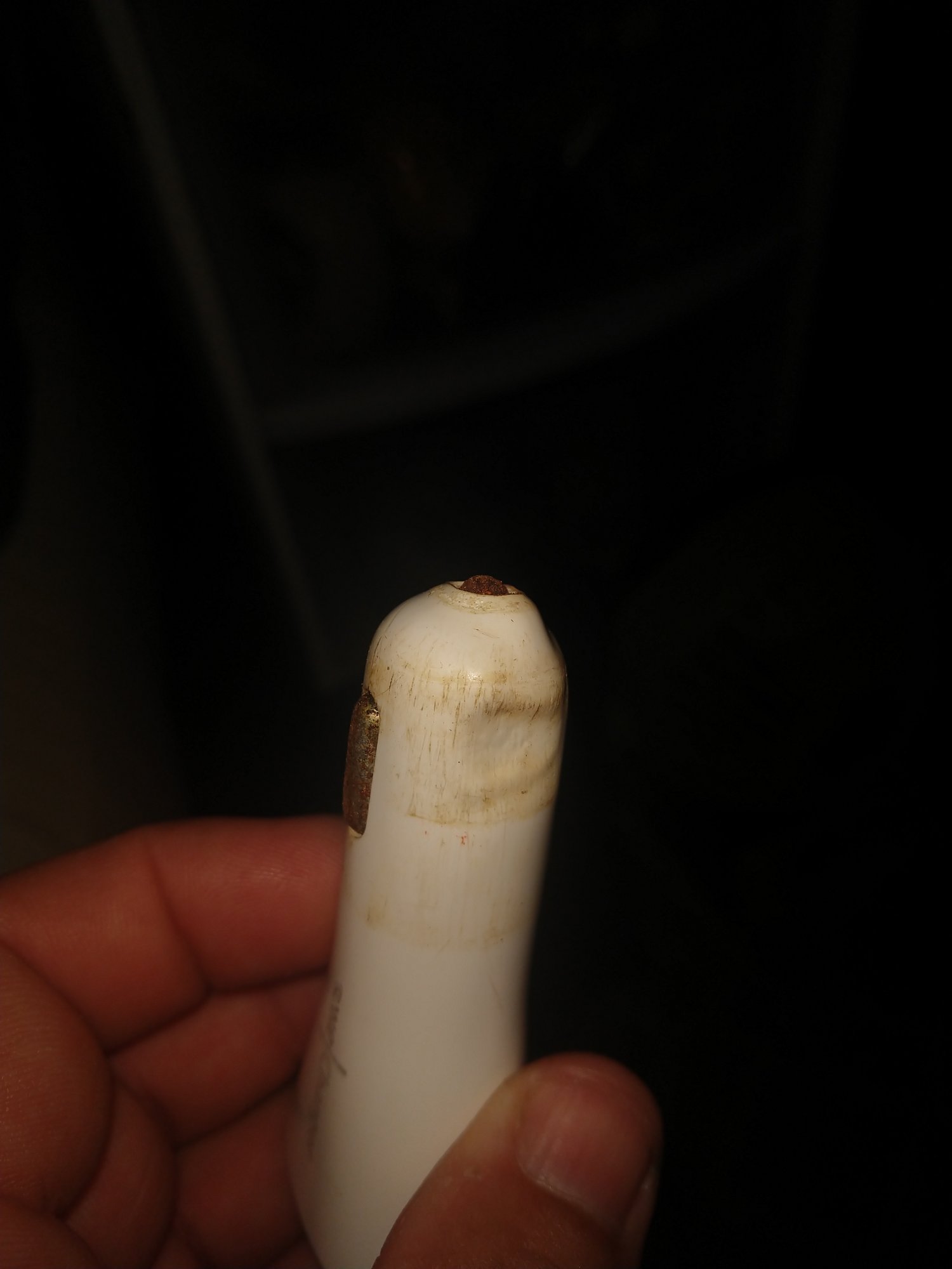

This is the charger from out MacBook Air.
Dec 25, 2000
6,059

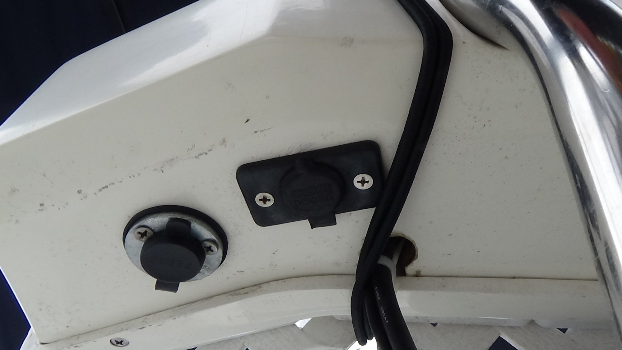

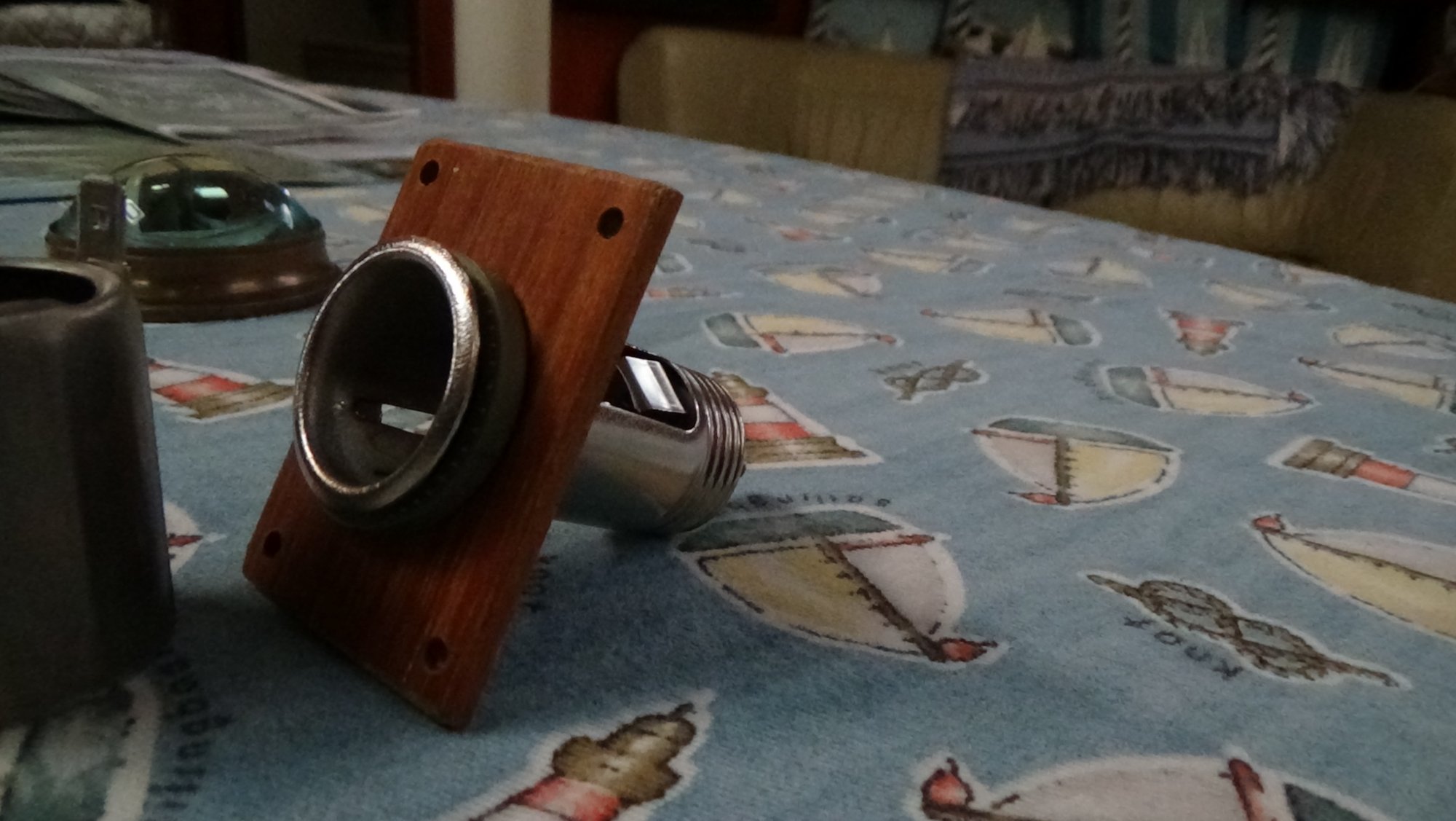

Does the socket look the same, all rusty? No rust in ours, even in the cockpit one. Of course that one is a marine grade unit with a rubber cap/cover. All the others that I've added inside the boat were for car applications. Some pics of ours follow:
