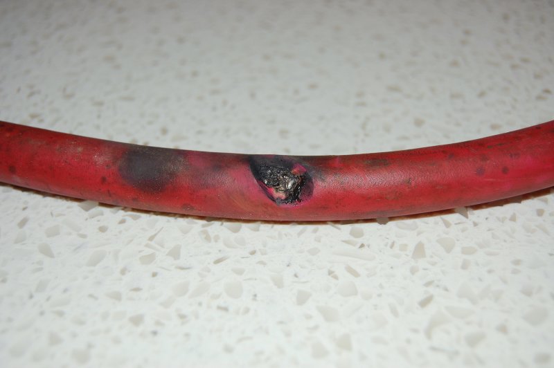

The dead short in the wire below was 2 GA, with an owner installed 300A fuse, inside an engine compartment. Max ampacity at 100% of table IV in an engien bay is 178A. This however was not 105C wire and was likely 90C, at best.
I'd have to say that in the "real world", not "Great Roosaks" world, the ABYC safety parameters do work.. This fuse was well ABOVE the 150% rule and the wire did NOT catch fire. The 300A fuse safely blew as it should. Working on boats I have blown a number of $15.00 fuses and never had any "wire damage". Always sucks when I do that, cause I eat that fuse as I should, but they blow, as they should, even when sized at 150% of Table IV. There was nothing more than some slight heat discoloration near the short, as can be seen, and nothing else.
Real world exceeding the max ampacity of Table IV allowances:
With a voltage drop less than 3% or 0.28V drop at 11.98V = 2.35% VD @ 127A of current that wire should be running at nearly the same temp as ambient.
