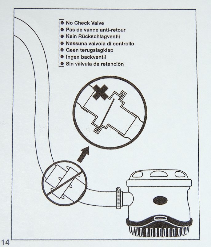

A well designed bilge pumping system will have two types of pumps:
1- A diaphragm pump for dealing with nuisance water
2- One, two or more centrifugal Rule style pumps to deal with moving high volumes of water
Follow ABYC standards. The OP's hose location and routing are not a compliant installation.
From Rule
Likes: JamesG161
