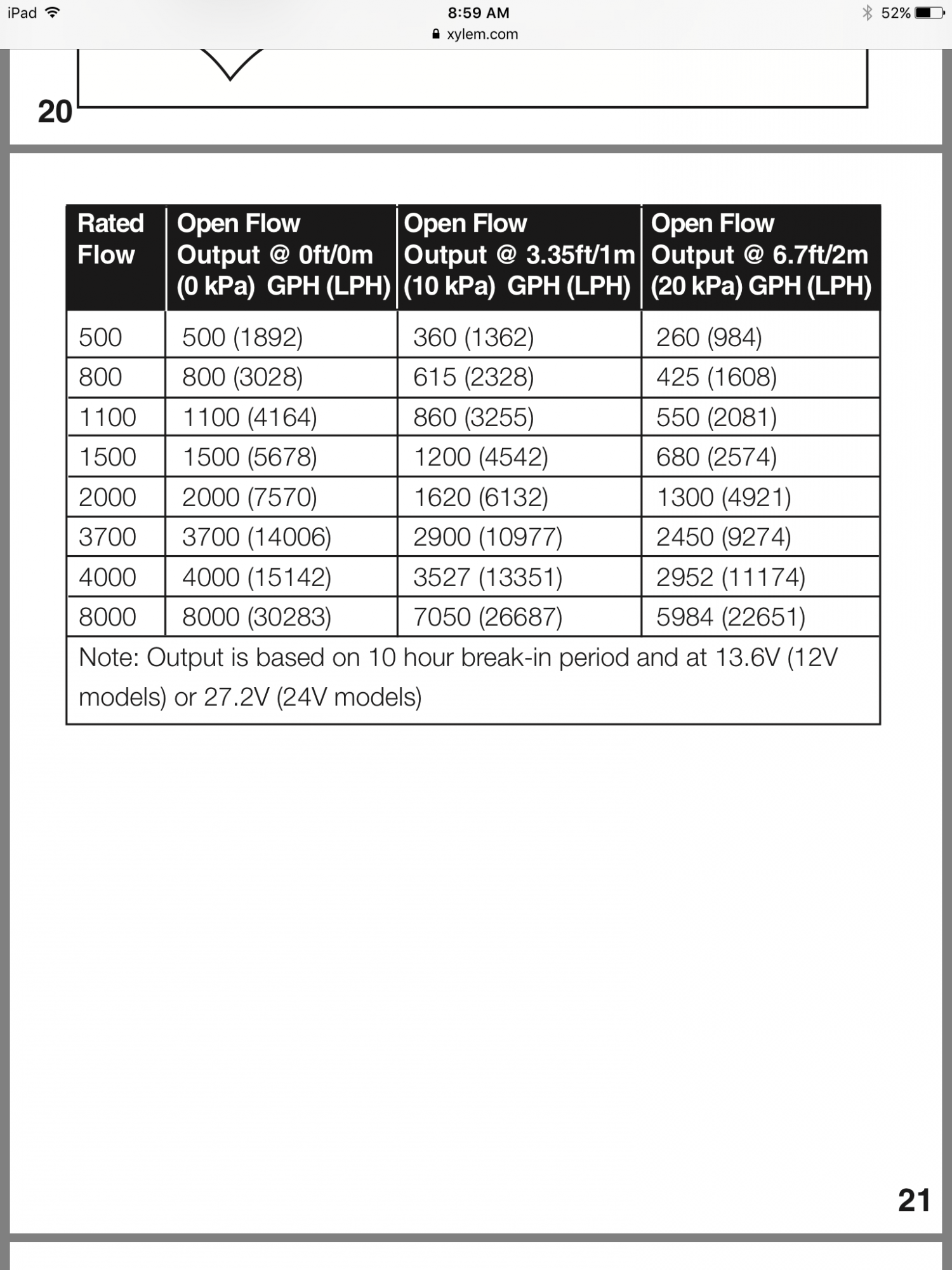

Anxious to hear your feedback. Looks like they may have cured the airlock issue. Also, notice that they changed the rating voltage down to 12. I guess @Maine Sail must not be alone in complaining about the bogus rating voltage... although, they appear to be spinning it as an efficiency improvement rather than the outright misinformation it was. Love those marketing and pr folks.
Still hard to find pump performance data for it though.
EDIT: Oops. Maybe not. The manual still shows performance ratings at 13.6v (limited to free flow and 2 head points).

Moreover: last time I read of a real world test of pumps by Practical Sailor, the measured output capacity was a fraction of the advertised number on the box. You have to consider real hose runs, actual battery voltage of maybe 12.4, normal height of 'head' or lift, and types of hoses -- lots of boats have cheap ribbed hose. Note the numbers in the right hand column in the chart... and that's the theoretical best result from the vendor/marketing department, and still at 13.6 volts. ( Yikes !)
14,025
Don't believe the numbers on the box. However, if all pump manufacturers are using the measuring technique, i.e., 0 head at 13.6 volts in to a smooth bore hose, then we can be certain that a 500 gallon per hour pump will move less water than a 1000 gph pump. How much less is anybody's guess and really dependent on the boats design and pump installation and available current. It gets trickier if someone is being more realistic about the pump's output. A pump that rates at 500 gph at 12.5 will move more water at 12.5v than a pump rated at 500 gph at 13.6v.
